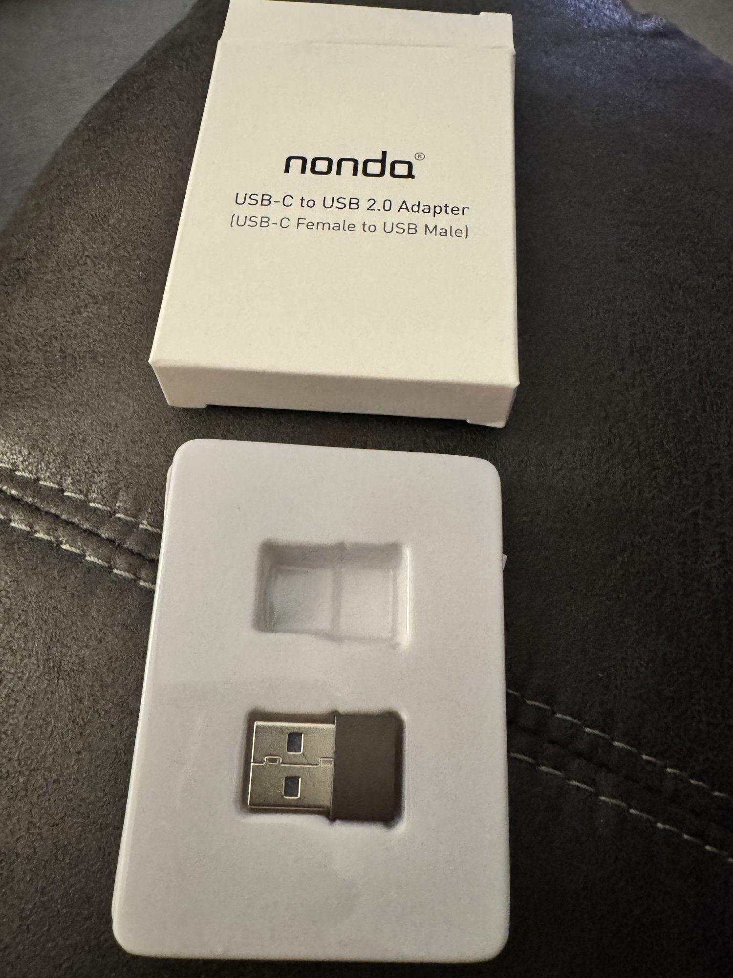

Grabbed these off Amazon a few weeks back. Work great in my Tahoe and zl1. I think they were 3-5 bucks. Problem solved.
Reactions: SqB
