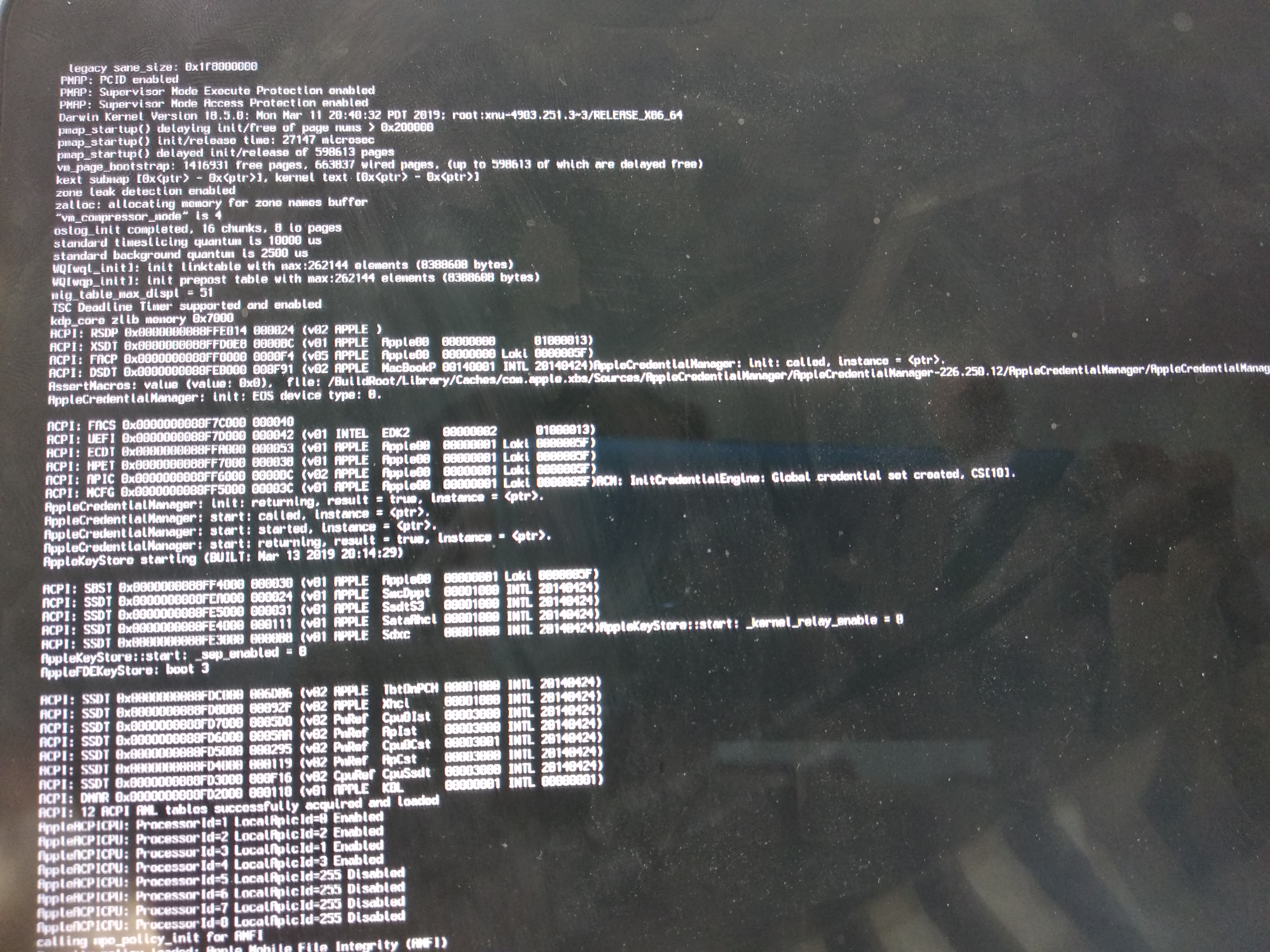

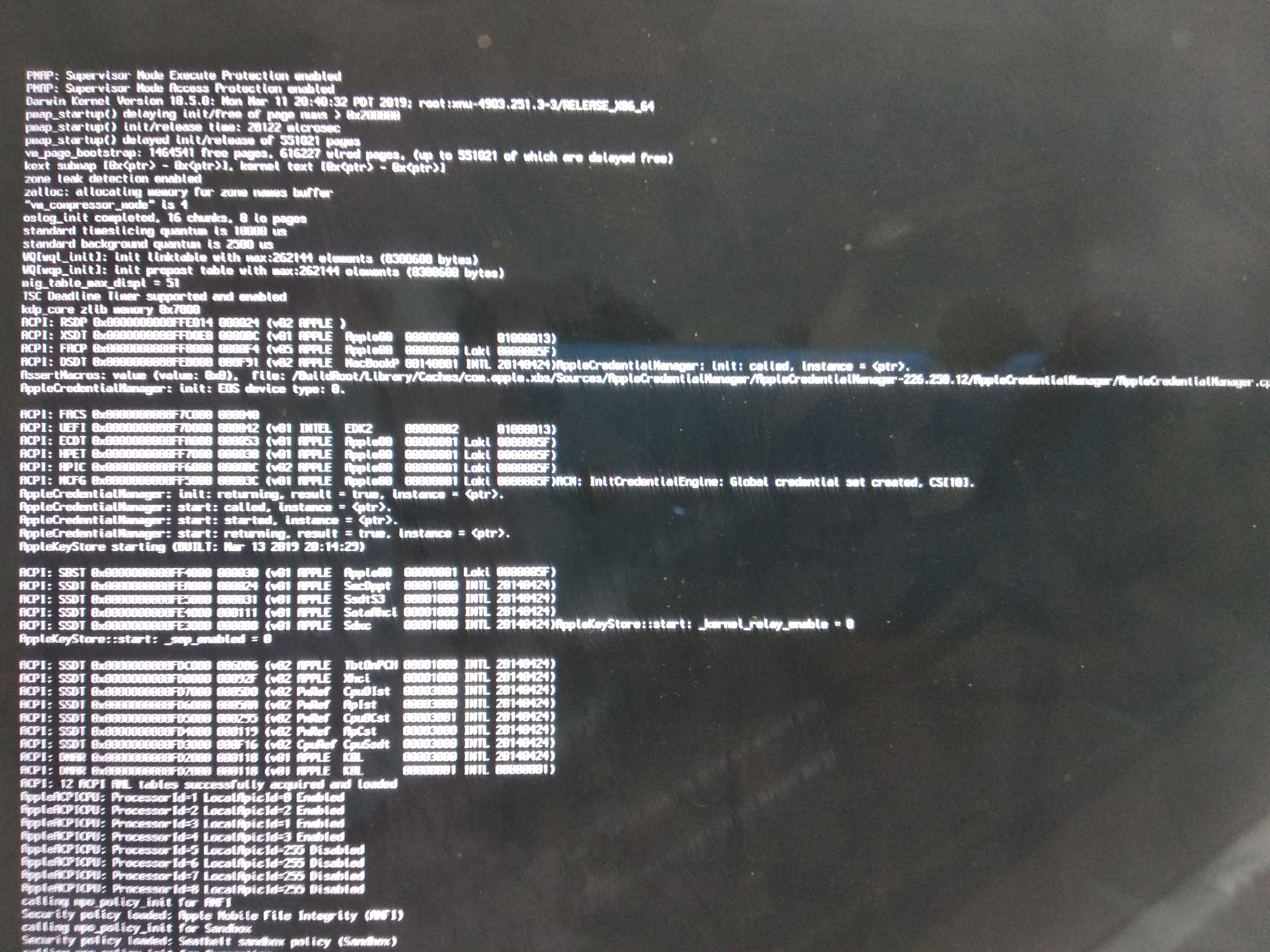

If you want to post what is displayed in your verbose mode - take a picture of the screen, and post the picture.
Yes I can boot into diagnostic mode, but it says that there's no problem.
I have added two images with the output of the verbose mode.

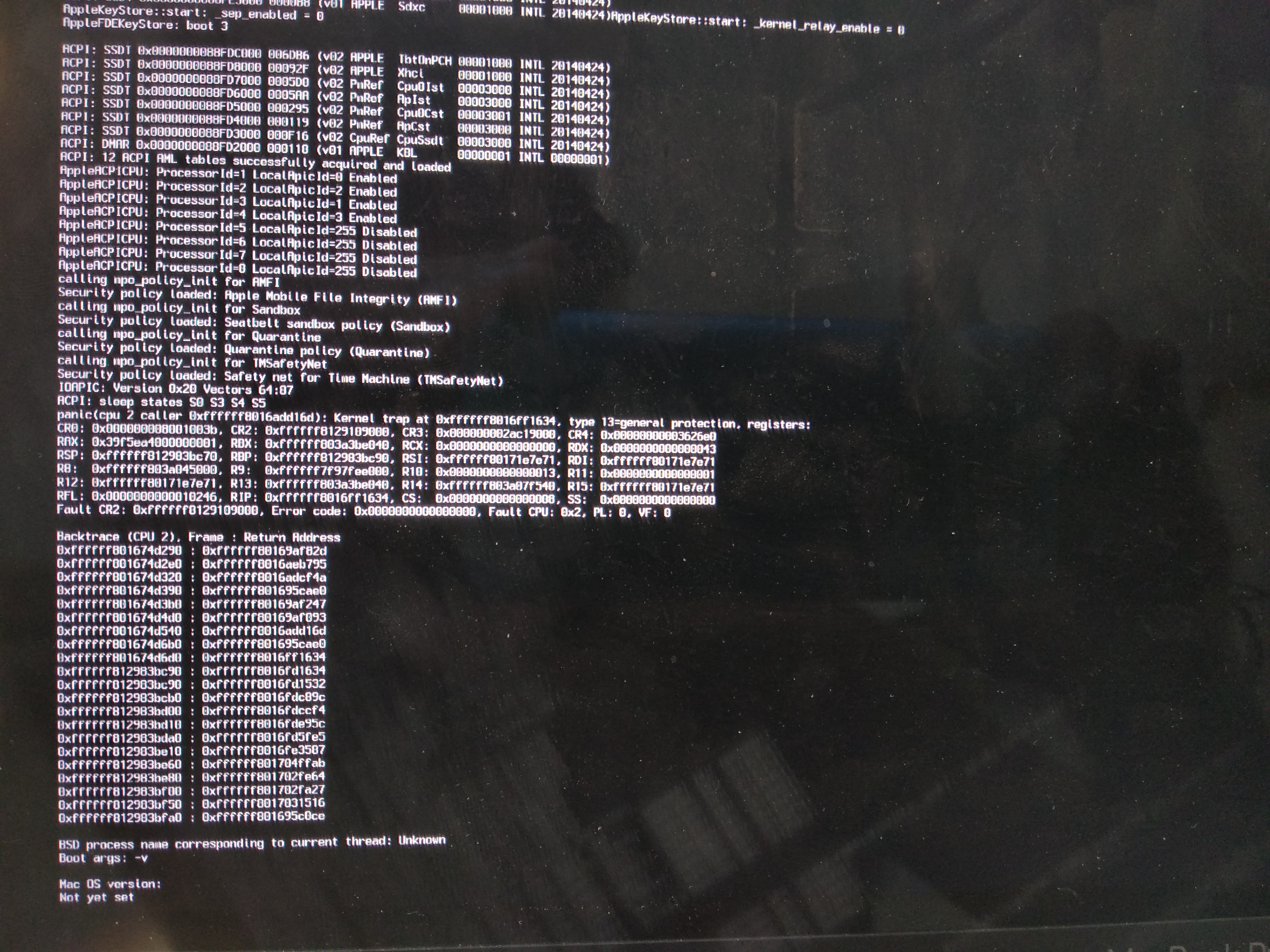

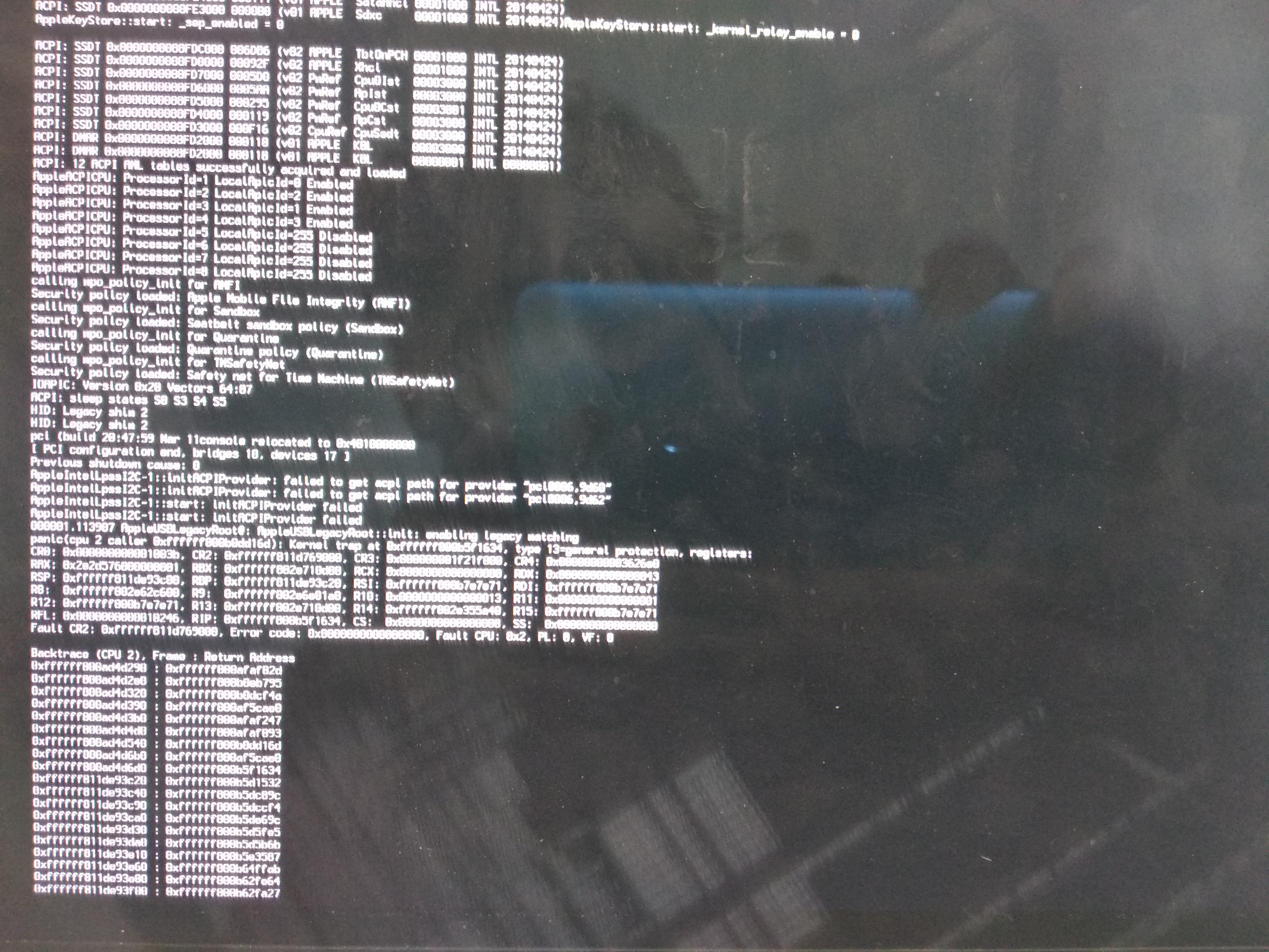

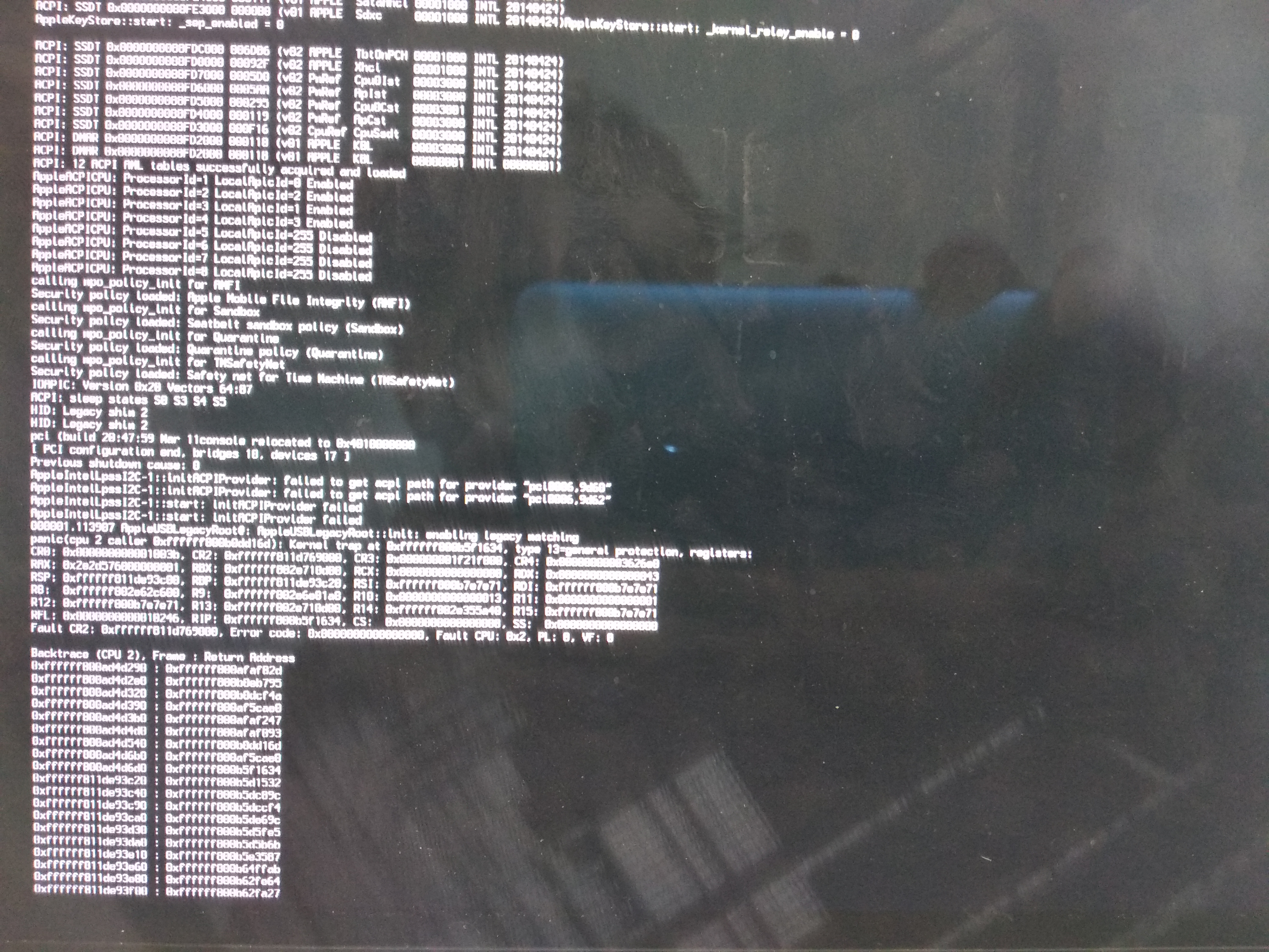

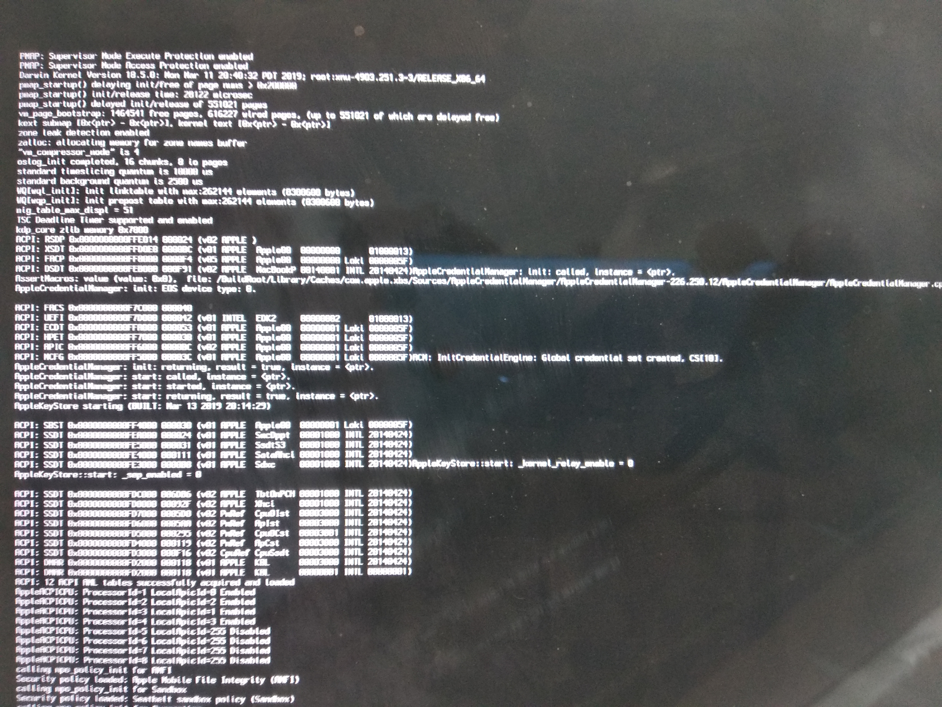

With the battery connected, when I boot in single-user mode, I get the screen with text, but its give me a kernel panic....I will upload a picture of the screen.

This is what happen when I boot in single-user mode with the battery connected to the motherboard.
Sorry for the quality, but the text size is to small...
