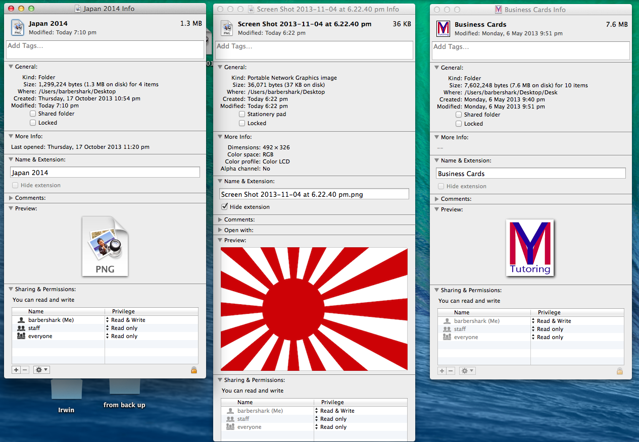

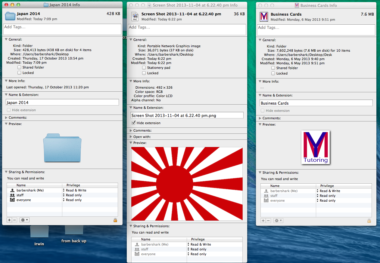

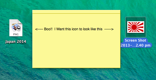

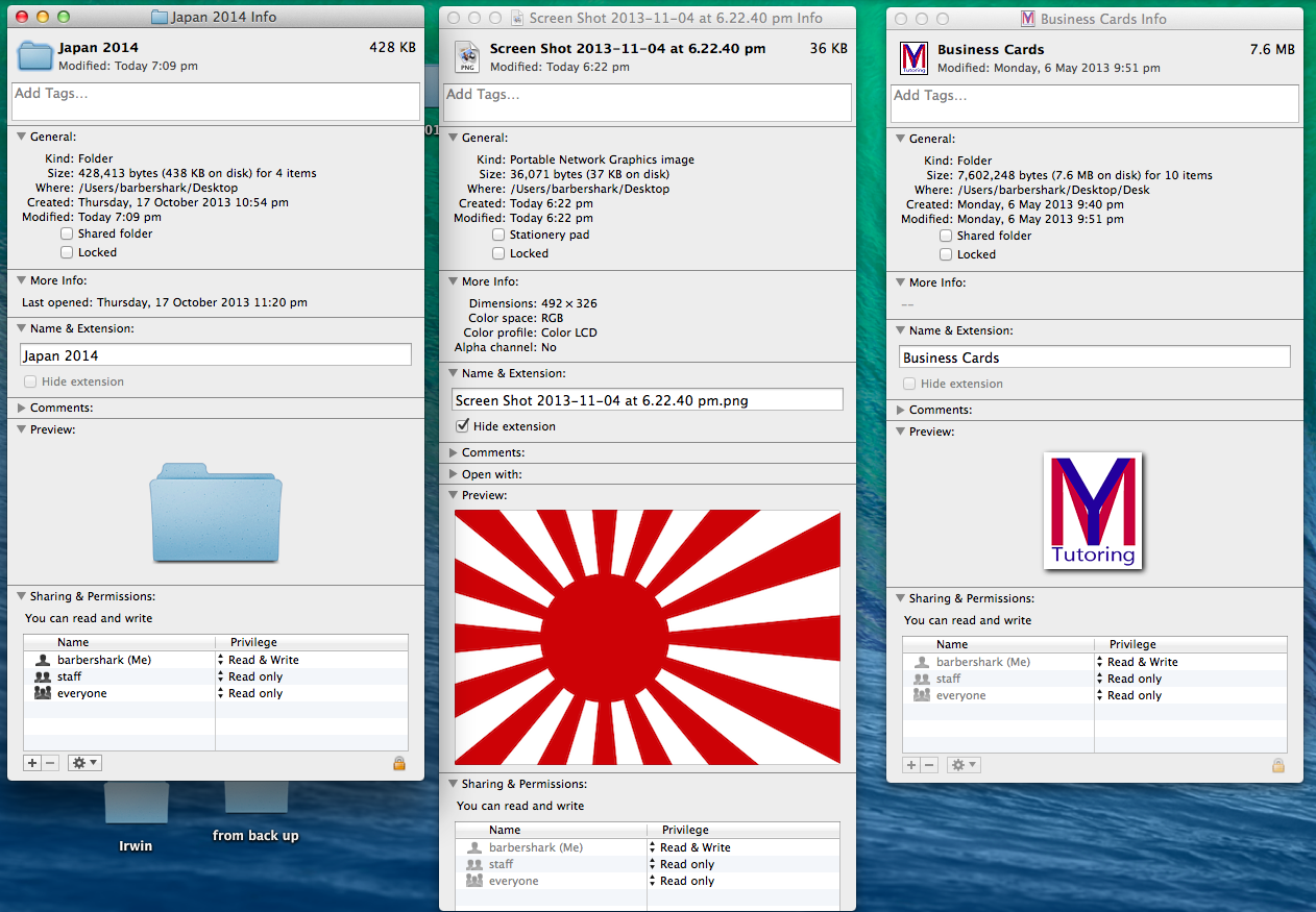

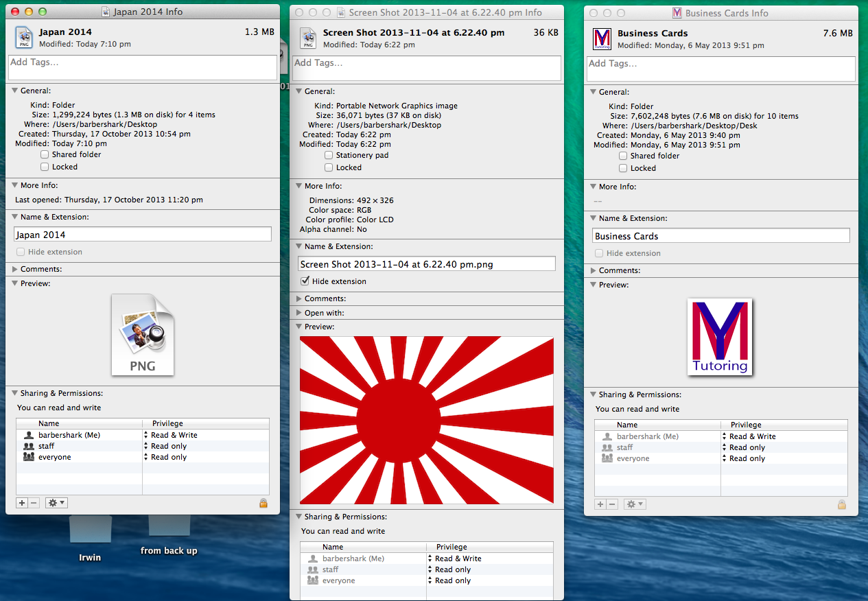

I used to use the above method with no issues what so ever, however since upgrading to mavericks the icons show up as standard .png or .jpeg icons. It is driving me crazy. See images below. Any advice on how to fix this?
(The images show what happens when I try to change an icon now... and the tutoring icon is there to show this is what used to happen... no problems. I can even transfer the old icons, however anything new just gives me those silly general icons 🙁
I get this from time to time. Usually I fix it by either re-saving the image in Preview or in the Get Info window highlight the icon in the top left, hit delete, and re-paste.
Another thought: does the image thumbnail show the proper image or just the standard .png icon? If the problem is this, then just go to Get Info on that file (not on the app or folder you're trying to change) and hit delete on the top left icon. This should make the thumbnail appear. Then you can copy and paste it into the info window for your app or folder.
I had the same issue until I decided to try downloading icns instead of png and that fixed them 😉

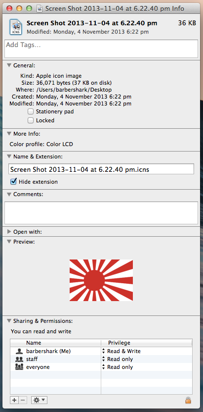

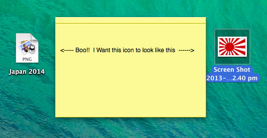

I usually create an image from a screenshot and then copy and paste the thumbnail generated, however I am getting no thumbnails at all? Even when I change the file to a .icns (see pic... I just get the standard .icns icon). Any other tips? Cheers
Ps. Thank you for offering your assistance.

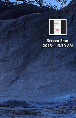

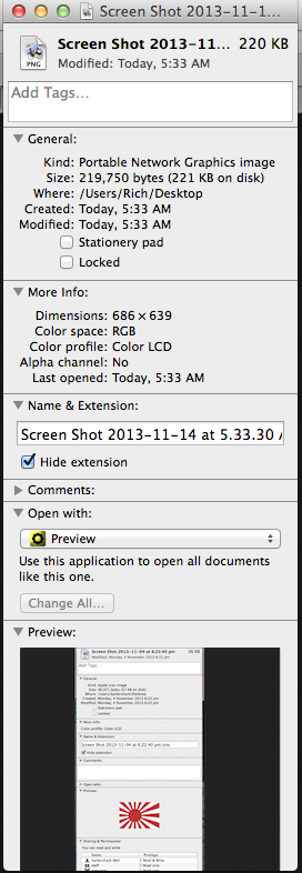

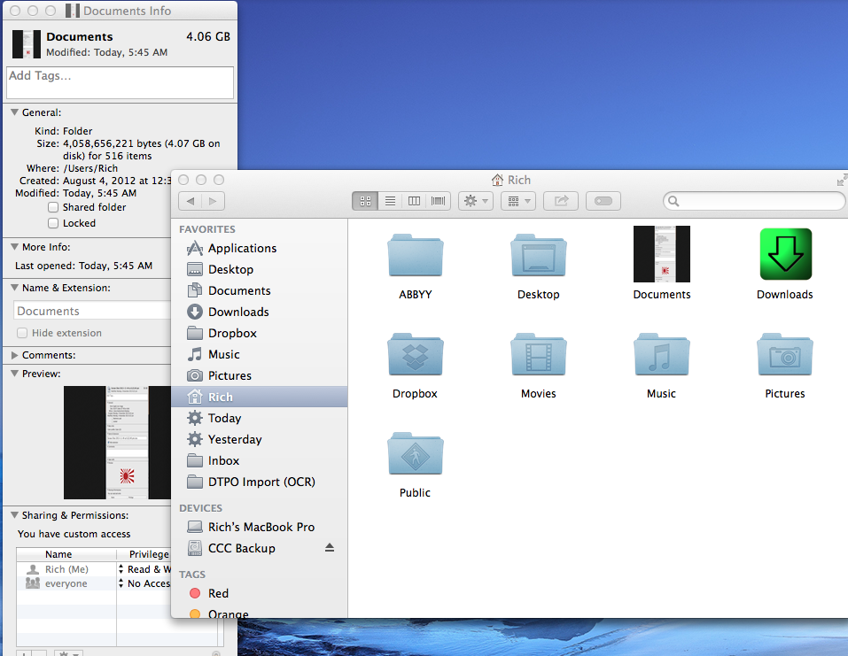

When I took a screenshot (of your screenshot) I also didn't see the image in the top corner of the Get Info panel.
However, I did get a thumbnail image on my desktop.
If I then opened this image in preview, cmd-A to select, cmd-C to copy, and then went to the Get Info panel of the app or folder whose icon I want to change and highlighted the icon in the top left corner and cmd-V it worked.
