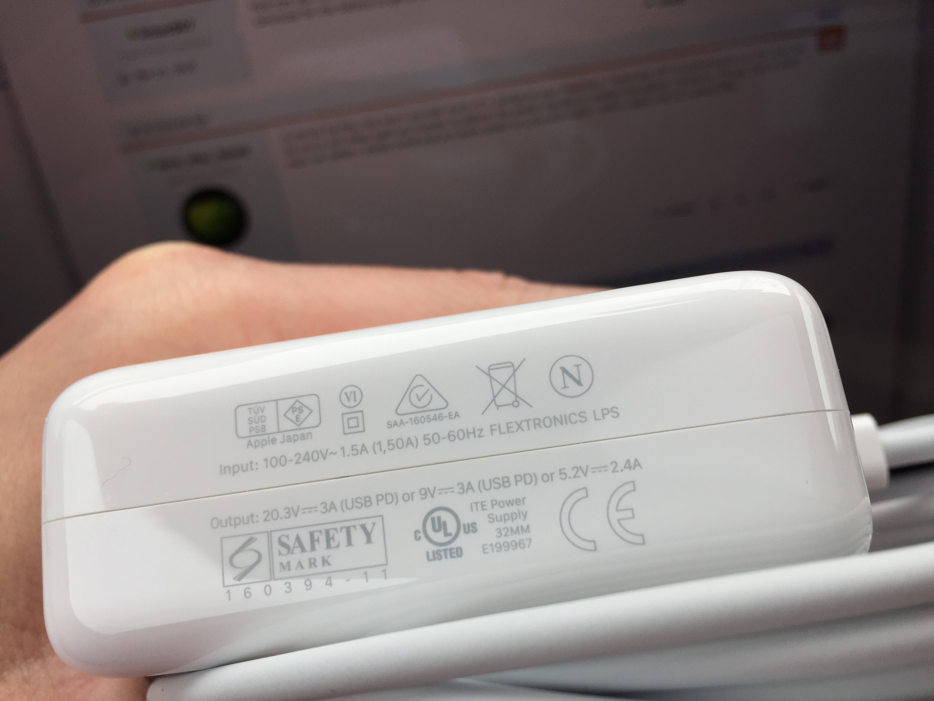

I have ruined the battery on a rMBP 13" laptop in the past using an inverter while on the road before I knew better. The power coming out of those things is not good unless it is a Pure Sine Wave inverter.
So now, I see Belkin has a USB-PD Certified USB-C Car Charger.
  • Supports 5V and 9V USB-PD up to 3A, total 27W output
http://www.theverge.com/circuitbreaker/2016/6/8/11886506/belkin-usb-c-car-charger-power-delivery
http://www.prnewswire.com/news-rele...ger--cable-with-power-delivery-300281277.html
How safe is it for my MBP to use to charge it over USB-C?
My laptop uses the 61W wall charger.
https://support.apple.com/en-us/HT204360
If this car charger is not good, which one would you recommend as a power solution while on the road?

It should be fine, but won't provide much of a charge to your machine. I think the 13" is wanting around 20v and 3A. So you'd still likely want an inverter to deliver the power needed to charge the laptop. However, I'd say that'd drain your car battery pretty quick and put extra strain on your alternator, which might not be a good idea.

You are right @New_Mac_Smell (love the Apple brand new smell btw), the supplied Apple charger outputs 20.3V and 3A.
This Belkin charger only outputs 9V USB-PD up to 3A, total 27W output.
