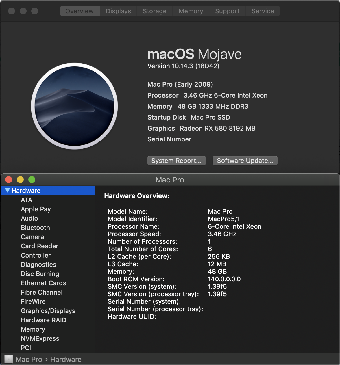

Correct, the current BootROM from Mojave is 140.0.0.0.0, which is newer than 0085.B00.
And that 5GT/s is at firmware level, will work in all OS (macOS, Windows, Linux...)

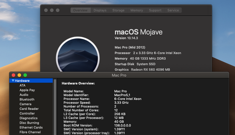

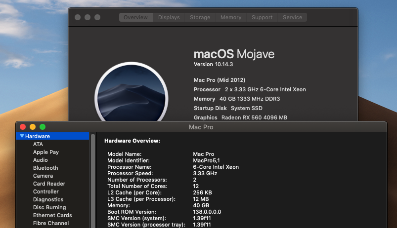

Actually the current BootROM is still 138.0.0.0.0
