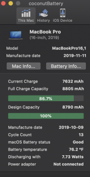

This is my results. Still monitoring the battery, cause Mac lives about 5 hours light usage after 1 week. Don't think that this is normal. Will wait one more week and if it stay the same will return it or exchange it.

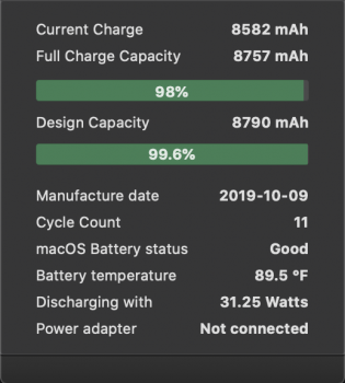

Thanks to everyone for their fast replies. My MacBook Pro has a build date of 11/11 and the battery was made on 10/9. Out of the box the battery was showing at 100% and 7900 for current charge and design capacity at 8790. After 20 minutes on the charger the battery gradually moved up to 8750. Then I unplugged the charger and turned the brightness down to 50% and eventually the current charge move up to 8853. Wonder if this is normal for a new battery?
I have seen this happen. That’s why I only take a reading at full charge - when it stops charging which can be a long time after it hits 100%.
I just noticed you have 11 battery cycles on your machine already so I went and checked mine on my 2018 MBP that I got almost exactly a year ago and it has 14. Definitely different levels of usage between us. Mine will probably go up considerably when I give it to my wife when my 16" arrives on Wednesday.
Interesting my battery behavior is very similar to yours Nikita. Both our batteries were made the same day by the same manufacture. I have yet to be able show a full charge capacity number above the design capacity when plugged in. Only way to accomplish this is to turn down the brightness level when unplugged.

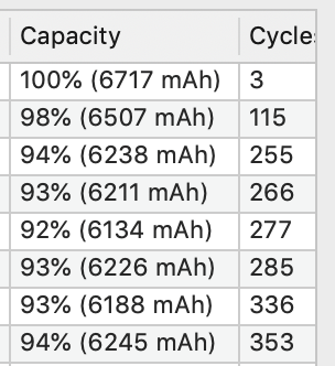

These numbers will change over time without too much pattern other than a gradual downwards trend. There's nothing wrong with your battery. Here's the history for my older machine. You can see it bounce near the end for pretty much no reason and the current capacity is higher than what it had 100 cycles ago.
Generally you'll see peak capacity after a bunch more cycles and it will start to decrease from there.

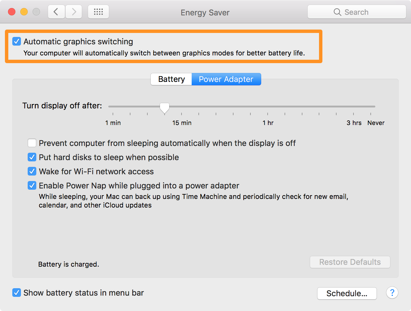

Check this option. For unknown reasons mine wasn't checked. Now the battery life is way batter than before.

Discharge all the way + charge all the way to calibrate; works for most batteries. Battery capacity estimation isn't a very exact science. Same laptop as in my screenshot above, now one cycle later, the capacity is "down" almost 100 mAh.
