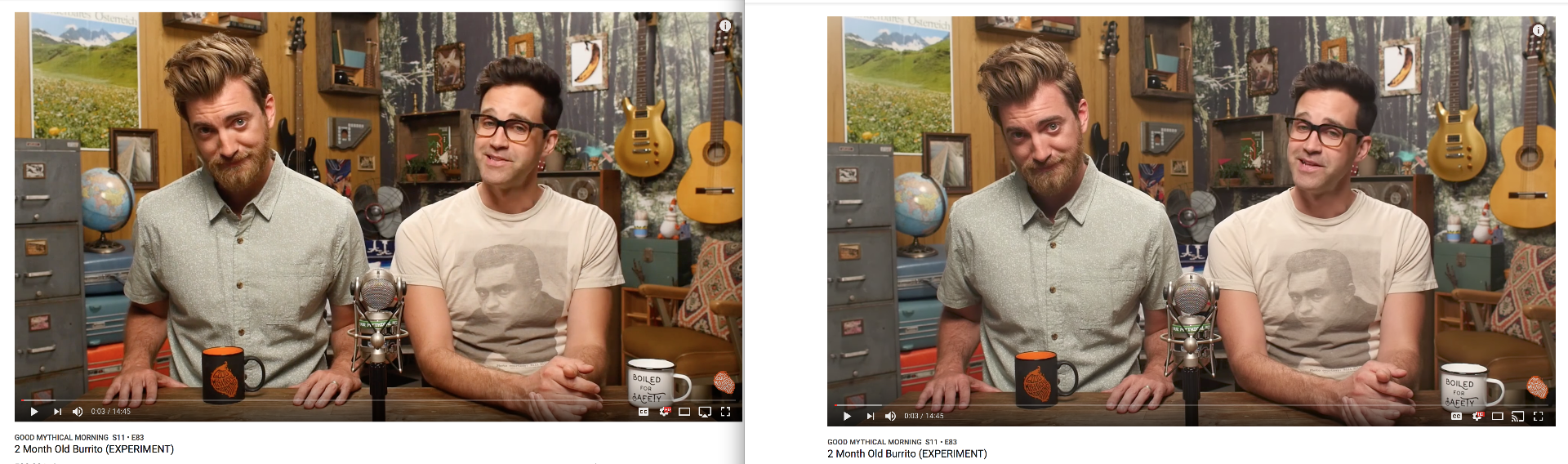

Here's the problem: I'm using the GTX 1080 with the most current Webdriver, and in Google Chrome, videos are shown with the incorrect gamma. Shadows appear brighter than they should. This happens with all the video sites that I've tested (YouTube, Facebook, Vimeo, my Plex media server).
I ONLY have this issue in Google Chrome. I don't have the problem in Safari. (But I need to use Chrome for my work, because Safari doesn't display 4K FB videos, nor does it display 4K60 or 8K YouTube videos). So in short, I'm stuck with this issue, and it's impeding my work.
Here are some examples. Left image is Safari, right image is Chrome. You'll notice that the problem is more noticeable with darker videos (such as the Blade Runner 2049 trailer). But it's still visible (and annoying) with brighter videos.
It also may be important to note that I ONLY have this problem with videos in Google Chrome. Still images and text all seem to be fine. I also do not have this issue on my MacBook Pro or in Windows 10. Only on my desktop in macOS Sierra.
Disabling hardware acceleration in Chrome fixes the issue; however, I need hardware acceleration to view 4K and 8K videos, so that's not a proper solution.

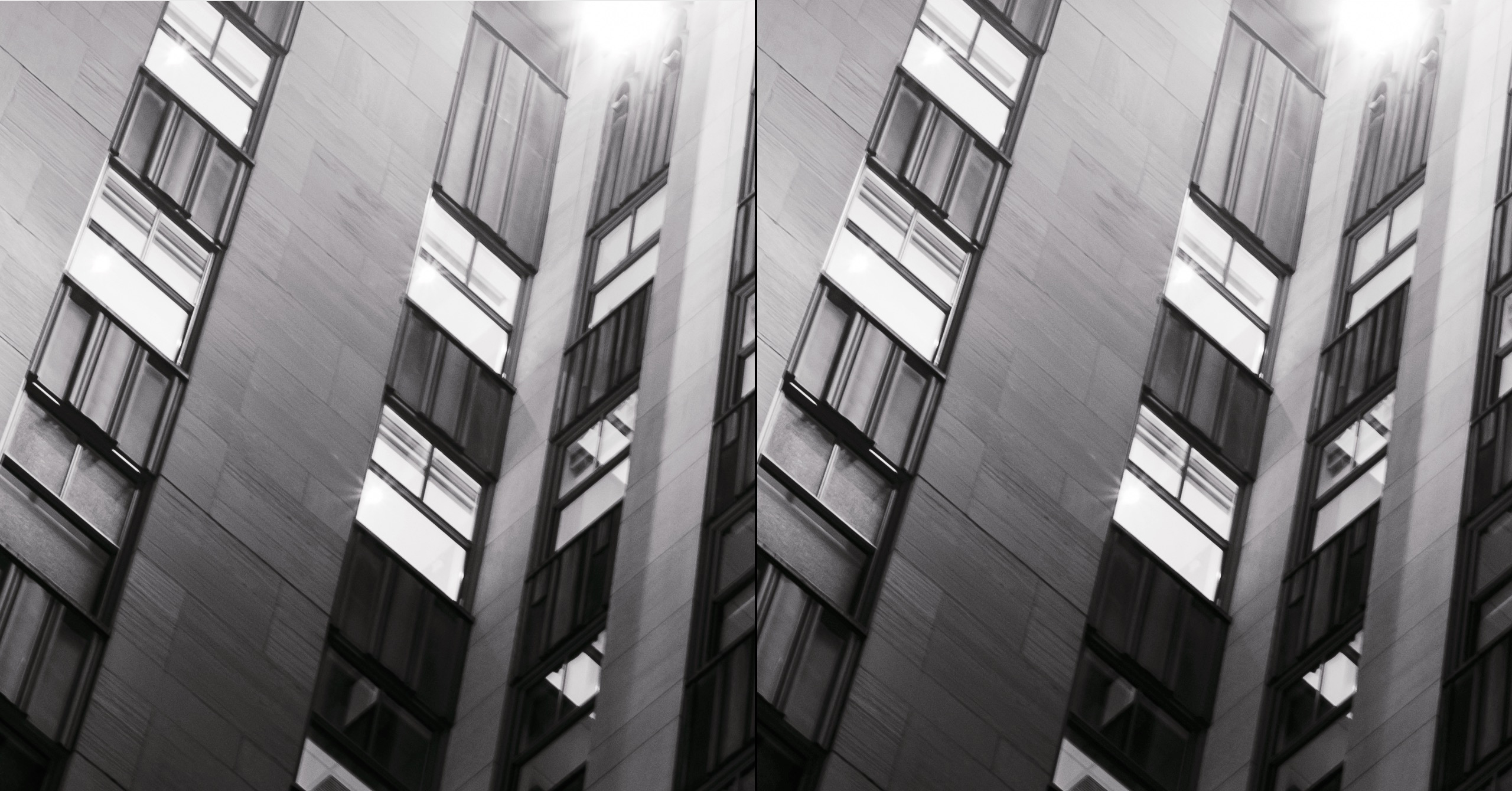

I am an amateur photographer and when you look pictures on flickr or check your own jpg exports in chrome they look like complete ****.
For some reason the chrome engine resets horizon lines, de-sharpen your pictures and changes contrast. It's probably the same with video content.

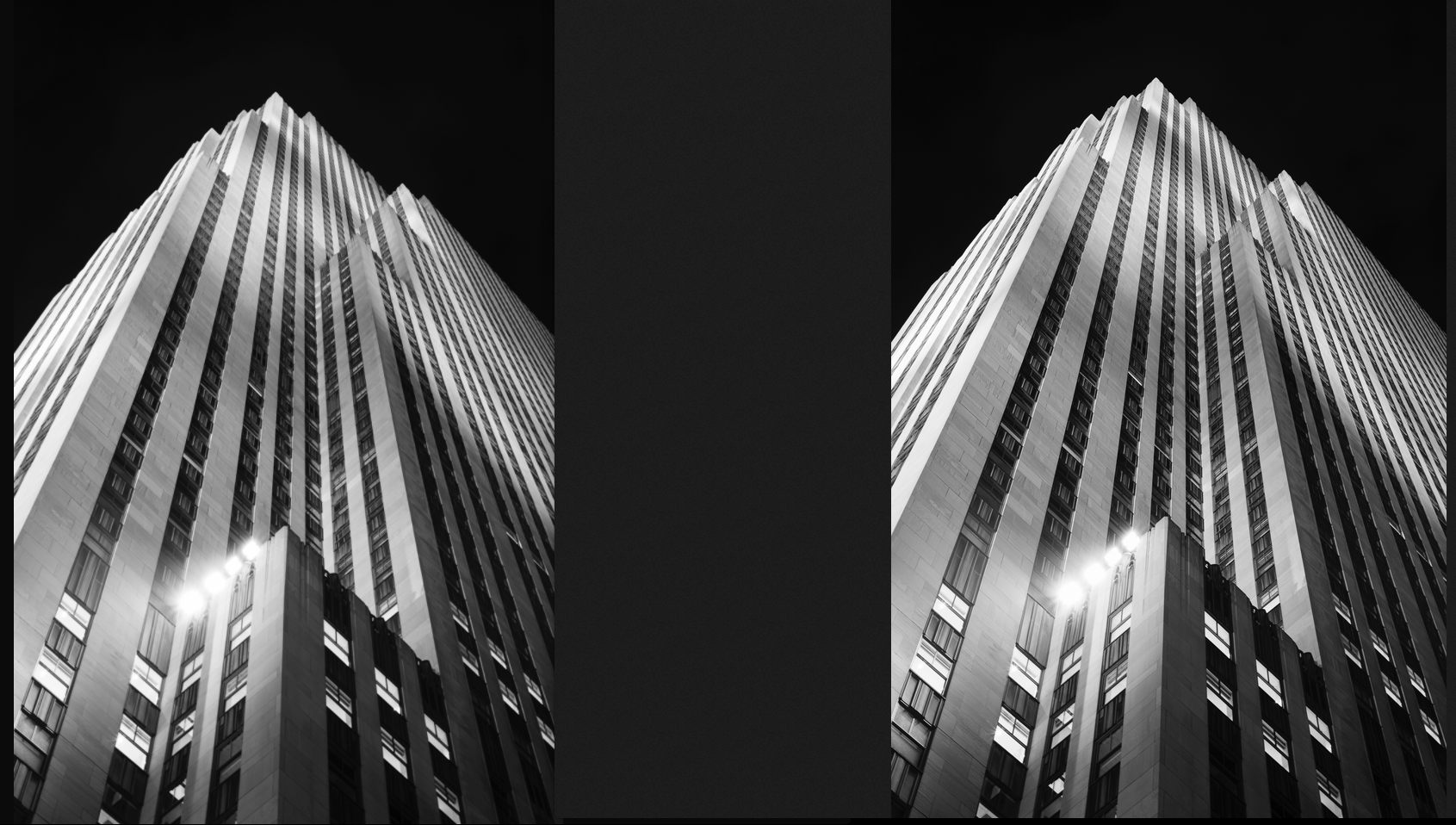

Look at this B&W picture of Rockefeller Center, left is chrome, right firefox. In chrome it's completely unsharp and slightly washed out. It's the same jpeg ... but chrome rendering engines are ****.
EDIT: Just opened this thread in Chrome and it's even worse ...

On macOS the photo you provided has the same issues in chrome vs firefox: Unsharp edges, horizon partially reset and attenuated contrast. The difference is shocking.
6 MB jpeg: https://pixady.com/image/rqs/
For reference, this photo is not 100% sharp but the difference on macOS in chrome and firefox is just crazy.
On macOS the photo you provided have the same issues in chrome vs firefox: Unsharp edges, horizon partially reset and attenuated contrast. The difference is shocking.

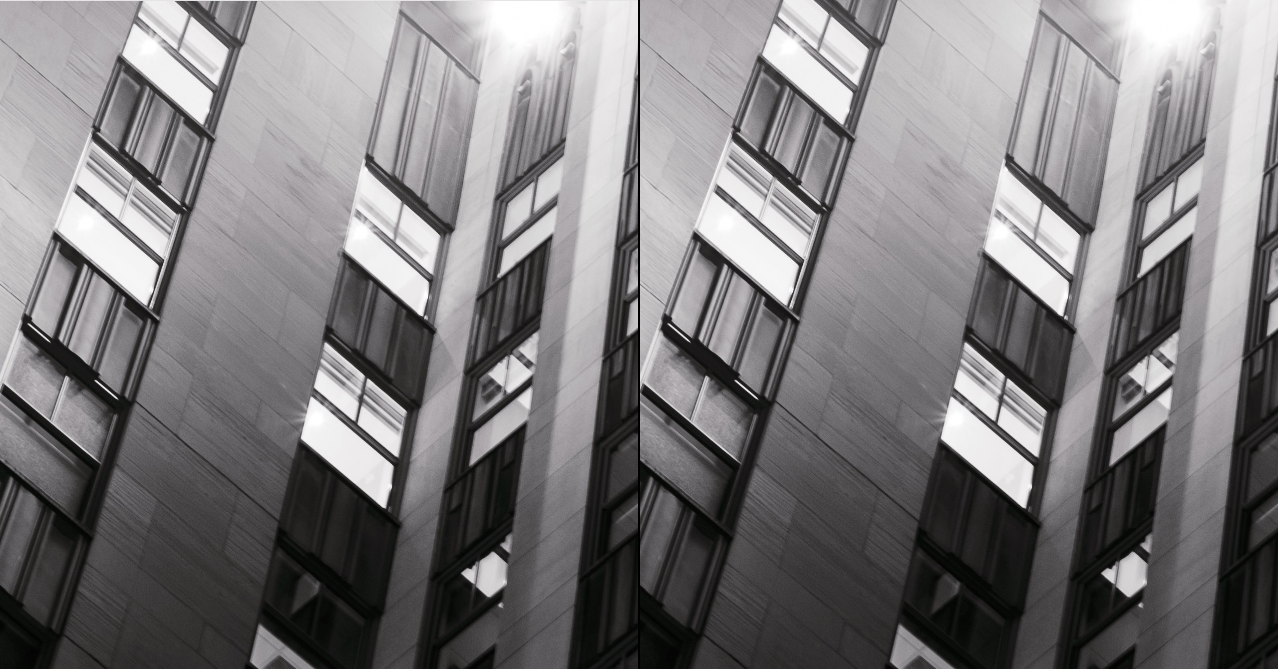

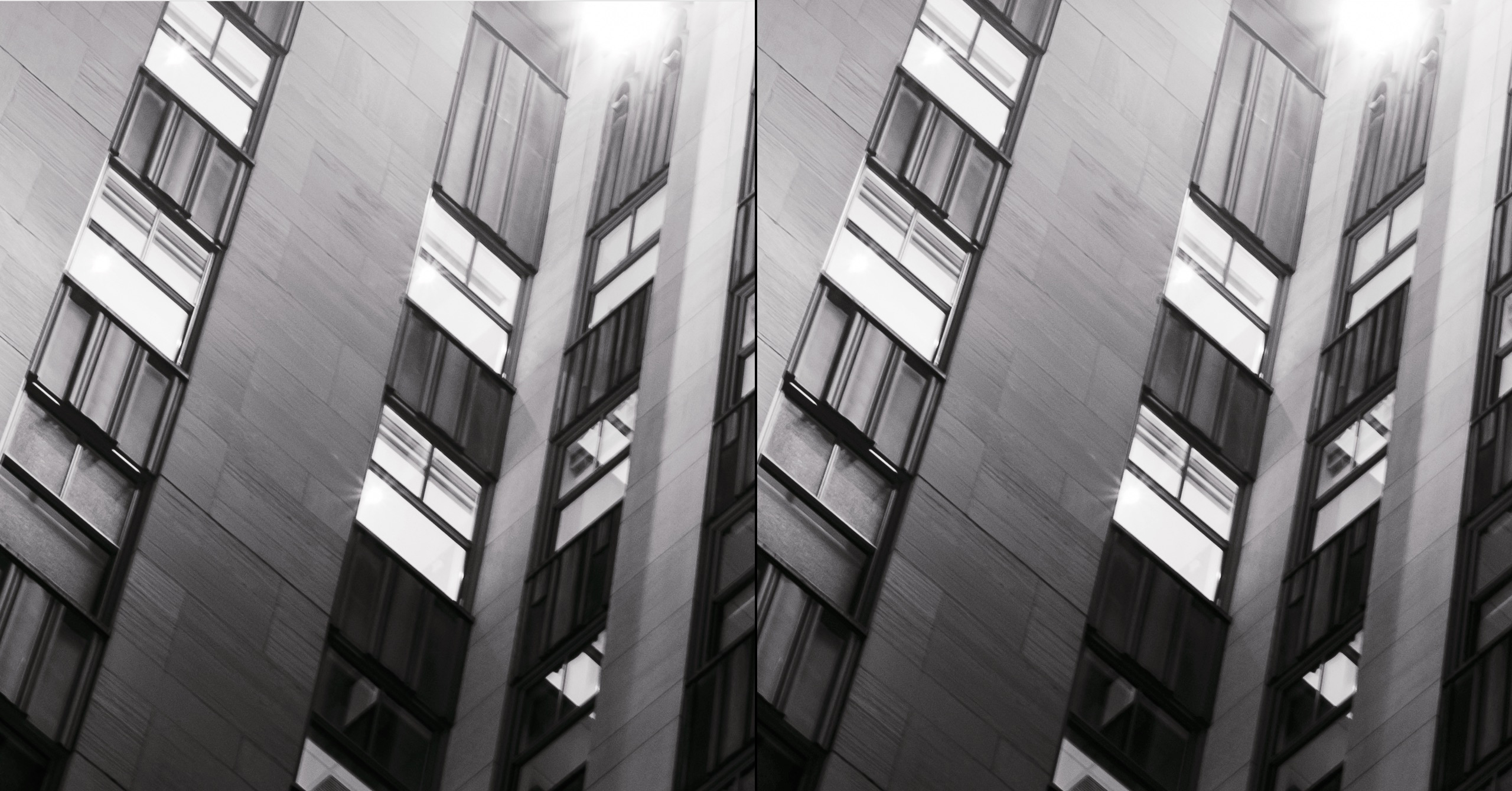

It looks like the difference is coming from the "zoom". On my cMP (as per my signature). I can clearly see the difference between Firefox and Chrome ONLY when the picture is resized to fit the screen. If I enlarge the picture to 100% (native resolution), I really can't tell the difference (may be because the picture is not 100% sharp from the beginning).
Can you tell which side is Chrome, and which side is Firefox?
I can tell chrome is left because the crop angle is not right. The change in contrast is less obvious.
