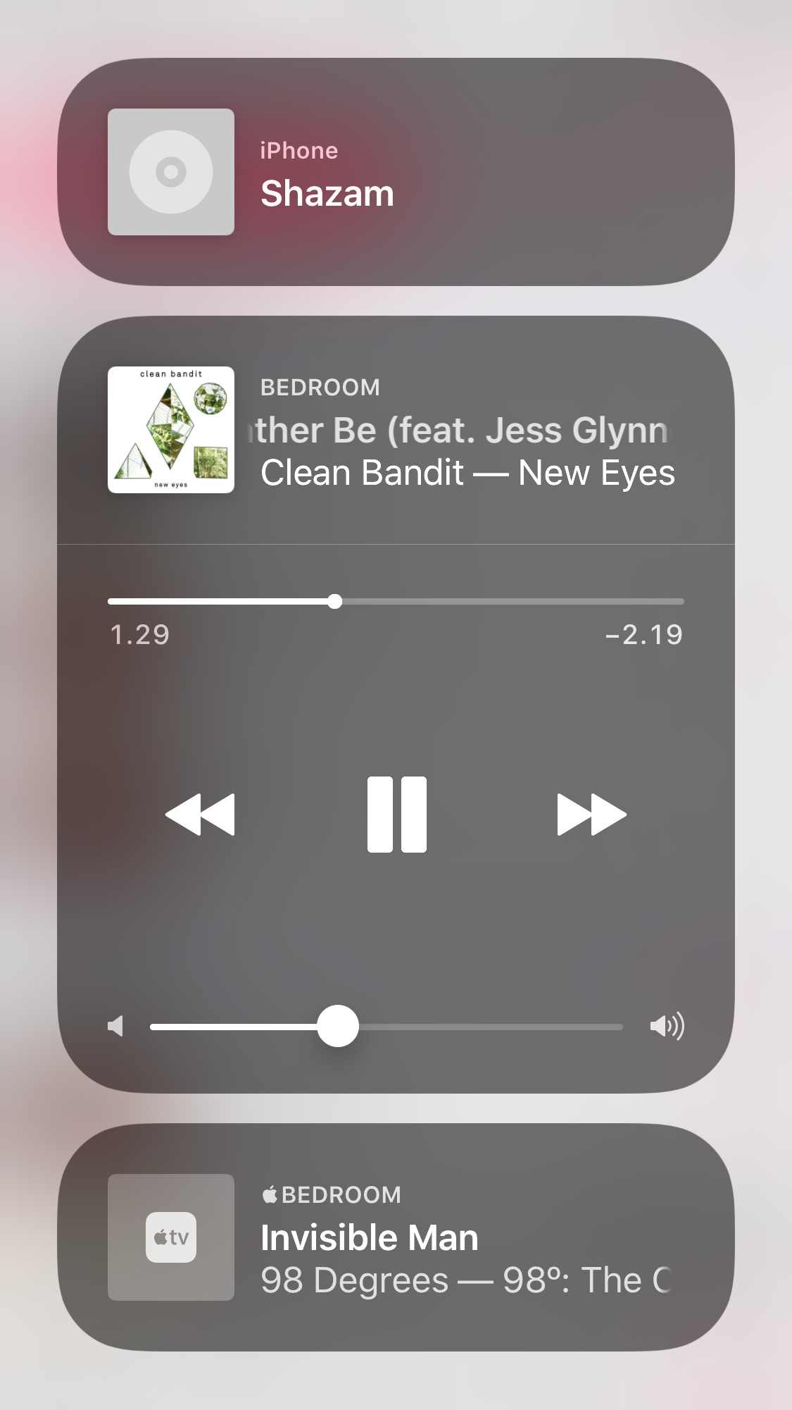

I apologize for the correction I made at the beginning. Now it is possible to change the device to control (HomePod or Apple TV) from within the Music app clicking on the red triangle.
I'd like to make a correction to my previous post. You can actually control and browse the Music played from your Apple TV, and HomePod in this regard. Please be notified that this only works from Apple Music. If you have Spotify or anything else, you can stick to Airplay to your Apple TV. Not as good to be honest because it drains up your iPhone battery real good.
You just need an iOS device for this, connected to the same WiFi network on all your Apple TV or HomePod. You simply need to pull up Control Center from your iPhone/iPad.

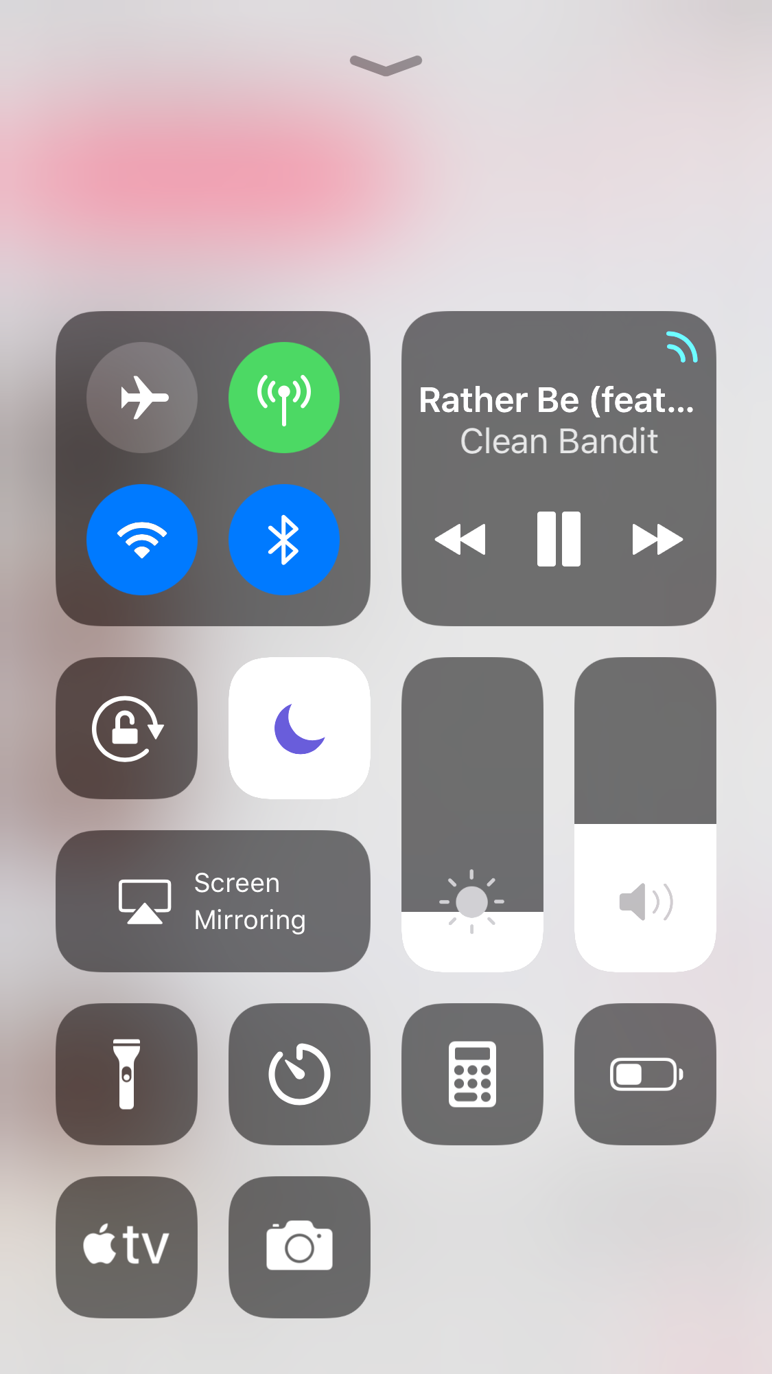

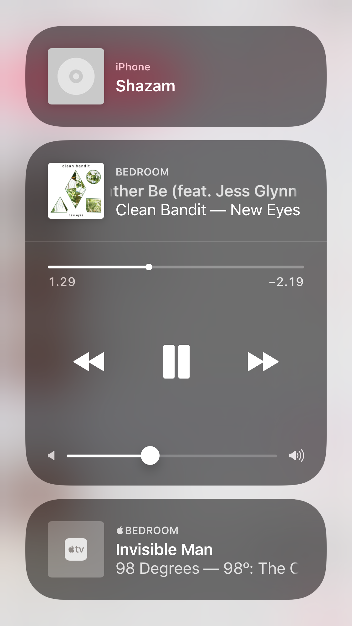

3D Touch on Music section (or tap and hold for iPad) in the Control Center and you'll get this
This individual box will control Apple Music on each device. In my case I have the top section is for local playback (iPhone music playback), then in the middle is the BEDROOM section which is a Homepod, and the bottom one is BEDROOM is my Apple TV's name. You can tap each box and it'll bring you back to Music App but it's for each respective devices. Once you're inside you will be able to control any playback for that particular device. You can choose any songs, play/pause and adjust the volume too.
So yeah, no need to turning on your TV or browse the Music interface via your Siri Remote. And let me assure you this method is NOT AIRPLAY STREAMING. It's an individual playback operation. Just again, keep in mind:
1. You need an iOS device for remote control
2. Your devices need to be connected to the same WiFi network and using the same Apple ID.
3. You need to use Apple MUSIC, and Apple MUSIC only. Other audio sources has to go through Airplay. It's  after all!
Hope this helps and I apologize for any misinformation before.

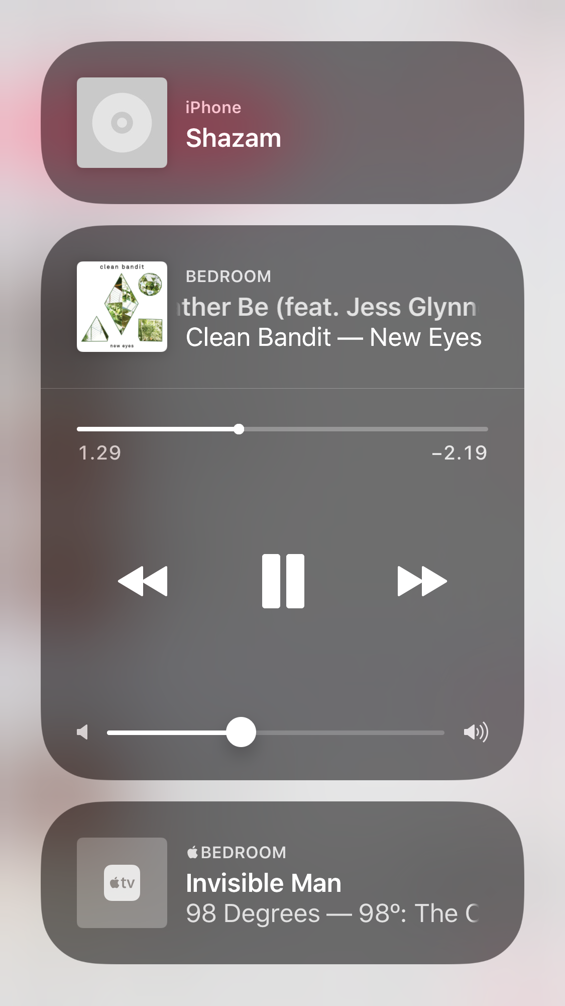

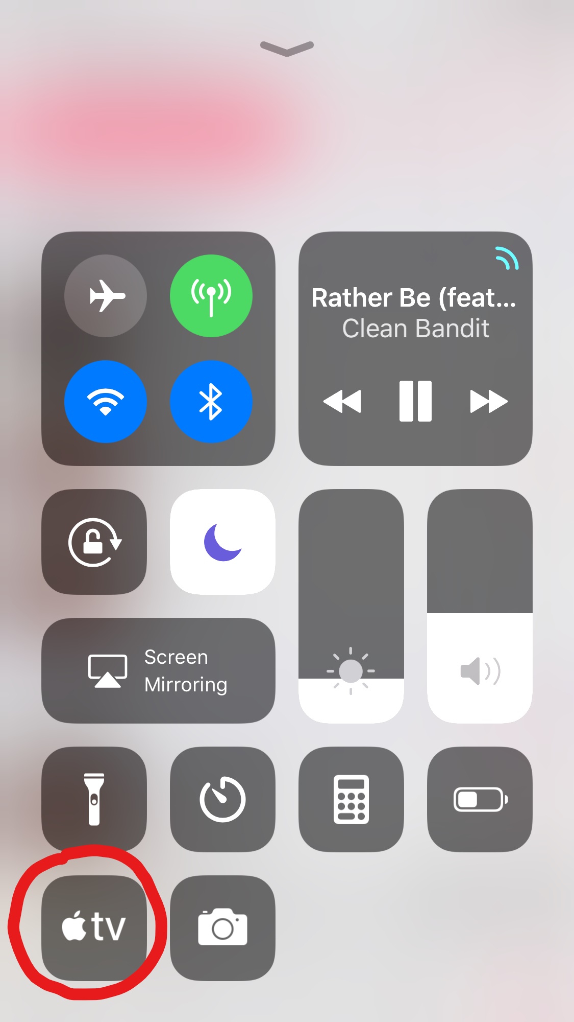

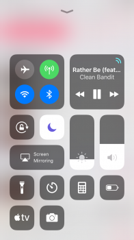

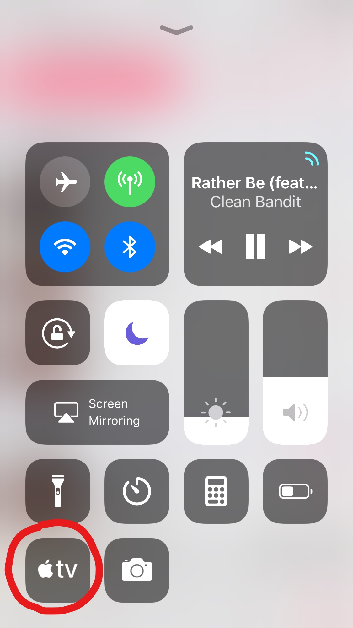

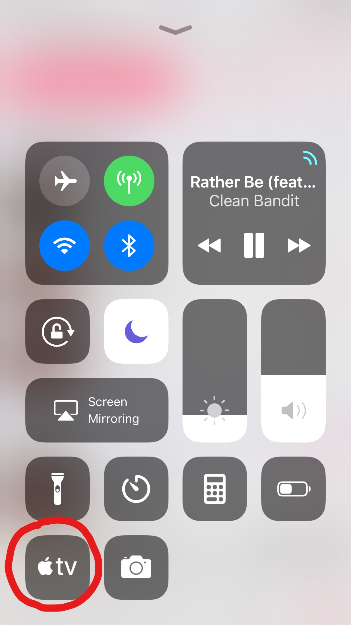

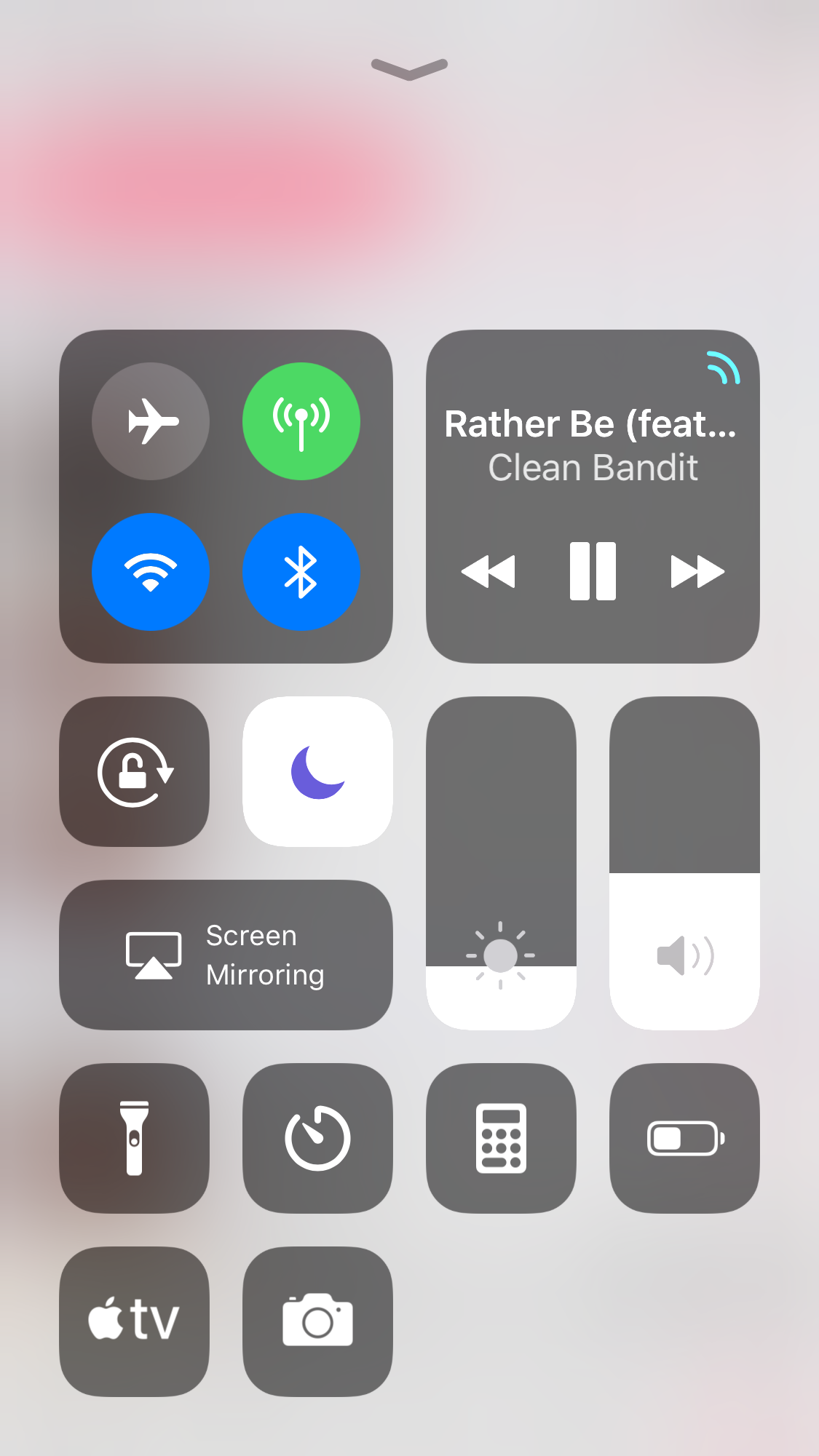

PROTIP: You can also add "Apple TV Remote" through your Control Center. Really helps with the situation when you don't have the remote with you because your iPhone works as well. Basic music control works as well too.

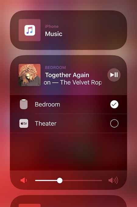

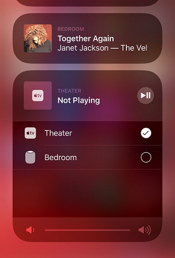

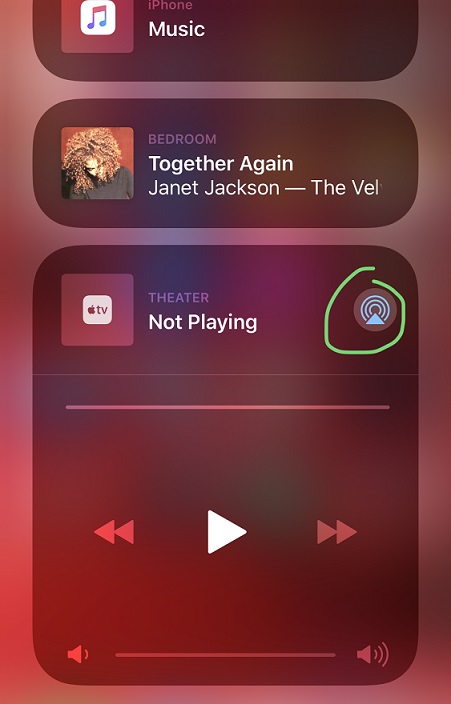

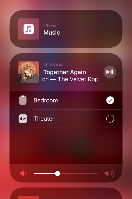

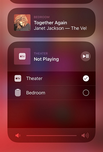

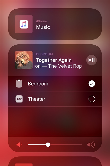

Actually, your post made me recheck and apparently you CAN choose where to throw the audio from your Apple TV. My bad for not digging a bit deeper. I rarely throw playback from Apple TV because it's connected with HDMI through my AV receiver, which is the primary audio player in the house. So I wasn't aware that it can be done only by Control Center. Again, my apology.
Here's a few screenshots:
(Please take note that in my case BEDROOM = HomePod, and THEATER = AppleTV)

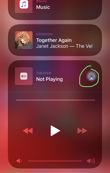

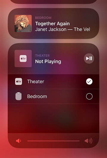

Choose Apple TV from Music Control Center, then select the "AirPlay" button as highlighted below. YES this is the same button you find on your iPhone music control.
From there you can choose where to throw the audio from Apple TV to your desired AirPlay speakers. I can't speak for Bluetooth speakers though as I don't have one here at home. You may try connecting a Bluetooth speaker to your Apple TV and see whether it appears on the list.
HomePod can also do the same thing. In short YES you may control the playback, choose any track, and AirPlay the sound anywhere inside your home network. Either from HomePod to ATV, and vise versa. AirPlay 2.0 compatible speakers also allow multi room playback. Here's a proof
Oh, and also Siri on HomePod can also help you throw the sound anywhere. Just make sure you rename your AirPlay devices accordingly. You may tell Siri to "play this on Theater Apple TV" or "play this on Kitchen HomePod" and it will throw the music accordingly.
Hope that clear things up for you.
Actually, your post made me recheck and apparently you CAN choose where to throw the sound from your Apple TV via Control Center. My bad for not digging a bit deeper. I rarely throw sound from Apple TV because it's connected with HDMI through my AV receiver, which is the primary audio player in the house. So I wasn't aware that it can be done only by Control Center. Again, my apology.
From there you can choose where to throw the sound from Apple TV to your desired AirPlay speakers. I can't speak for Bluetooth speakers though as I don't have one here at home. You may try connecting a Bluetooth Speaker to your Apple TV and see whether it appears on the list.

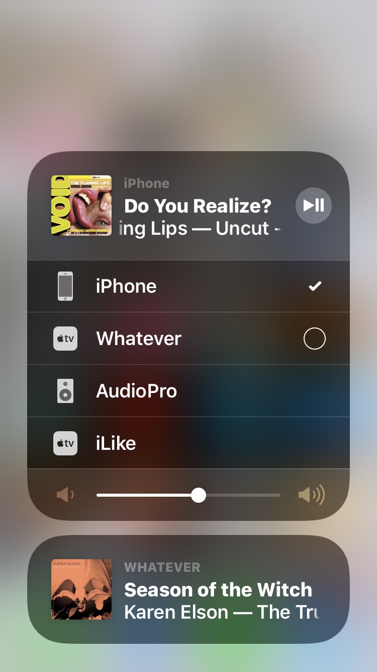

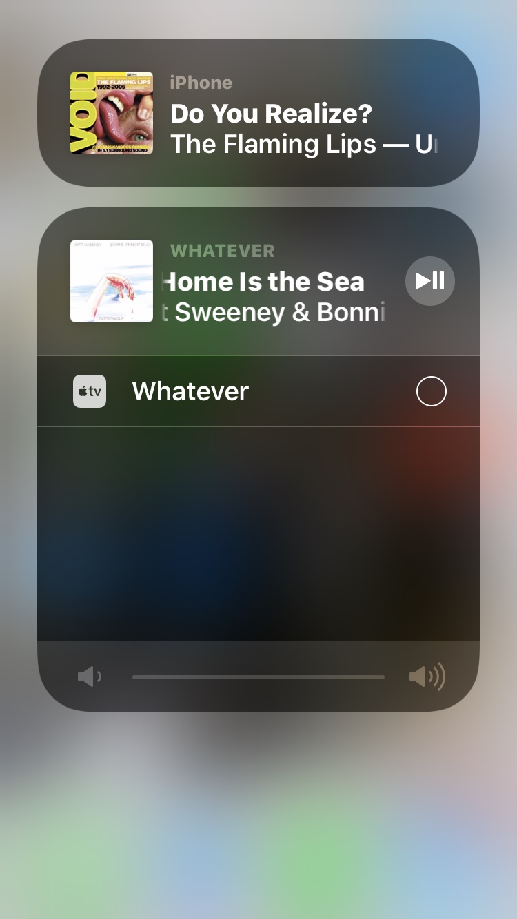

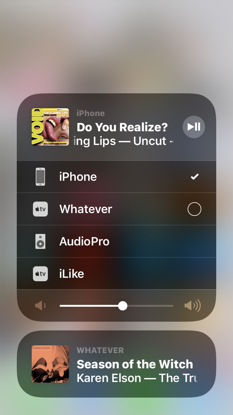

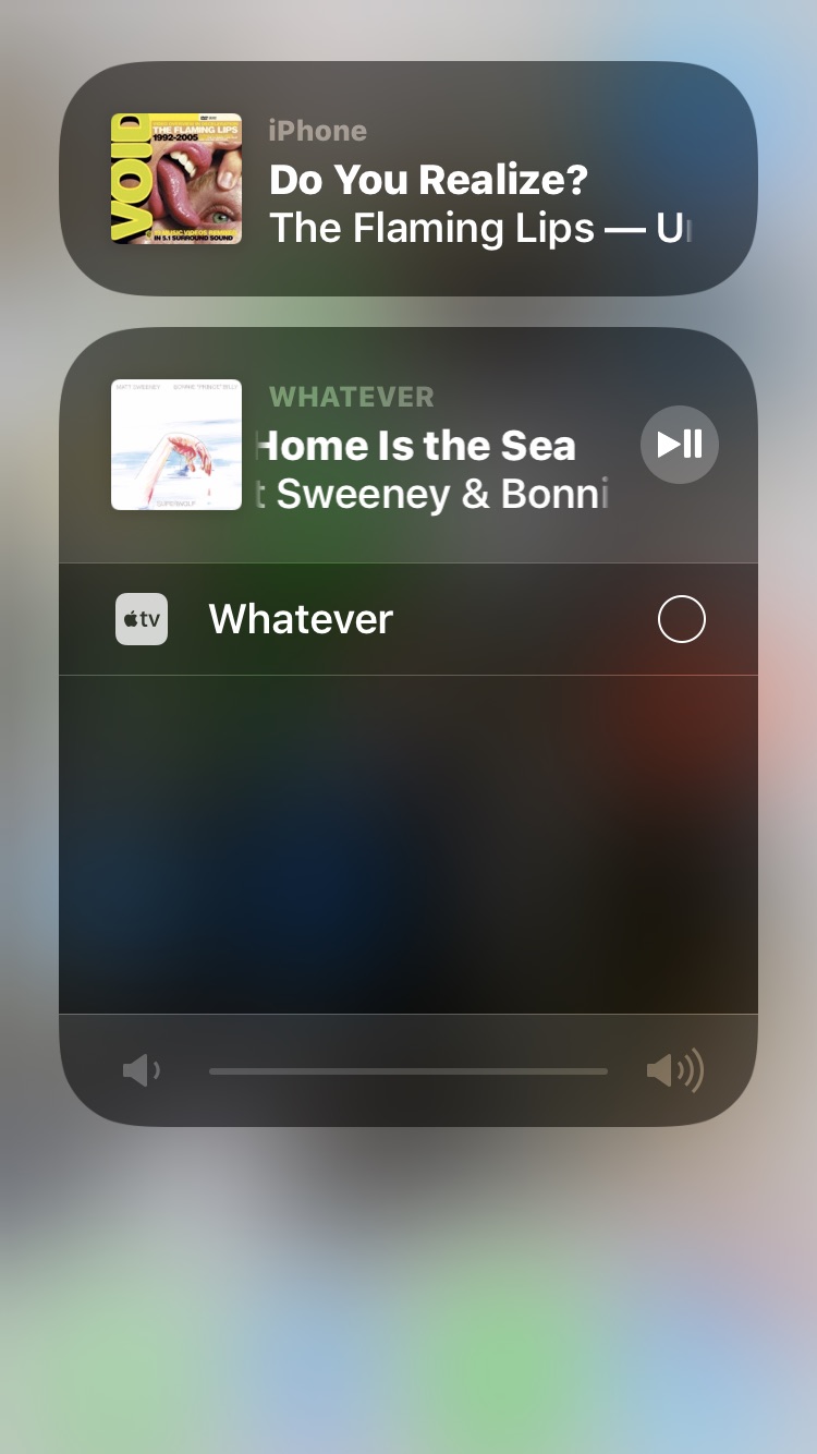

This is what I had expected. Unfortunately this does not work for me.
(TV is Whatever and iLike is the Mac that also runs a AirServer for AirPlay.)
The iPhone box in Music Control Center shows all devices
but the TV box does not:
All devices fully updated. So something IS buggy here.
Clearly the TV can see all devices, but will not show them in the Music Control Center.

Yep read the post above me. Your “AudioPro” and “iLike” aren’t AirPlay 2.0 capable because you cannot see the checkbox sign with those two. Notice how they’re different from “Whatever” apple tv on your iPhone
Airplay 2.0 speakers allow you to choose freely for multiroom playback, while your AudioPro and iLike speaker aren’t, so each can only receive single throw but not streaming anywhere else. I know it’s weird since iTunes can stream into multiple non-airplay 2.0 speakers. Maybe it’s just another reason to force you upgrade? Lol
That’s why Control Center wouldn’t let you throw audio from apple tv onto your audiopro nor emulated airserver.
Yep read the post above me. Your “AudioPro” isn’t AirPlay 2.0 yet because you cannot see the checkbox sign with that speaker, unlike “Whatever” apple tv on your iPhone
Airplay 2.0 speakers allow you to choose freely for multiroom playback, while your AudioPro speaker isnt, so it can only receive single throw but not streaming anywhere else. I know it’s weird since iTunes can stream into multiple non-airplay 2.0 speakers. Maybe it’s just another reason to force you upgrade? Lol
I suppose your “iLike” apple tv is one of the older generation? It doesnt show checkbox either and so it’s not airplay 2.0 capable
( iLike is the Mac running AirServer which is AirPlay 1. )
Really silly that you cannot chose an Airplay 1 speaker via Music Control when controlling the AppleTV, while you can chose it on the TV. i really can't se why this limitation was set. I know I cannot chose multiple speaker, but you should at least be able to chose one.
And I just found out that my newly bought well sounding speaker will not ever run AirPlay 2.

Well, at least you may now just remoting music on Apple TV from the iPhone, all without turning on the TV. It really is better than the old Remote app.
I really hope to see iTunes on the PC/Mac appears and be controlled via Control Center as well.
