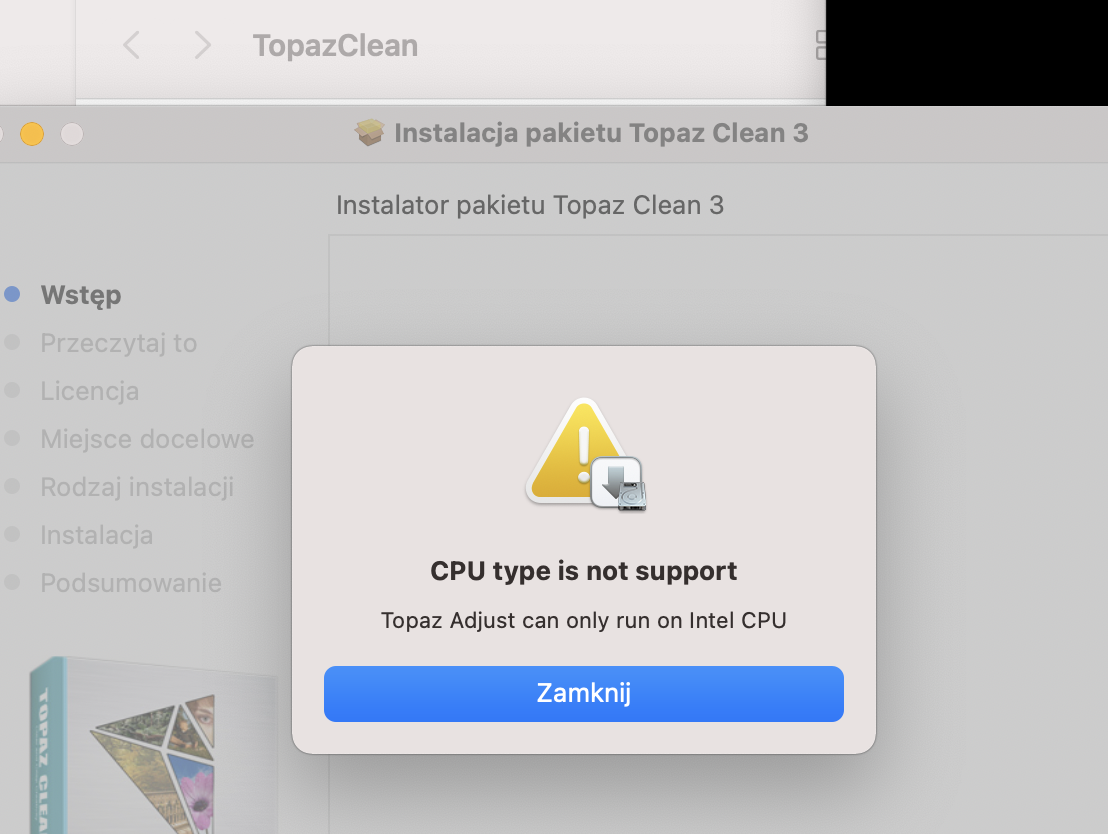

Hi everyone, is there any solution for this problem? I want to install some plugin/app on my M1 Mac but its working only on Intel CPU Macs. I already have Rosetta but its not working. Probably because its not application but a .pkg installation file. Is there any chance to run this on M1 Mac?

Rosetta can only work on plug-ins that are run out-of-process. So if the application is running a plug-in from within a process that is designated as Apple silicon and the plug-in is only Intel, it won't work. The best thing to do would be to contact the software tech support and ask.
Edit: You can also run your application (Photoshop?) using Rosetta which should allow in-process Intel plug-ins to work.

Yes you are right I already using Photoshop with Rosetta but this plugin is pretty old and must be first installed directly on the computer not on AdobeCloud etc so it won't work for me :/
You could try an app like Pacifist to force the install. This looks like the installer looks for Intel and blocks any other CPU type.

Rosetta's CPU type is VirtualApple,not Geniueintel.
Mac OS can run on Geniueintel and AuthenticAMD(using kernel patch)
So this program can only run on Geniueintel CPU
If you are using the plugin with an Intel app under Rosetta2, it should work. You cannot match CPU types in apps with its plugins. You could force the app to use Rosetta2 from Get Info.
The installer likely is checking for the CPU type and only allowing Intel. Pacifist will allow you to force the install. It's worth a try.

Hello, could you explain to me how you managed to install it?
Sure, but how do I install Topaz Clean? Because using the Pacifist tool does not open the Topaz installer.
Someone in this thread said that Pacifist did work. Sorry I can't be of more help. Pacifist should be able to open a .pkg or .mpkg file. If that isn't the type of installer then you might be out of luck.
