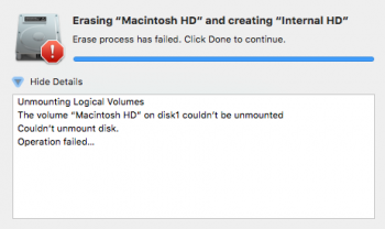

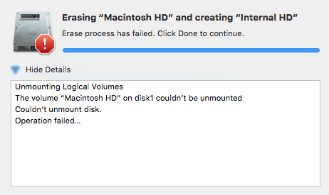

Hey guys, quick question. When I try to erase the Internal HD it gives me the following error (image attached).
Any ideas?
