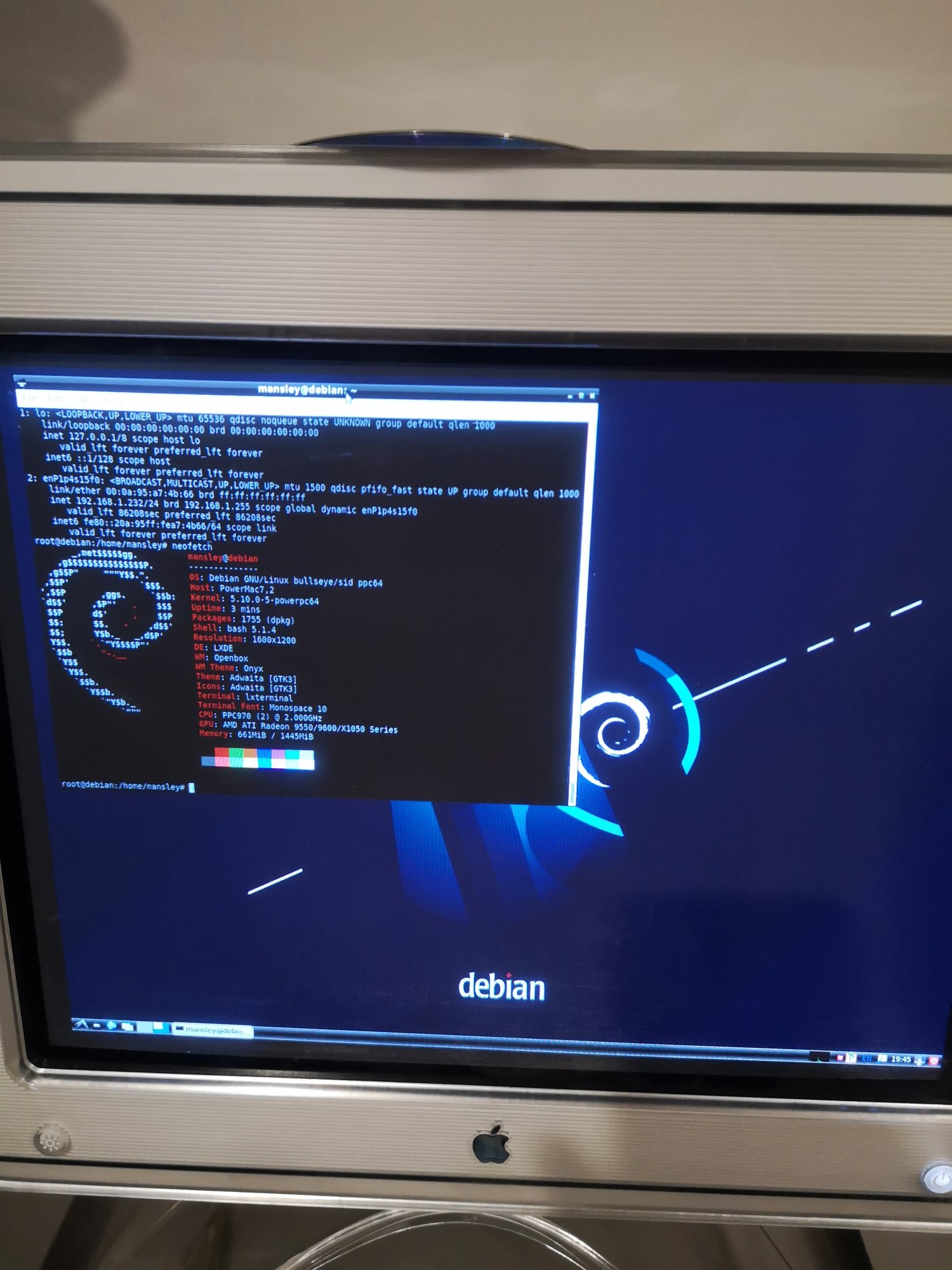

Well, that was easy. Wifi up and running, the dual monitor thing is frustrating.
I ran xrandr -q from the terminal and it shows the DVI monitor and it's possible resolutions, and it shows VGA-0 is disconnected and S video 0 is disconnected. Not sure where the S video thing is coming from since the Mac G5 doesn't have an S video out.
As much as I hate plugging in devices on a running computer, I plugged the Apple Cinema Display (ACD) after the G5 was up and running and ran the xrandr -q again, and it showed VGA-0 with a resolution of 1980x1520 (something like that). I ran an xrandr command to add the monitor and it actually showed up in the Monitor Settings with the Max resolution but it also jacked up the DVI monitors resolution so I bailed out of that and put everything back to normal.
While the DVI monitor was displaying at the larger resolution, I had to right click to get back to the Monitor Setting preference screen and a weird thing occurred. The drop down menues were much more pristine with a charcoal background instead on the plain-jane white pull downs. I'm not sure why that happened but I wouldn't mind getting those back.
More research is required to get the ACD up, by itself or in dual mode. Every attempt to launch Debian 10 with just the ACD attached resulted in a dead/black/blank screen with no responce in my attempts to get to a terminal.
Or I could go buy the "mother of all DVI monitors" and attach it, but, as always, the ACD should work.

I think I figured out that the GPU card in my G5 supports only one monitor at a time and for some reason only the DVI port works with this install. Is there a way, using the DVI Monitor to install, update, upgrade a package that would "activate" the Apple Cinema Display port. I can have both monitors plugged in and (oddly) when the ACD is plugged in along with the DVI monitor, xrandr -q sees a VGA-0 with 1680x1050 resolution but no way to "make it active" or wake it up. The DVI monitor is listed as DVI-0 which I think might be confusing the system. I'm not sure what to think of the fact that both monitors are listed in xrandr -q, that xrandr shows the ACD's max resolution correctly but the monitor is dead.
Thoughts anyone?
MM855
The card is fine, Lubuntu 16.04 and others displayed just fine on the 20” Apple Cinema Display, for some reason, it’s not working in Debian. I need to figure out if there is an install package or other software fix or adjustment needed in Debian t get it to work.
1 more dumb question. Firmware packages? If I remember correctly, for debian it is useful to install firmware-linux, firmware-linux-ffree, firmware-linux-nonfree, firmware-amd-graphics, m.b. some else.
The Debian install included instructions on doing just that, I’ll have to look at the “firmware-amd-graphics“ again. I tried to find that last package and came up empty but will try again. You’re not the only one who mentioned “firmware-amd-graphics”. Must be something to it.

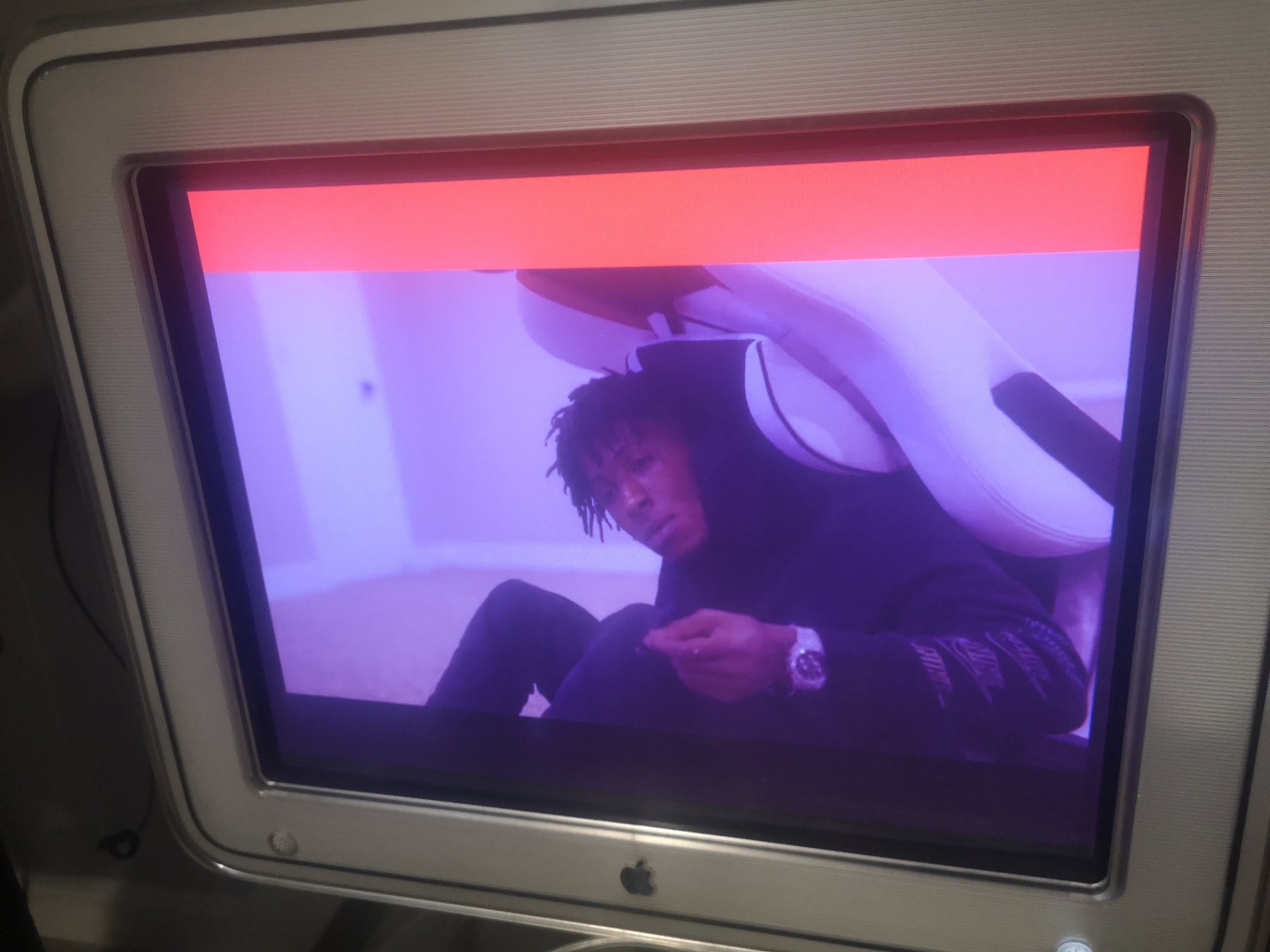

Question, I am using the sid remix with great success. However on some desktops environments, including LXDE, I get red artifacts on the screen. It is bright red and can take over an entire panel. I am assuming it has something to do with my radeon 9700 rendering. Have you seen this? For example, I cannot use gdm3/gnome because the login manager is bright red and I cannot see text and icons properly. LXDE and lightdm are the only combination I can get to work with the least amount of problems.

Here is an example of what I am seeing
My guess would be issues with hardware acceleration. It's semi broken on ppc. I don't know what boot parameters you are using, but try running it with software 2d/3d rendering. Just pass: radeon.agpmode=-1 video=1600x1200-16 to the kernel at boot and see if that helps.
