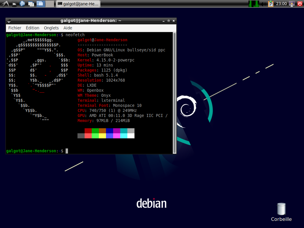

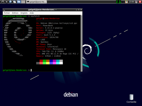

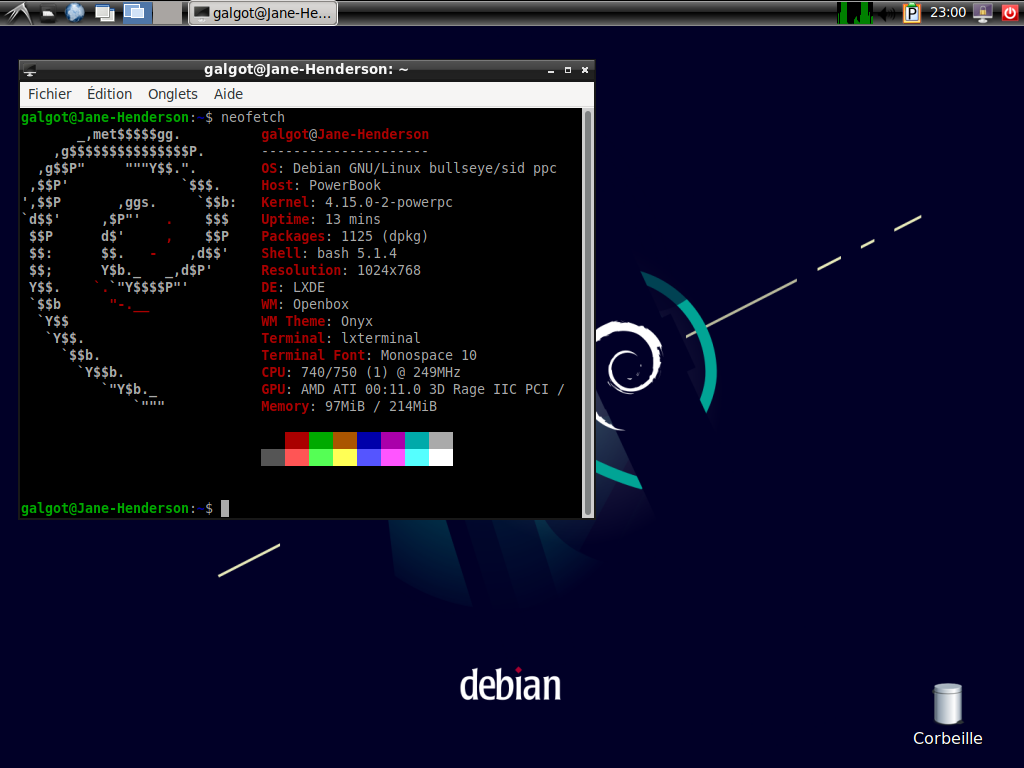

Just to report that I'm quite happy to have this running on a Wallstreet 250Ghz ,
double boot mandatory with BootX . Had difficulty copying the installed kernel files to the MacOS partition as it wouldn't show on the linux side, had to copy the Kernel files to my home directory, then remove HD and plug it to another Debian machine to retrieve the files and move it were it should on the MacOS 8.6 System Folder.
This is just after LXDE install. Not tested all yet. Will play with it and customize it with Windowmaker maybe...
Wonder if that could run of a Kanga, or even a 3400c :p

Didn't tried yet any browser. But yes , afraid it is gonna be a pain, specially with firefox. Dunno if Midori is still in the repo.
Lxde is quite snappy tho.
What surprised me is the video worked out of the box, i have another one (PDQ) running wheezy and it needed a custom xorg.conf file to work.
So far also find that the display, if not faster, works better than on a Pismo , which stops displaying some part of the screen when it's too much for it.
Nothing serious, just move a window over the area to refresh.
See nothing like that on this one.
Anyway, i'll try a browser later and report. But never intended to use it for sailing on the www high seas anyway.
