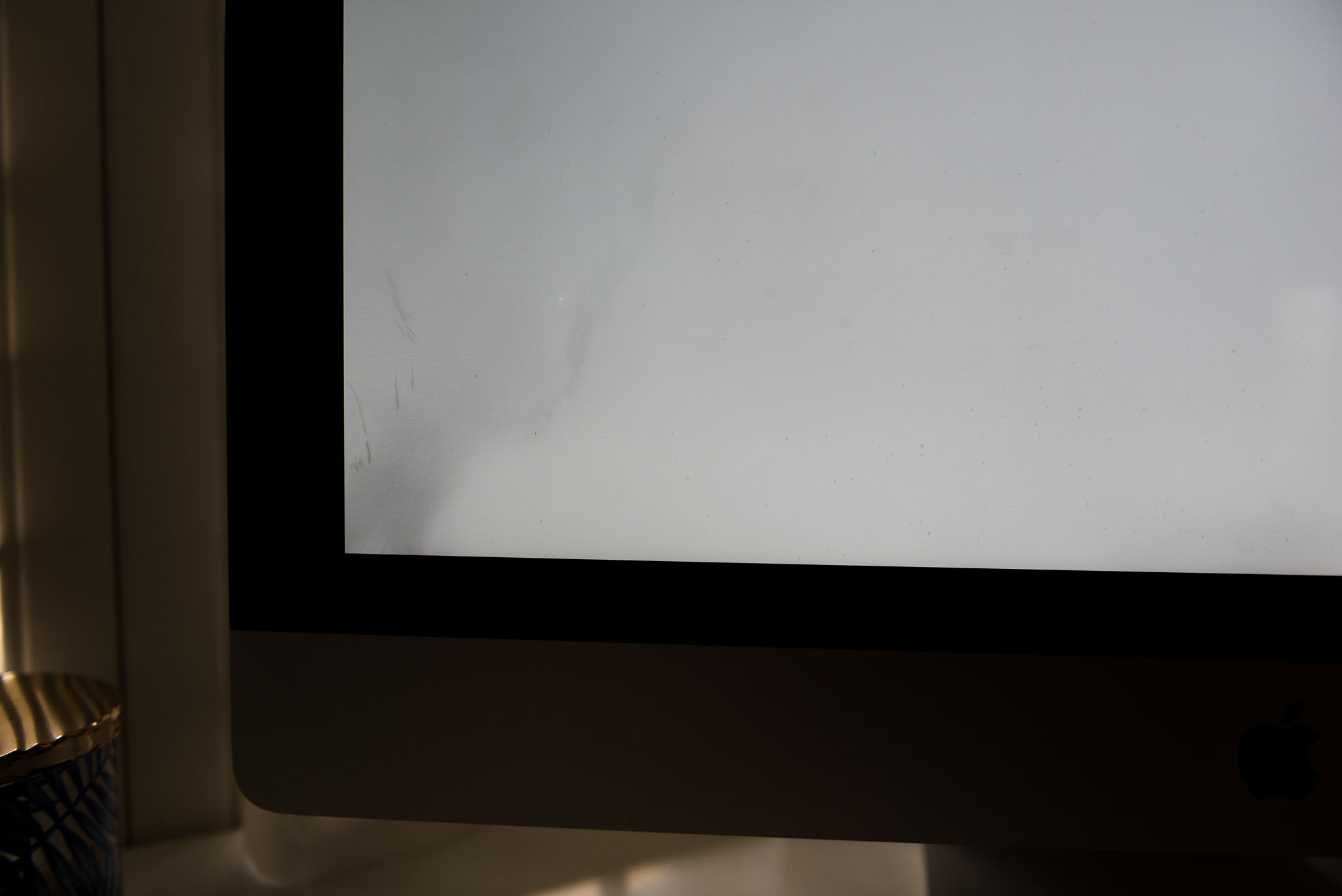

Hello,
I had a lot of questions in this topic - https://forums.macrumors.com/threads/imac-27-or-21.2122173/#post-26136334 and thankfully you guys helped me to choose better option. The thing is - I still don't know should I get 27" iMac. Does iMac still have a problem with dust in screen/under screen?
There are a lot of topic about this problem, even at Macrumors. Here you have example, what is it look like:
https://www.ifixit.com/Answers/View...+dust+in+the+screen+like+the+previous+models?
I made this poll to see if you guys and girls had to deal with this problem...

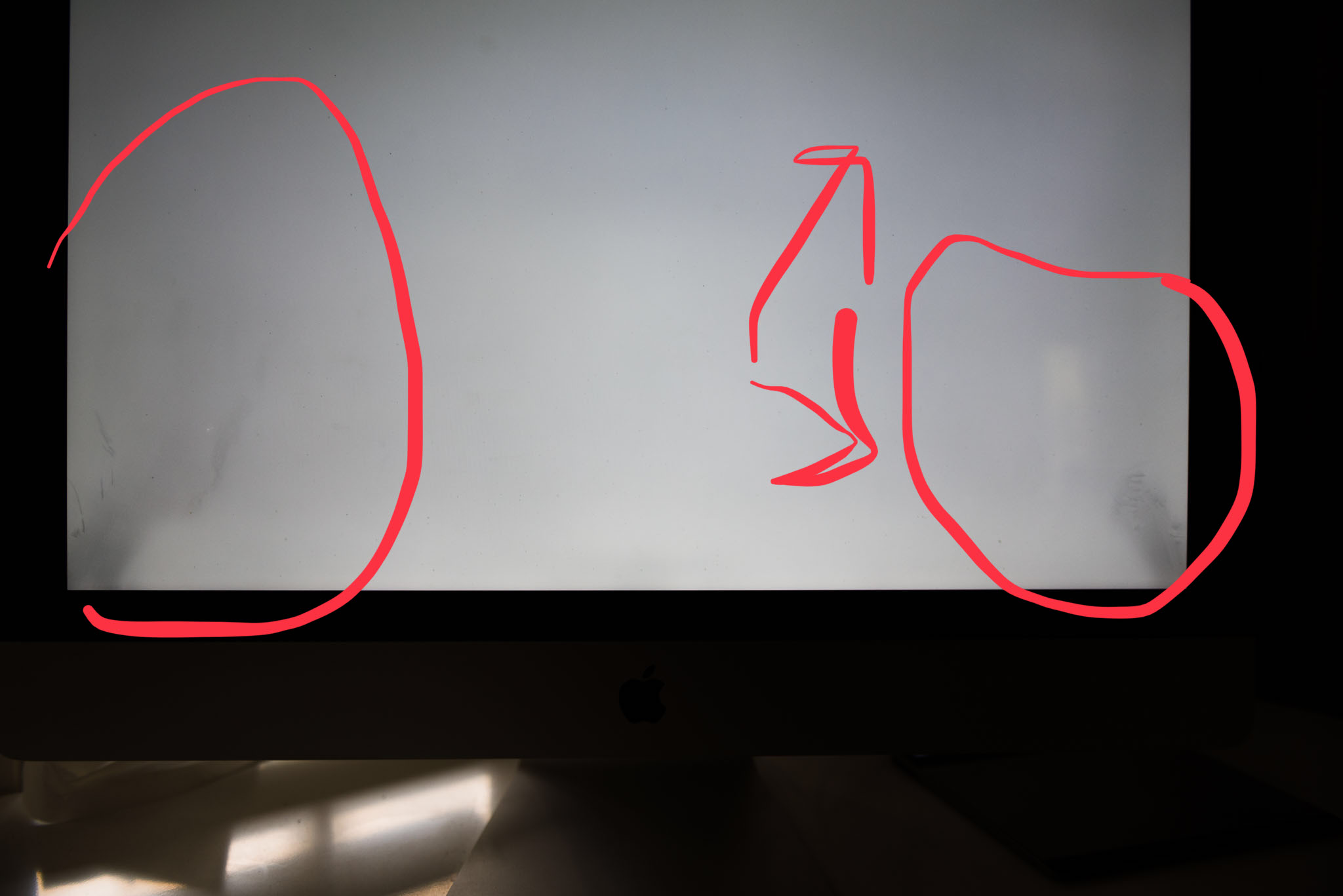

Yup, as long as I have my 2009 iMac I have this problem, and after me so many. It's one of the reasons I still haven't updated this one yet.
Any iMac release up until 2012 when Apple introduced the slimline profile has the potential to collect dust most likely around the RAM access point. If their is a large collection of dust around this area it is likely there will be a build up of dust to the interior fans as well. To clean you will need to remove the Front Glass and Display to gain access to the internals of the iMac where you can clean the fans with canned air and a fine soft brush for the stubborn areas. Here is the iFixit tutorial for removing the Display on the pre 2012 27" iMac. The tutorial is the 2011 27" iMac but it is much the same for the 2009 and 2010 models

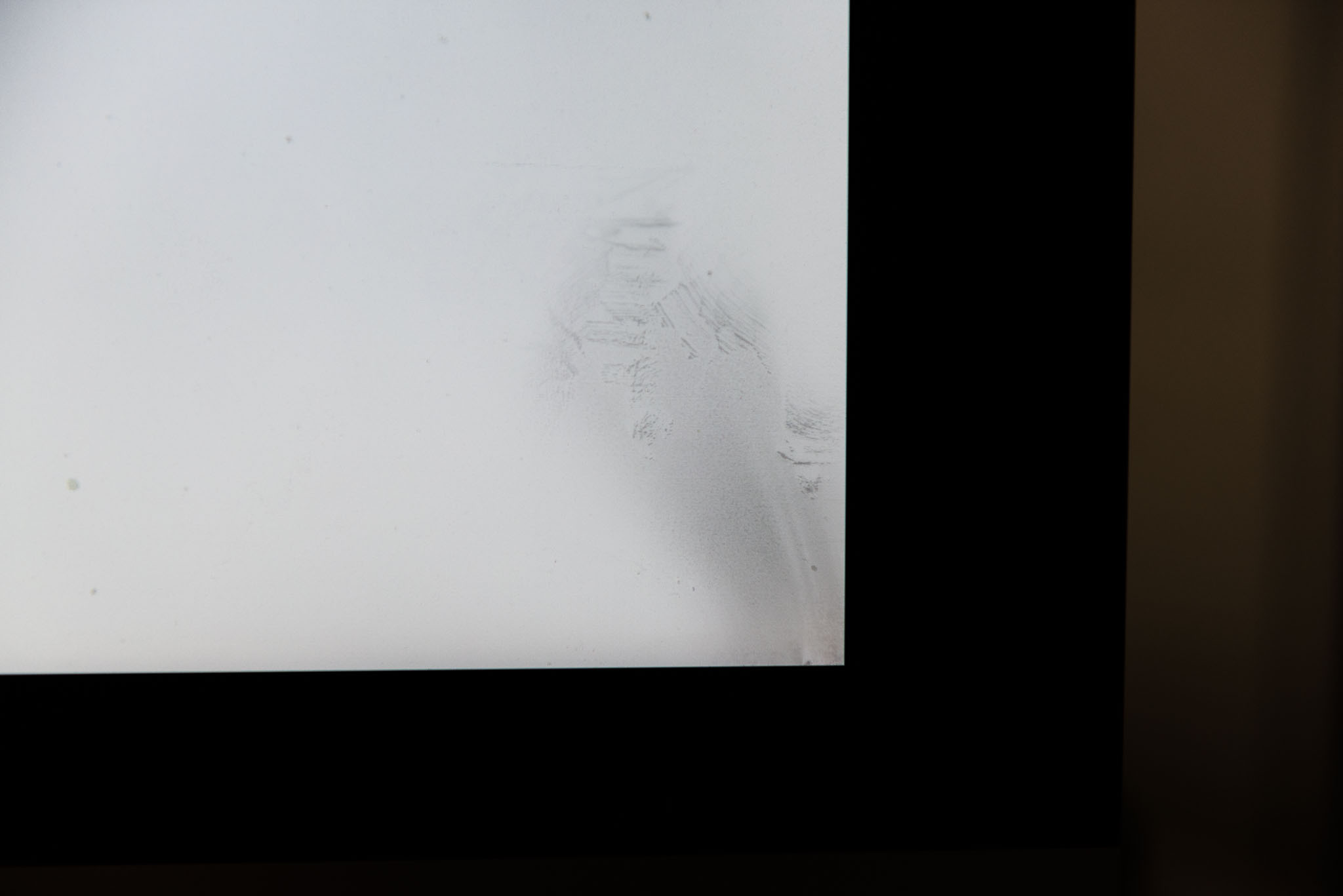

My new iMac was just under 2 years old when I started noticing the grayish/black smudges under the glass. The first Apple Store told me that it was not covered under Apple Care and basically tried to tell me it was my fault that I must have damaged it someway. The second Apple store I took the iMac to said it was under Apple Care and fixed the iMac, no questions asked. They replace the screen. My Apple Care expires April 2019 for this iMac. I'll be watching the screen very closely to see if the smudges come back before Apple Care expires. I feel it's their defect so they should fix it even if Apple Care is expired. I can smell a Class Action Lawsuit coming. 🙂

Mine is a 2014 and started getting the dust within a year or so(when I first saw it I thought I just needed to clean the screen). I brought it to the Genius Bar and they said that because it is all fused as one piece, it cant be cleaned, it has to be replaced -for $600. The implied that this is not an issue with Apple.

@Kapphoto - look at my posts by clicking on my name. In short, I had such stains after 8 months of purchase, although they were not that big. Apple authorized service center replaced the screen, only for the problem to return after about a year. I sold the iMac.
I can confirm this exact issue happened within few months to my late 2014 27-inch Retina iMac in the lower left corner. I thought only my unit was faulty and wasn't even sure this was dust due to a design flaw of Apple (not having air filters).

Newer Macs do not have a laminated screen. There's still an air gap between the glass and the display.
I ordered my late 2012 iMac right after the Apple event, got those ugly, disturbing (especially as the mac is used for graphic design work) dust smudges in corners pretty soon, I thought I could live with it but decided to send it a week before the end of warranty, a year later it started again, no more warranty, and it annoys me since then. I vacuum regularly and obsessively and have an air purifier and ionizer in my room.
