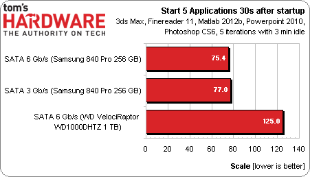

As for the SSD...you do not need to upgrade your system from SATA 2 to SATA 3. The benefit most people observe from an SSD is not from throughput (what SATA 3 improves on over SATA 2) but rather much better random read times (which SATA 3 will have little noticeable impact on).
As has been stated several times...almost any SSD is going to noticeably improve the responsiveness of your system. The primary thing you should be considering with an SSD is the size you want to buy. Other than that any SSD is going to be an improvement so don't put any more thought into it.

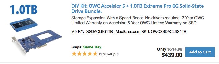

New and exciting News. I talked with a tech guy at OWC and he recommended Accelsior S + 6G 1 TB SSD It will accept there SSD. If I just put it on an adapter and into one of my HD bays it will only accept 3G. that with 32GB RAM 567.00

If you're comfortable spending that kind of money and know that it will boot your Mac then go for it. However I feel you'll be paying for something you will not ever notice. The SSDs kschendel mentioned will be more than sufficient.

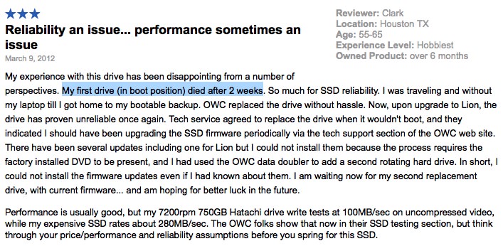

I personally won't go for OWC SSD, it's almost the worst you can go. None of any other SSD cannot run High Sierra except some OWC SSD. Doesn't sounds like really build for Mac (but they charge you for that). Some of their SSD even don't support TRIM or SMART, it's just the basic of the basic in today standard.
Also, they charge you about double on the RAM. And from this forum, I can tell their DIMM is not working better than any other brand, in fact, occasionally see someone complain their OWC RAM causing issues.
Did you really understand our recommendation?
Is there any real world difference between 3Gb/s and 6Gb/s in your case? I don't think so!
If you really want some god speed, then go for the AHCI PCIe SSD. At least you are paying for the SSD, but not the adaptor, or their brand, or their marketing... And its sequential speed is 3x faster than the OWC SSD you are looking for.
The OWC guys just asking you to overpay something that has no real world value.
The SanDisk 960SSD is just $269 on Amazon (that OWC SSD only has 960GB usable space, not really 1TB). And you want to pay $439 for virtually the same thing??? (In fact, I believe the SanDisk SSD has better quality).

Correct. What I am not sure about is whether you'll actually notice the difference. My machine has both SATA SSD (SATA 3 capable running at SATA 2 speeds, 3 gbit/sec) and NVMe SSD, which is theoretically faster than SATA 3 although I don't have one of the really high end SSD's in there. I can tell the difference when I'm running a many-minutes-long benchmark, but not in interactive use.
I have no objection to people spending their money for peace of mind, or because they are reasonably sure that their workloads (which WILL differ from mine) will benefit. If you're doing a lot of long sequential reads/writes, as might happen if you are streaming videos or something, the SATA 3 adapter might be worth it. Maybe.
