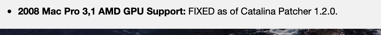

Yes, I know, but in dosdude's Catalina Patcher you can see this thing :
So I imagined this GPU could work in my Mac Pro... In all cases, it doesn't respond to my question : why the GPU doesn't start...

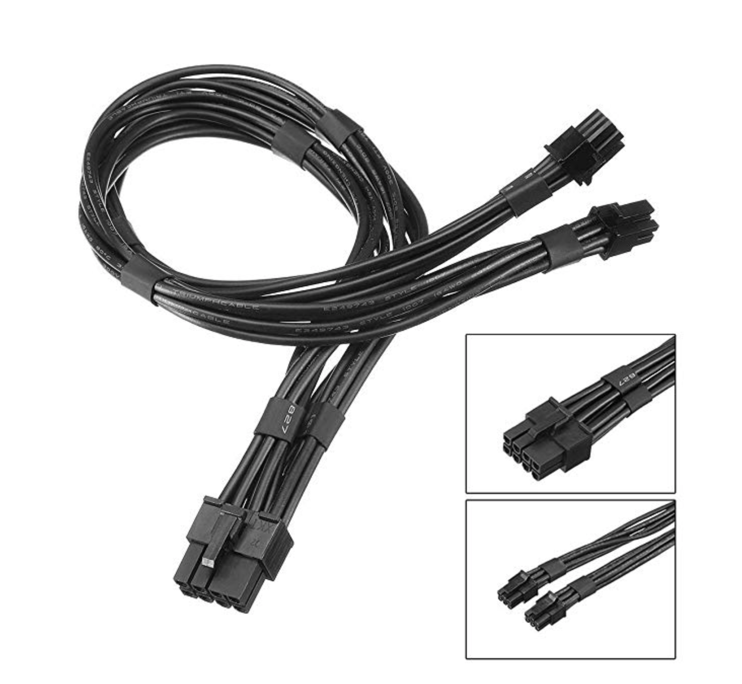

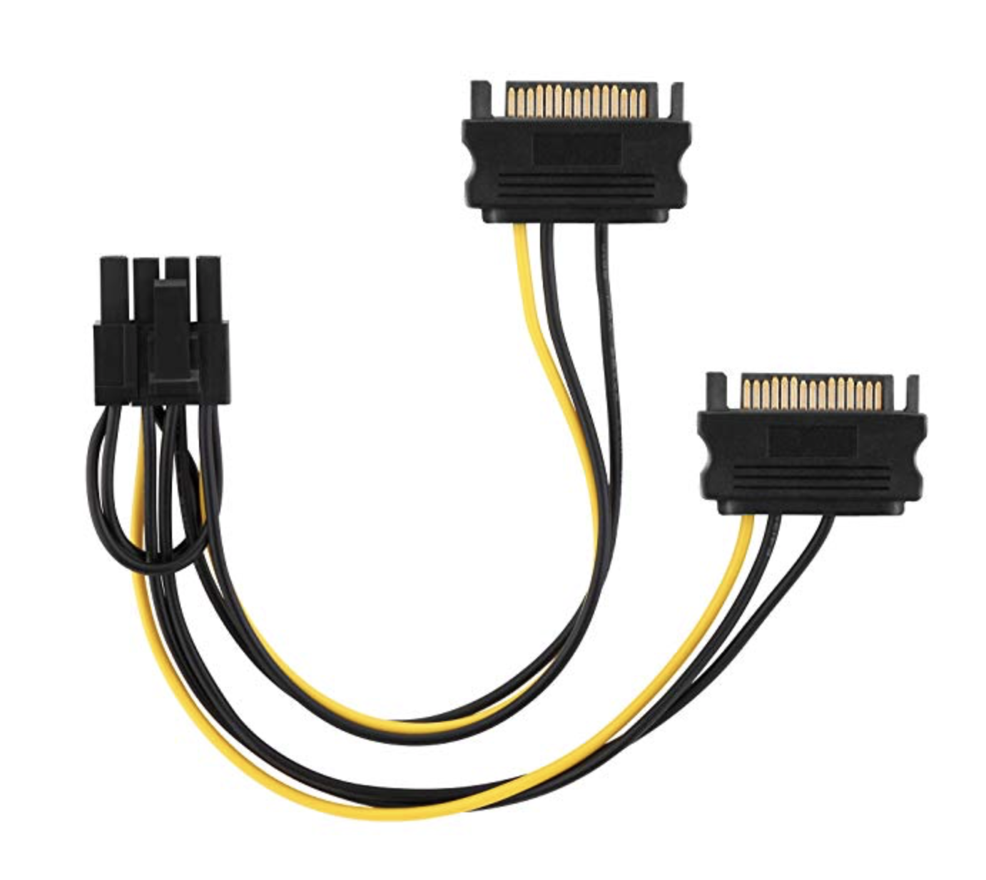

My RX590 has 2x8-pin ports and I'm connecting it with 2x6-pin to 1x8-pin tanks to this cable :

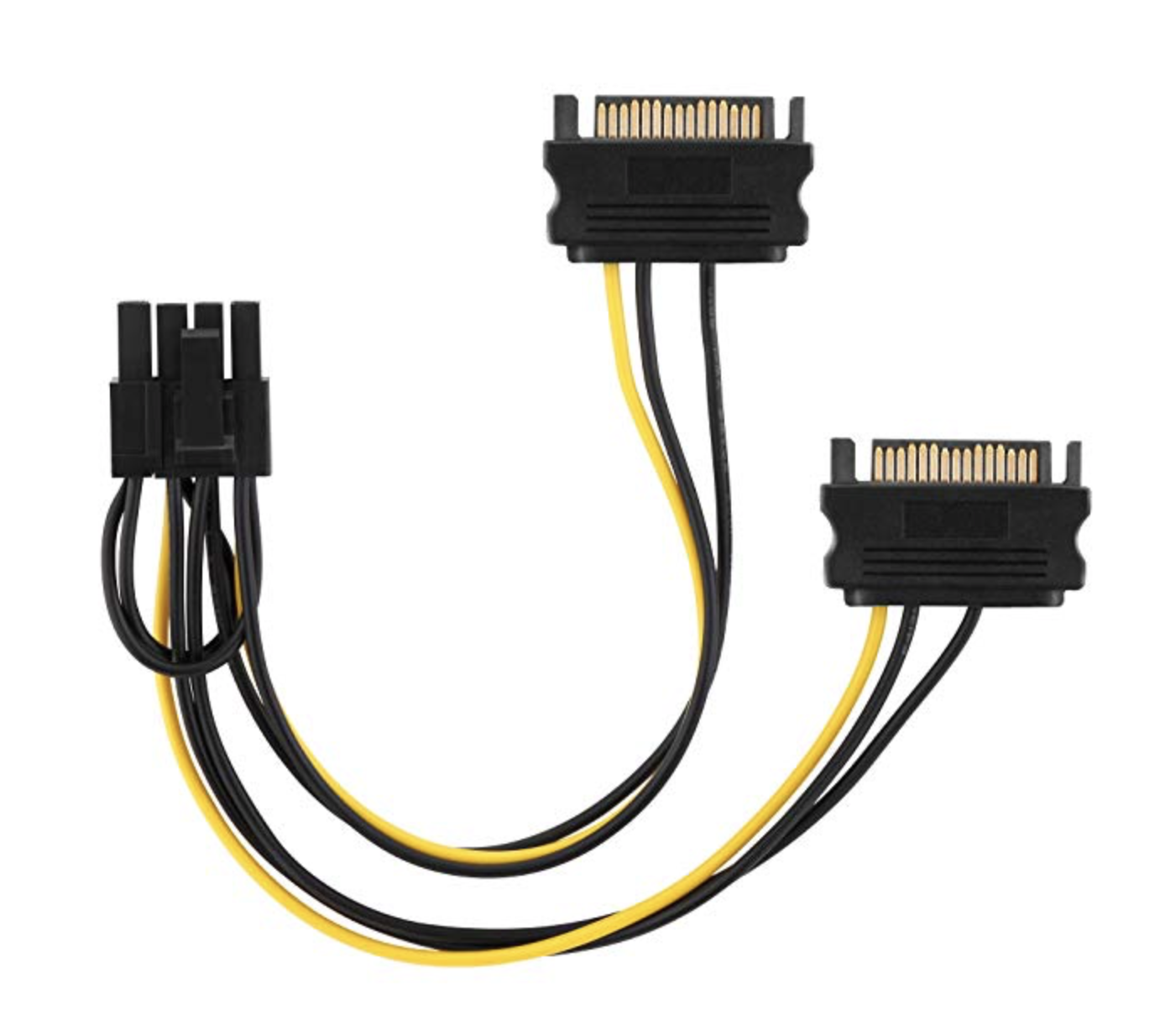

I saw however I can use a SATA cable to 8-pin port to take SATA power from a hard drive slot :
Curently, nothing is connected to the second 8-pin of the RX
...and that is the problem. There are 2x 8pin connectors because it needs 2 connectors (if you draw too much current through a single connector, you can damage the PCB or components). The card won't work with only half the power connected.
Instead of using a 2x6pin->1x8pin, you might try 6pin->6+2pin (x2, one for each 8pin connector). The total power is still very close to the MP3,1 capacity, but it might work OK. Or just add external power.
Okaaaay guys, I found at home another 1x6-pin → 1x8-pin, I removed one of the two in the 6-pin from the 2x6-pin to 1x8-pin (Tell me if you did not understand)...
And, it just works !!! The GPU is recognized by the Mac Pro as a 'AMD Radeon RX 590 8GB', Metal acceleration works perfectly, I tested it a little bit in Final Cut (because in France it's 2am lol), and it's amazing...
However, I found one big issue : The two fan of the RX aren't turning on, so I won't push the GPU at is limits (for the moment). So I think I will use an external power supply because I don't want to blow it lol
