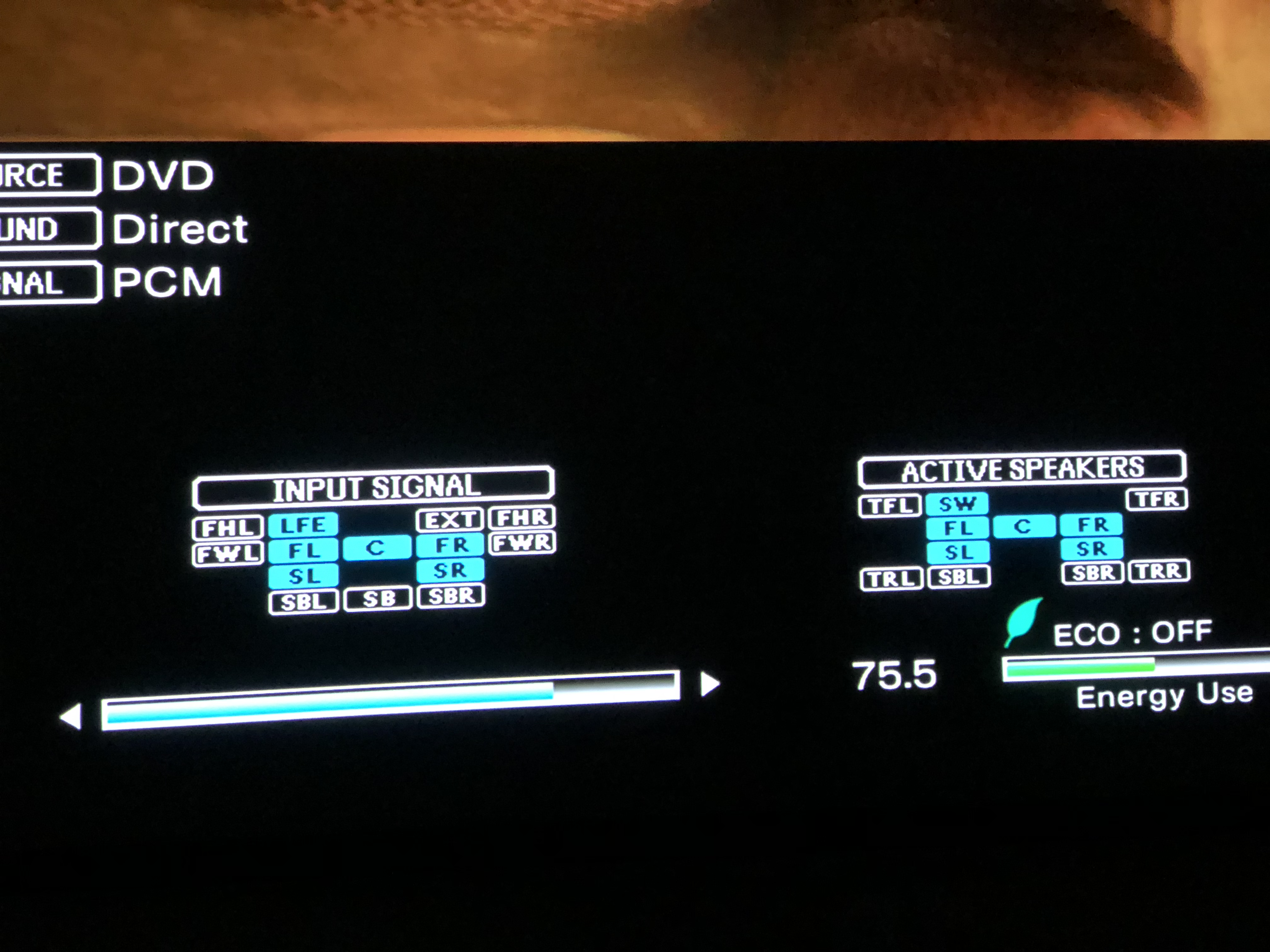

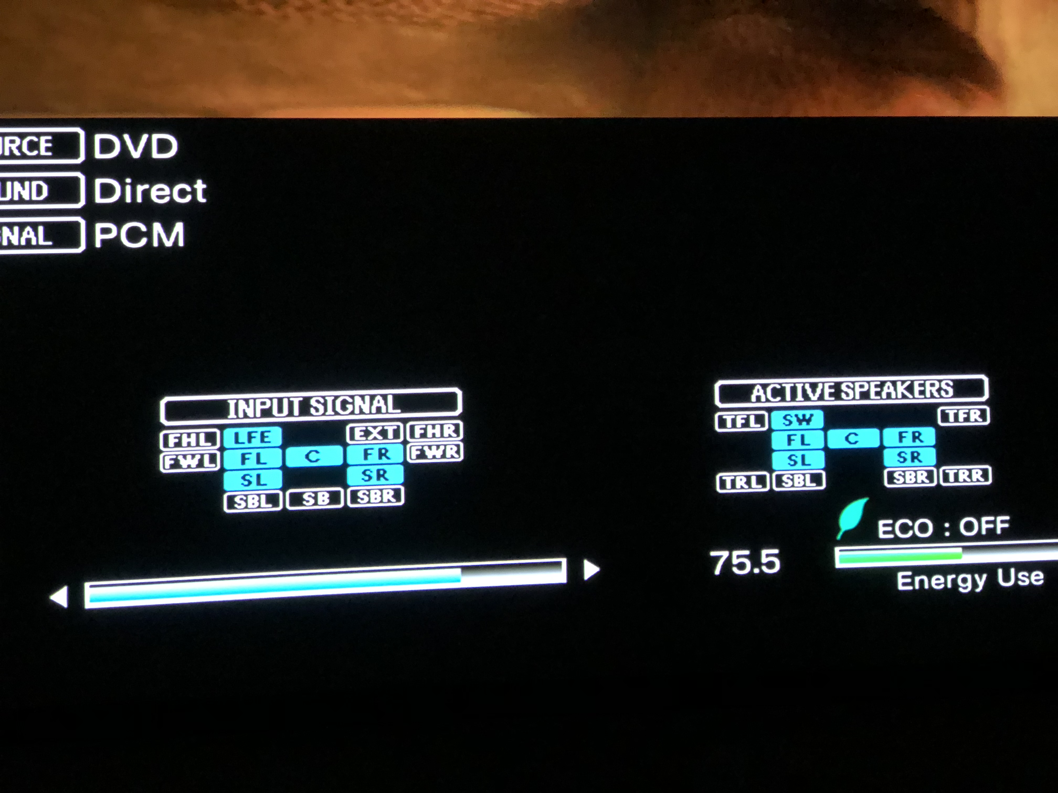

I’m connecting my Atv 4k to a high end Denon 6300 and that outputs to 7.1.4 speakers and a projector. Atmos works perfectly well on all my other streaming and disk based devices. In current beta I can’t get anything to output Atmos at all. My receiver shows straight 5.1 PCM in and out. So whatever trick Apple is doing to pass Atmos to soundboard isn’t working with a full Atmos setup. Anyone else tried with a receiver setup?
What content have you tried so far? The only thing that’s worked for me so far is Vudu.
A dozen of the iTunes movies reported to work for other users. Paddington, Matrix, lego Batman. Vudu. Netflix.
I just checked on my ATV connected to bounce Atmos, I can't get any Atmos content there either. It all shows 5.1 PCM. In iTunes and Vudu...

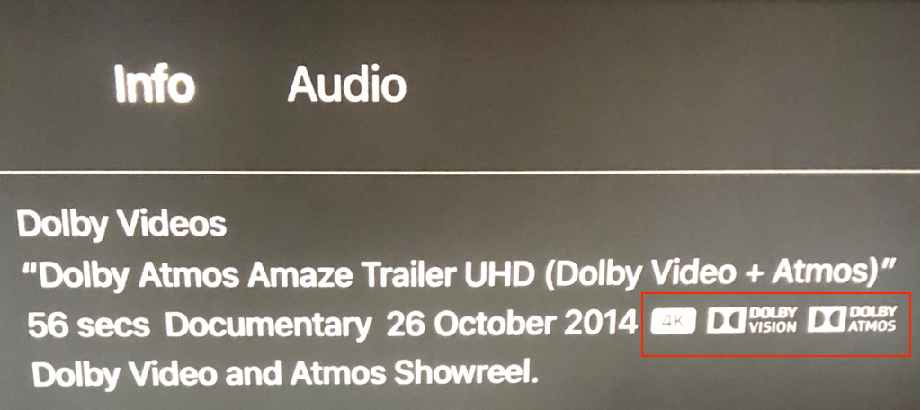

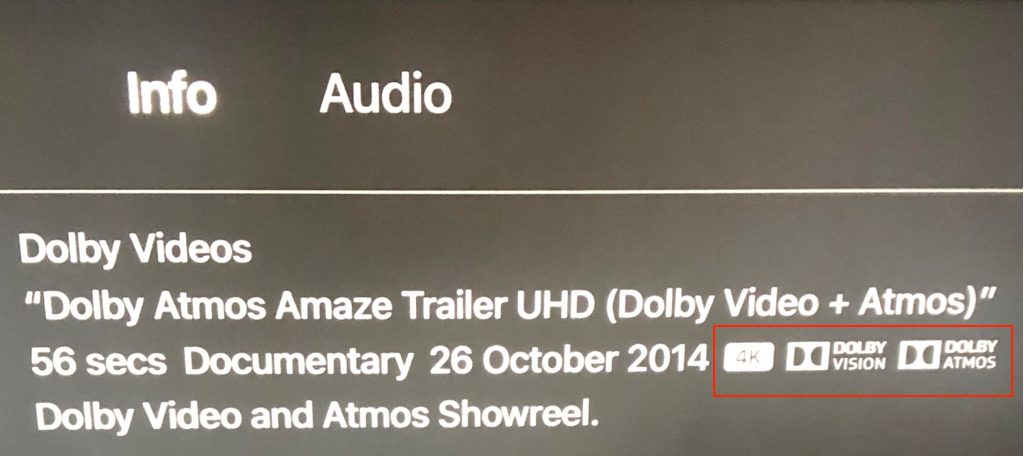

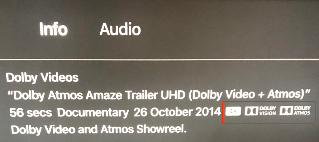

PS, one new feature is the indication of DoVi and DoAtmos signal in the Drop-down HUD
Do you have the Amaze trailer in 4K with Dolby Vision? If so, where did you get it. I’ve only found it with standard HD and ATOMS
