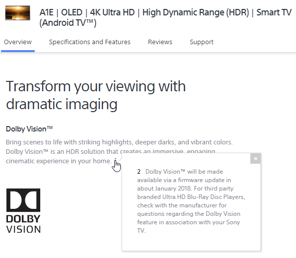

I have read the American Bravia with X1 Extreme co-processor have got the Dolby Vision FW update. It is working with the Apple TV 4K? In the Sony forums there are people complaining that.. it is a mess. Did anyone manage to make it working?
The DoVi feature has been removed from the release changelog.
And remark about possible compatibility issues with 3rd-party sources added to product pages of A1E and Z9D.
Go figure.
Unfortunately, it's only working with the TVs onboard apps. They even updated the firmware on the website and it doesn't even mention Dolby vision.
It's a different firmware number but from what I can tell the only thing that changed was the release notes.
It was also PKG6.2818 this morning, when DoVi was still listed as a feature. Not sure about the 0075NAA part any more.
Oh.. all right. Thanks guys. So it is even worse than I imagined. That Android TV on Bravia will never work at this point. It has issues everywhere. Even in a key selling point like DV, now. Unbelievable.

I updated early yesterday morning. The release notes page said 0070NAA but the release my TV received was 0075NAA. Guessing they just removed the reference but the file is the same.
Would you be able to pull the EDID data from your Bravia then? Just to see if and what evidences it may contain about new HDR mode.

Last week, Sony finally started rolling out the Dolby Vision update to its A1 OLED, X93E, X94E, and Z9D models in the US. The same update will roll out in Europe next month.
However, while the update works as expected via streaming apps (Netflix), it does not work via HDMI sources such as Apple TV 4K or UHD Blu-ray players. After waiting for almost a year for the update to arrive, owners are frustrated and disappointed. We have pressed Sony for an answer since the update was released last week and received the following statement from Sony Europe today:
- “Select Sony TVs will support Dolby Vision with the software update to be rolled out in Europe within February, 2018. After the Sony TV receives the software update, devices with Dolby Vision playback (such streaming media players and UHD Blu-Ray players) that are connected to the Sony TV by HDMI will also require a software update to support Dolby Vision playback through the device. For more info on the timing of an update to a particular player, please contact the player’s manufacturer.”
If you are confused we can understand why. To date, Dolby Vision has required the TV to process the dynamic metadata, meaning that if the playback device outputs in Dolby Vision, your TV will accept the signal. However, Sony has implemented a new Dolby Vision profile that offloads much of the processing to the playback device, likely because the processor in Sony’s TVs lacks the capability or power.
Sony did not go into further details of the technical implements or explain why it has chosen this approach.
But there you have it. Your Dolby Vision playback device, meaning your UHD Blu-ray player or Apple TV 4K, will need a firmware update in order to be compatible with Sony’s TVs. Oppo has said that it will deliver but Apple and others have yet to comment on the matter. Sony will release its first Dolby Vision-capable UHD Blu-ray player this month but the update to enable Dolby Vision on the player will not arrive until “summer 2018”. We expect the X700 player to compatible with Sony’s TVs by then.

Dolby and Sony share responsibility for this mess (though, I blame Sony more because this information wasn't revealed to X1 Extreme Bravia buyers in advance). Dolby is apparently struggling to bring Dolby Vision to wider acceptance. And now HDR10+ is trying to steal Dolby's thunder and I suspect Dolby is concerned.
Basically, Dolby is allowing a VARIETY of different decoding schemes for Dolby Vision. Decoding happening entirely in the TV, part in the TV and part in the HDMI device, and also entirely in the HDMI device. It's a royal mess.

FYI - someone on AVS forums posted a screenshot of their Z9D after they installed the just released 11.3 tvOS dev beta and DV is working on it!! Bring on the public beta!!!!
