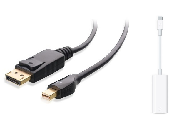

Still not clear for me about the Thunderbolt 3 to Thunderbolt 2 adapter from Apple.
I have 2 displays which I currently use with Mini DisplayPort to DisplayPort cables. Is the Apple adapter right in order to keep using these displays with the new MacBook Pro without buying new cables?

It works only for Thunderbolt 2. It does not work for MiniDisplayPort.

Yes according to https://support.apple.com/en-ca/HT207266Will Apple's Thunderbolt 3 to Thunderbolt 2 adapter work with Thunderbolt 1?
Thank you
