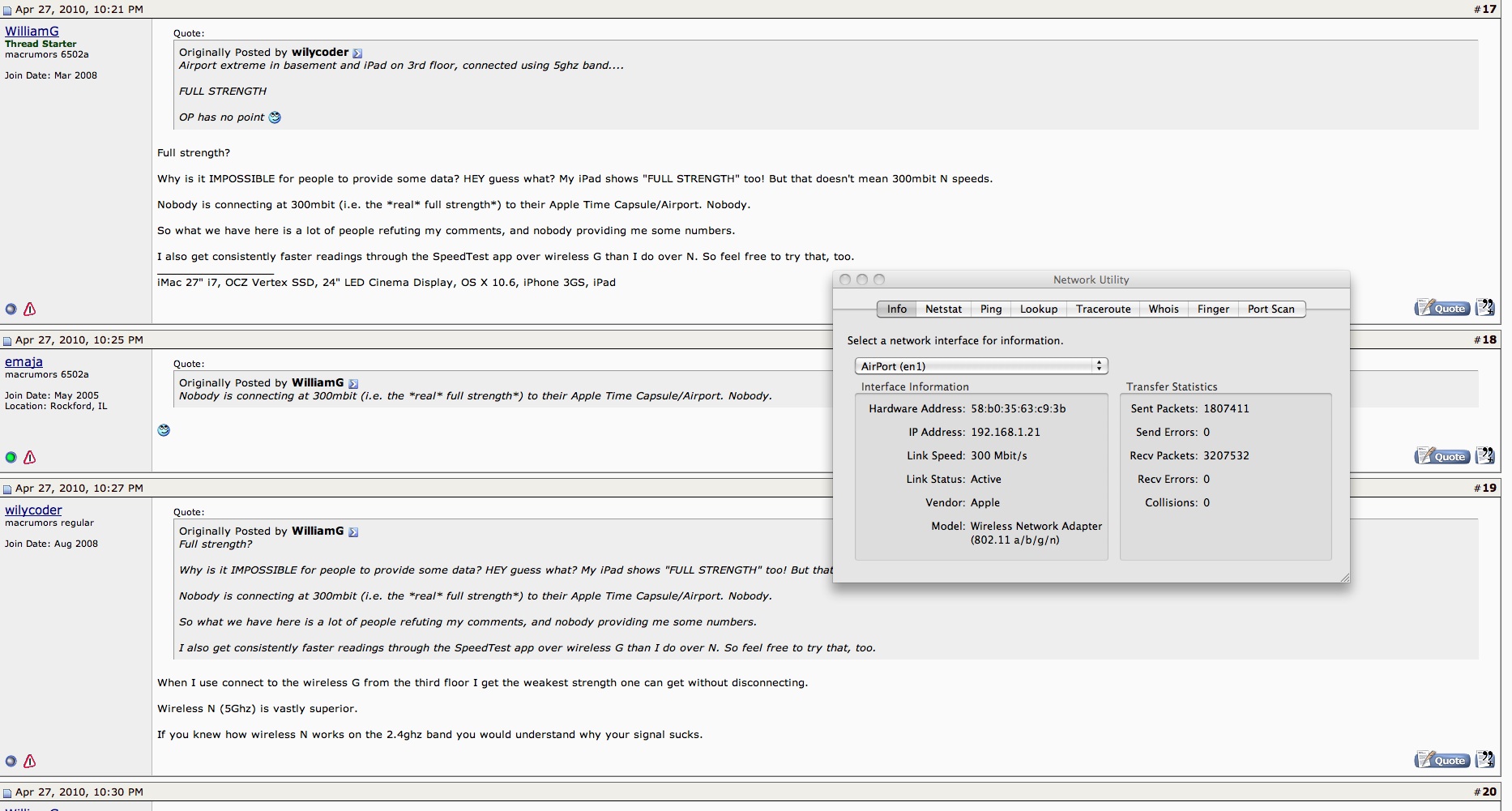

Read this and weep. I get this every day or about 98% of max speeds:
http://www.welho.fi/Privateusers/InternetAndTelephone/tabid/783/Default.aspx
It's good to be an American working in Finland. Let me know when you catch up.

Universal translation on: "I can't back up anything I've said with anything factual. Come on guys believe me. Honest"
Universal translator off

Congratulations for not reading what we're talking about. :rolleyes: My iMac connects at 300mbit, so does my MacBook Pro, and my Airport Express. What's YOUR point?
And others have supported my findings with their own.
So why don't you go read the thread from the beginning.
And congratulations that your Mac connects at 300mbit. So does mine. We're talking about the iPad, here. The iPad. Got it?

Go read your own post #17.
You said no one connects at 300mbps. Your own words. Got it?
Until there is hard empirical evidence your words are no more valid than mine or anyone else here. While you may have experience a certain of data, others might not. Yours is not the final answer. It is just an opinion. Got it?
30 mbit. "snickers"..... Enjoy.....
Yes, nobody is connecting at 300mbit. How do I know this? Well, I've tested several iPad WiFi models, on several routers that are considered "high-end," and found this. Some people I know with iPads (3G and WiFi models) have found the same thing. In fact, if you scour the message boards, you'll find the same.
