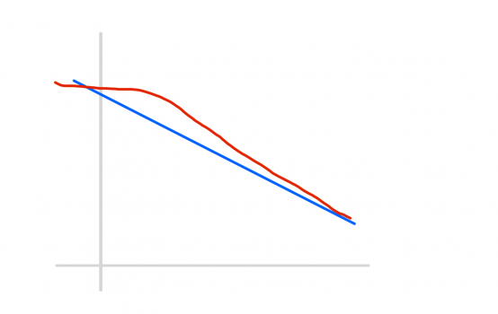

I agree, it could be less. I'm all for raw battery indication. Anyway it also depends on the time you do it. The nearer to a reboot or recharge, the bigger the difference. Try rebooting two times. The first time it will drop 5%, the second maybe 1 or 2% only. After many hours I observed the difference to lessen. Quick graph to explain myself, blue line is raw battery charge, red line is how iOS shows it to us, it lies more in the beginning (of a recharge, or of a reboot) then slowly reduce this lie:
Yes, the more times you do it, the less is the difference. The first 5% and the second 2-3%. Although it also depends on the time that passes between reboots. The more time passes the lower. In one thing you are wrong, it goes down the closer it is to 100%. In my case if it is at 20-30% it does not usually go down more than 2% but if I do it with 80% it can go down to even 75%
maybe you are right, maybe it's related to the total battery charge
