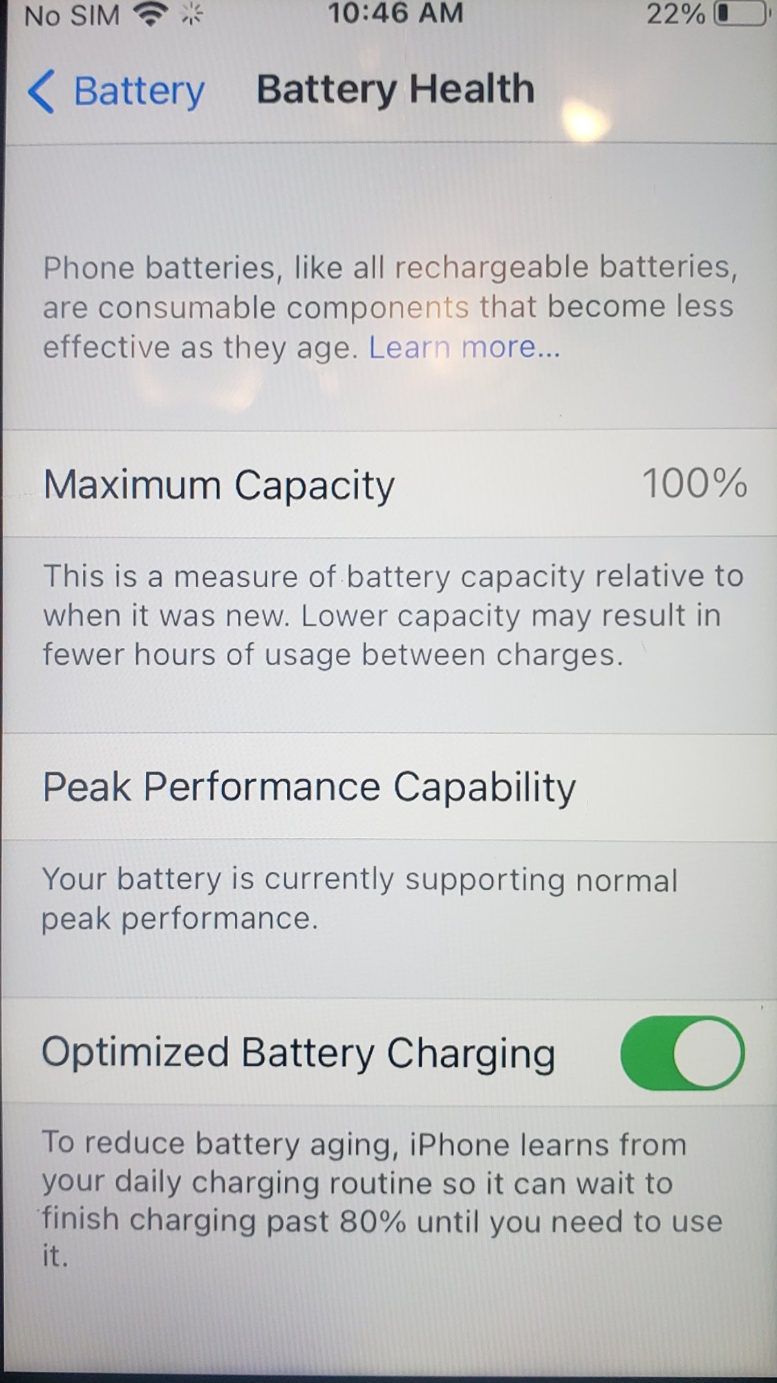

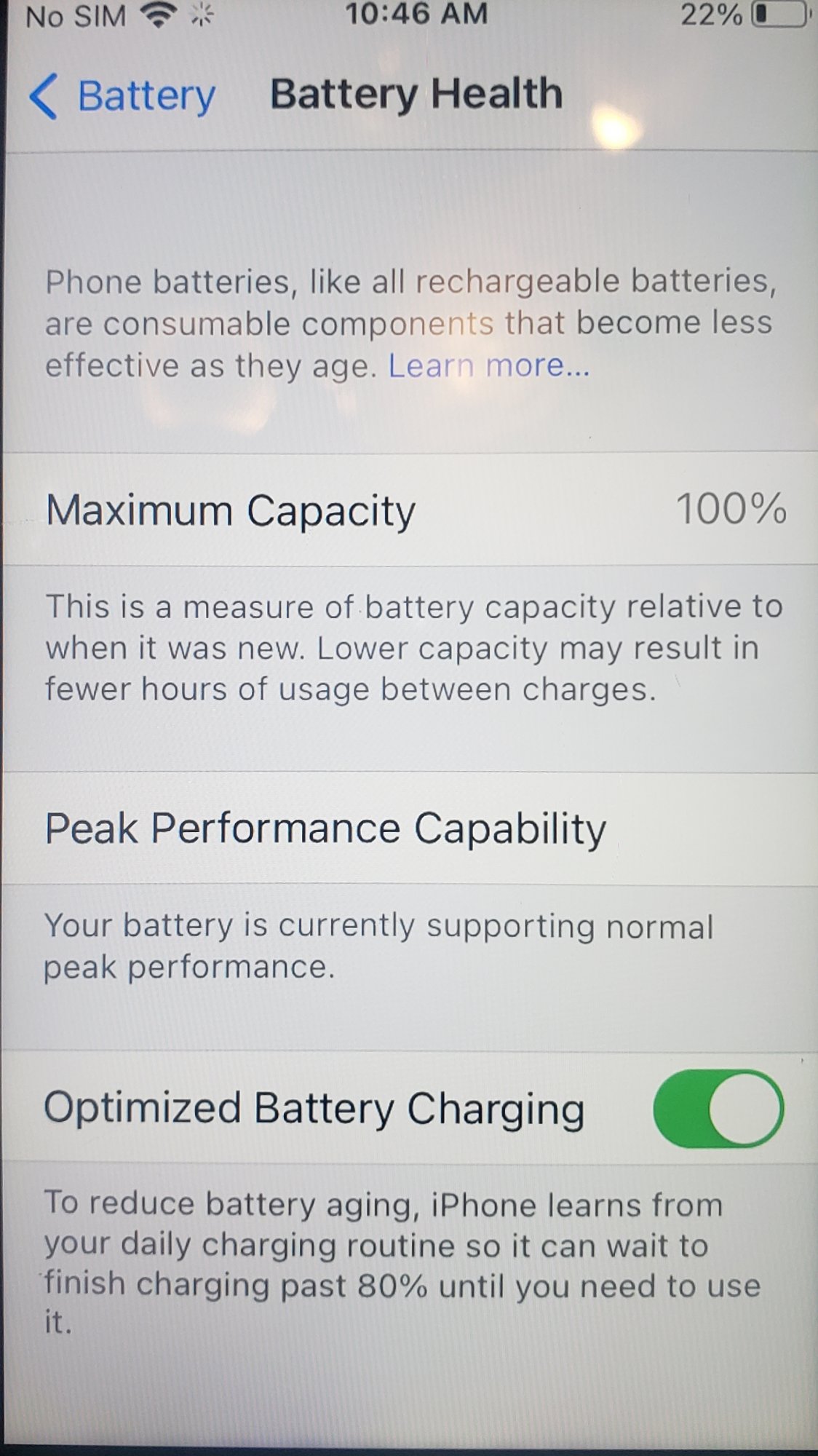

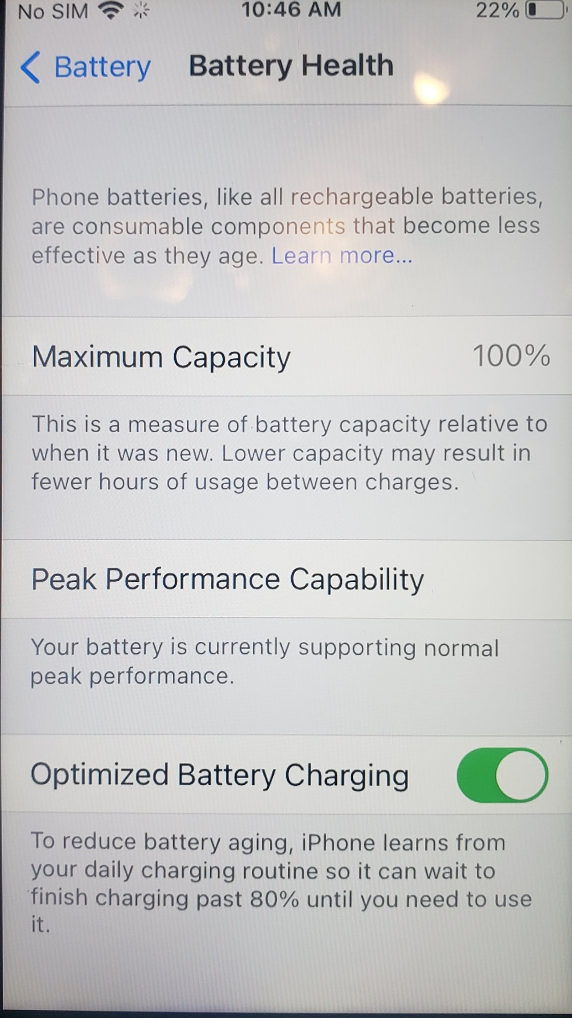

Hey just want to give an update on the situation.
So the phone came back today. It came with a letter in the box basically repeating the same thing the email said. However, after turning on the phone (which had been reset btw) I went to settings to check out the battery health, and it would seem that they did replace it after all! The Maximum Capacity says "100%" and under Peak Performance Capability a little message reads "Your battery is currently supporting normal peak performance." (Image attached) Upon re-reading the letter and the message you sent showed in your first post I think we, or at least I, have been reading it wrong the whole time. The messages never stated that the battery couldn't be replaced, but rather was focused on this supposed "new" issue that was never mentioned.
I recommend checking the Battery Health settings on your phone and look at the messages there. This whole thing could have been a misunderstanding.
I recommend checking the Battery Health settings on your phone and look at the messages there. This whole thing could have been a misunderstanding.View attachment 1720203
