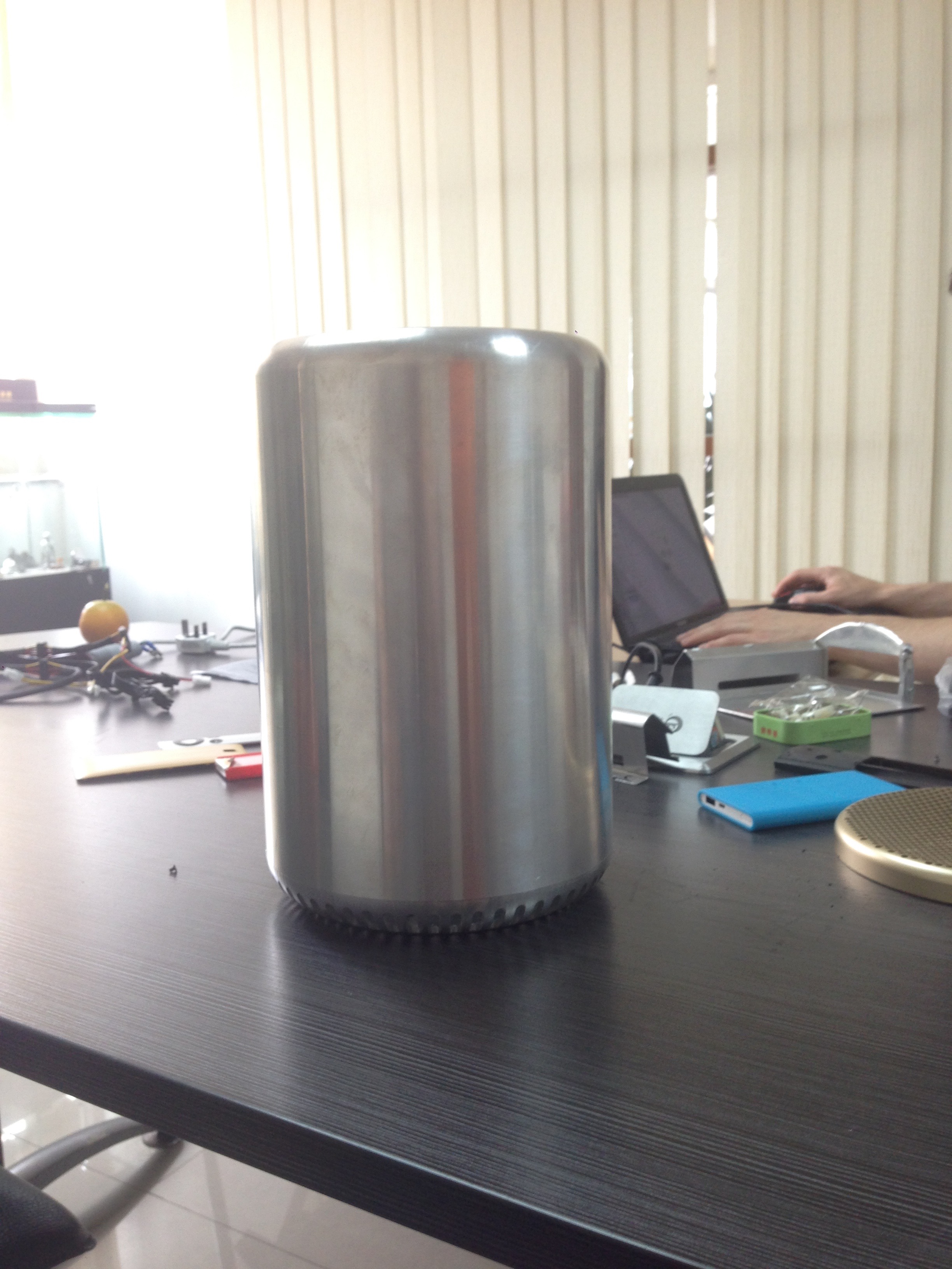

Here is a picture for you mate .. its not anodized but its raw aluminium that is polished 🙂 .. But yes the offering is in Gold and Black
Okay damn, that picture looks like a Mac Pro lol. 99% of people looking at it will say it's a Mac Pro.
Please stop pretending your revolutionising the PC markert, and this is a breakthrough etc etc . Just be humble and carry on .
To quote you "I personally feel that in the PC space that too many designers are playing it safe and not taking risks"
Mate it does not get any safer than taking apples design..... You took no design risks. I've said many times I want you to do well, but frankly as this thread had moved on, I'm seeing arrogance and delusion , and as a PC user this is no breakthrough product, it's a Mac Pro case, it was designed and manufactured in 2013. Please answer people questions but don't pretend you are a visionary....at least day apples Mac Pro inspired the design 😉

I'd say apples design is the evolution and breakthrough. Let's see how you case handles intensive gaming, here is apples breakthrough you can game on it and it remains Almost silent , can your case do that ? No, I can tell you right now , cause those fans on the GPU will spin fast! I've built enough cases to knew this cannot match the Mac Pro for heat and sound .

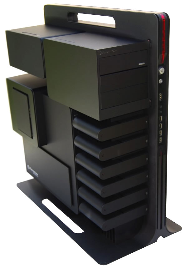

If you want to think about revolutionary designs and something totally fresh , it's looks something like this
Still just moving current PC components around but something new , no copying anyone else's design. I really liked this case cause at the time it matched he Mac pros design while not copying it, and it was great in relation to accessing individual components . For me this was a breakthrough of design, not having an existing model to draw a lot of inspiration from.

Could they just make a transparent glass/polycarb version of the Mac Pro Shell, to replace the aluminium one?
Of course, then I'd need to buy a Mac Pro to go with it, but baby steps.
