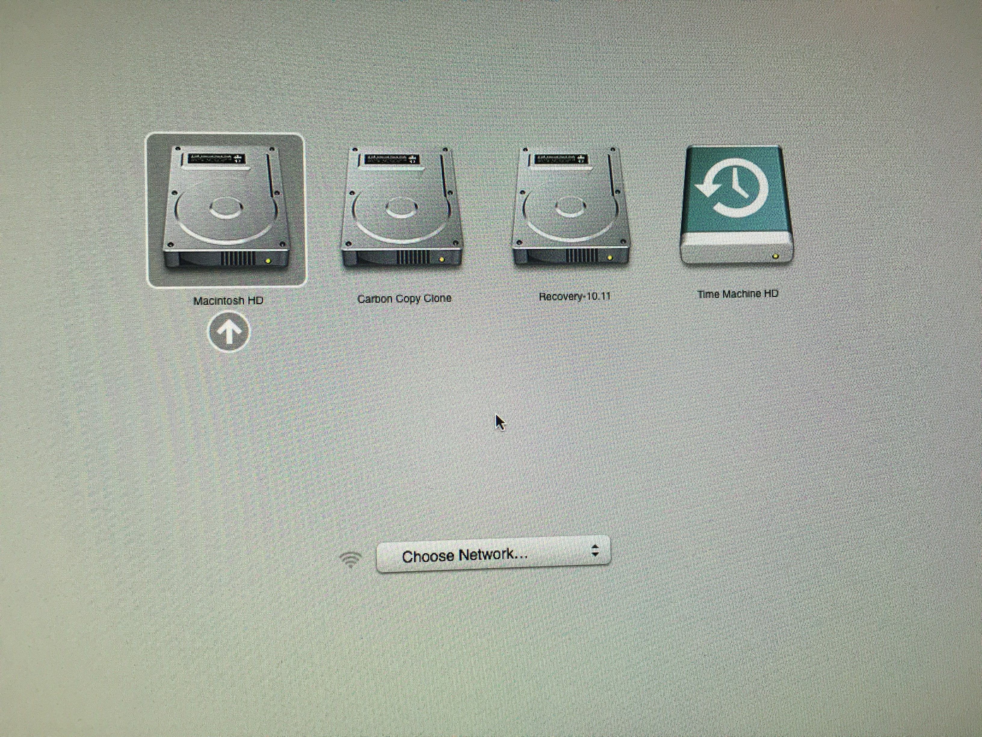

- Interestingly, I get the stop sign when attempting to boot from the TM drive, too. My machine then rebooted automatically to my standard drive after about 30 seconds. Might be you can only boot from TM when you don't have a functioning internal Recovery partition.
The normal Recovery partition isn't supposed to show up in the menu. I believe it did at one point (perhaps before Yosemite), but it doesn't any longer. Cmd + R is the way to go now.
I should think such a TM restore would also restore the Recovery partition, yes. Can't say I've ever tried it, though.
(Please ignore the two middle partitions; they're related to my CCC backup.)
