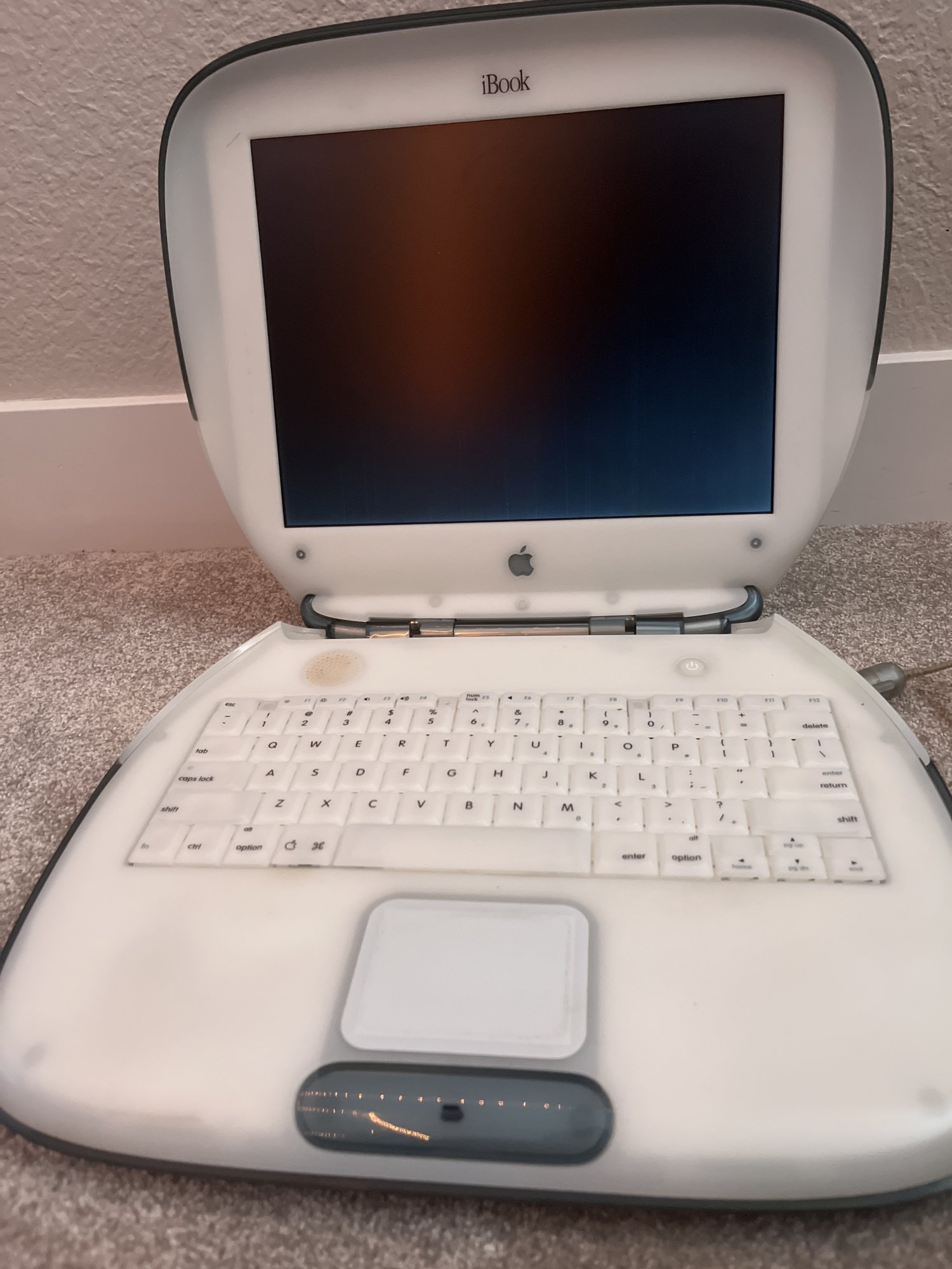

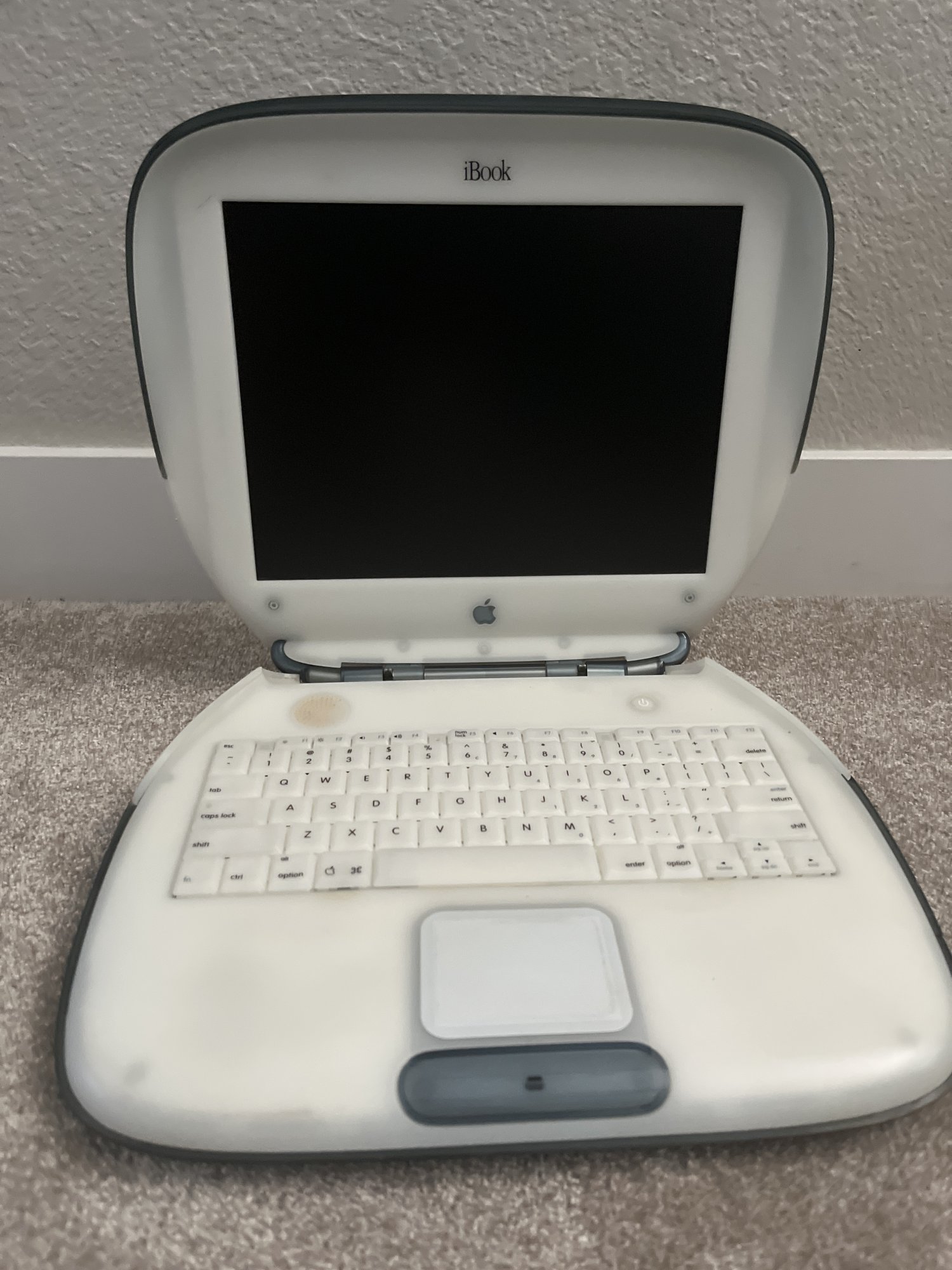

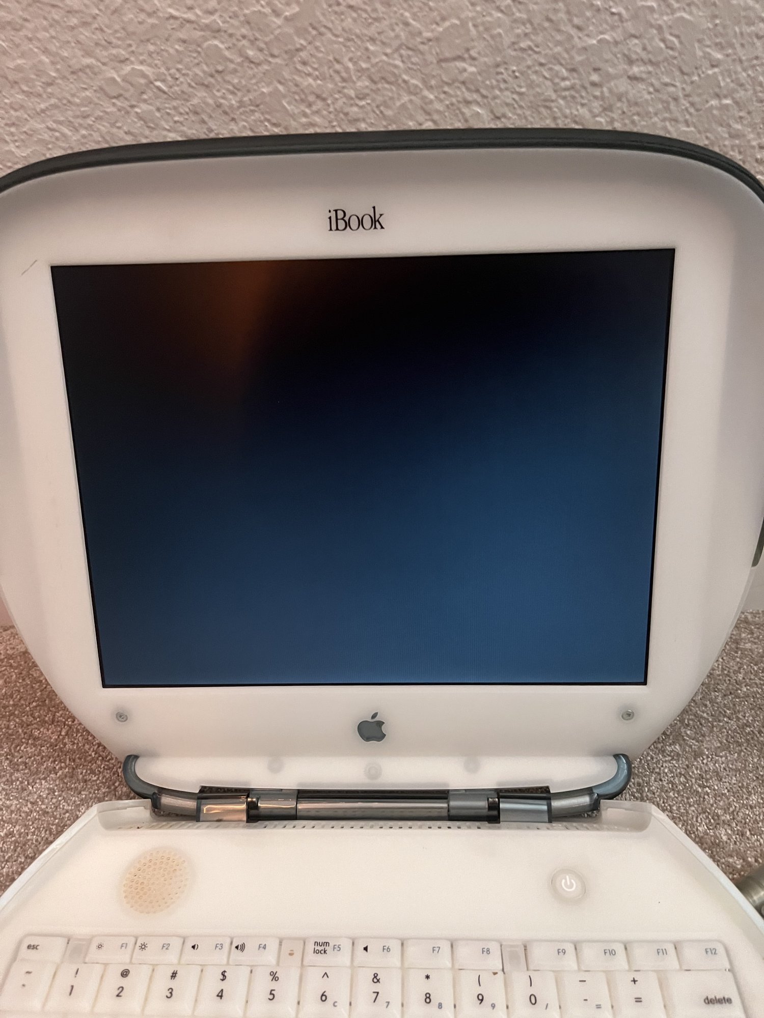

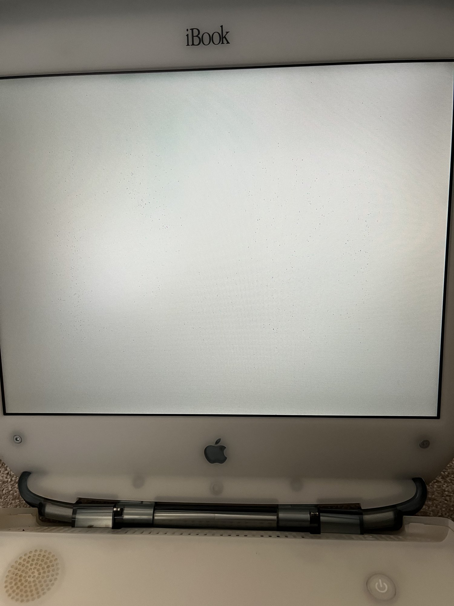

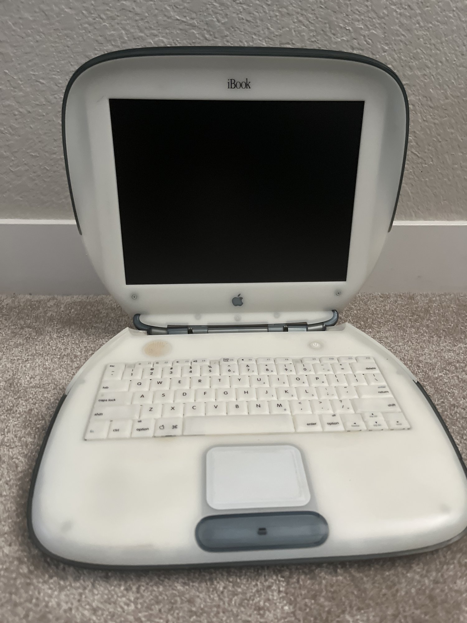

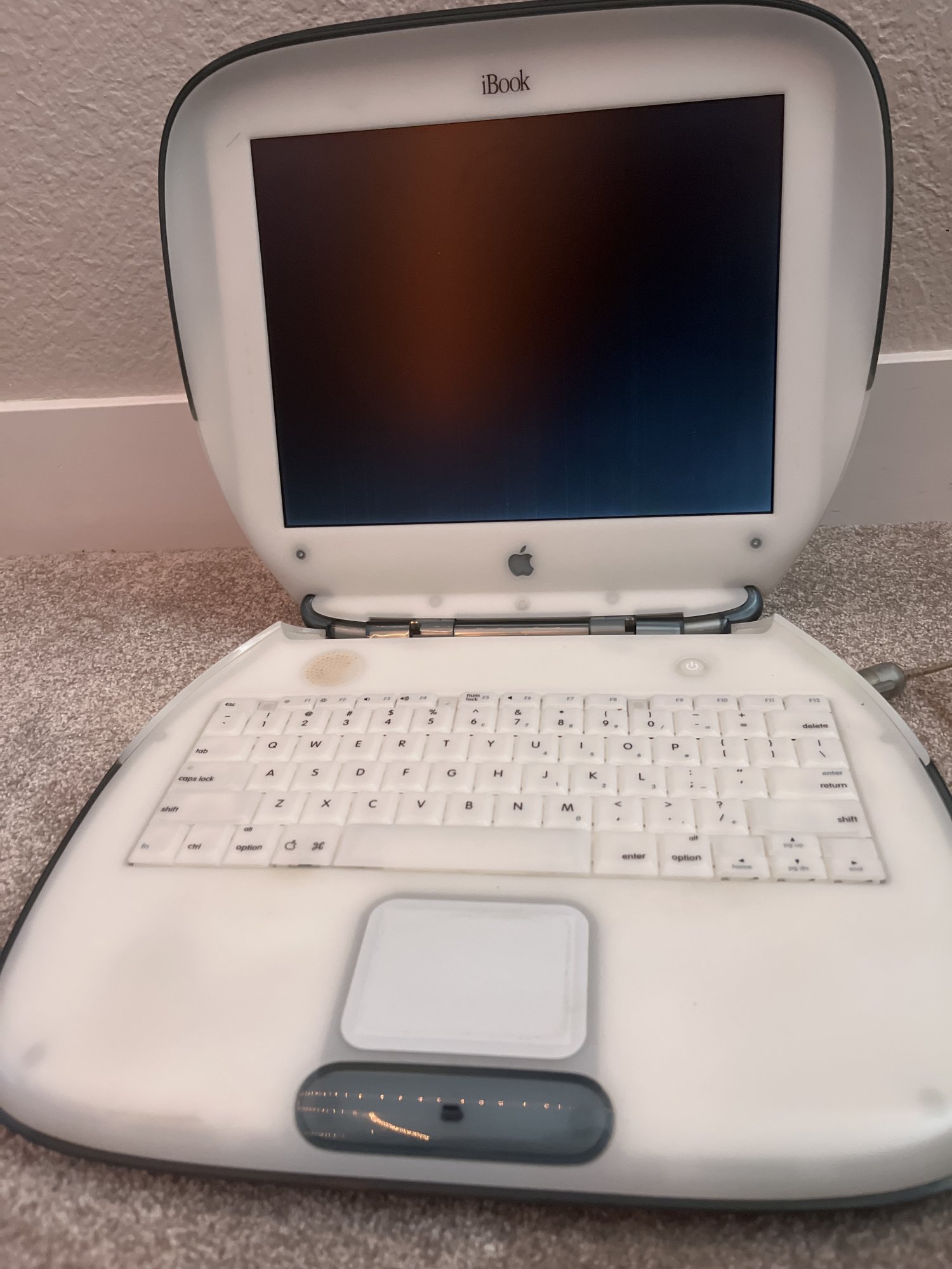

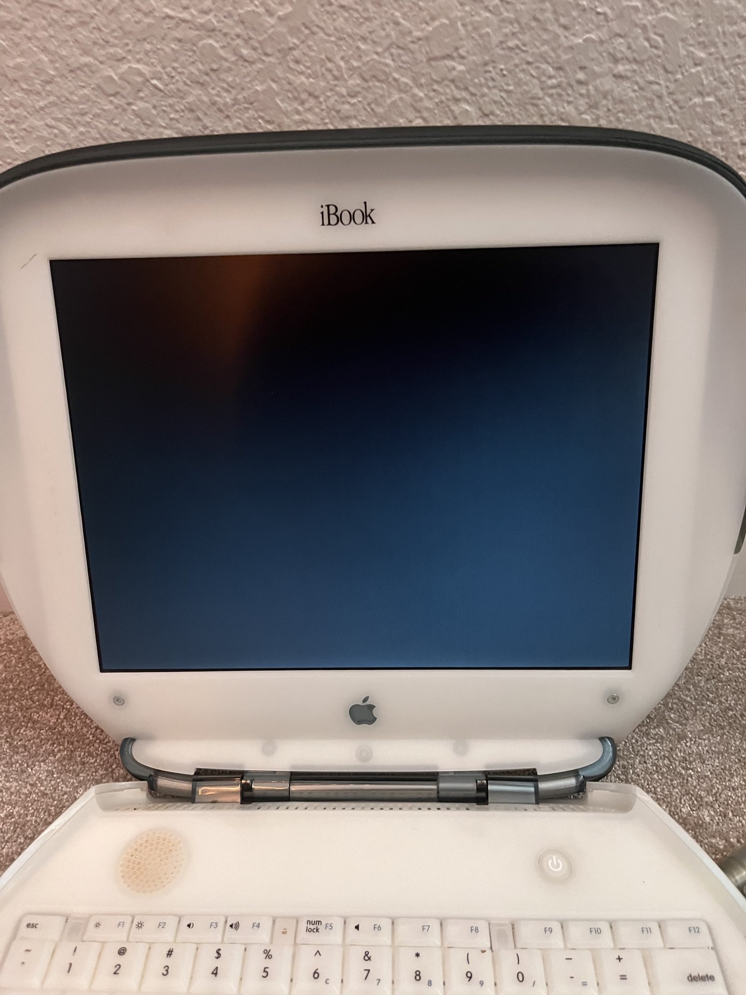

Just got an $10 iBook with a broken screen.
I was thinking of a procedure that would tap the signal from an appropriate point on the logic board and then somehow feed it externally. If it were even possible to do so. 🙂
It might be technically possible but you would have to sacrifice the display out socket in order to feed the wires out and it would look messy. I don't think it would be easily possible given the design of the case to create an extra port out for audio/video as appropriate so that you could use a component cable.

The plug in point is a barrel jack, which limits the cabling out to three. Not sure how you would split the audio and video from that.

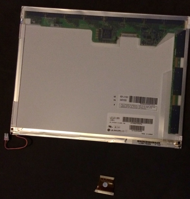

Looks like an SE so can be replaced with any XGA screen from an iBook or Powerbook 12". Just getting the video cable adapter is going to be very difficult, though.
As in finding it online? Also, can I just swap displays and display cables with an iBook G3 Snow?
The screen will be fine. I swapped mine with the last generation iBook G4 12". To be honest, the newer the better. At that time, you could get a display cable adapter from pchub.com but they sold out long ago. Without that adapter you need to somehow find a display with the same cable connector as on the iBook Clamshell. That is the problem. Nearly all do not have that connector.
I did a quick summary of my swap here so you can see what the problem is.
So I can’t use the cable without an adapter. That sucks. Why would a snow cable not work for a Clamshell?
Will this work?
No idea. It's the correct form factor but it's Apple, so who knows if Apple didn't swap the cables around somehow. You could give it a try. As said, I couldn't get mine to work even with an Apple cable and from what I have seen on Apple's forums, I'm not the only one.
Reactions: christiann
I will try the Apple cable
You won't know until you see what your panel is in your Clamshell and if it matches your replacement panel. As I showed, my Clamshell had an LG Philips panel but most iBooks/PowerBooks had Samsung panels. If you find an LG panel then you might be in with a shout.
I’ll see if I can get the broken Snow to boot up and possibly check to get the specs on it. (I broke it replacing the hard drive). Then, I’ll use the parts for the Clamshell. This will be an all-day affair. It was so difficult replacing the hard drive on the Snow— and I broke it… Wish me luck 😕
Reactions: TheShortTimer
If it's not an LG, don't take it apart. There isn't much you can do unless you can find the right display cable or adapter.
