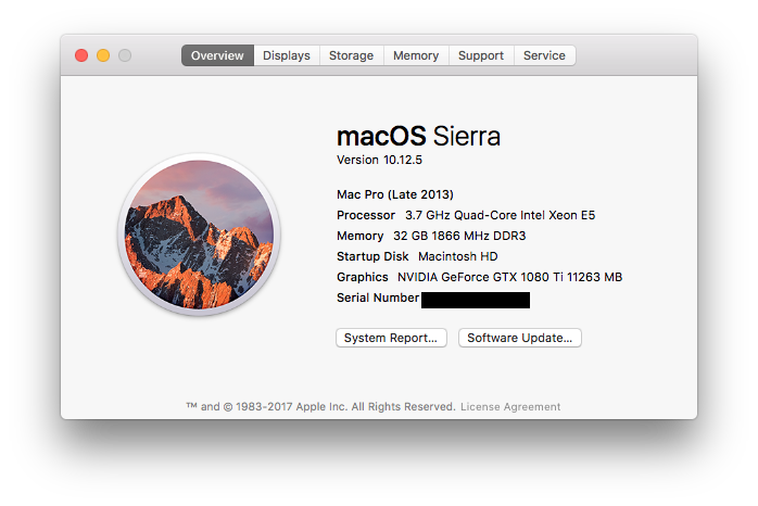

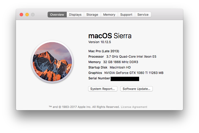

No complaints here with nMP + Sierra 10.12.5 + AKiTiO Node + GTX 1080 Ti.
Disable SIP, run the automate-egpu.sh script which grabs the latest web driver (Nvidia driver for 10.12.5 was released yesterday), reboot, done. It was amazingly simple.
My main issue is with bootcamped Win10, I can't get the eGPU to show up there at all. No input on an AMD eGPU, sorry.
No complaints here with nMP + Sierra 10.12.5 + AKiTiO Node + GTX 1080 Ti.View attachment 700174

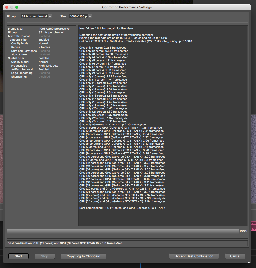

Interesting. I use a lot of NeatVideo on 4K footage with my 12-core 3.46 cMP/Titan X Maxwell combo.
What is your max fps you are getting with NeatVideo with your current CPU/dual D700 setup? I know they optimized the plugin for AMD lately, so I'd love to know if there have been great performance increases.
Reactions: Flint Ironstag
This right here is the question. You guys please post benchmarks.
Here's my benchmarks on my system. I used Neatvideo's built-in 'Optimize performance setting' feature to see what combination of CPU cores/GPU would run fastest.
Note that I use Adobe Premiere Pro and not FCPX. This is the latest Adobe CC version.
