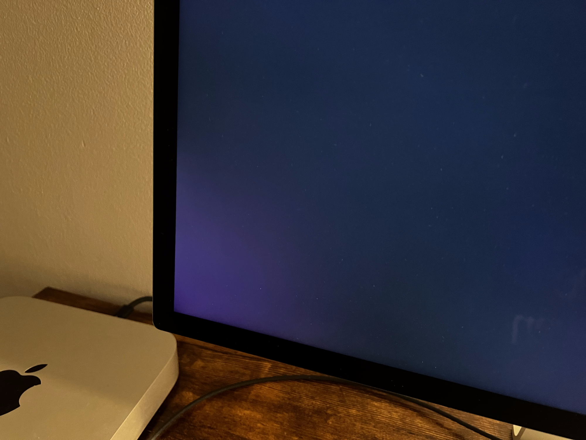

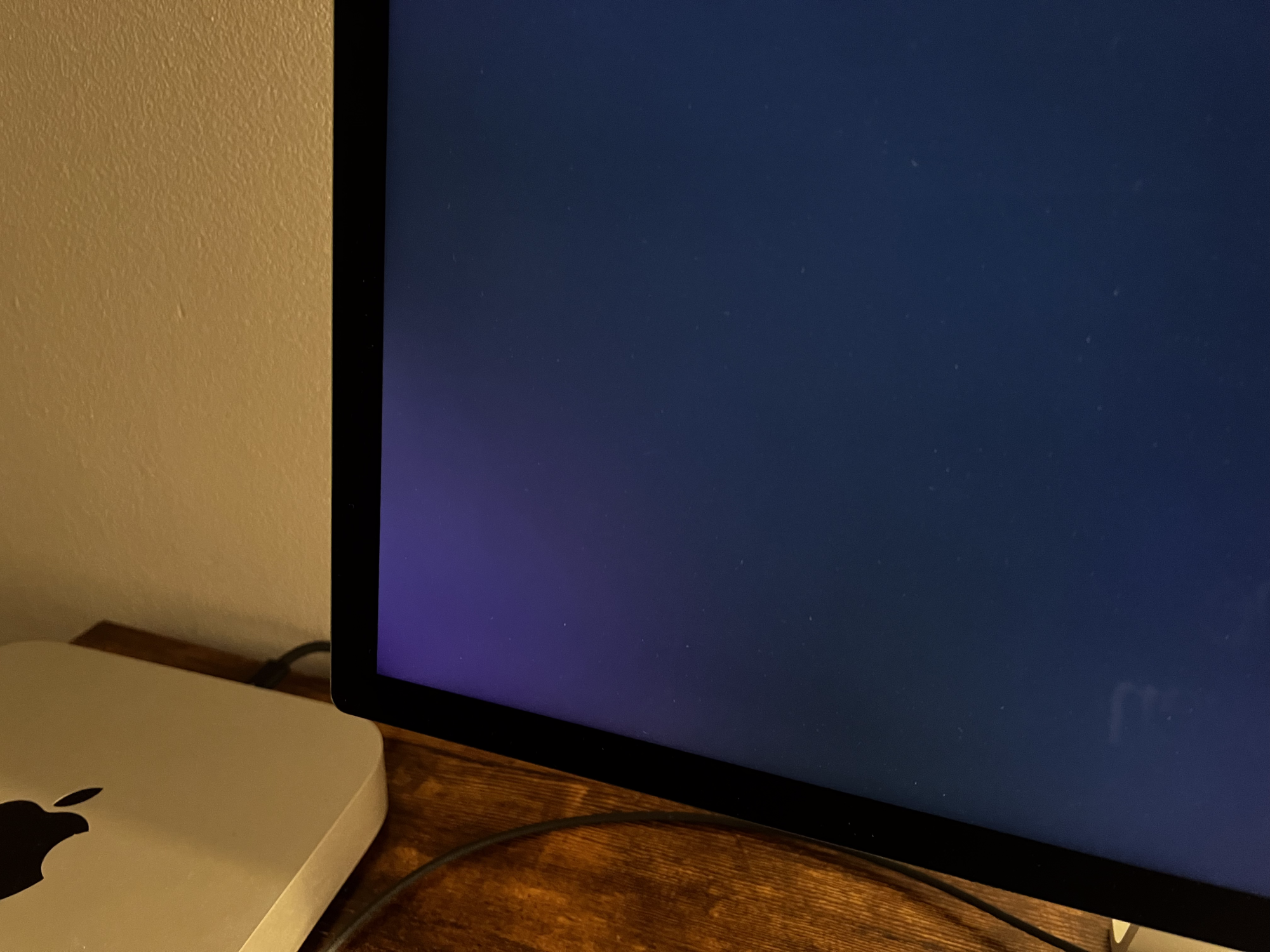

Hi all, I have the same problem that the ASP makes buzzing noises. I bought the ASD 10 days ago and have already tried everything to make the noises disappear (connected to the floor sockets, connected the ASD in the other room, deactivated all smart lights .....).
My ASD:
The buzzing comes as soon as I plug in my MacMini M1 or iPad 12.9 Pro 2020, but as soon as I plug in the MacBook Pro 2017, there is no more buzzing.
In addition, I live in a new house, accordingly, all electrical wiring is up to date technology.
I called Apple about the problem and I will get a new ASD tomorrow because I still have 14 days right of return. Tomorrow I will let you know whether the new ASD has the same issues or not.
