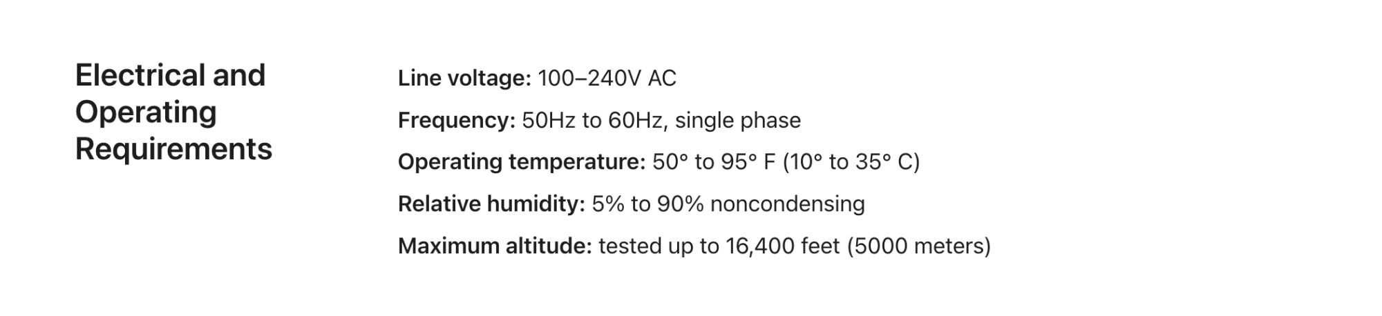

The electrician was with me today and has looked at everything.
Actually, at the sockets should arrive maximum only 230v, but with mine come 241v - 245v. Since I live on the first floor, I get of course the full power and those above me live, of course, the normal 230v ... :-/
Directly under my apartment is also the technical room for the power in the house.
However, the ASD is designed only to max 240v. In the upper apartments, the ASD makes no problems....
Quote from the electrician: "These Ami products are partly poorly designed for the non-US room".

DUUUDEE! This is my problem too! I have 238-241 V depending on time of the day. I am going to try buying a voltage stabiliser to lower it to 220/230, but before that I want to visit my old house (where ASD wasn't buzzing) to check voltage there.

The ASD can, as previously mentioned, a maximum of 240v. Any volt above that makes the ASD buzz. Higher current voltage fluctuations will also cause this.

Anything over 240v will make the ASD buzz ;D

Yes. A tolerance of like 5% is supposed to be standard from a quick check now online. I'll measure the voltage at a friend's house. Again, I still think there's more to it because the AC/ car charger makes the buzzing worse at the same voltage (so why is the buzzing getting worse in this setting?). Also I have more Apple devices with the same 240V AC max rating, probably just like you, meaning their PSU design for the Studio is specially bad. Thank you for updating. My guess is that the problem has something to do with voltage and interference togehter.
