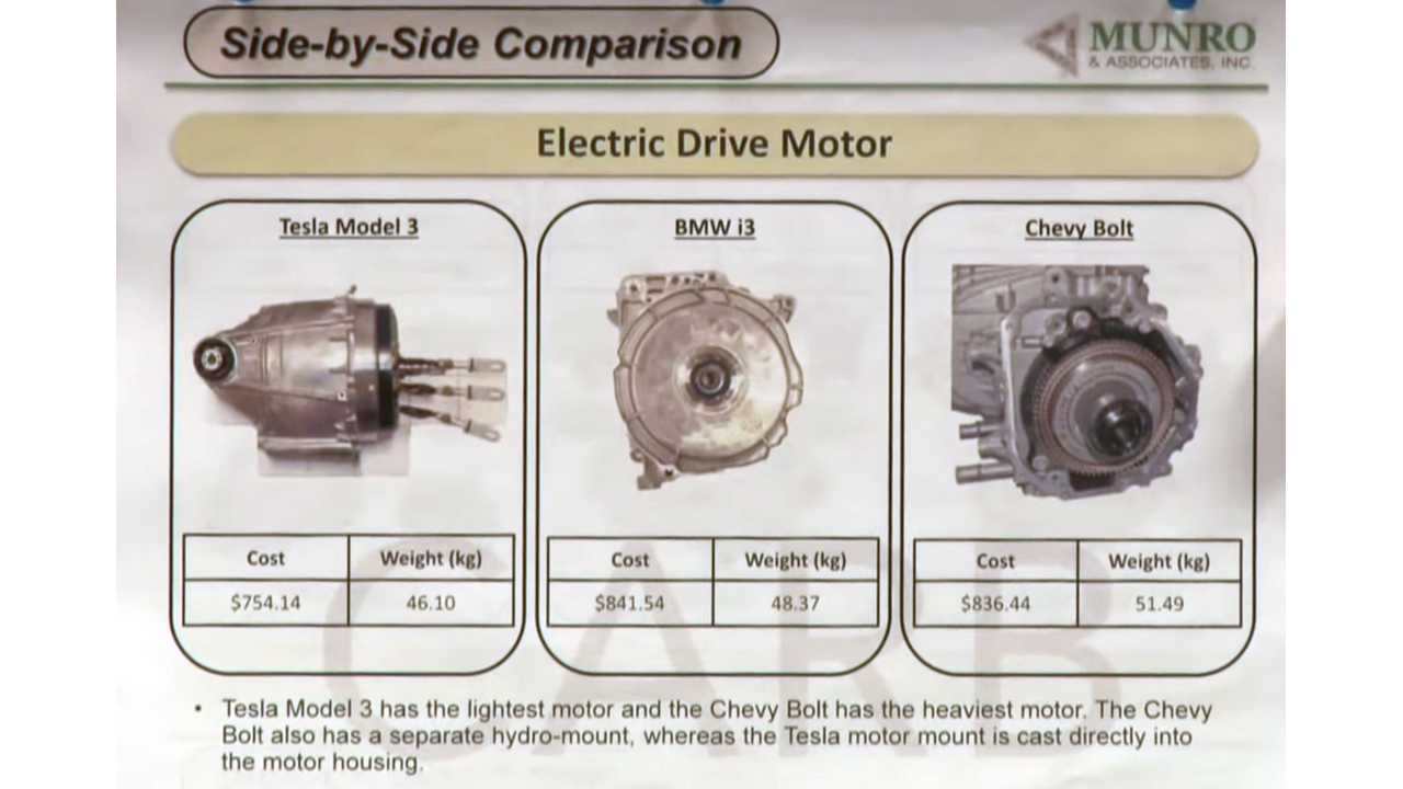

The 3 in the video doesn't have launch control (I think you are confusing it with the S).
Unless Sandy Munro was mistaken the 3's motor is smaller, more powerful, and costs less than the immediate competition (at the time of the tear down).
Unlike the other major players in BEVs, Tesla uses three-phase motors. Everyone else that I know of uses synchronous, in which the A/C frequency is varied to control motor speed. Three-phase obviously means that the power supply has to have three offset oscillators instead of one variable oscillator, but those are relatively small and inexpensive components. A three-phase motor tends to yield better performance all around, but I guess the big companies are far more interested in maximizing their profits than in making good stuff.
This doesn't make any sense. Pretty much everyone uses 3 phase, regardless of the motor type.
