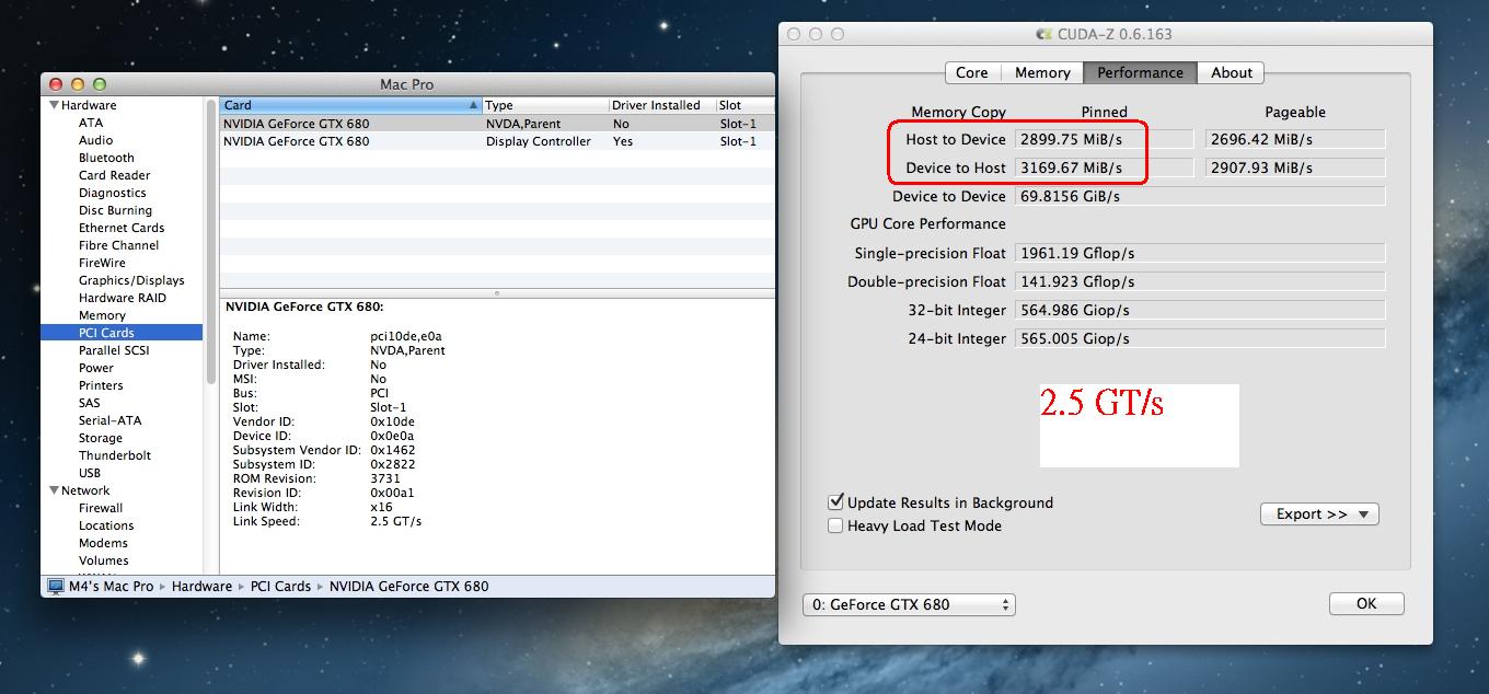

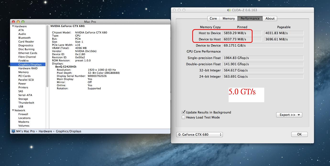

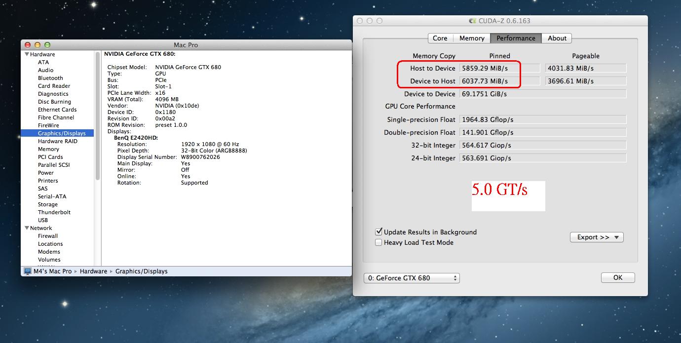

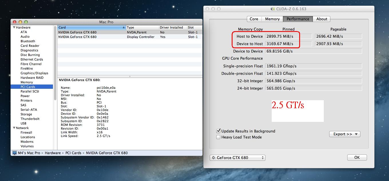

I am afraid that you are wrong.
Using a PC GTX 680 in a MP ,in fact it runs in 5.0 GT/s.
Sometimes, even it shows 2.5GT/s, it runs in 5.0 GT/s.
Check the speed via CUDA-Z.
The left picture is a flashed card, but not mod to 5.0GT/s so in fact it runs 2.5 GT/s.
The right picture is a PC GTX 680. Won't see the PCI info, but it runs 5.0 GT/s.
So, you don't have to flash a PC card.

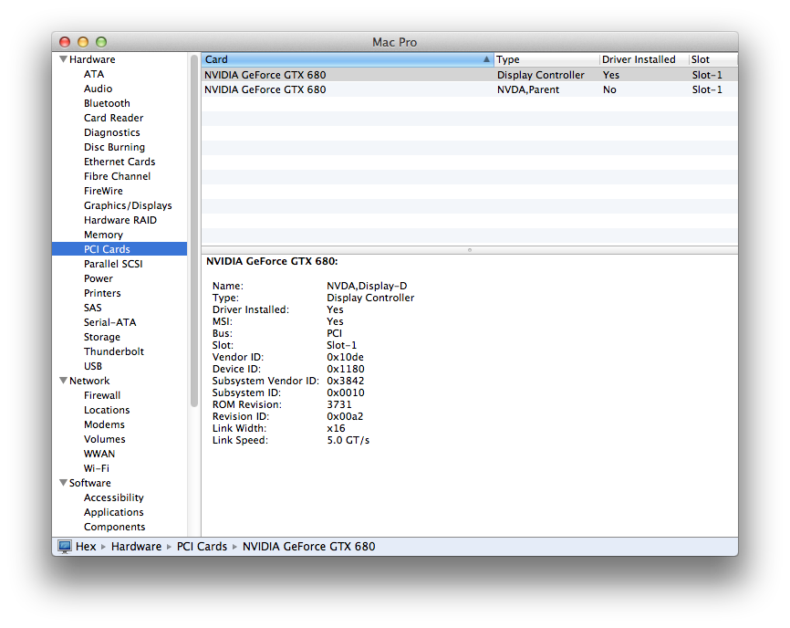

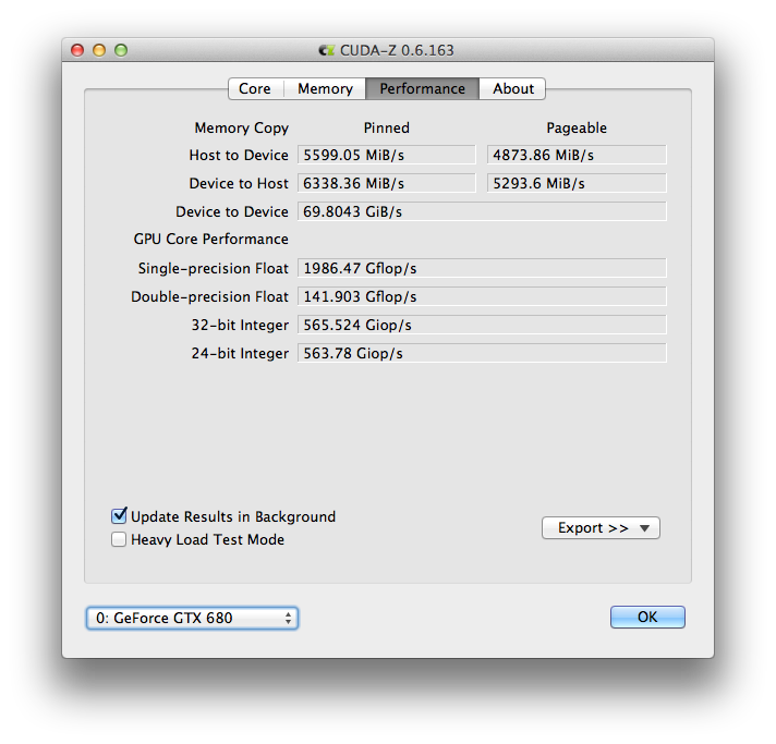

I beg to differ, fouel. These are screensots from a PNY GTX 680 (PNY VCGGTX680XPB), flashed with the EVGA ROM, but otherwise unaltered.
