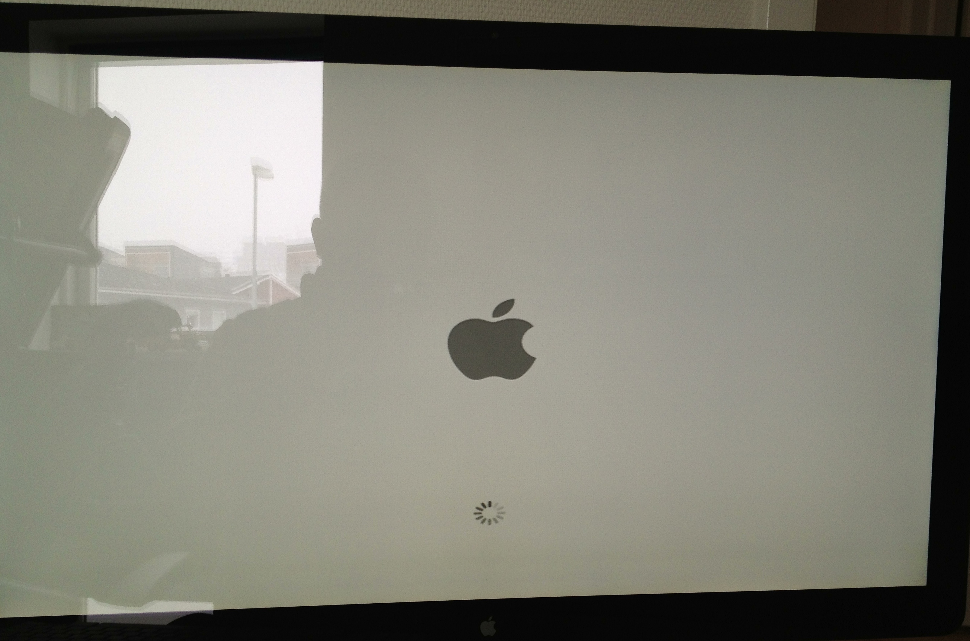

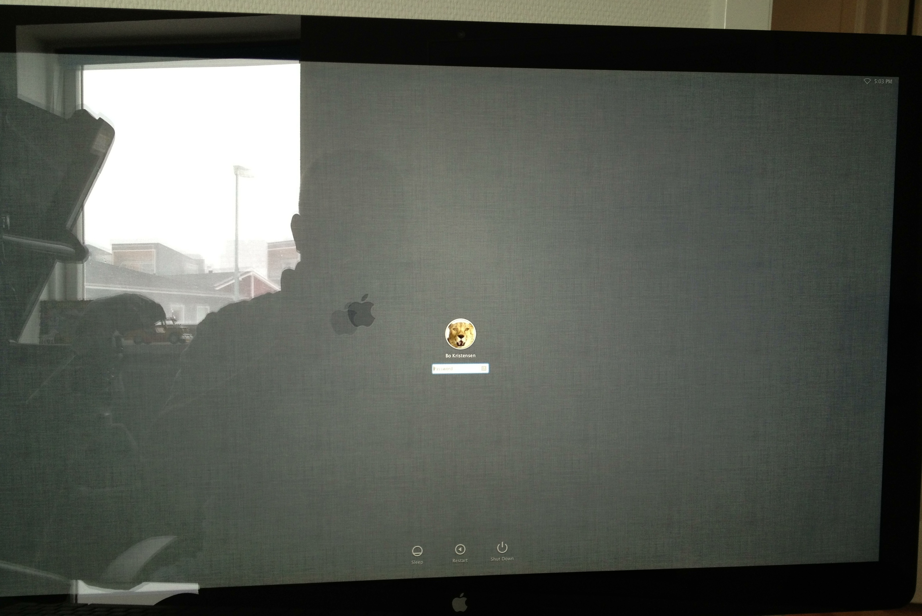

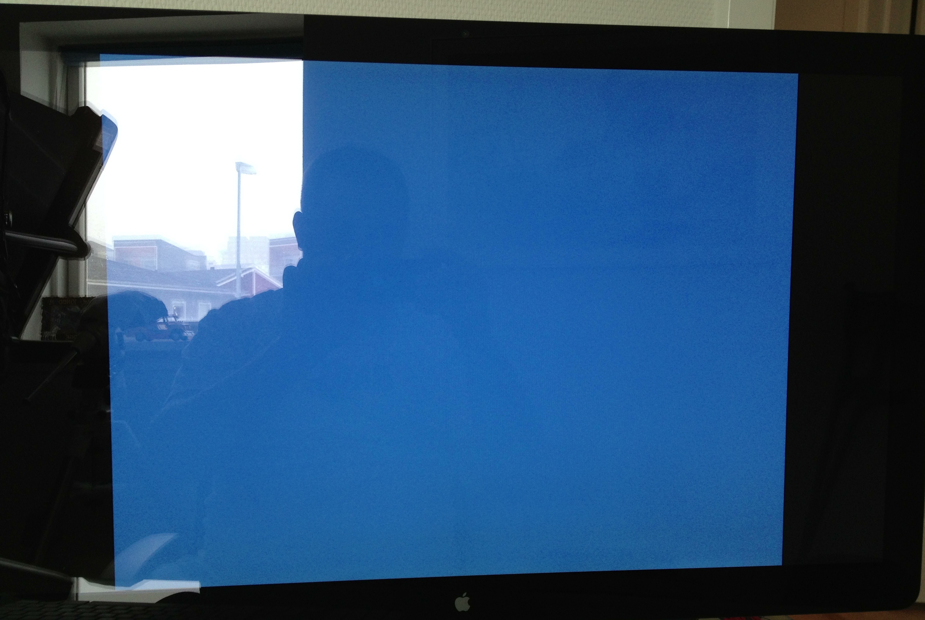

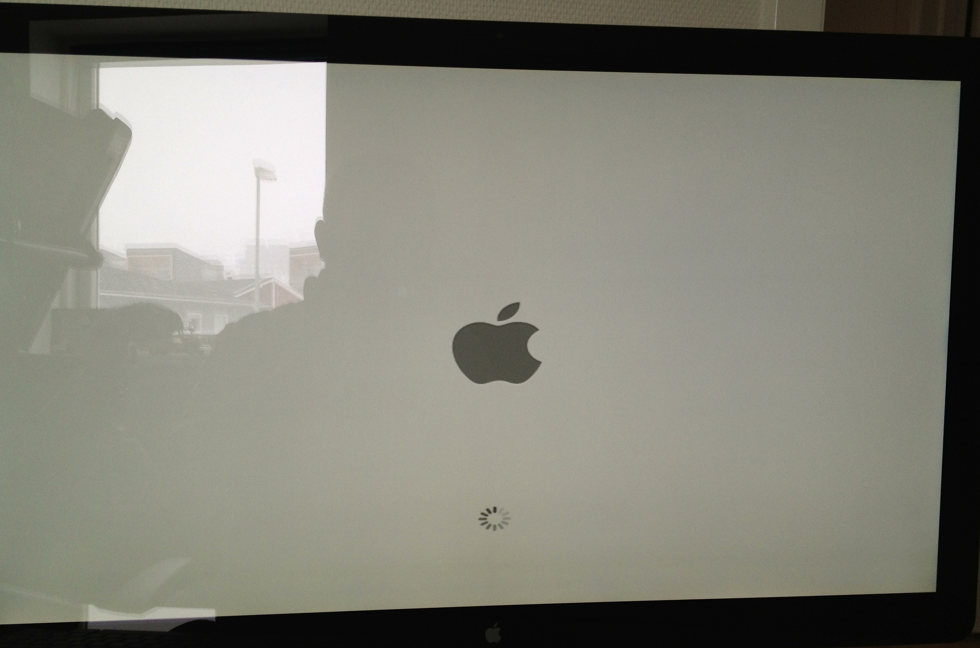

After flashing my EVGA GTX680 SC card with the Mac ROM, it is all working fine in OSX and in Bootcamp Windows 7. I have bootscreen, and full PCIe ver. 2.0 connections.
However, something is bugging me a little bit and that is during the boot sequence it seems like the display is VGA only. Is that normal?
I have attached three images showing the bootscreen. In "Boot #1" you can see the HUGE Apple icon on my ACD 27". In "Boot #2" you see the blue background, but it is showing with thick black bars on both sides. In "Boot #3# it changes to 2560x1440 when the login screen appears. The reason for the shadowed Apple icon is that this comes flying from the lower left corner up to the middle...
Is this normal behavior😕
no it is not, but I don't see any explanation. On the other hand, if it is the only problem, you may just forget it...Otherwise, you may try the usual tricks (zap PRAM...) or re-flash the card with the original ROM and then again with the Mac ROM...good luck

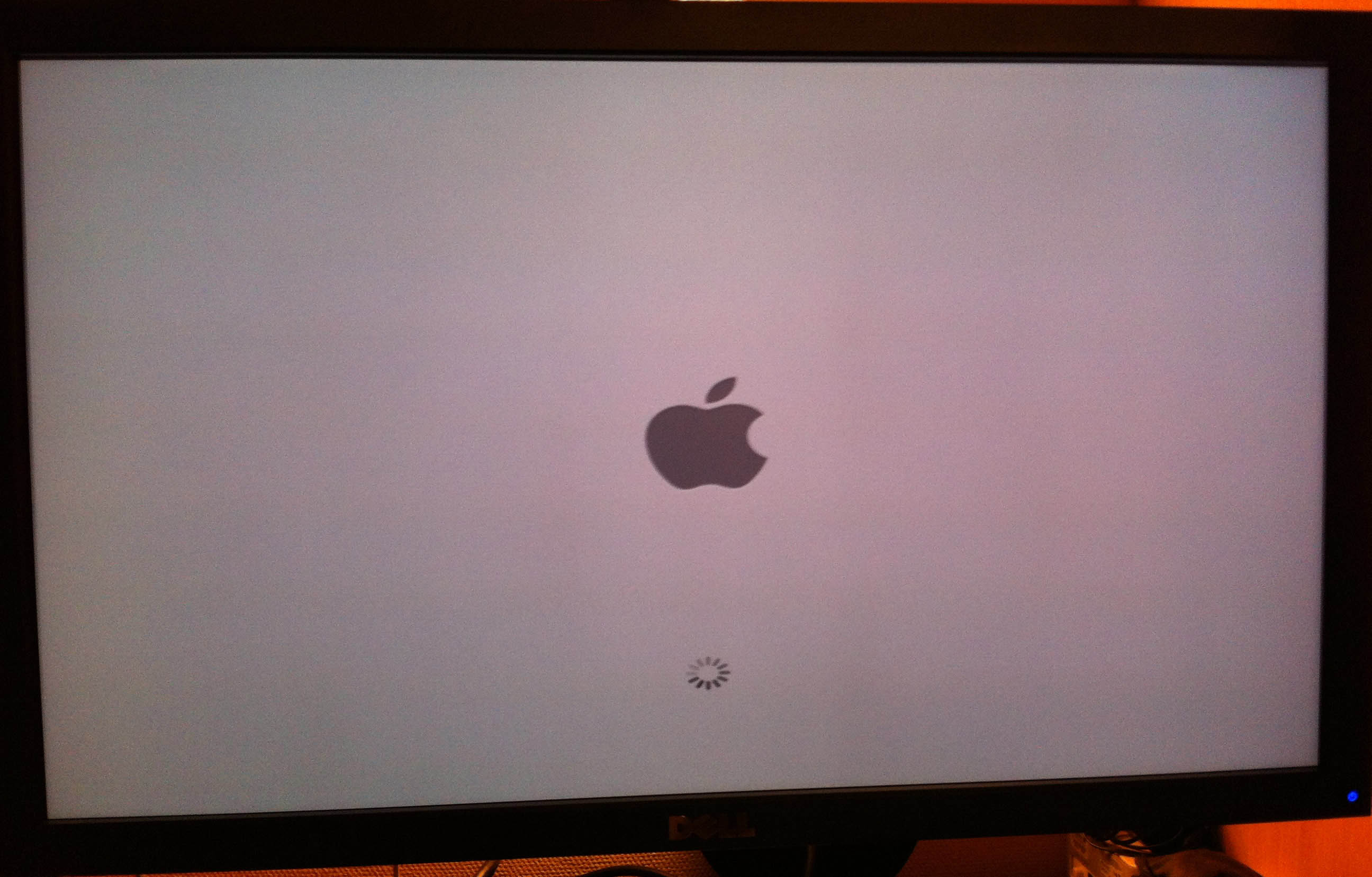

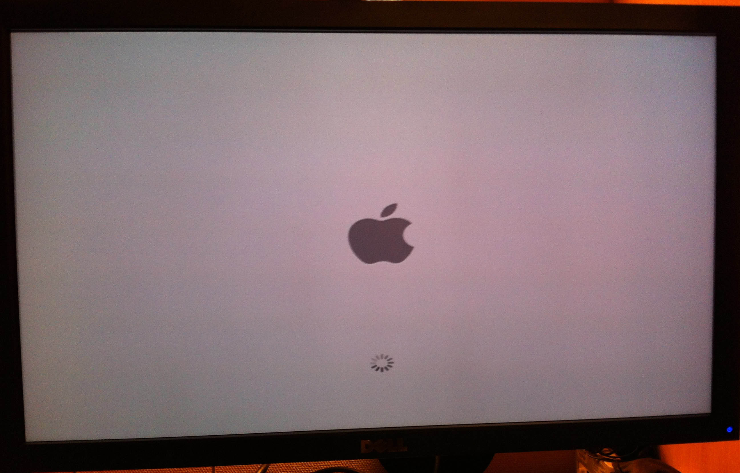

Hi! Killerbob.
Pardon me for the language, not native english speaker.
I got more or less the same thing.
I fleshed EVGA GTX 680 (02G-P4-2680-KR), with rom file from https://forums.macrumors.com/posts/17132316/ everything OK, but i got strange thing too.
When i use DVI, the boot-screen has right resolution, right size icons(right resolution), but mice pointer can move only vertically..
When i use DP, i got boot-screen too, but it has HUGE icons(wrong resolution), and mice pointer can move only vertically(see attachments).
I have Mac Pro 3.1 with OS X 10.8.3, EVGA GTX 680 (02G-P4-2680-KR) connected to Dell U2711(native resolution 2560x1440)
I already asked about that "strange huge boot-screen" here but, unfortunately, got no sensible answer.
I already reflashed card twice, and reset SMC - no changes.

NoNaMeUsEr and Killerbob: If real Mac 680 does not have this issue, it must be caused by slight difference between your cards PC BIOS and original Mac Evga PC BIOS part. It could be presumably corrected by combining original PC BIOS of your cards with EFI part.
MVC or fouel could confirm if the issue is present (or not) on their cards flashed with custom ROMs.
