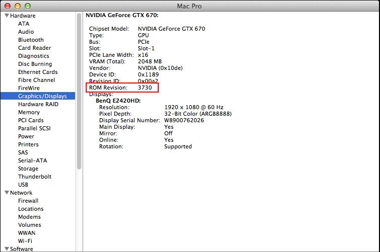

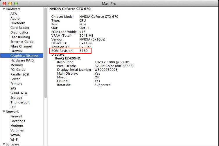

I use Mac K5000 EFI on the pc GTX 670 (reference card) and it works on mac with boot screen (Mac K5000 rom revision is 3730 and Mac GTX 680 EVGA is 3731).
Yes. Maybe all GTX 6xx ,Titan ,K4000 and Tesla K20c could show boot screen with Mac K5000 EFI part on Mac.
Thanks NVIDIA for offering drivers.
