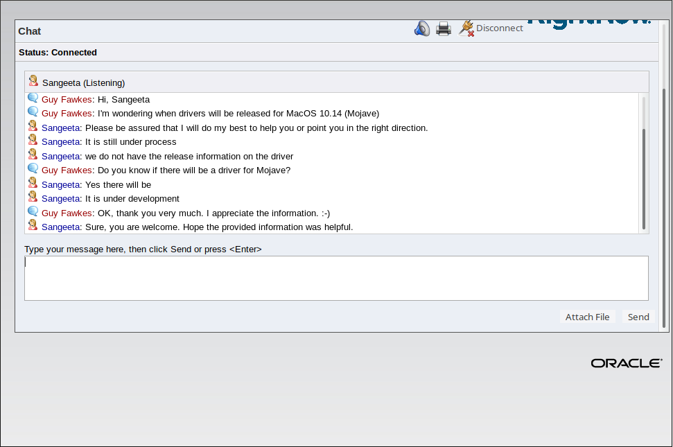

I agree, if that screen shot is real. If I have some time to kill, I might try a support chat with NVIDIA to see what they say.
EDIT: Had a few minutes to kill.......
I'm glad to see their responses are consistent. Just need to wait.
