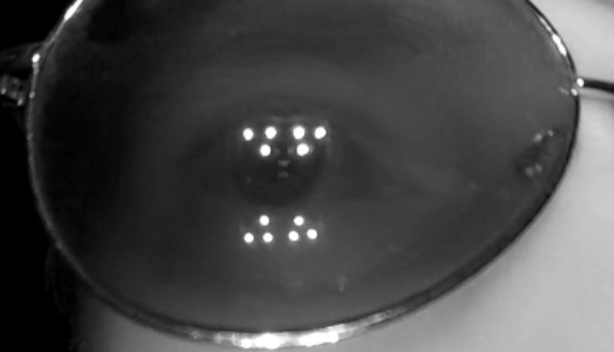

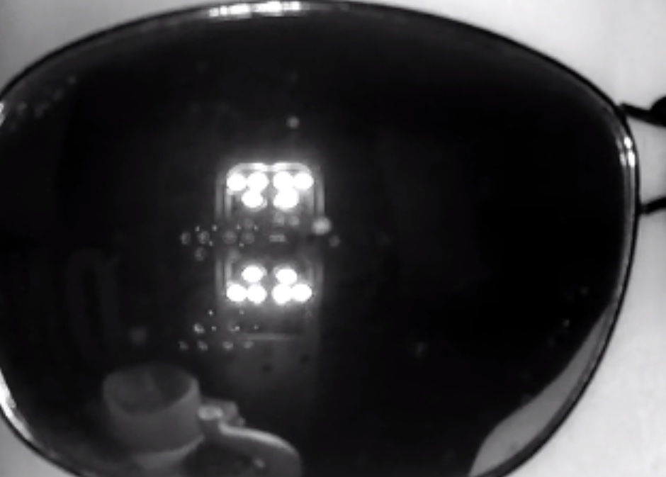

Depends on the lenses. If the are polarized and block infrared (the spectrum of light used for Face ID) then Face ID won't work. If not or at least the polarization doesn't block specifically the wavelength of infrared used by Face ID then it can see right through them as if you aren't even wearing glass.
Here is what the camera sees.
Polarized (decent brand)
Polarized (knock off brand)
The polarized reflects nearly all the infrared lights (12 light reflections). The knock off brand reflects some of the light but not all of it so my eye is illuminated for the camera under the glasses.

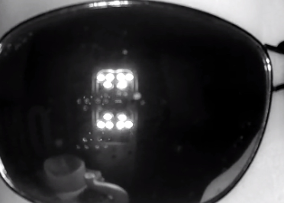

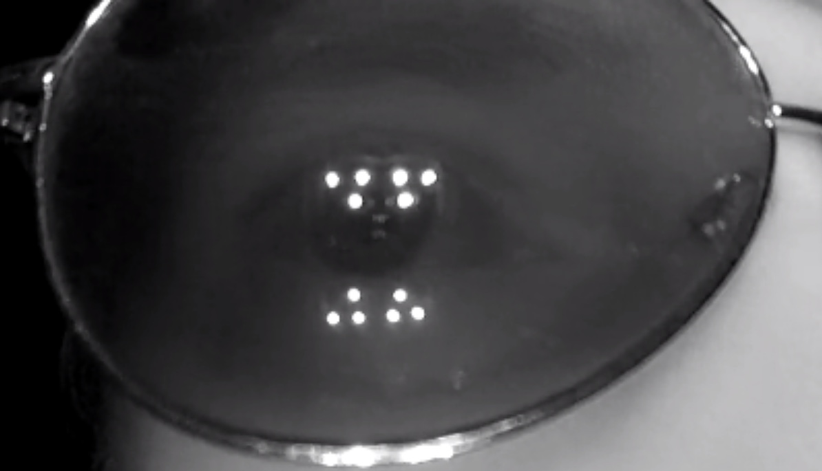

Turn off attention awareness setting might help with sunglasses with polarized lenses because it won't need to see your eyes themselves. Never tried it though...
Thanks for the tip! I never considered this at all. This has to be why. I'd really have to test it all out just for curiosity sake. I mean, I have a set of Oakleys, 3 or 4 different brands aviators, my normal glasses, some crap glasses because I forgot my real ones at home lol, all sorts of glasses and it just those.
