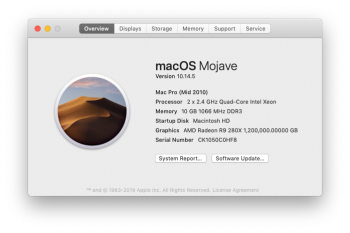

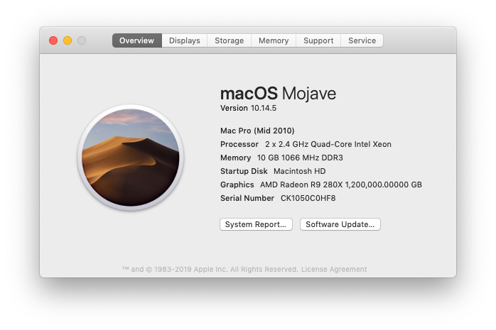

Hi, guys.
Ok, I flashed MSI R9 280x with the boot root from the post #3, it works though with 2 problems:
- White screen when a 4k monitor (Dell P2715Q) connected on boot via mDP. Same problem as here
It boots fine with a 2k monitor connected via DVI. Also 4k monitor works when it's connected AFTER boot from DVI 2k
- About dialog says the GPU has 1.200.000.00000 GB RAM. See screenshot. I have both original bios #1 and #2 both 256kb...The post above says I must read 45 netkas pages... no simple solution ?
Any ideas?
