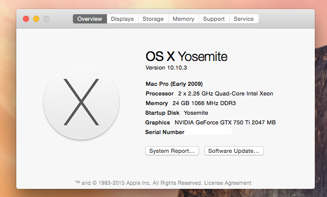

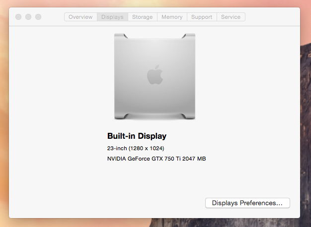

Hey guys!
I spun the wheel and grabbed an Asus GTX 750 TI OC card for my Mac Pro 4,1 yesterday. There have been a few snags along the way. I haven't read all 88 pages of this thread, so it maybe covered previously but I will go over what I discovered.
Firstly, if you do get an overclocked 750 card it will require 6 pin PCIe power. The original Radeon 4870 that came in my mac has its 6 pin power connection at the opposite end to the DVI connectors. The Asus GTX 750 TI has its 6 pin power connection on the top edge of the card just behind the DVI connectors. You will need a 6 pin PCIe power extension cable! The two that come inside a mac pro 4,1 are only about half as long as they need to be.
The second issue I have hit is a bit of a doozy, but it is something that I should have been aware of having spent the last 4 years dealing with similar problems in the world of hackintosh computers. Not every card is made the same. An Asus GTX 750 TI will differ to a Gigabyte GTX 750 TI which will differ from a MSI, etc, etc. You will find a large amount of info on this if you search for hackintosh related threads with the GTX 750 TI. I went through similar things with an Asus GT 430 prior to the drivers being included with Lion. What you will find is the bios/firmware within each manufacturers card is inherently different and will work in different and slightly less predicable ways.
I only get a black screen. My Asus GTX 750 TI has installed correctly, confirmed via screen sharing. The latest web & cuda drivers are installed and all appears as normal except that the detected display is appearing as some kind of internal display. The Asus GTX 750 TI contains a number of video outputs. Thus far I have only tried HDMI and DVI outputs - I will buy a VGA -> DVI cable in the coming hours to see if the card will function using the VGA output.
Does anyone have an thoughts about this? When using the GT 430 under snow leopard a chap posted several lines of code to add to your hackintosh's DSDT which would allow use of all of the video outputs on the card. Could it being something simply to shake the GTX 750 TI alive on all its outputs? Members of the hackintosh community have also claimed success by flashing various GTX 750 TI cards with the appropriate Palit GTX 750 TI bios.
I have attached some screenshots of how my system is appearing.

Your issue has to do with display routing in the rom.
It is possible that another BIOS rom will have a better mix for OS X. The trick will be finding one that works on that card. I would suggest looking on the VGA database and find one with same clock speeds and ports.

Just an update on my Asus GTX 750 TI OC findings.
VGA works as standard straight out of the box. It is the only video port on the card that functions though.
Flashing the card with a rom from the Palit GTX 750 TI has disabled the one VGA port, but now allows dual monitors to run on one of the DVI ports and the HDMI port.
Can't complain about that. I could try other roms to see if I can get more ports working, but this is fine for now.
Moms were found here: http://www.techpowerup.com/vgabios/...model=GTX+750+Ti&interface=&memType=&memSize=
I used the most appropriate based on the I/O of the card, and the stock rom it shipped with.
ie: the asus came with firmware 82.07.32.00.20, as viewable in 'about this mac's' system report.
I replaced it with 82.07.32.00.60, rather than the 82.07.25.00.82 that is available for the same model card.
Its the first time I have ever flashed a card before. Took about 10 minutes, including installing and removing the card. Its pretty straight forward if you can follow instructions and aren't scared of the windows command prompt.

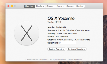

Hello,
I am new the group and looking for help with my 2GB Asus GTX 750Ti OC video card.
I have a Mac Pro 4,1, running a Nvidia GT 120 and the new GTX 750Ti. Problem is, I only get a black screen with the 750Ti on all ports (DVI, HDMI, VGA).
I have Yosmite 10.10.3, and have downloaded the latest Nvidia video driver and CUDA files. I had the files downloaded before I installed the 750Ti. I have even tried the Apple drivers with 10.10.3.
I have tried resetting the PRAM, I have tried the 750Ti in slot 1 and slot 2...nothing. This is very frustrating.
Does anyone know how someone new to the "PC-card in a Mac" can make this work? Has anyone been successful with the same video card?
Even more frustratingly, I had better video performance with my ATi 1900XT on my old Mac Pro 1,1 than with the GT 120 on a 4,1.
Thx
Tim

All I can say is that I find your situation rather odd. Most folks can get a PC card running without much difficulty. I've read that the Maxwell graphics processors require the drivers from Nvidia's website, but they should work fine once those drivers are installed. You probably mentioned this, but did you try using the VGA port with the card in either the bottom slot or the top slot? I forget which, but it might be either the first slot or the bottom one which usually works. It almost seems like people are having an easier time with external graphics cards than internal ones.
I'm sorry I couldn't be more helpful.

Yeah, this is why I find it so confusing. I've followed the instructions as I have seen them posted. There seems to be no reason why it doesn't work essentially right out of the box. I have all the current Nvidia files, current OSX, no cabling issues, no monitor problems and it just won't display.
I'm not an expert, but I've tried a number of methods outlined here. I'm really out of ideas at this point. I though it could be a 10.10.3 issue, but there's new Nvidia driver/CUDA files since the release. I'd be interested in hearing some other user experiences with 10.10.3 and the latest Nvidia files. A lot of posts predate these releases.
I think the best course of action would be to return the GTX 750 Ti and buy an older card, like a GTX 670.
