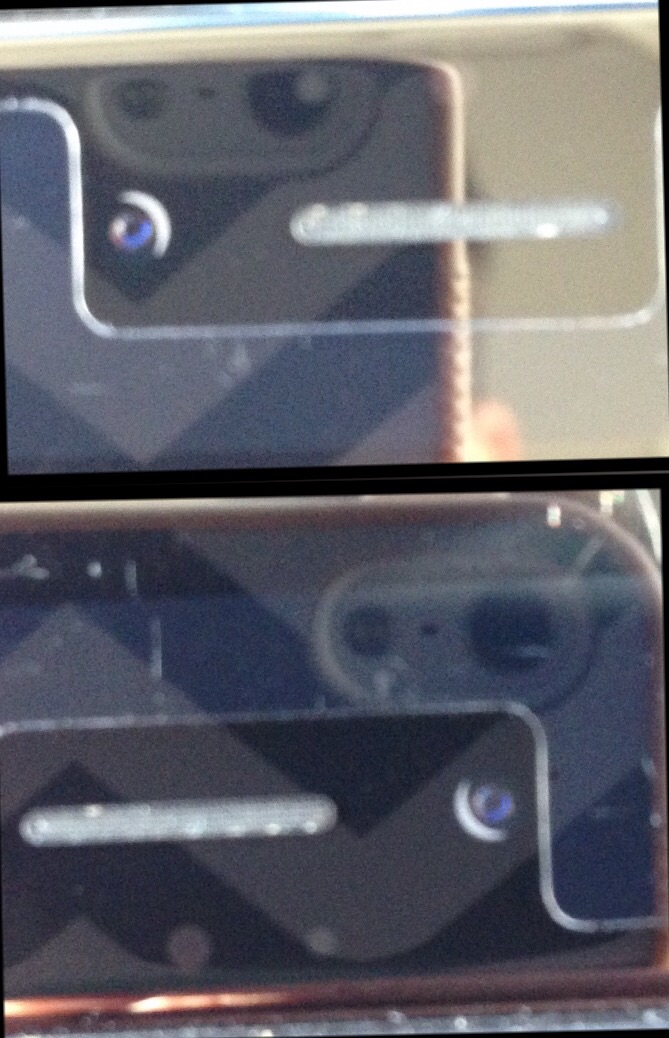

I know, crappy photo quality. But you can see nevertheless. I took a photo, and then rotated the phone 180degrees so you know the lighting angle had nothing to do with it.

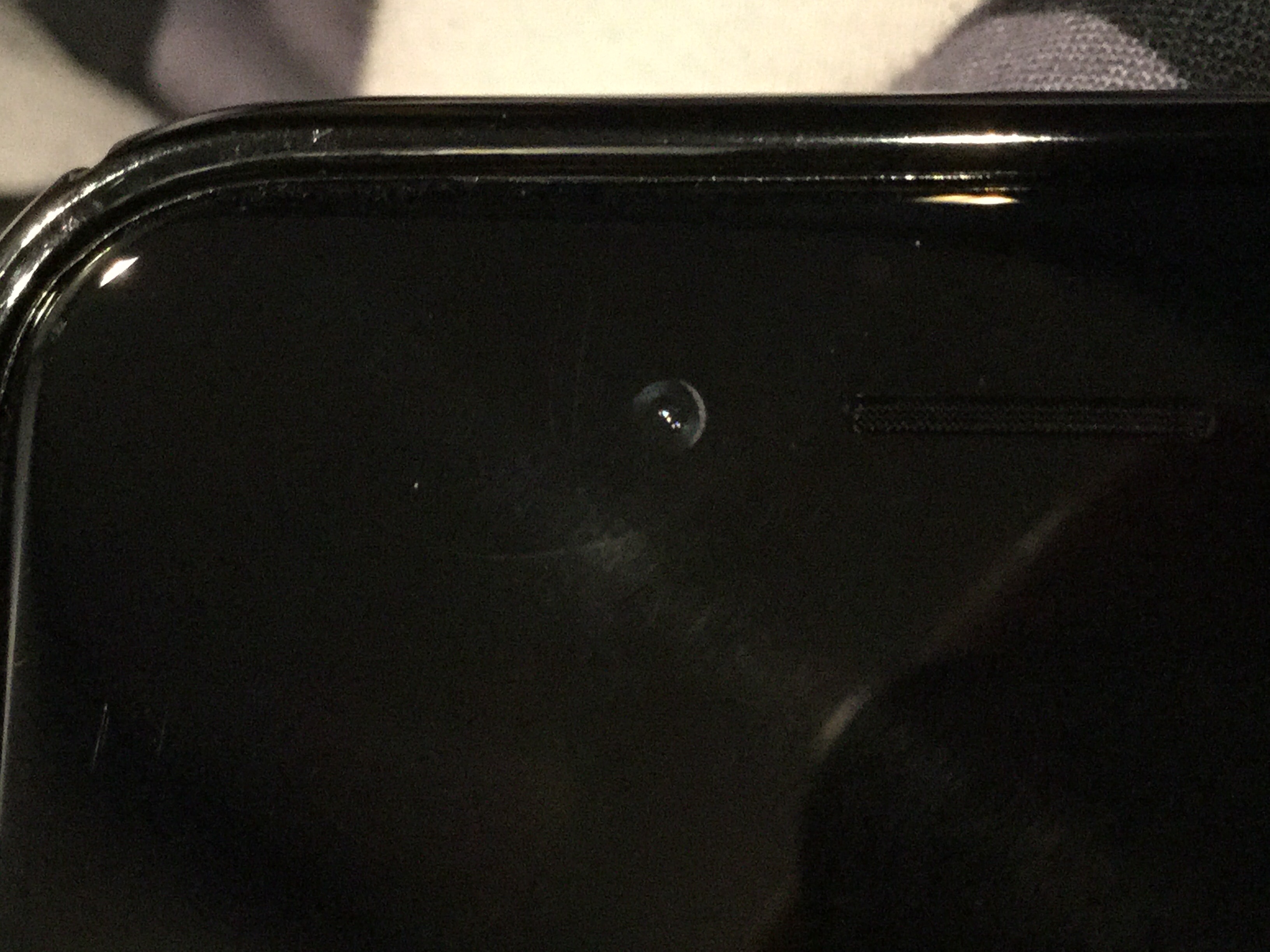

I know the pictures are really bad, it's just that he camera won't focus when I'm this close to the phone.... I have attempted taking another picture which has think is better...it's probably just as bad but I can't do better than this..
