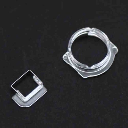

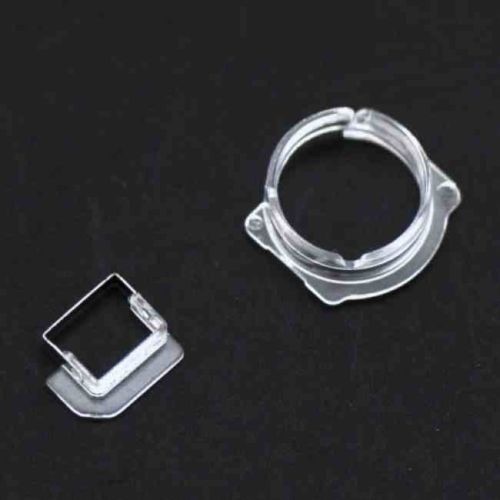

Not quite; the front camera module connects to the mainboard by flex cable, but is kept against the glass by a metal bracket screwed down to the plastic midbezel. A plastic alignment bracket is glued to the glass so the camera rests in the mount and aligns with the "hole" clearing on the glass. A foam grommet keeps dirt from slipping into the cam view, and protects it from shock.
What you are seeing is the edge of the module itself that the user is not supposed to see. I've posted a pic of the plastic bracket the cam module rests in for an iPhone 5, but I'm sure the design is similar to the 6.
I've taken apart a few iPhone 5 models for screen repair, and one of the most difficult tasks for me when putting them back together is keeping the front camera module aligned. The module keeps slipping when the metal bracket is screwed down against the module, especially if the plastic allignment bracket is not securely glued to the glass. Sent from my iPhone.
