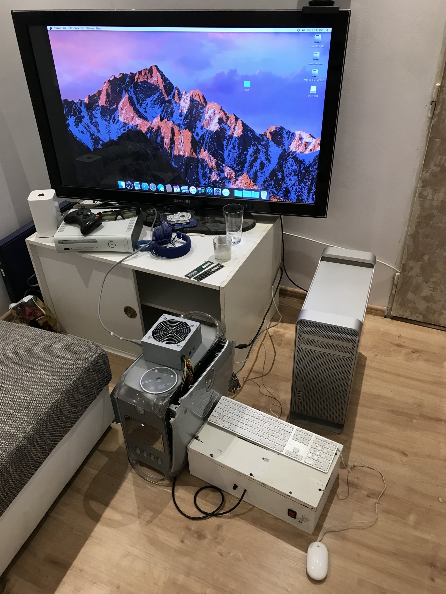

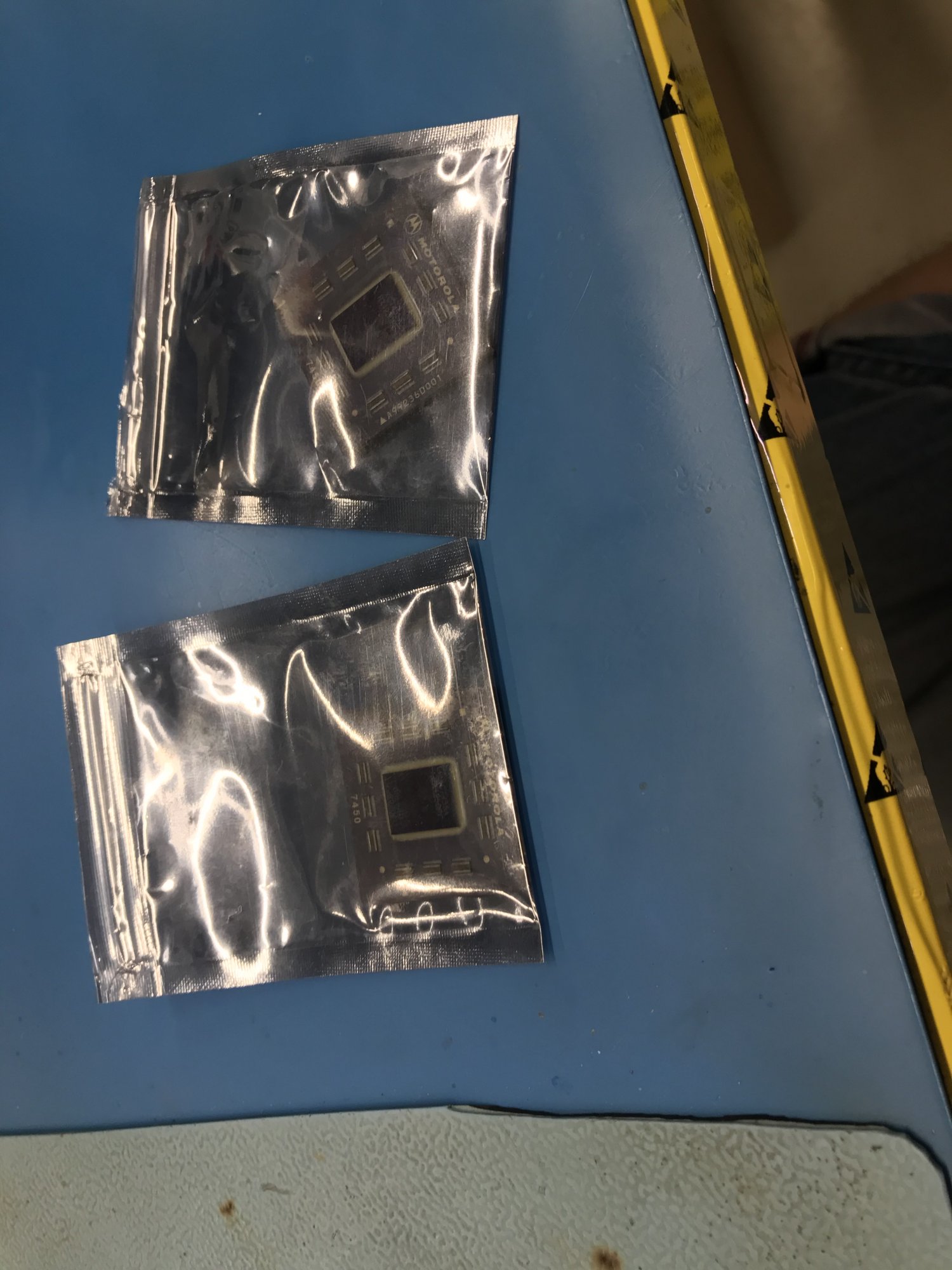

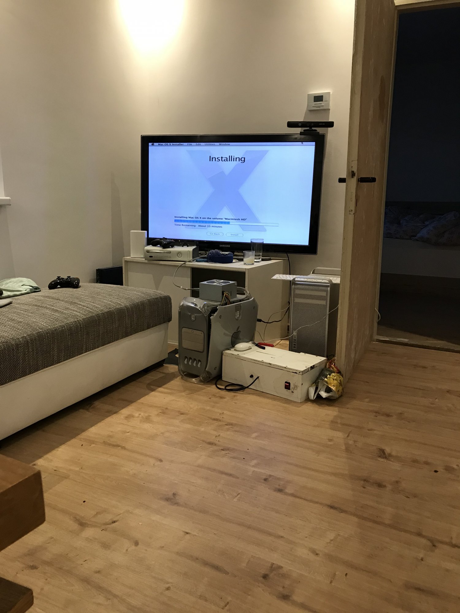

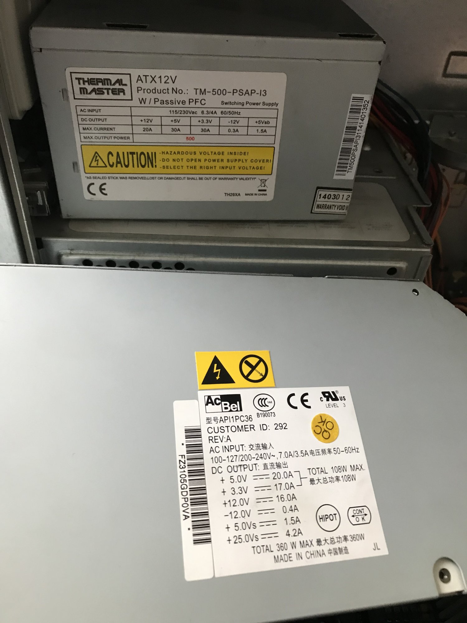

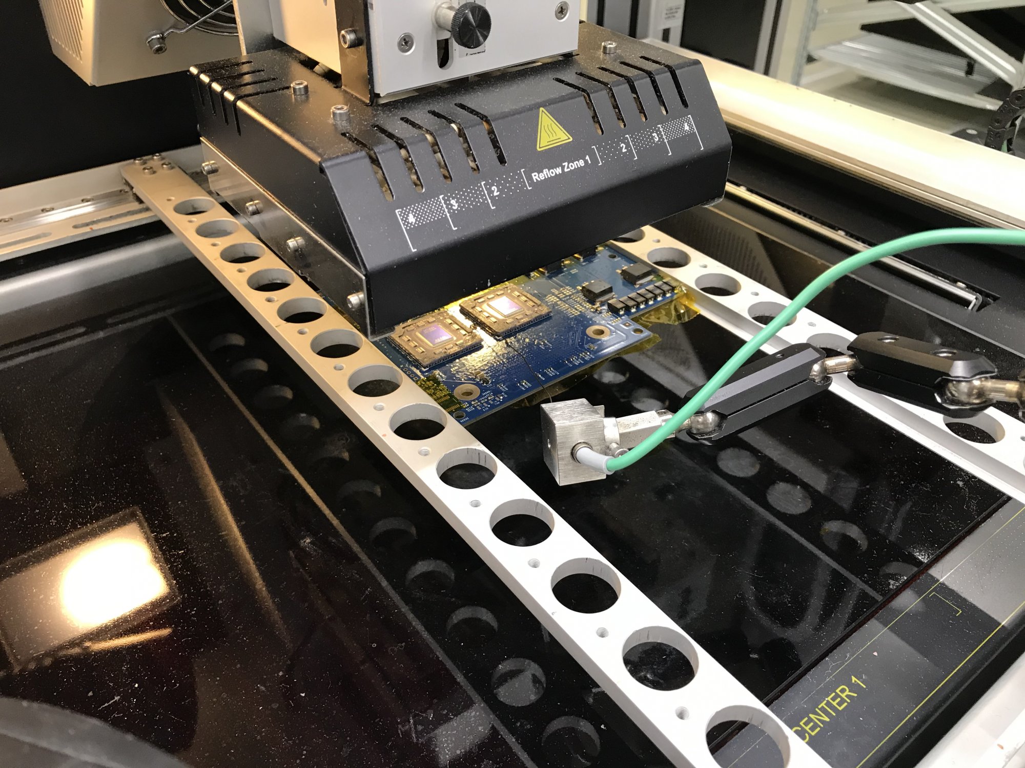

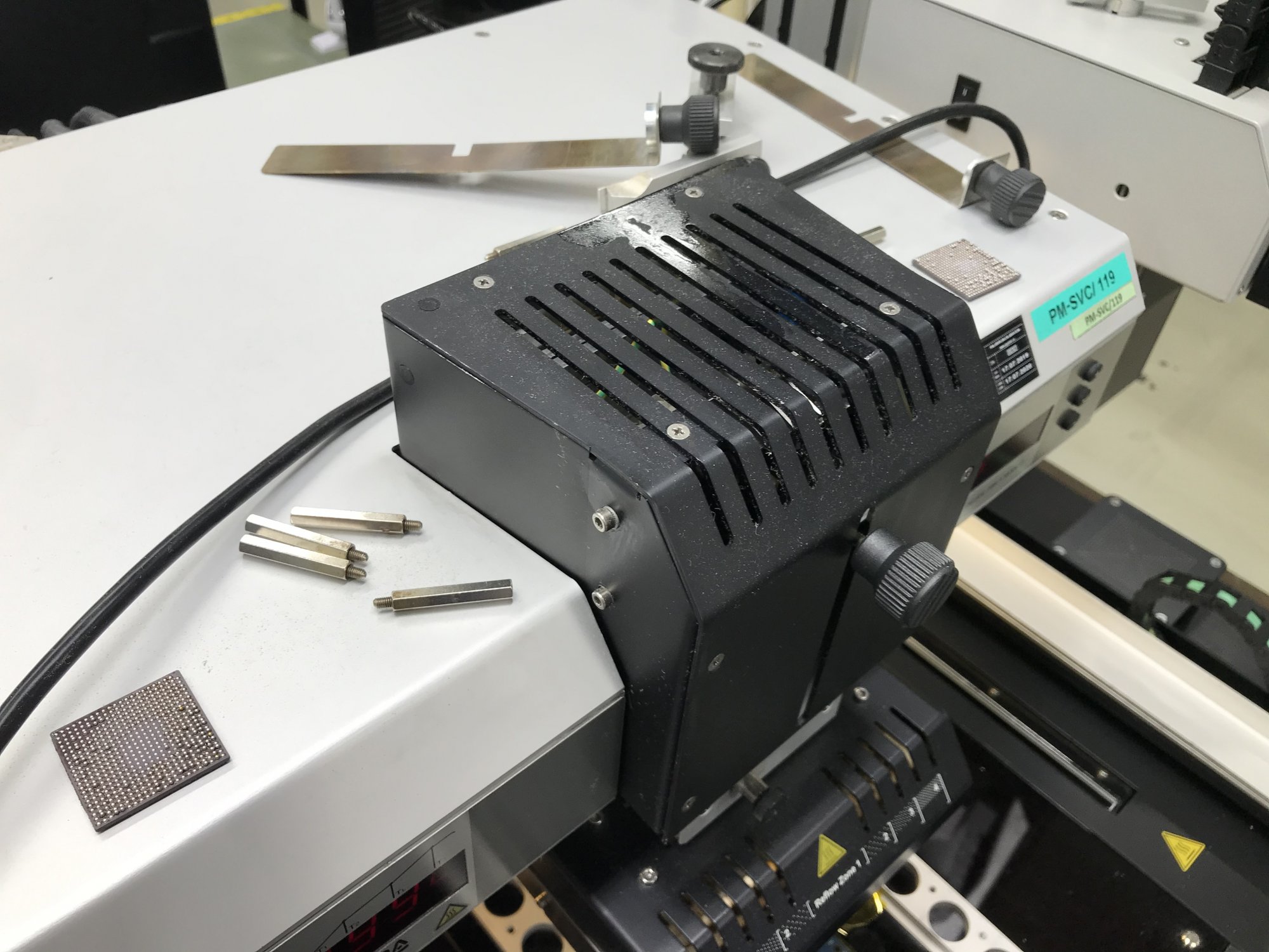

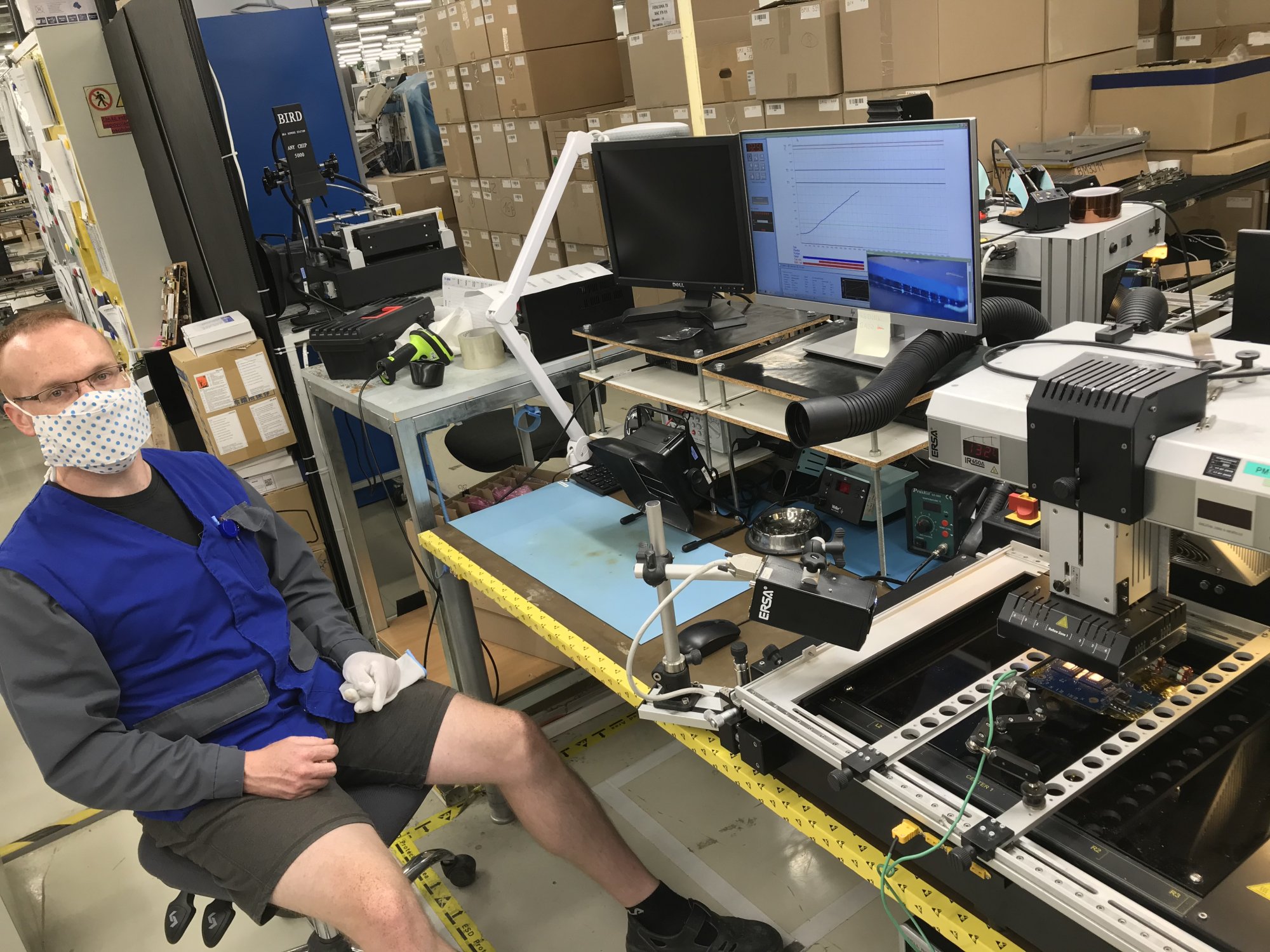

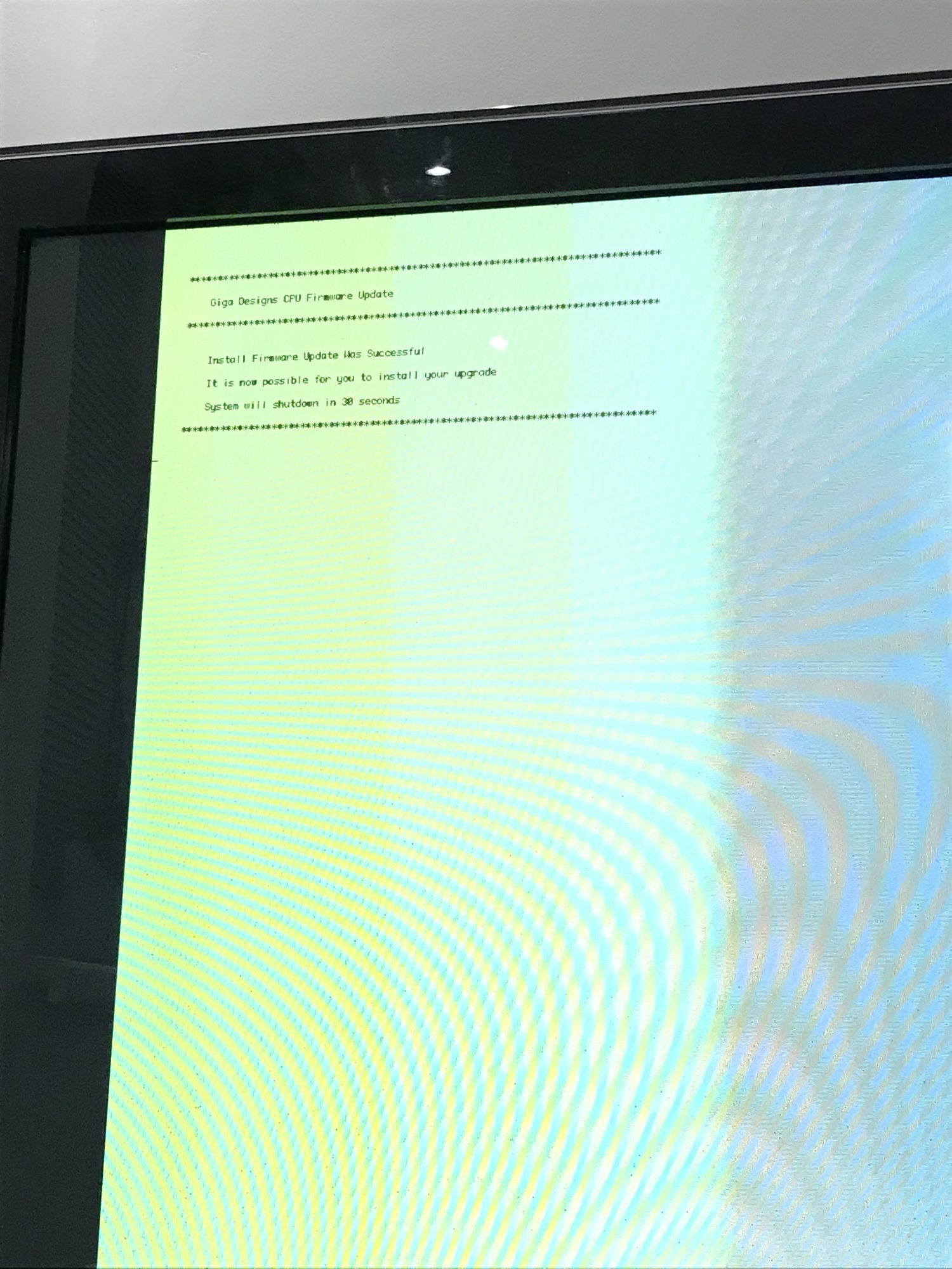

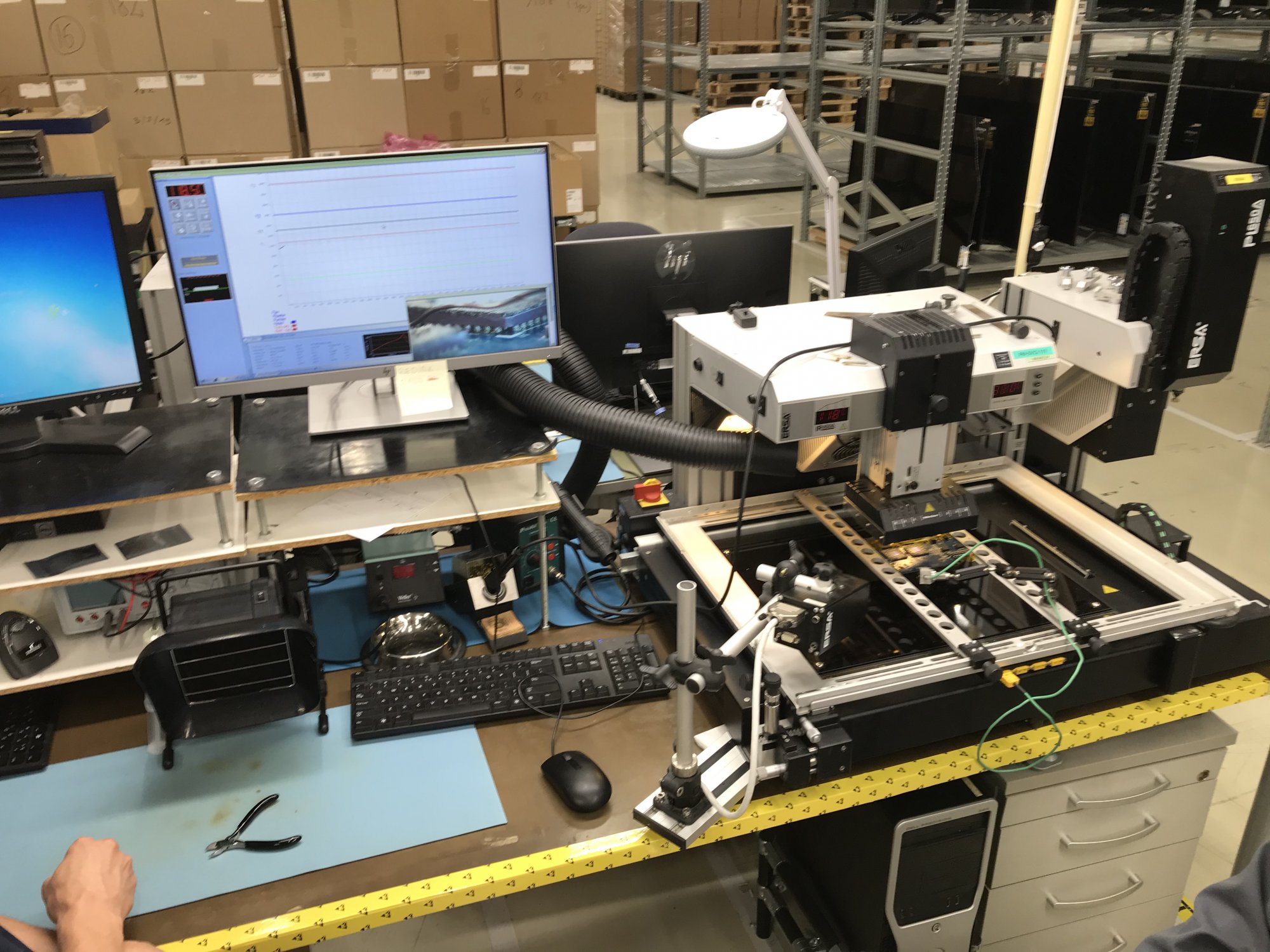

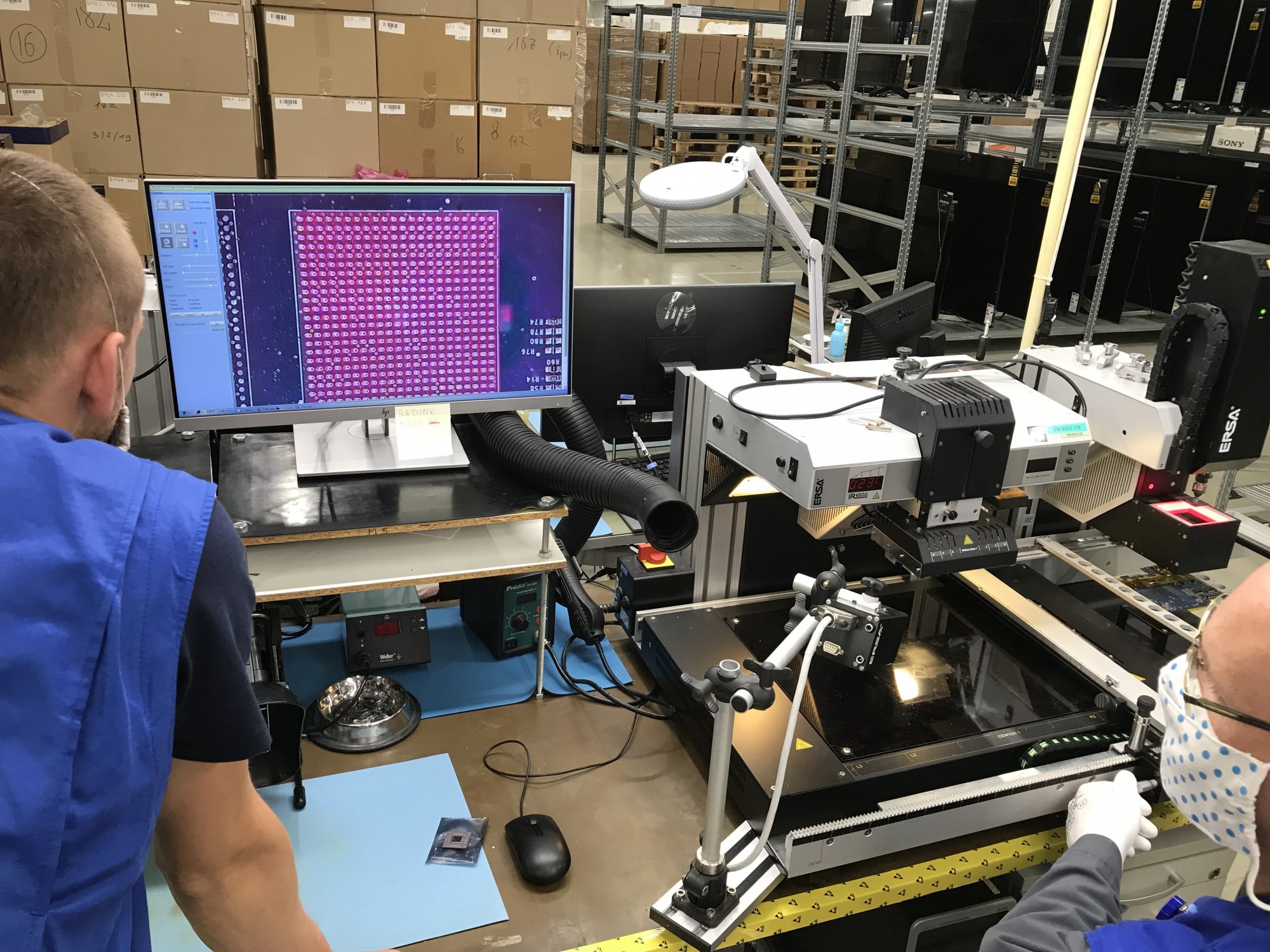

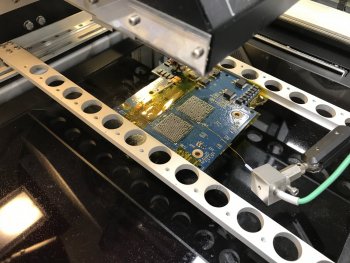

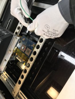

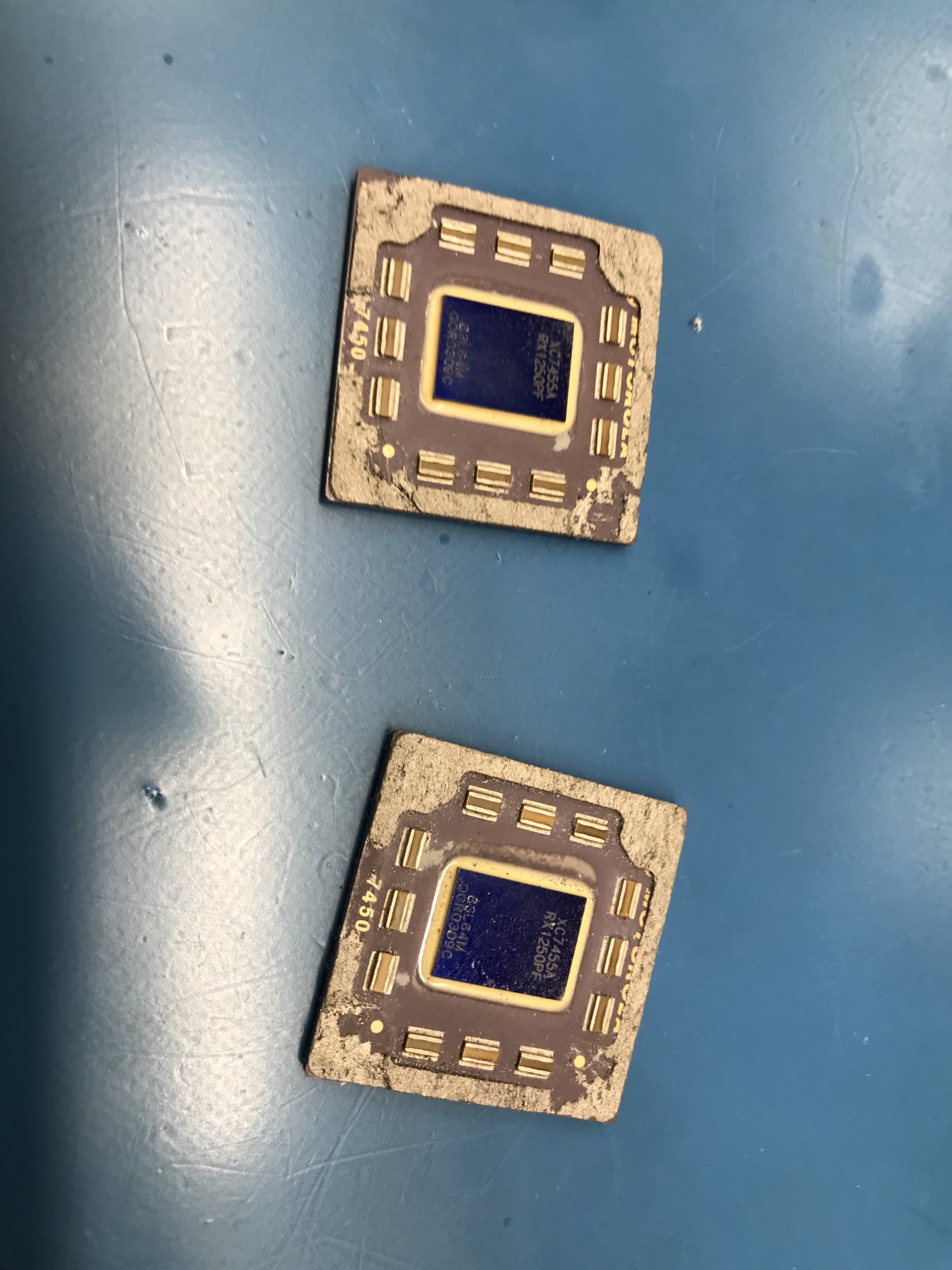

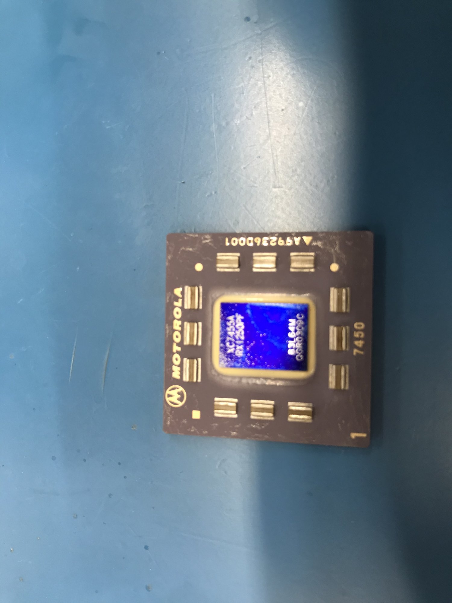

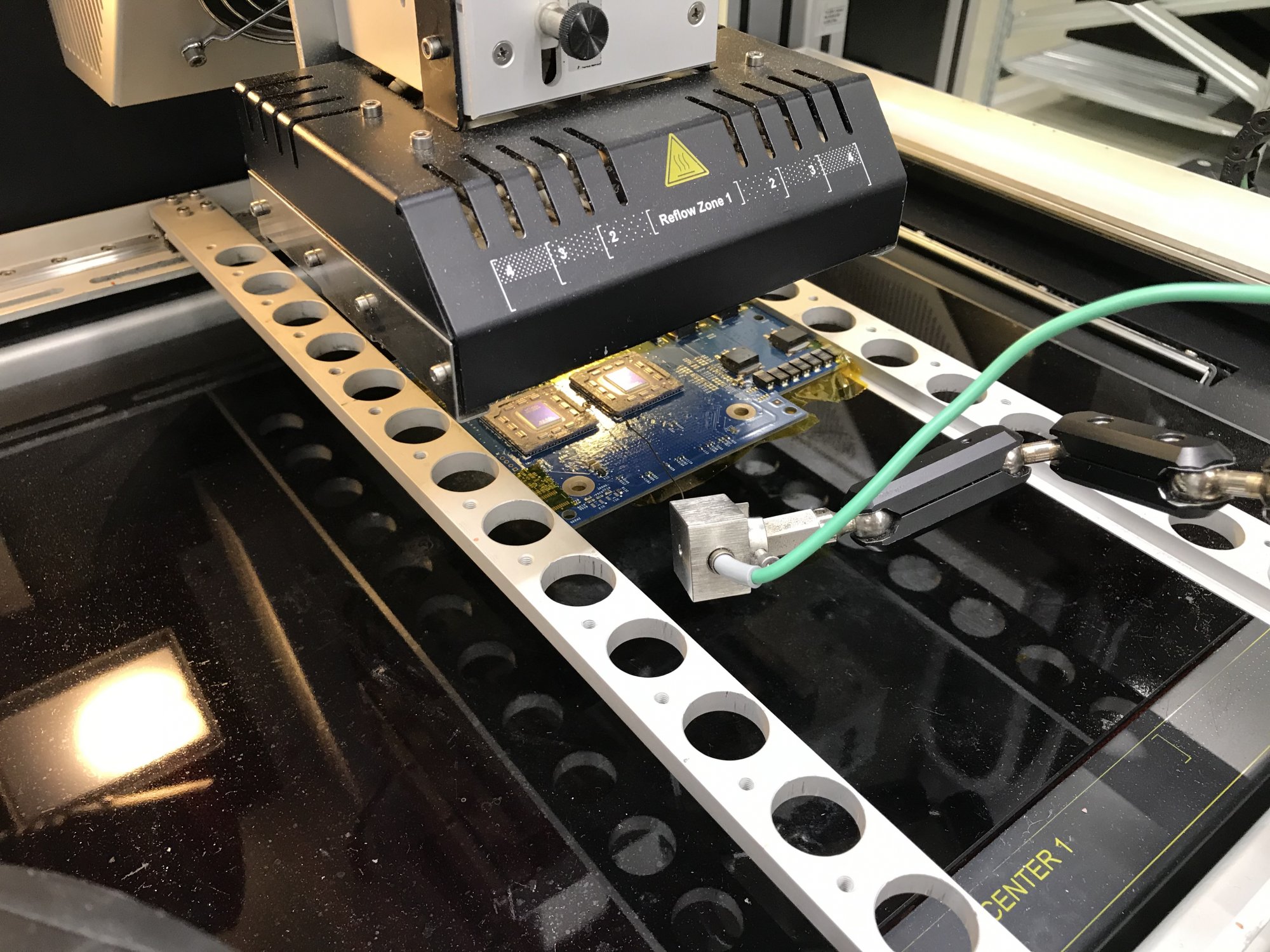

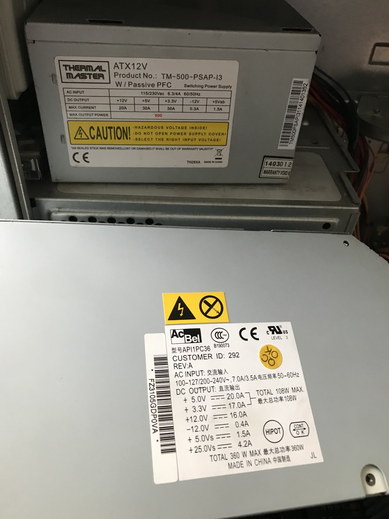

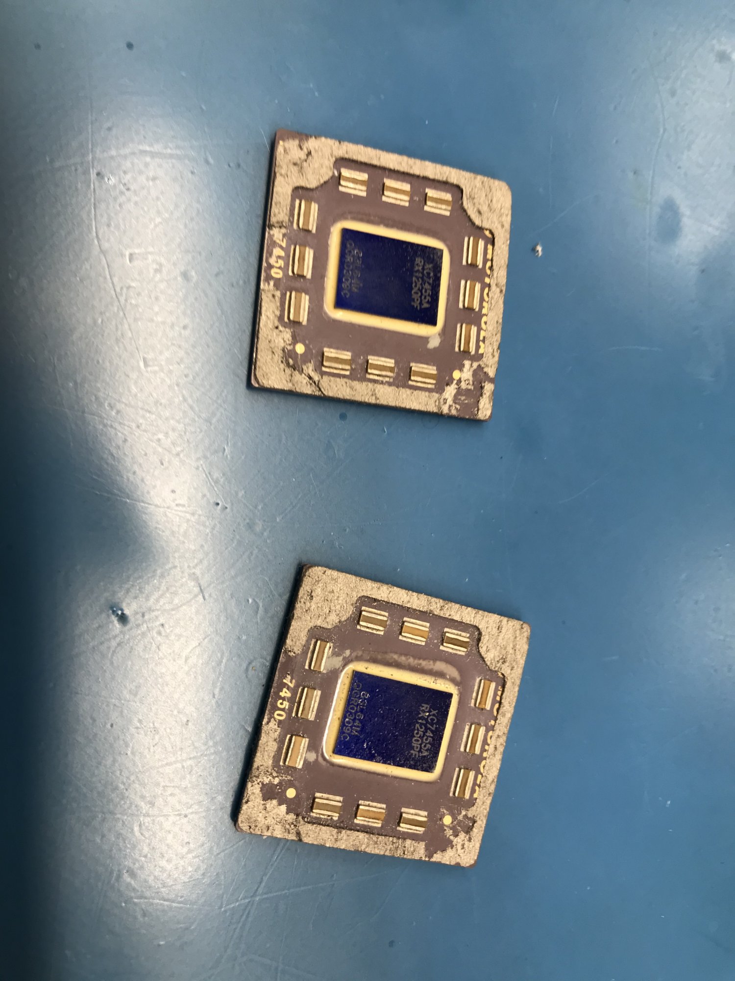

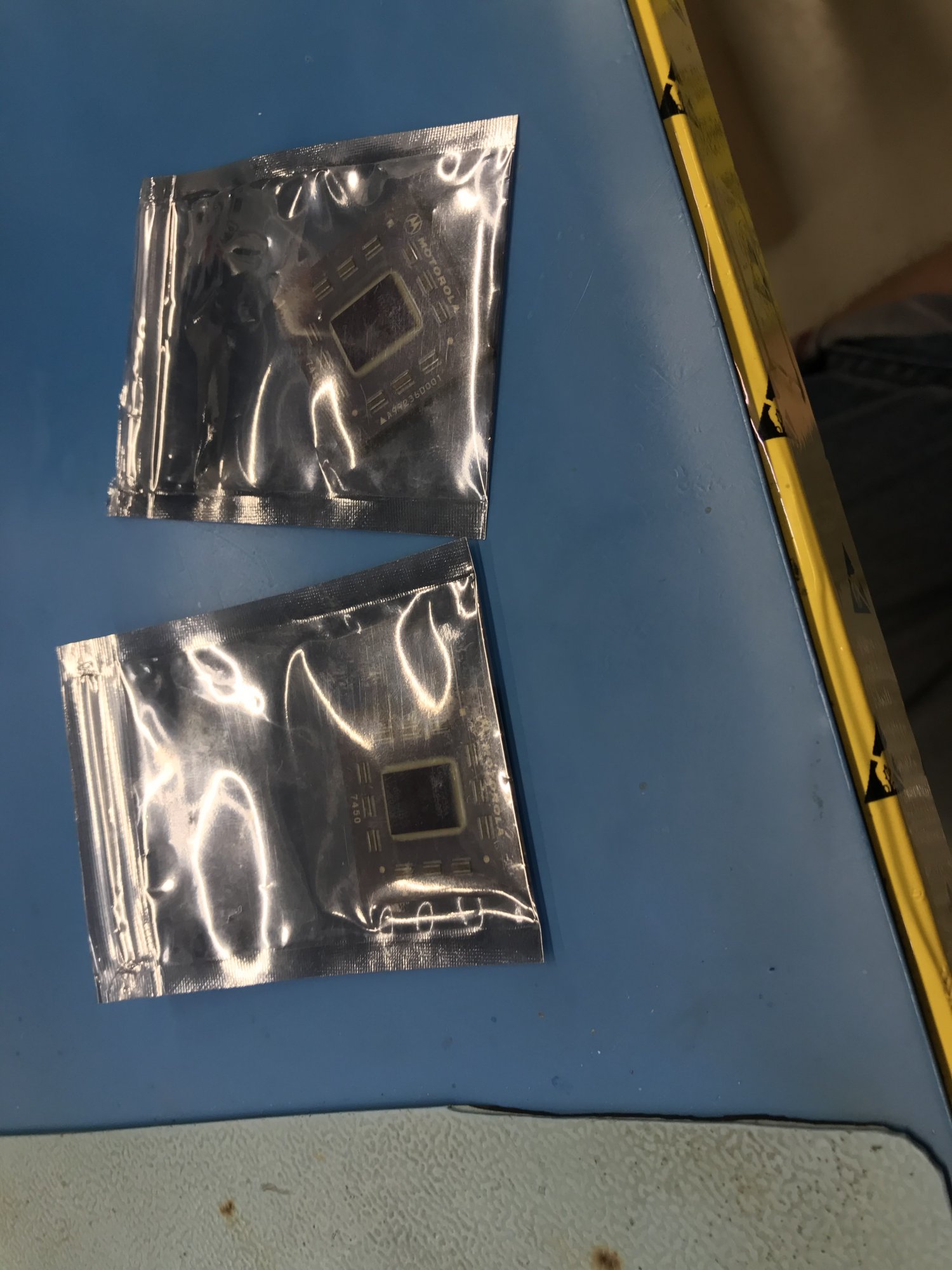

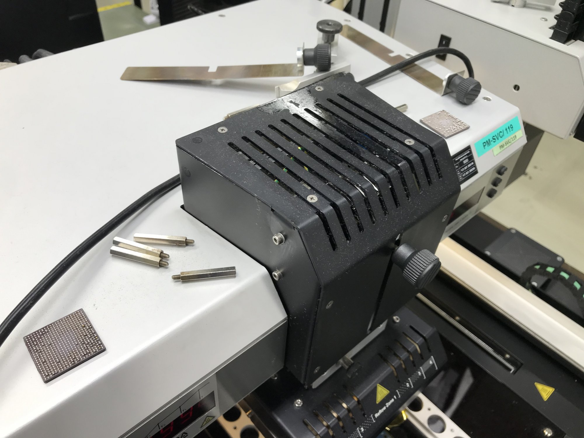

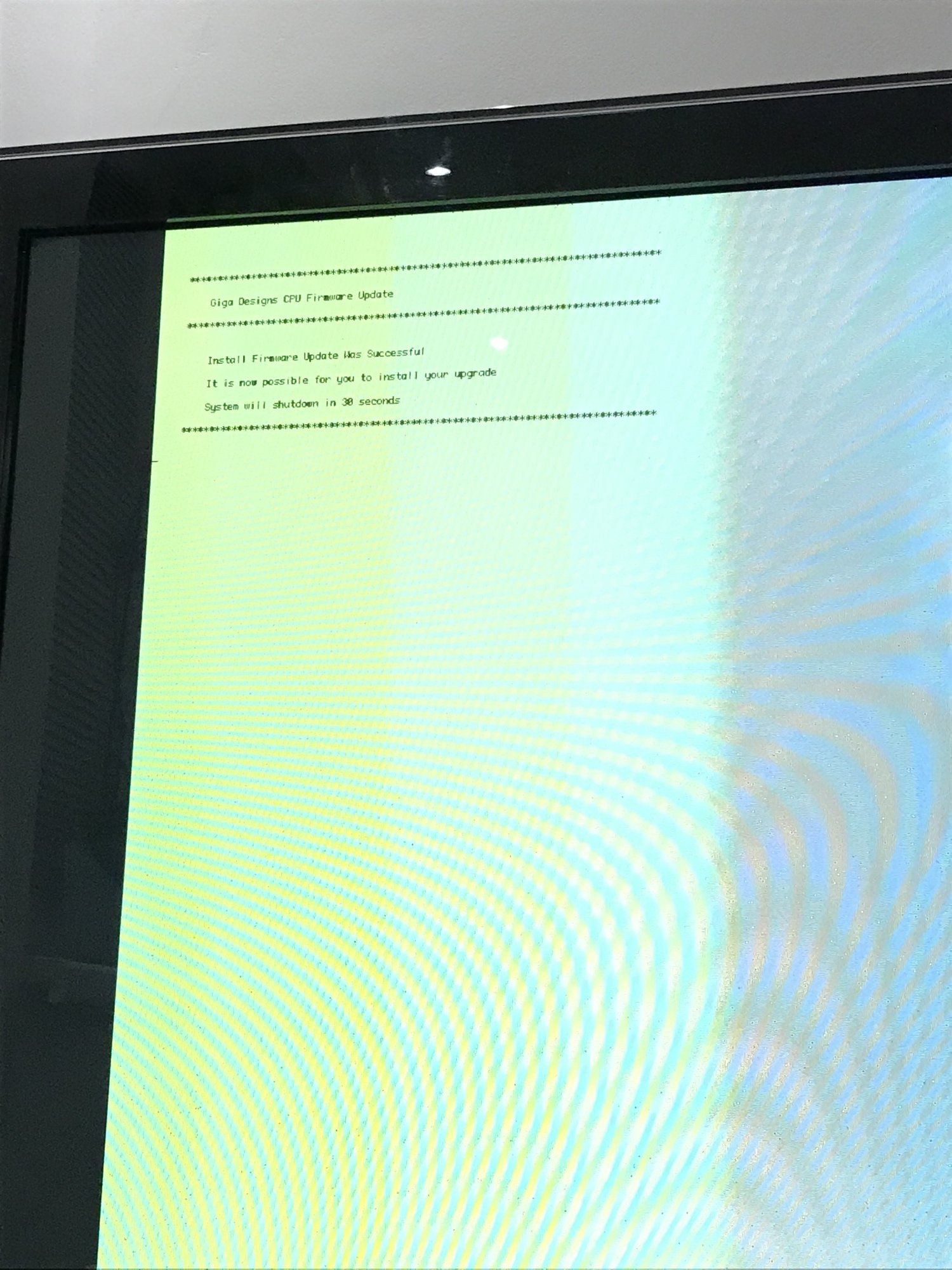

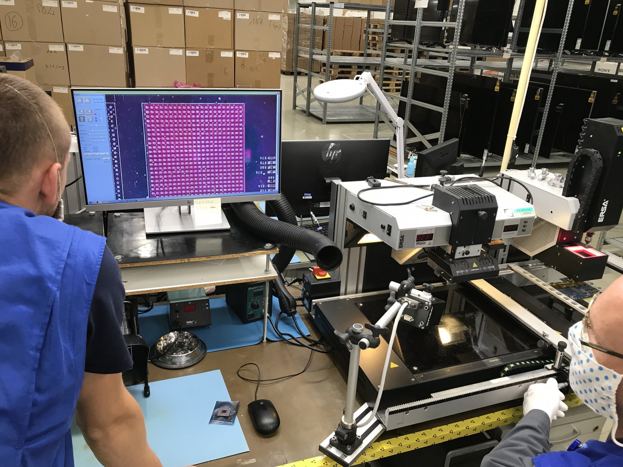

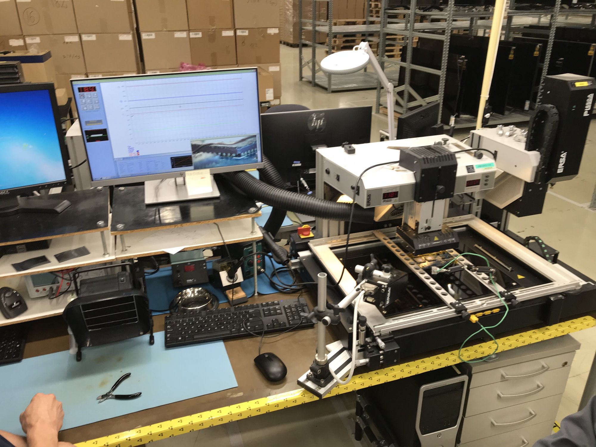

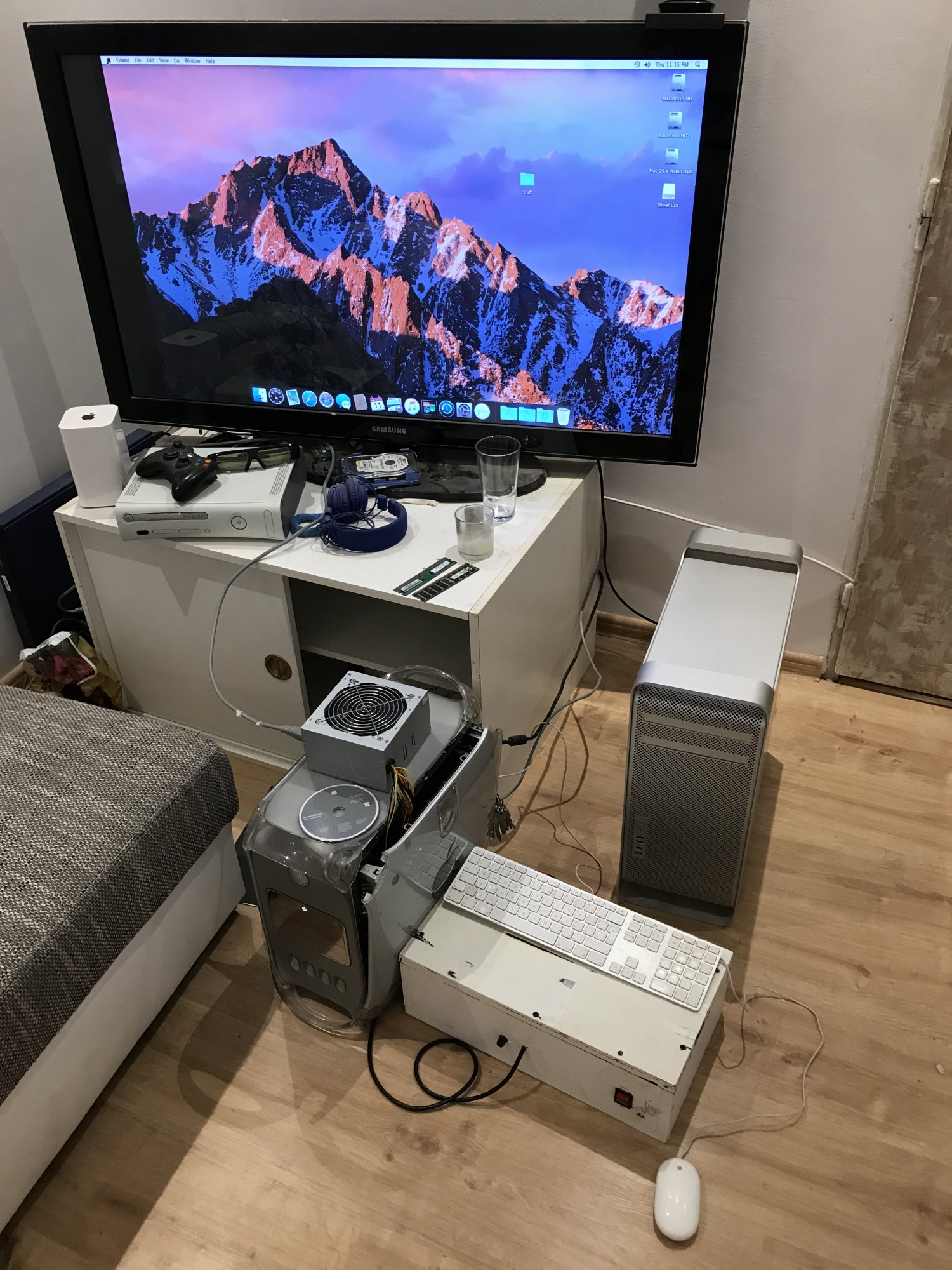

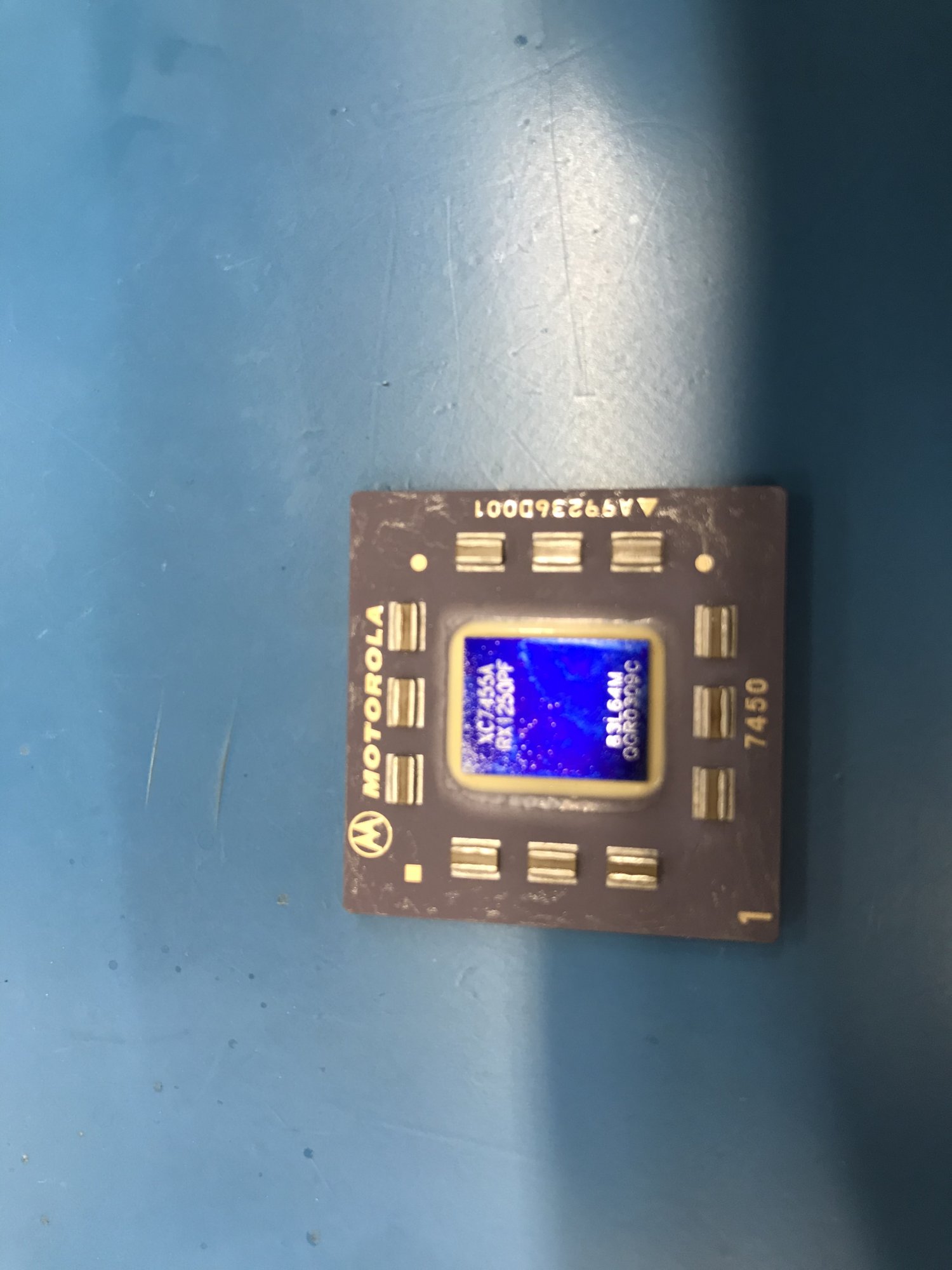

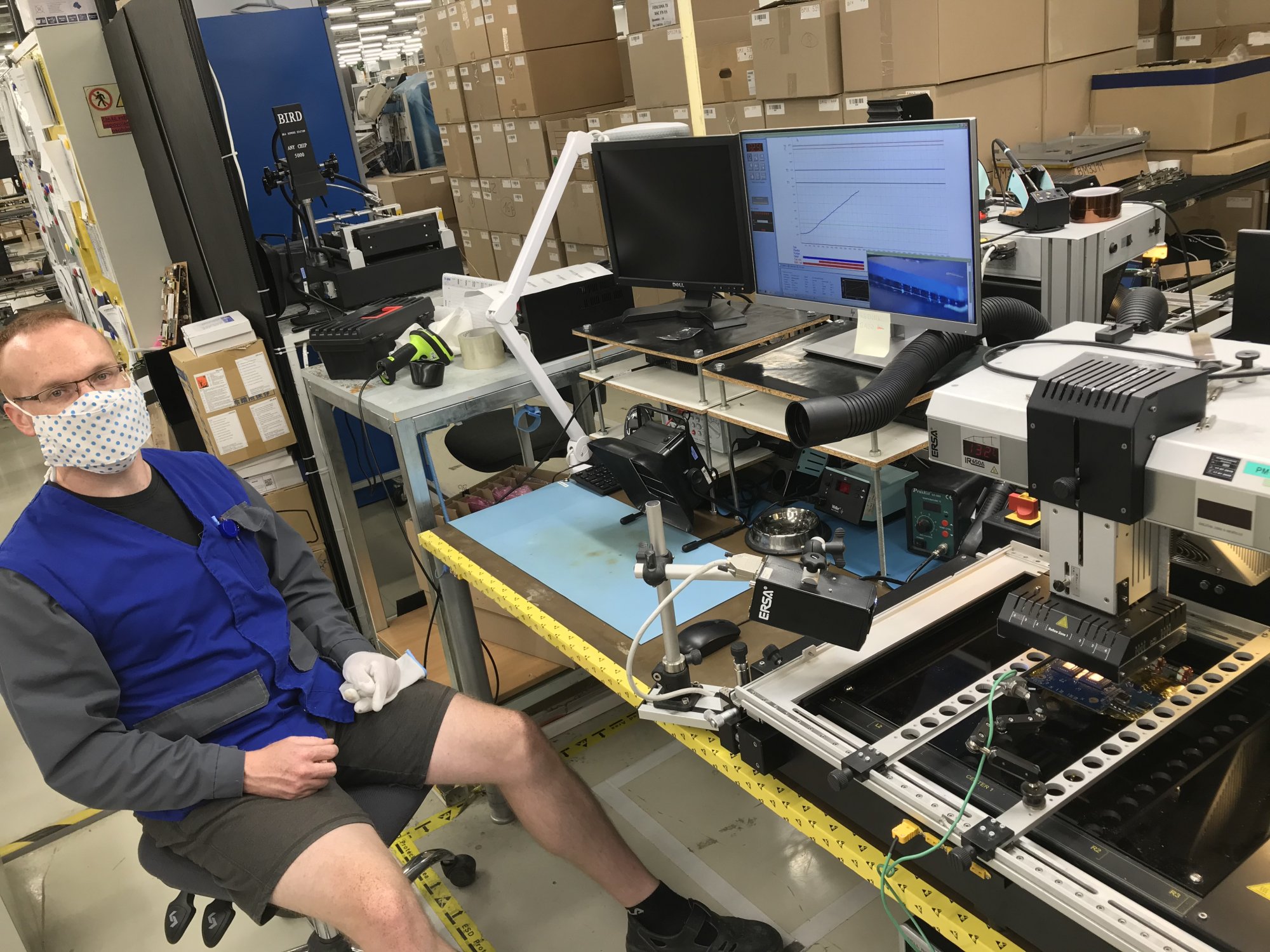

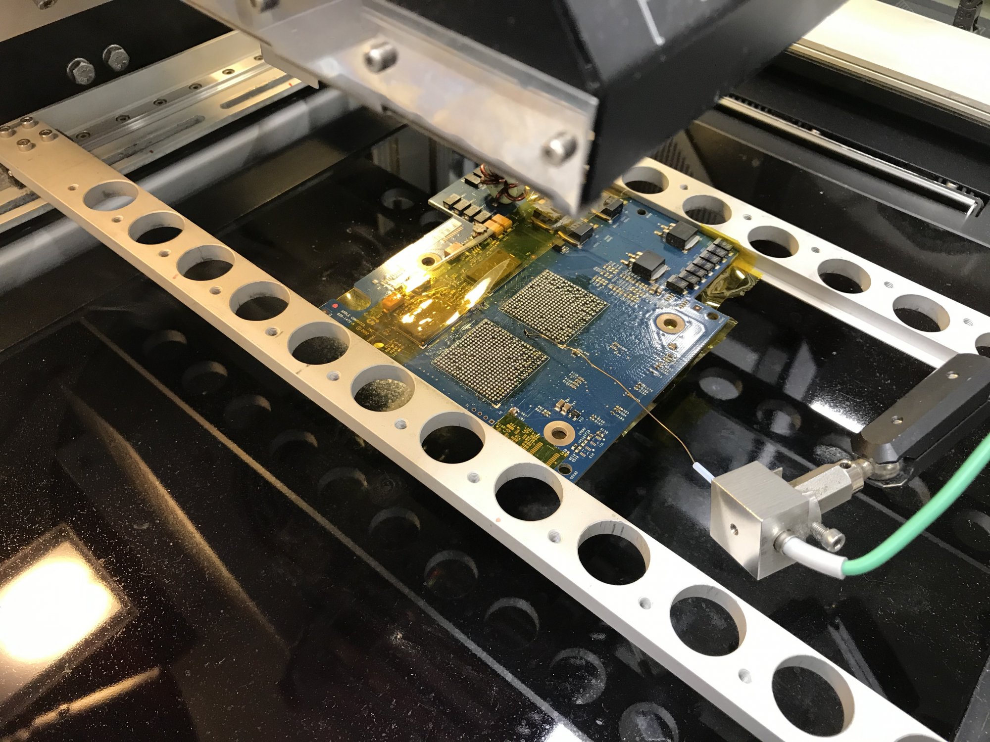

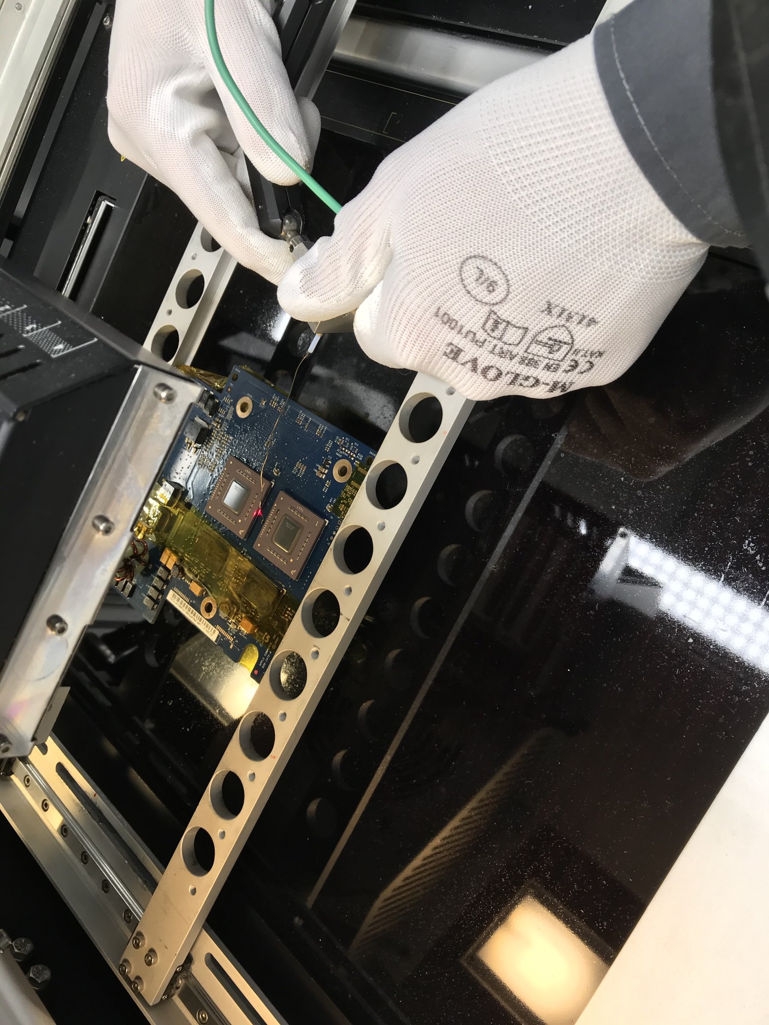

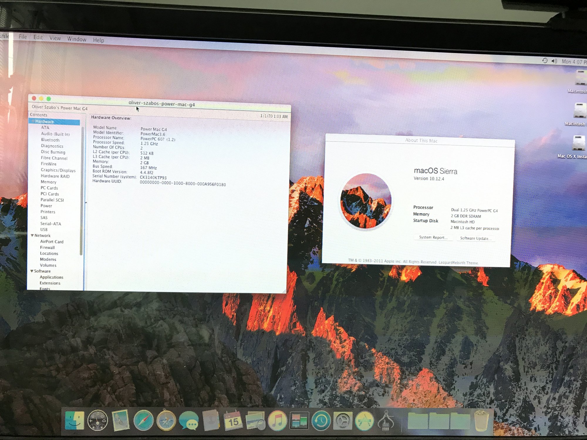

Okay, continuing with the swap project. The old non-working PSU has been swapped for a ATX PSU(specs can be seen in the photo) so I have a room for a powerful GPU(I need an advice on that what is the fastest GPU I can cram in there), firmware patched, CPUs swapped with the help of my coworker. Now just to get home to test it out. Later I will overclock it. I plan on something like 190MHz bus and 1,7GHz cpus. The uni-north in my DLSD can handle the189MHz with the 7447 so why not the same series just with the L3? Its the only difference between the 7457 and 7447. Maybe I will replace the L3 cache chips with faster ones to get their clockspeeds higher too and I will check if there are wired lines for the possibility of changing the cache chips to full 4megs the 7457 supports. Also who is willing to pay the price of the cpus and shipping back and forth and something for the time and work I am willing to do the upgrades for anyone who wants it(and if the overclock will be stable and the cache chip upgrade will be possible too I will do that too, also new label with new specs and without the barcode).

Also if someone have a computer that can accept just the 7455 and not anything higher I can replace it with my 7455 since they are fully functional. (I will also do dual and single swap no matter of the series... 7448 7447 7455 7450 7457 dual single... you name it, I do it)
EDIT: Indeed there are... Our stock 300MHz ones can be replaced with 370MHz ones that are faster and pin compatible and in the datasheet they say they are compatible just faster... Sooo... Im going online shopping for them.
First question, as it's an MDD, is the replacement PSU quieter? Even after changing the Delta fans in the stock PSU it's a fairly (annoyingly) noisy unit.
Yes its quieter, and after replacing the big fan that sools the CPUs it will be even more quiet. probably I will throw some Noctua fans on it to be super quiet and super cool(lowest temps possible). Now im just thinking what voltage to give the 7457 CPUs... If i leave the 1,55V or lower it to something like 1,45V.

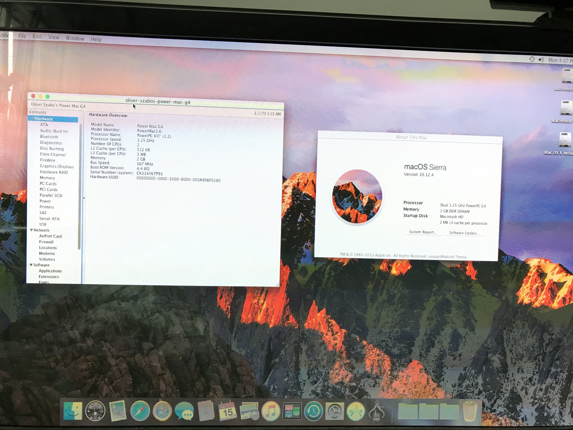

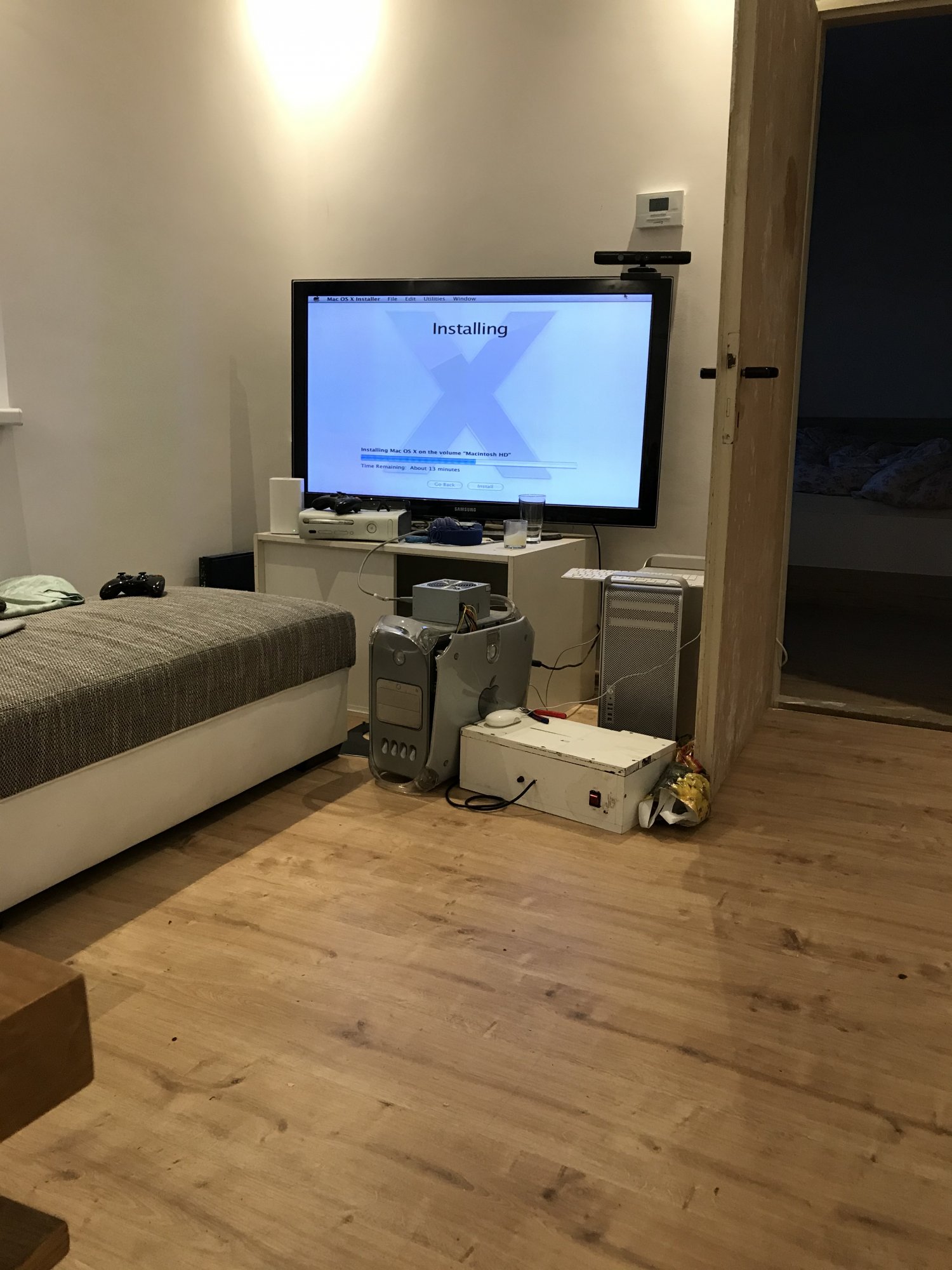

Quick insert: For the safe of the CPUs I lowered the voltage to 1,45V. In about an hour and half I will be at home and testing, than I will report back if it works.
