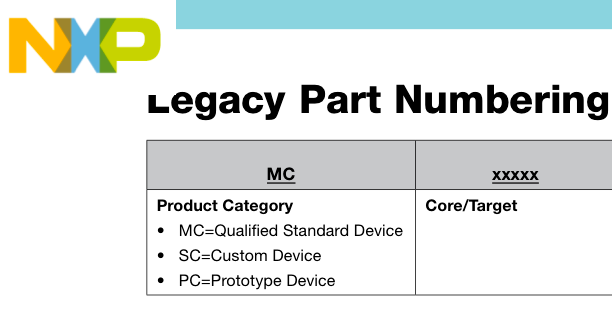

Hey dosdude,
In case you haven't seen this, SC means "Custom Device" whereas MC means "Qualified Standard Device". Presumably Freescale manufactured the SC chips to be tailored to a specific customer's requirements. What those requirements were, what product they were produced for, and how they might impact our ability to overclock, I have no idea.
It seems most people are having better luck overclocking the MC chips. Sometime in the next couple of months, I will be doing a few chip swaps with some SC7448s and will report whether or not I can get them to run faster than 2 GHz.
Please see my post from a few pages back regarding Motorola/Freescale legacy part numbering.

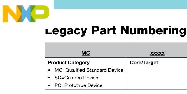

Direct from NXP’s web site:
The part numbering qualification appears to follow very similar conventions across the entire product line, including our legacy PPC processors.
I have also sometimes seen brief explanations of these qualifications in the individual product datasheets.
It doesnt say anything about the PowerPC CPUs our Macs use tho, the legacy part is talking about power management devices.

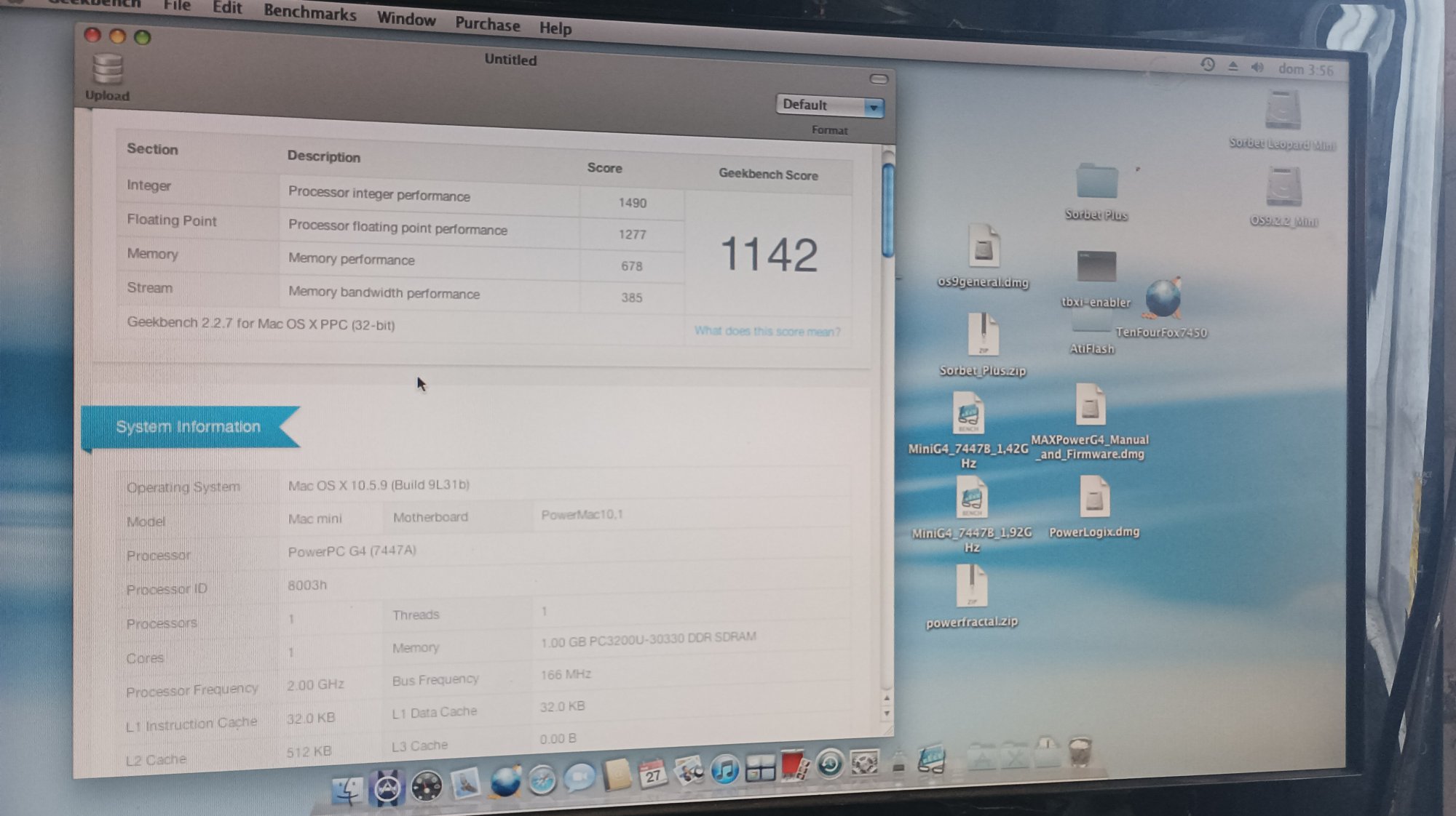

I look forward to the 2Ghz attempt 🙂 I think I have only ever seen one Mac Mini G4 hit 2Ghz, and that was with a massive heatsink coming out the top of it, I guess they managed to keep it cool enough to stop it tripping the OCP...
I do really want see what could be done with a 7448 now the OCP has been figured, if you use a Last gen Mac Mini G4, PowerMac10,2 then you dont need to worry about firmware patching, as the 4.9.x firmware supports the 7448 natively
you will need an NVRAMRC script to boot MacOS, but thats not too hard to do
I wonder if one could find a copper heatsink with the same fin-stack density as the original, for maximum improved cooling?

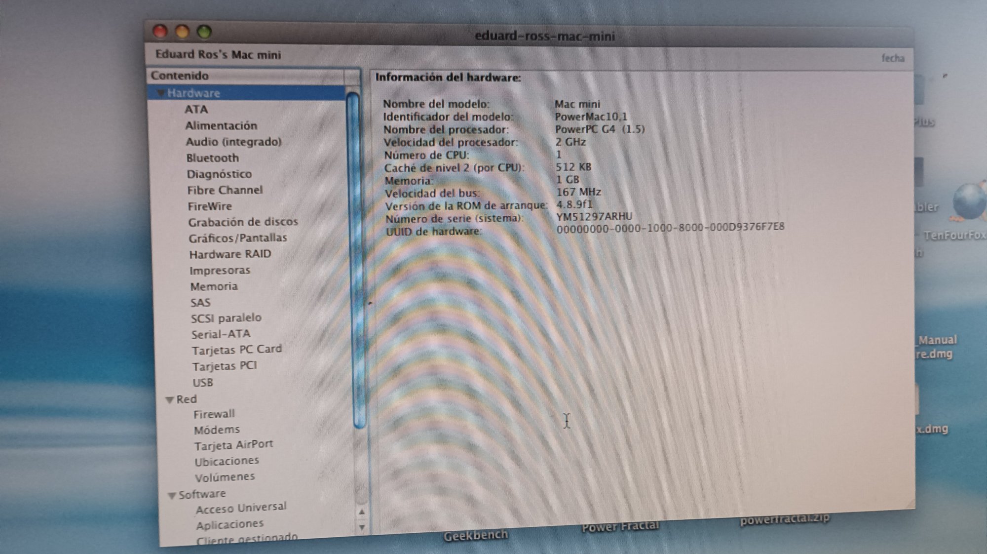

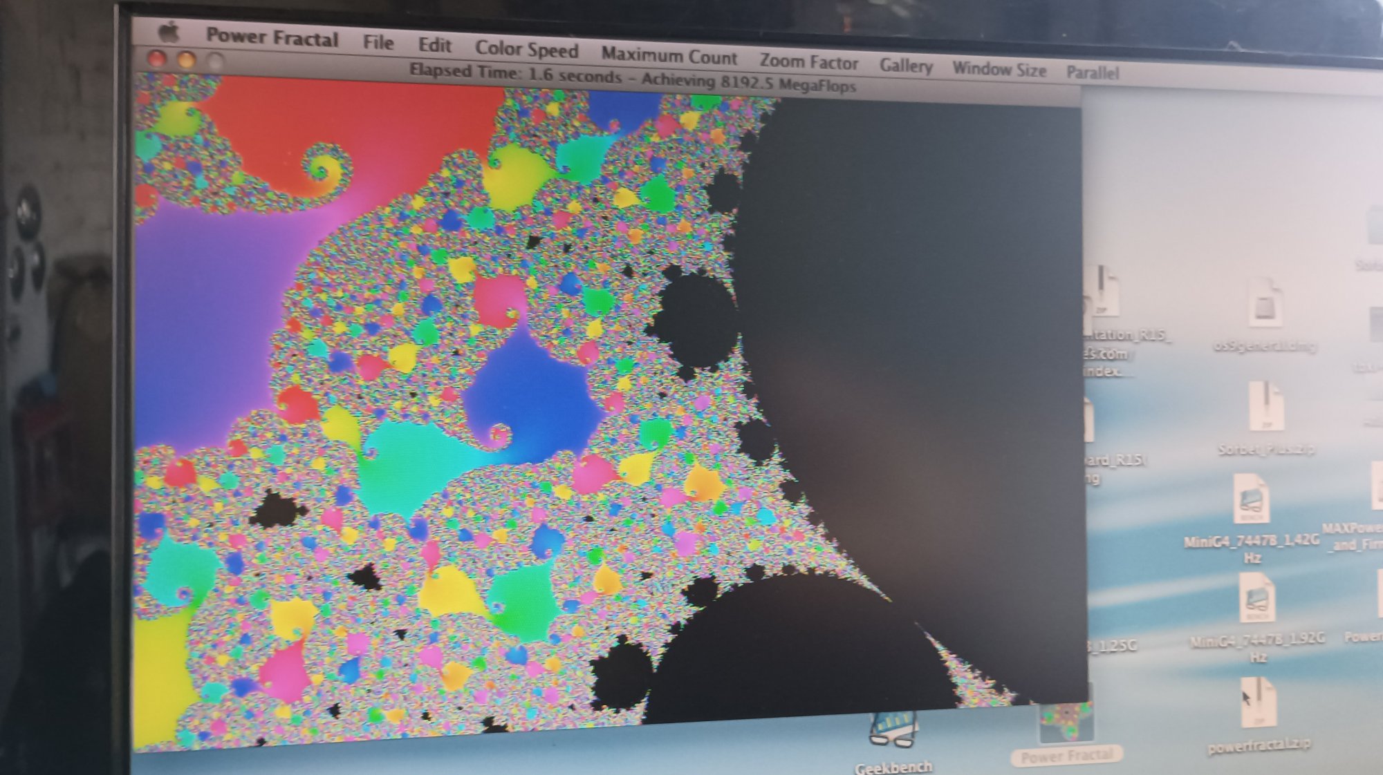

Hello, the Mac Mini works fine at 2GHz:
More details at:
https://rosysumenteinquieta.blogspot.com/2024/04/mac-mini-g4-2ghz.html

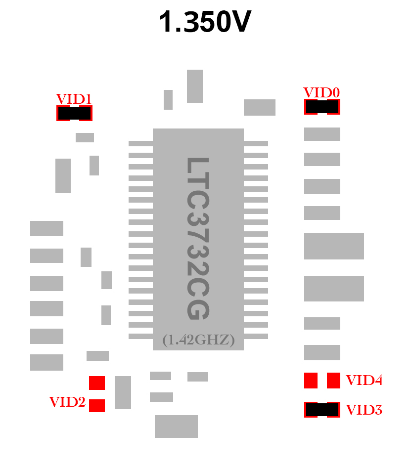

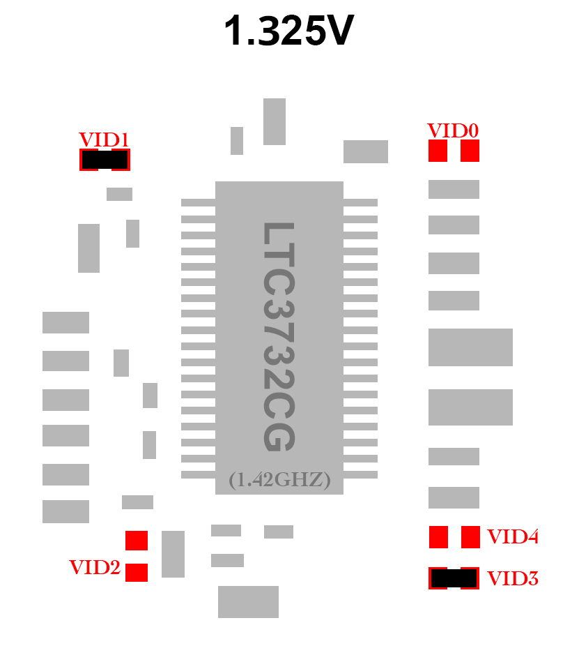

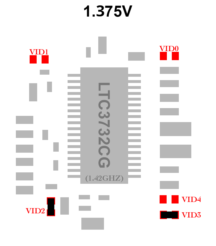

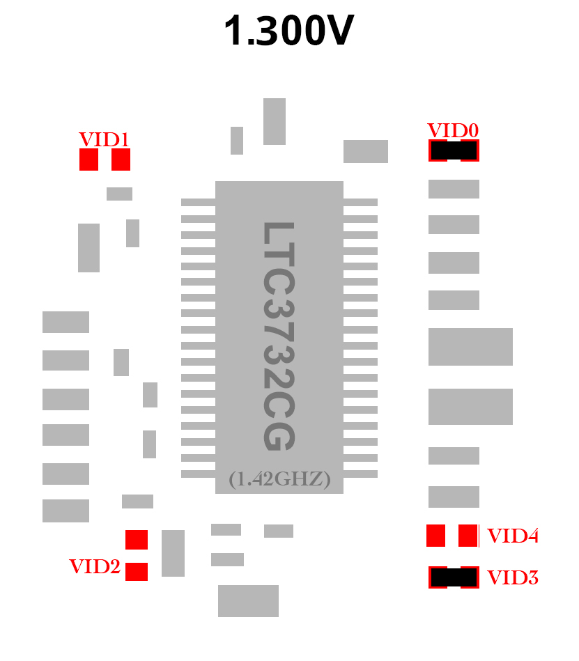

Hi,
I have Powermac G4 with 2x 1,42 GHz. I want to swap CPUs to MC7457 RX1267LC and overclock it.
But original VCore setup is 1.6V and my new CPUs has 1.3V.
I have voltage regulator chip LTC3732CG. On this The house of Moth excellent guide unfortunatelly is only VCore settings from 1.6 to 1.85 V.
I think ( according to LTC3732CG datasheet ) that correct voltages for 1.3-1.375 V should be like this:
Please, can you somebody check my assumption?
Many thanks.
Hi,
Many thanks.

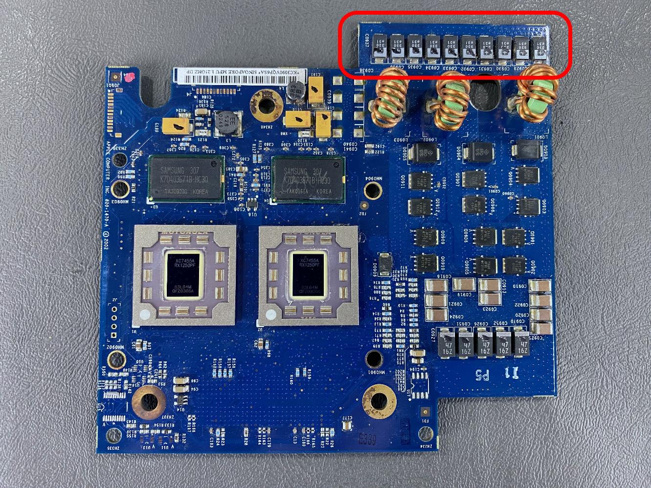

I can't check it right now, but the best way is to, once you've removed the processor, place the daughterboard on the motherboard before soldering the 7448, and then check the Vcore without a CPU installed. That's what I do.
@indibil
thanks for reply.
Unfortunately I am not doing CPU swap myselves. So I have to prepare diagram in advance for guys which doing CPU swap.
Not to say, I don't know where to measured VCore. On CPU pin? For example H8, H10, H12 ?
@sailorMH I measure the voltage across the capacitors I've marked in the photo, they're the ones that "feed" the CPU.
I know you're skilled with small resistors; you made a lot of progress overclocking a Mini. You can still try modifying the Vcore with the 7455. The computer won't boot, perhaps due to insufficient Vcore, but you'll be able to measure the voltage there. Be quick; the processors will be without heatsink.
According to the LTC3732CG's Datasheet, your guesses are correct; I just checked it.
