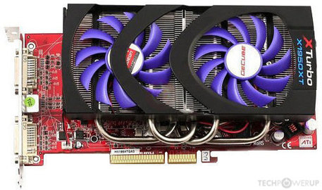

It's waiting for you to do it, it's not that hard, assuming the GPU it the same as the:
RetailRadeon X1900 GT
Good luck finding one for a reasonable price though lol

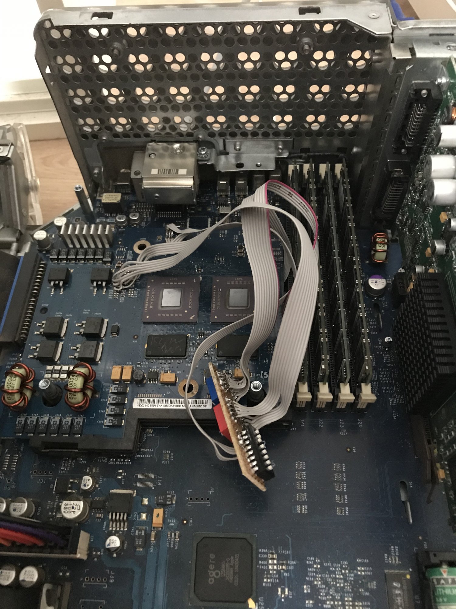

Okay, I will get the 7800GS. Also now i have a good way of testing clock speeds and different setting on the bus PLL. Its fun to clock the system just with switches.

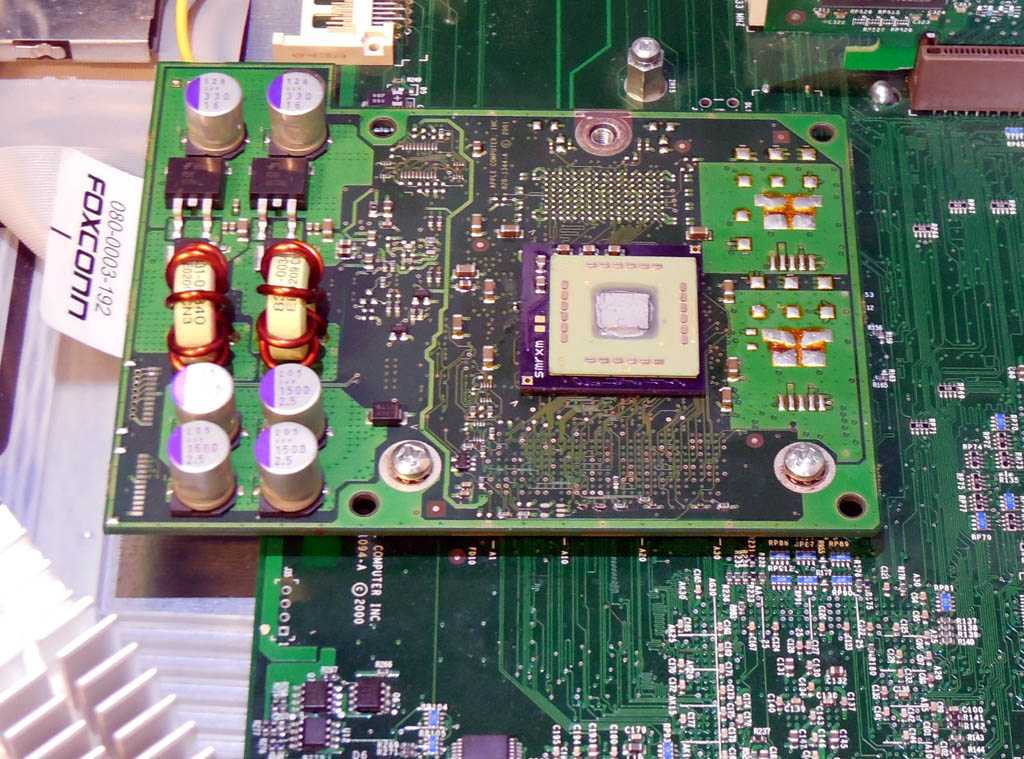

Hi! Yes im still providing overclocking and CPU swaping services. I live in Europe, more exactly in Slovakia. The 7448 is still in progress cuz I didnt found any bootrom that would give me even a slight chance how to remove the cpuid check. So for now I just do a PowerMac CPU swaps and overclocks and PowerBook overclocks.
You might like to keep watch on this thread, then. @dosdude1 has a manually-modified Mac mini G4 ROM that (potentially) replicates what the Giga Designs & other patchers do, but for that specific Mac model. Hopefully more is to come for PowerBooks and iBooks?
Also, any attempts at installing 7447 and/or 7448 on MDD CPU daughtercards? Although, as discussed earlier in the thread, something like the following adapter board for the CPU would be required for them:
If the following observation from @LightBulbFun is correct... (emphasis mine):
all the gigadesigns and powerlogix patchers do is remove the halt on unknown CPU check, it does not technically add support OF still has no idea what the CPU is LOL (it does the bare minmum to get the system booting with unknown CPUs which is good for tinkers like me but less so for end users)
it would be interesting to see how they are reported with the Sonnet firmware patch meant for the sonnet MDX CPUs
the Sonnet patcher tends to fix the name in the device tree and also masks the CPU PVR so the CPUs report them as 7455's so you can boot OS 9 with minimal patching/nvramrc scripts
obviously make sure to proper uninstall one makers BootROM patch before installing another!
...then the 7448 will work for MDD if those two patchers work. Else, we would have to rely on the Sonnet patcher intended for the MDX with its 7447 (a dual 2.0GHz 7447 would be already something, at least), and see if that works with the 7448. But the only way to know is by trying first...
