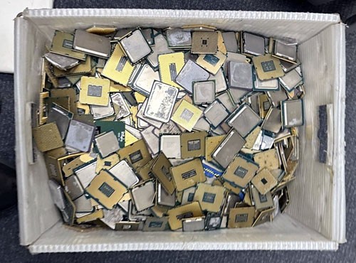

My experience with the PPC G4 chips is similar to @dosdude1 in that the 7448's are EXTREMELY delicate. I have also managed to crack a couple of them simply by applying the required heat to melt the solder. It is evident to me that excess heat might have been used previously to remove them from their original equipment boards. I won't speak for @dosdude1 but the 7448's I have are definitely salvage chips as they sometimes come charred with some kind of dark-ish substance, chipped corners on the die, etc. Makes me wonder what methods were used by the salvagers to actually remove them....
Anyway, back to your question. Best chips if you want L3 cache support are hands down the 7457s (if you can find them). They generally run cooler than 7455B's, use less power and also have 512 KB of L2. It is tougher to get them to clock as high as 7455B's though. See my posts on page 9 and 10 of this thread to see what can be done with 7455B's in an MDD using factory copper cooling.
They were probably cracked before you got them. I think they use pliers and a blowtorch to remove them, then transport them 50 miles on the back of a horse in a rusty bucket. "New old stock" 🙂

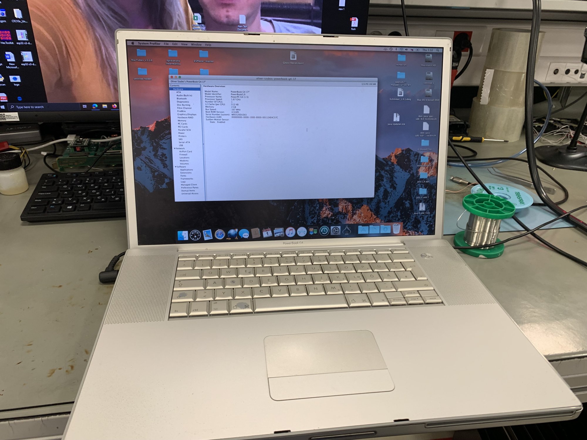

After a VERY long time I got my DLSD working again. Still amazes me that the system profiler doesnt show actual frequency. After the 7448 swap I will pump the bus to 200MHz and the CPU to at least 2GHz. Will be a rock’n’roll powerbook. I think I again did something to the ram slot as its AGAIN not seeing the second ram stick… Easy fix tho. In a week you all will be seeing the sweetness of overclocked 7448 DLSD 😁 I am excited to see the GeekBench score.
EDIT: Now I have a test platform for the PCMCIA accelerator card at least.

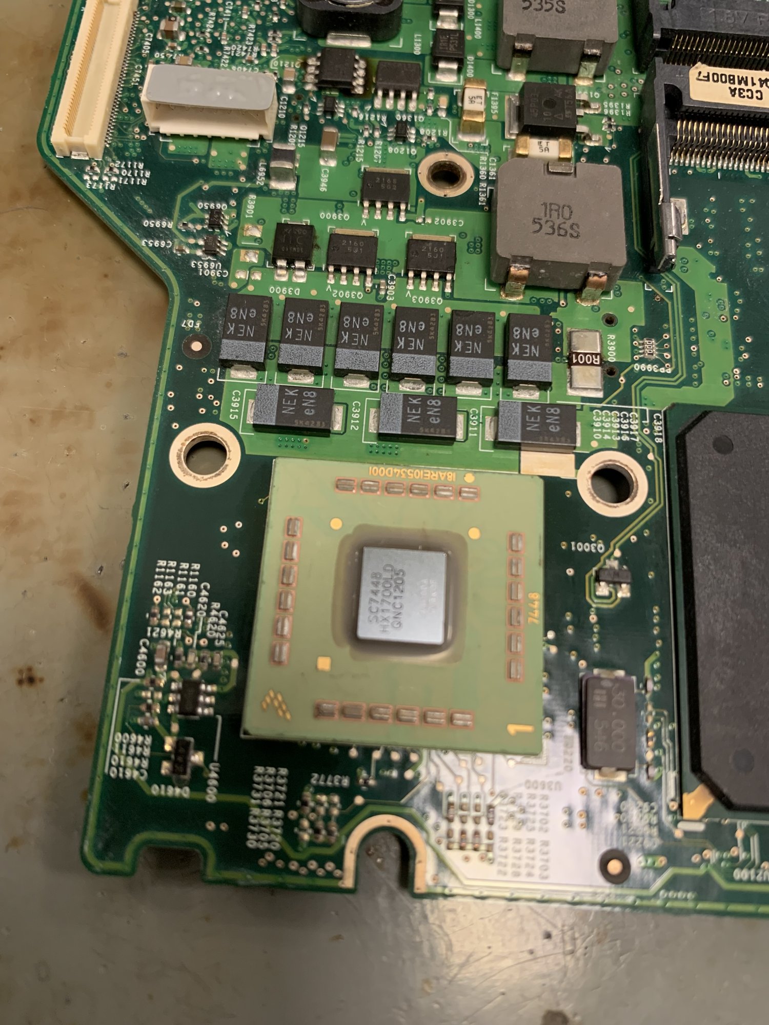

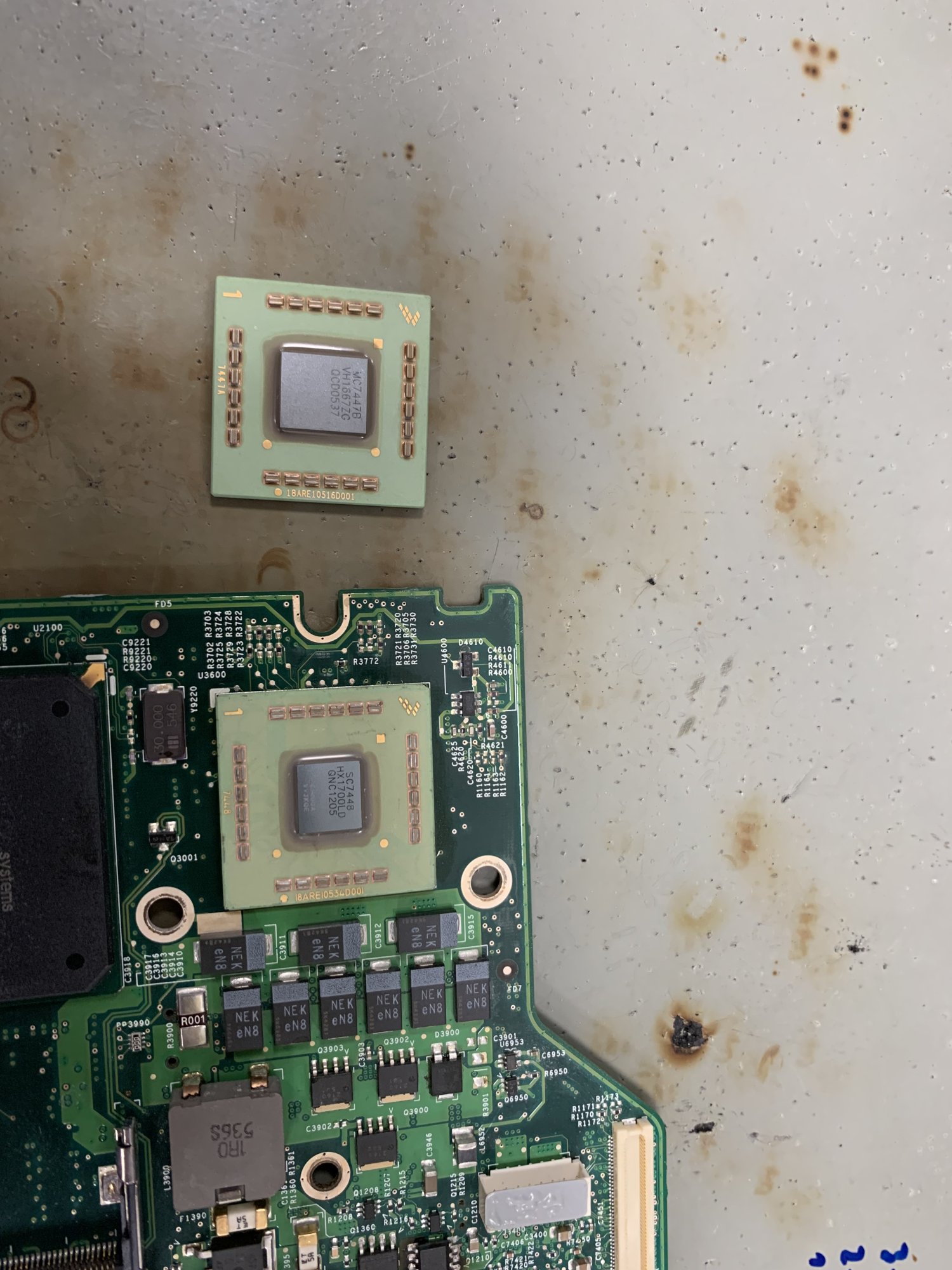

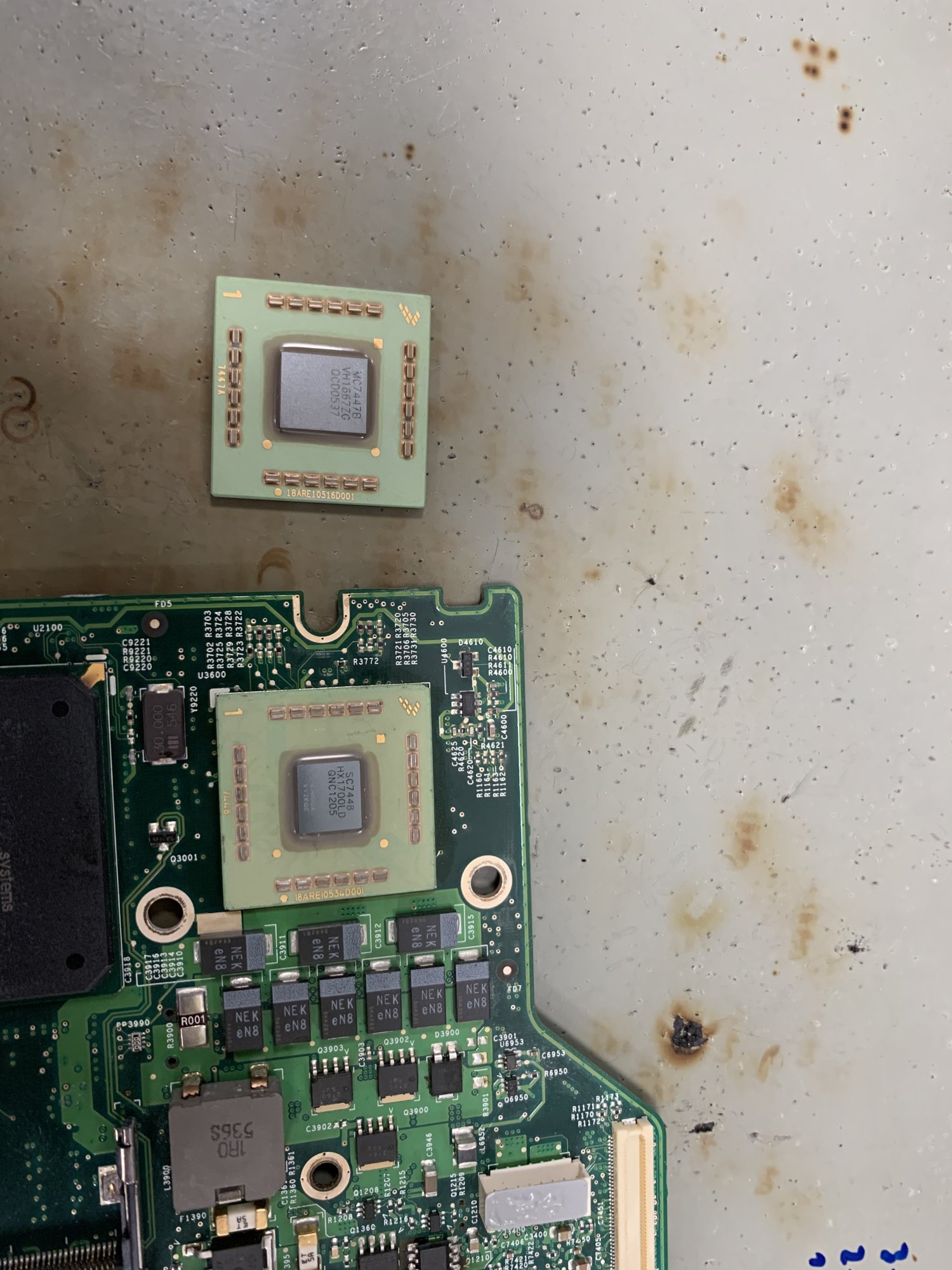

A little update, out with the old, in with the new! The 7448 is now in my DLSD. Buuuut… The miraculously “fixed” charging circuit is dead even more so the powerbook doesnt power up… 😞😭 I was measuring and injecting the voltages to the regulators and finding whats dead and whats alive for 12 hours today… So the result is that I ordered 30 mosfets(3 types) and 3 regulators. Also the battery is totaly worn out, it can power the laptop for like 90 seconds so I also ordered new cells for the battery and a active balancer that I will also pack into the battery. So any testing of the PPC Accelerator will be delayed. Life really doesnt want me to have a 7448 Hi-res DLSD with a accelerator card 😞.

View attachment 2355090View attachment 2355091A little update, out with the old, in with the new! The 7448 is now in my DLSD. Buuuut… The miraculously “fixed” charging circuit is dead even more so the powerbook doesnt power up… 😞😭 I was measuring and injecting the voltages to the regulators and finding whats dead and whats alive for 12 hours today… So the result is that I ordered 30 mosfets(3 types) and 3 regulators. Also the battery is totaly worn out, it can power the laptop for like 90 seconds so I also ordered new cells for the battery and a active balancer that I will also pack into the battery. So any testing of the PPC Accelerator will be delayed. Life really doesnt want me to have a 7448 Hi-res DLSD with a accelerator card 😞.

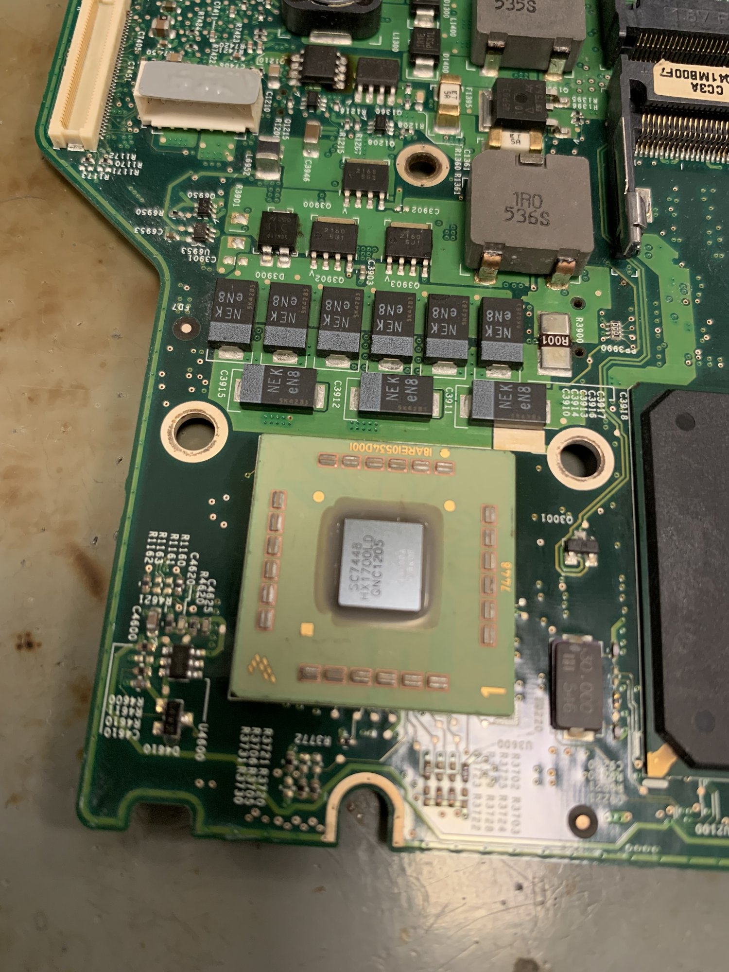

May I ask a dumb question about the different wafer sizes between the MC7448 and SC7448?
The MC7448 version, shown in your first pic, appears to occupy roughly 30 per cent more surface area versus the SC7448 wafer. What again is embedded in the MC7448 package which is lacking in the SC7448 package?
I think I noticed this at the time you first posted these pics, but I’m only getting around to asking about it now. Cheers.
The one with the larger die is the original 7447B... All 7448s have the smaller die size.

Good g-d, how did I not see the second 7 in that string… 🤦‍♀️
Yeah, sometimes happens. I almost soldered the 1,2GHz version onto the motherboard instead of the 1,7GHz… You know… 2 and 7 looks the same aint it? 😂 Like your B and 8 😁

I have a English US keyboard actually. Im from Slovakia.
Ah, ok, I had just zoomed into your photo in post 282.

I think what threw me is I knew the 7447A/B was a rectangular wafer, but from that angle, the 7447 in the pic looked like a larger square, not a rectangle.
