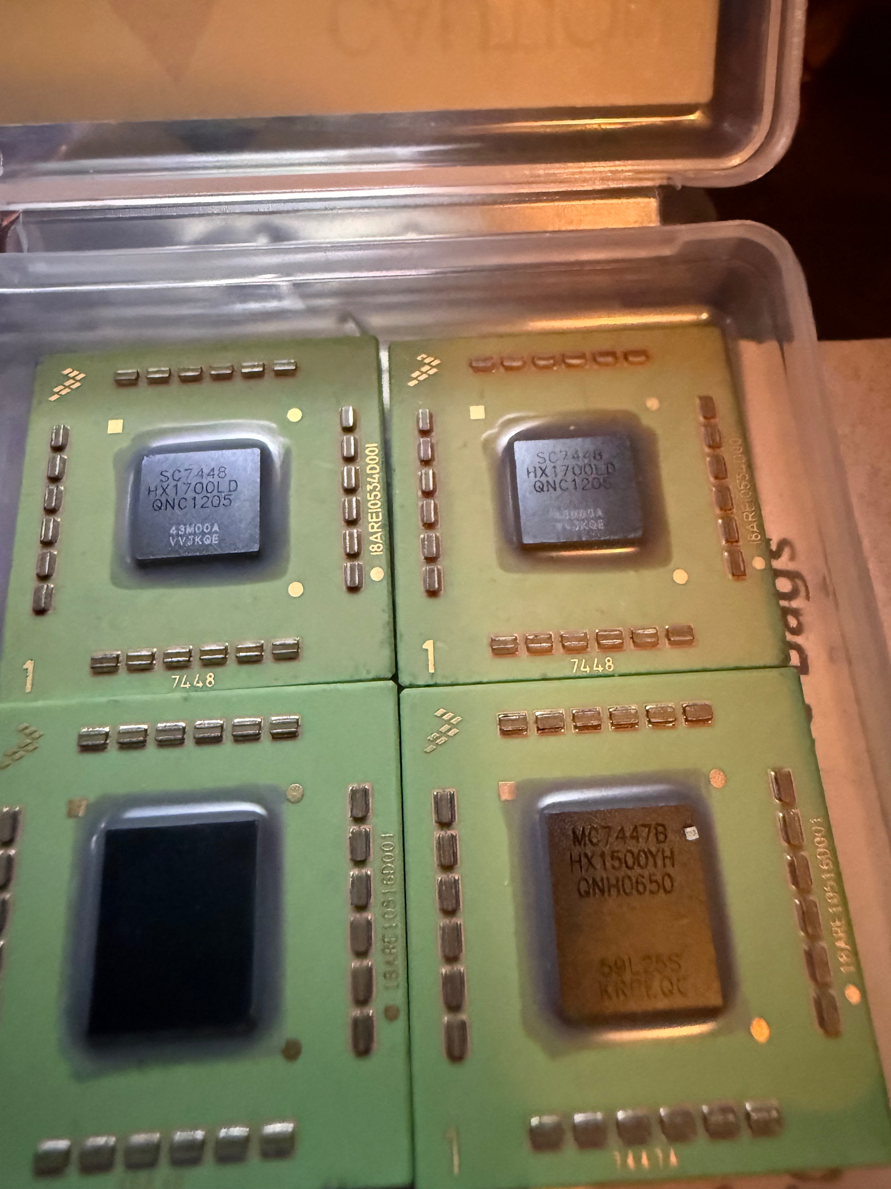

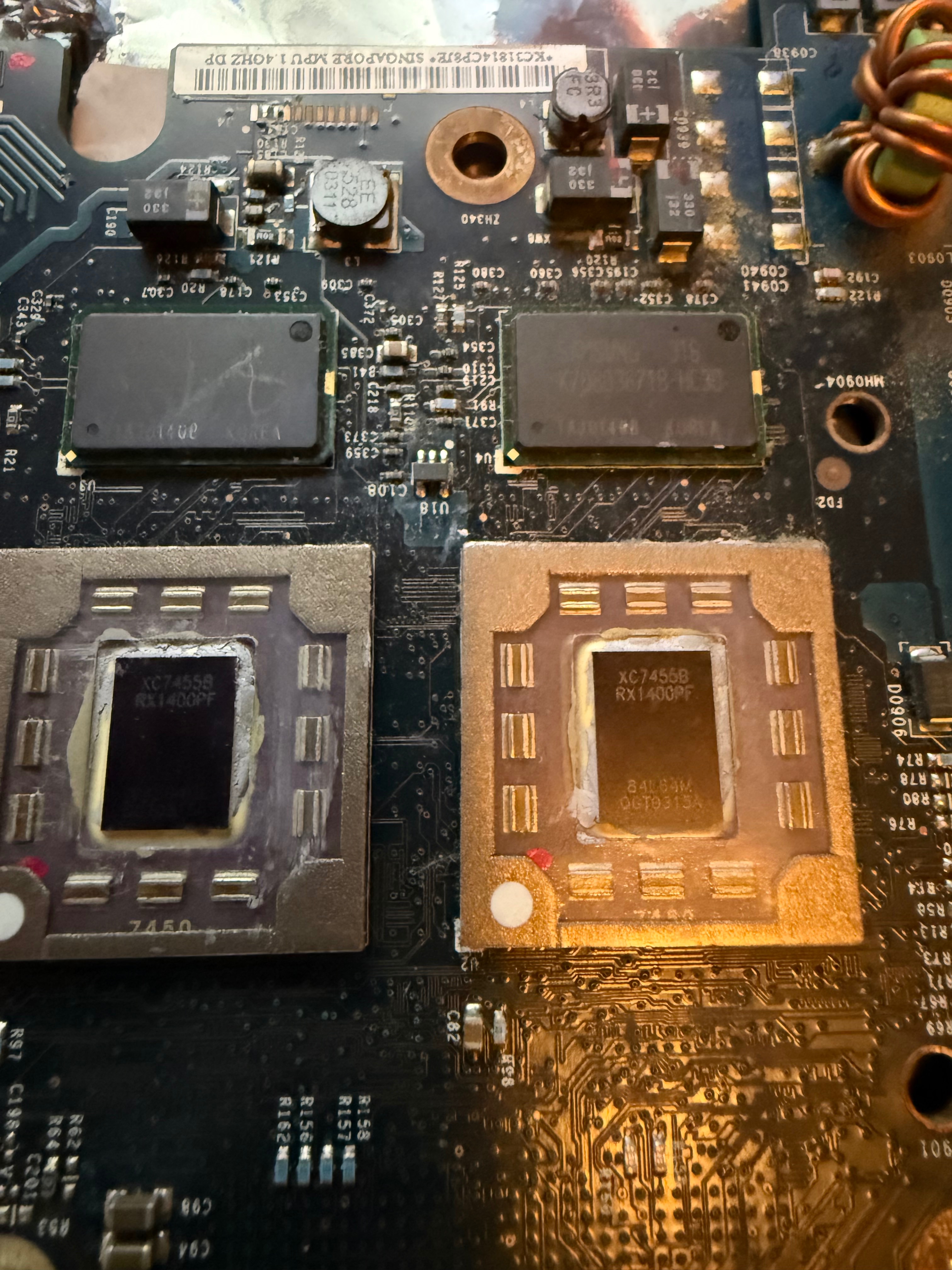

Not sure if anybody still frequents this thread, but I have a 1.42GHz MDD G4, with a spare processor card. Since I have a couple SC7448 HX1700LD processors, I'm considering attempting a swap. The processors look to be new stock or very well pulled and reball'd because there's not a mark on the processors. Obviously I'd need to track down the CBGA adapters that I see are no longer sold. I really should have pulled the trigger them back in the day! I was moving around a lot a couple years back and didn't have time to tinker with this stuff.
The 1GHz spare processor card is rocking 7455's running @ 167MHz from what I can decipher from the resistors, so it would save me a little bit of time, obviously I'd have to move some resistors around for voltage.
My other thought was just to overclock the existing 1.42GHz board or try and find some 7457's and go that route for this machine and save the 7448's for my 15" DLSD 1.67GHz Powerbook, from what I read here it should have the bootrom to do a direct swap.
Any advice or words of wisdom?

Whoa, where did you find those 7448 chips? They seem quite hard to find for a reasonable price, unless I'm looking in the wrong places. I'd also like to try and upgrade my 15" DLSD PBG4.
I picked them up probably 4 years ago now when they were a lot more for sale. There were definitely some sketchier listings at that time, some clearly had been pulled aggressively. I'm still not 100% certain they are legit or working but I'm fairly confident because of the die size and the etching all seems to line up, especially comparing 7447B I have there that I know are from a factory tray.

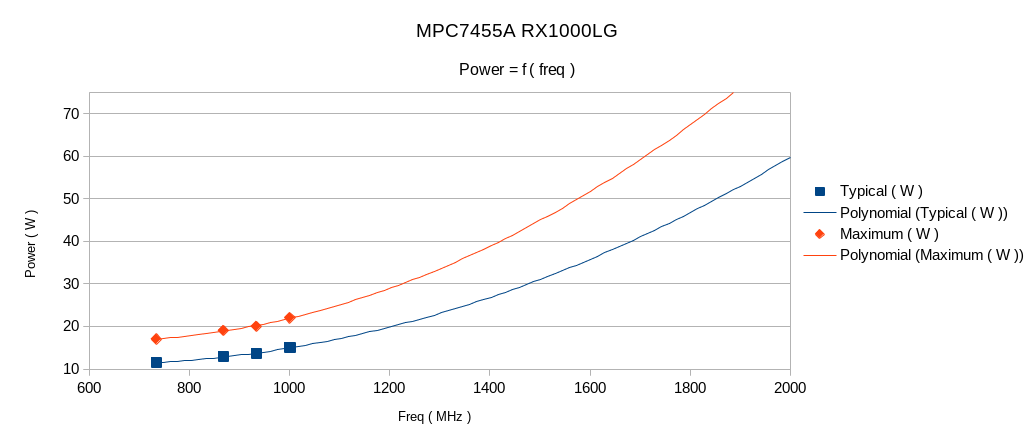

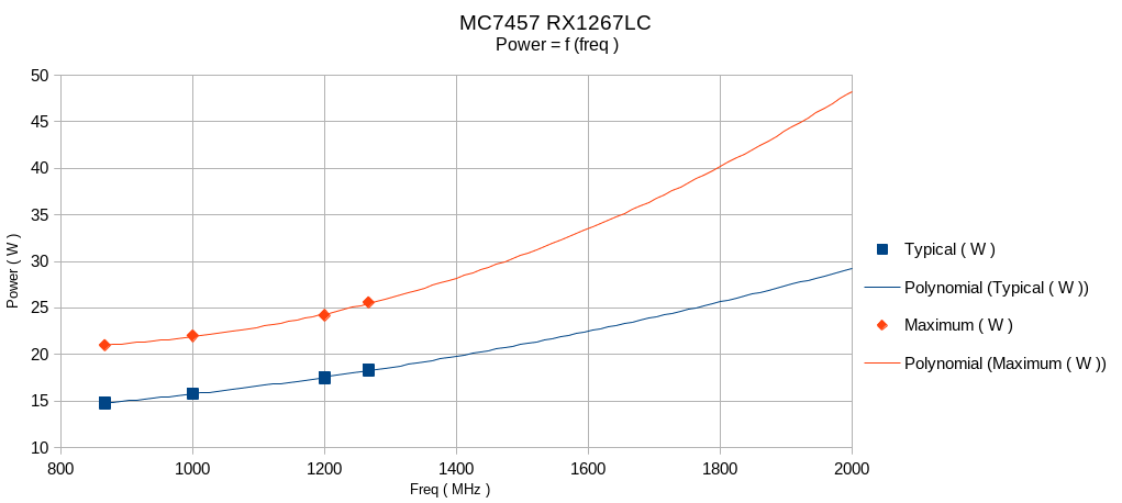

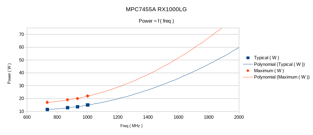

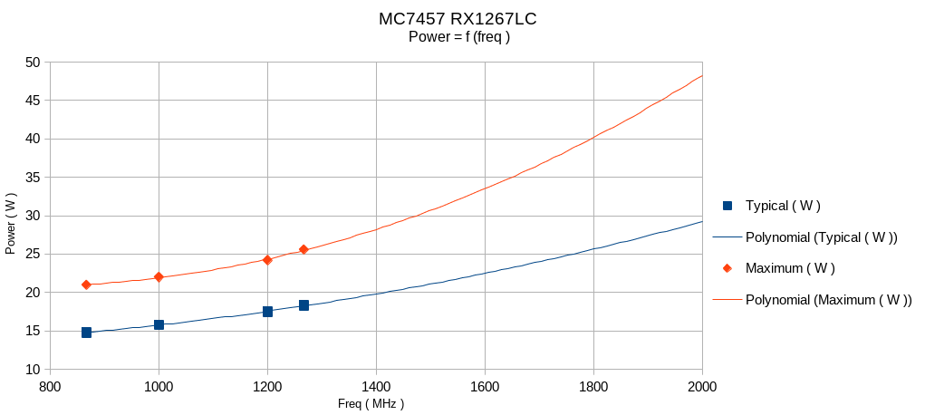

I make some Thermal ( in real electric Power ) graphs for replacement 7455 - 7457
Here is 7555A:
and here 7457:
You are right, original 7455 / 1400 MHz has max 39W, new 7457 / 1667 MHz will have max 36W
And L3 ratio I have already 1:6, so real freq. will be278 MHz, it is OK
Here is 7555A:
and here 7457:
These figures are theoretical, right? I don't know if it takes into account the overvoltage of both models, but I don't think you'll have any problems at 1.67GHz. I think there's someone on the forum with a Dual 7455 OC at 1.6GHz who claims it's been working for a long time without issues.

Graphs are theoretical. Square points are exact data from manual, line is extrapolation to high frequency.

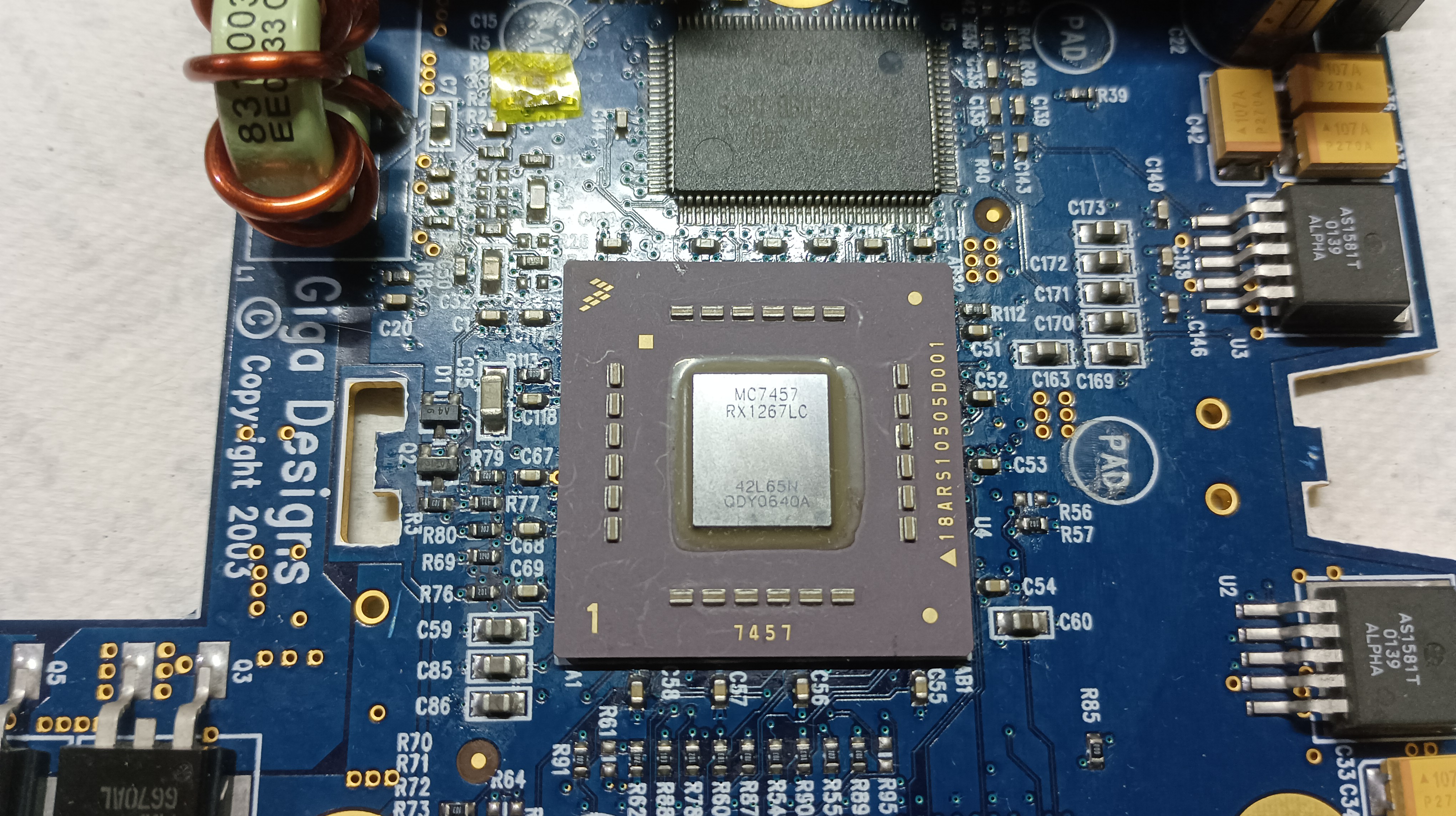

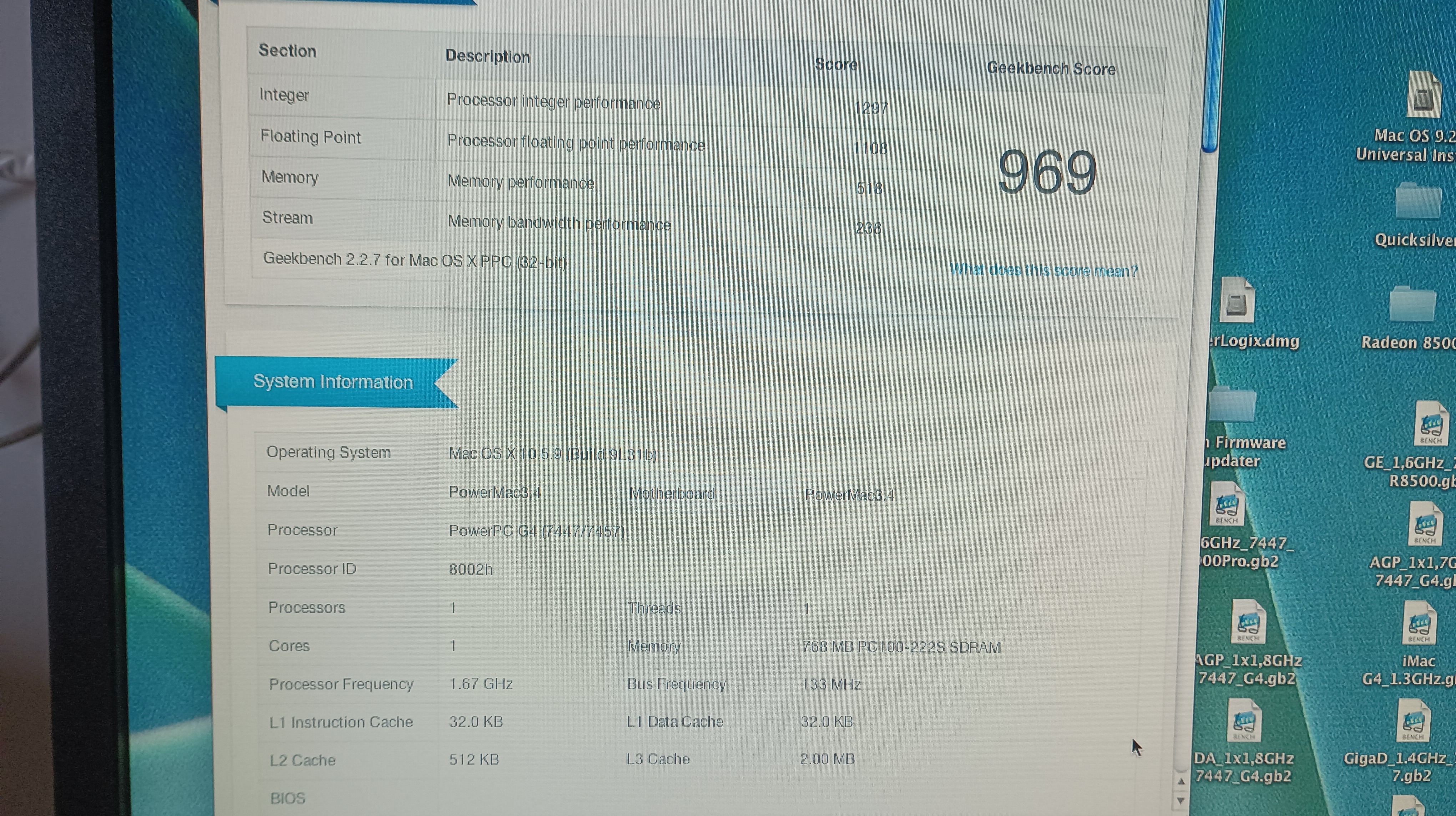

It seems the SWAP craze has waned a bit, but I've been playing for a couple of days with a G-Celerator and a 7457. I've unlocked a few achievements, though I suppose nothing groundbreaking.
Hope you enjoy it.
https://rosysumenteinquieta.blogspot.com/2026/03/vamos-divertirnos-con-un-giga-designs-g.html
Very cool stuff! makes me a bit nostalgic, the very first CPU Upgrade I ever got for my Sawtooth was one of those Giga-Designs G4's 🙂 it fittingly lives in one of @bunnspecial's Sawtooth's these days 🙂 I have often thought it would make a good candidate for being CPU swapped given its CPU multiplier and vCore Jumpers already present
