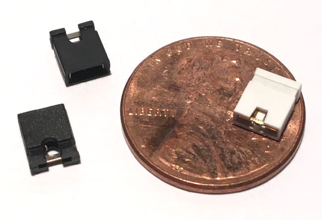

I opened up my spare adapter and there are no visible jumpers, and I don't think my eyesight will let me even attempt to solder anything that small.
Do you have any old conventional drives not being used? Usually a good source to find / scavenge them from. AND MicroSataCables may send you one - if you can't find one locally. And if you can't acquire one, message me your address and I'll send you one. And I wouldn't solder the pins anyway as... not certain exactly what their jumper setting should be. (It might be the other two pins?)

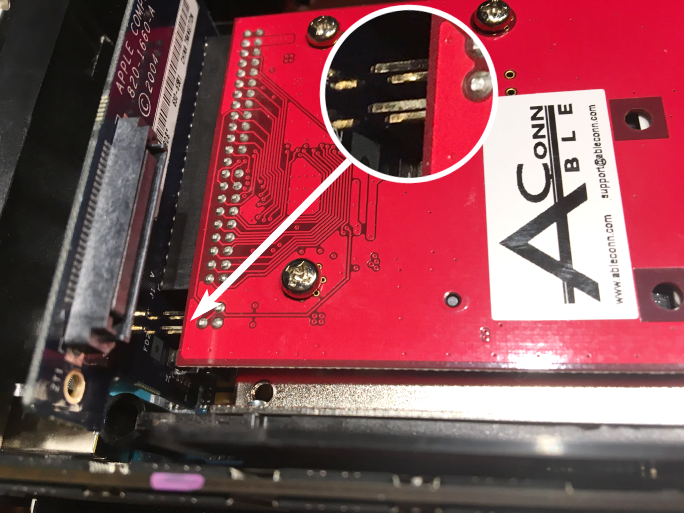

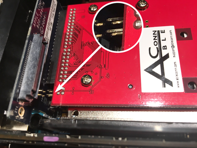

Appears that @Amethyst1 is correct… and with that, you may need to double check that your enclosure is properly oriented, seated & aligned into the female 820-1660-A board. Attached “top view” image shows a working Mac Mini Ableconn mSATA sled with no jumpers attached.
IF for some reason this approach then does not yield results, then you may have to experiment with jumpers. *The MicroSATACables enclosure might require a jumper for Master setting. Double-check also that the mSATA is properly seated within the enclosure.
Reactions: TheShortTimer
