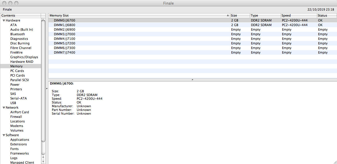

Earlier this week I booted up my G5 Quad to find only 12 of my 16GB Memory was showing up. I've had 16GB working without issue for 1-2 years now. DIMMs 4 & 5 were showing up empty despite that not being true. Haven't had to go fiddling inside for a long time so I'm surprised anything changed.
Today I decided to fix it so I shut down and reseated every DIMM for good measure. But when I booted up afterward I noticed only 4GB total was showing up! Now only DIMMs 2 & 3 appear in system profiler with all others marked empty. Hoping there isn't damage to the DIMM slots...
Is there something I'm doing wrong here?
Do I need to fire up open firmware and do a reset?

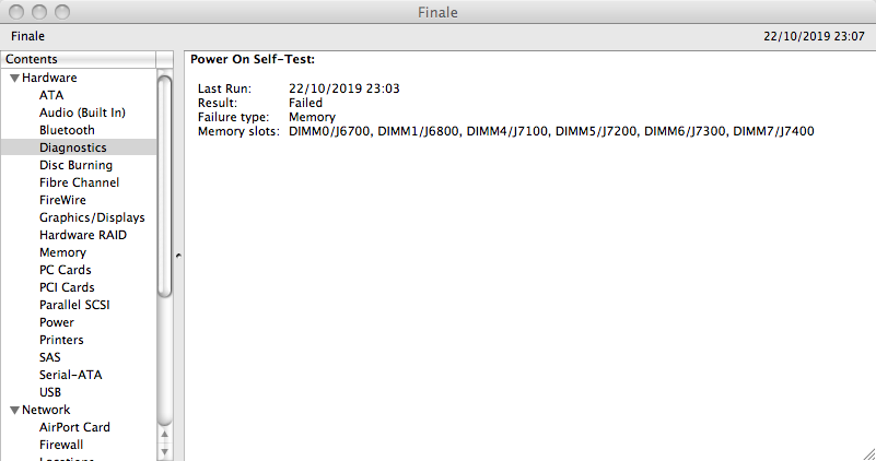

also don't forget about the "Diagnostic" tab in System profiler, this will tell you if the machine is Failing POST and disabling the RAM sticks, rather than them just not being detected
(and theres also Apple service diagnostic :) )
if your RAM sticks keep vanishing regardless of what you do, and especially if it shows up as a POST failure
then I fear its your memory controller that's failing, either BGA or die bump issues, where slowly RAM slots are physically being disconnected
this was a good symptom of the failing U3 North bridge on an AGP G5, however I think this is the first time I have heard of it happening on a PCIe G5
Lets hope it's not that bad! Been busy but I'll ticker with it tonight and go pair by pair. Forgot about the "Diagnostic" tab in System profiler. I don't think it was chiming on my last 2-3 boots either.

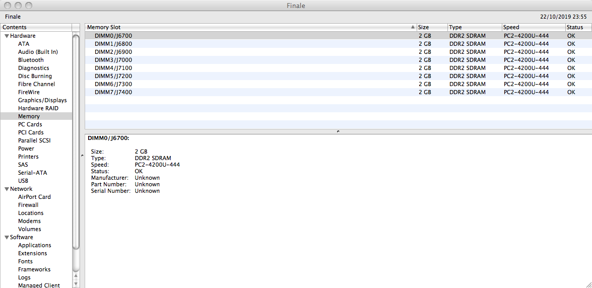

Cleaned the slots and a few of the other internals with compressed air.
I'm going pair by pair now to find a culprit and all seems okay after the first pair, will keep going...
Well! Went pair by pair and had no issues until the 3rd. Used the other pair I had left in 3rd slots and that worked. So at least slots of the first three pairs seemed to be okay and 75% of my DIMMs. One of the faulty pair DIMMs has a very mild looking scratch on the contacts on the back. Doesn't look toooo bad but it's suspicious.
I tried the faulty pair again in the 4th pair slots but no joy. Then as a last effort I swapped them top to bottom and for some reason it worked! All 16GB back in action, for now at least.
[automerge]1571785691[/automerge]
The beast is back in action
