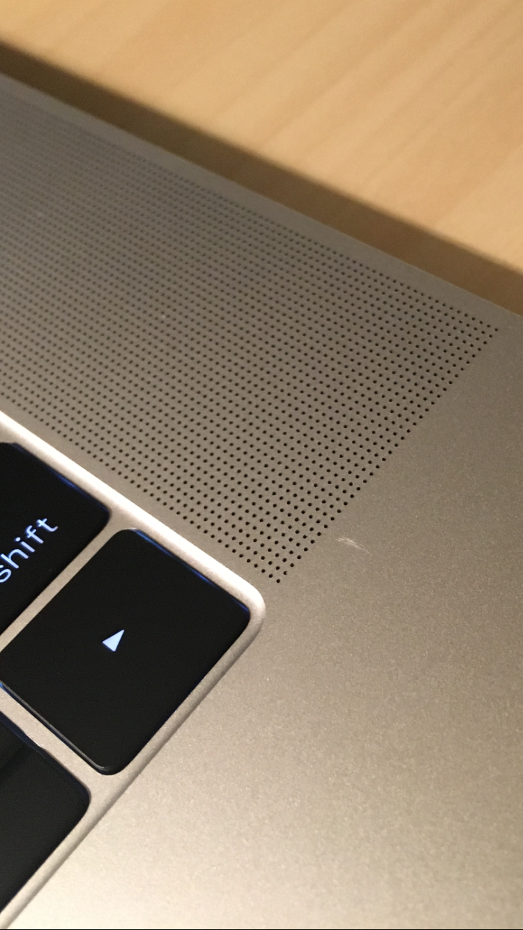

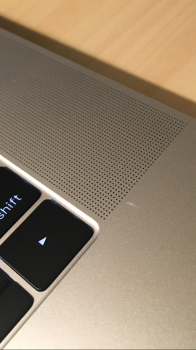

Picked up mine yesterday (2.9GHz, 1T, 460), and I can confirm it is still happening. And actually, it is more annoying than I thought - if you have a lighting source (like a table lamp) coming from the left side, it is quite obvious whenever you look down.

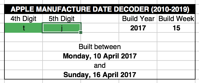

What's the build date? Could be old stock.
(If you don't know, you can just post the forth and fifth digits of your serial.)
I am not sure how to check the build date - the forth and fifth digits are TJ. Could you please let me know how to check the build date, thanks a lot!
Week 15 2017 (so approximately April 10 to April 16 - 'approximately' because the week numbers can overlap if production of a single unit occurs over more than one day).
So it is still happening! I thought you might have picked it up in store from stock (some stores stock the model you have).
[T means the first half of 2017, and J means the 15th week of that half of the year. It can get a little complicated to figure out so a while ago I made a little spreadsheet to do it for me, haha!]

Yea I made an order, waited for about 2 weeks, and picked it up in the store. It's kind of disappointed to see this right out of the box... I couldn't get over it and made another order last night, will return this one next week...

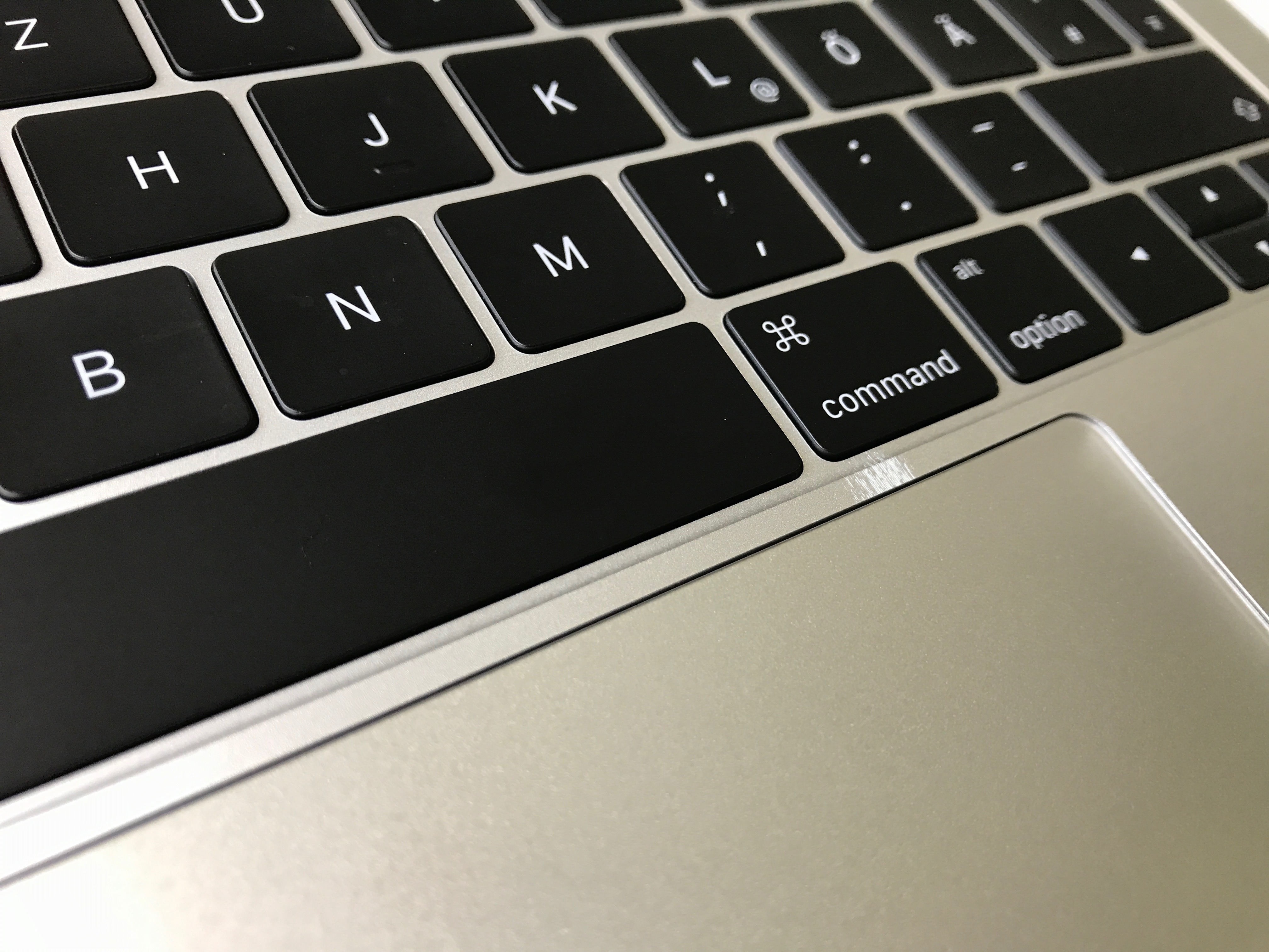

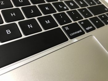

Nice to have the working capital to do that! :) I had issues with my own TJ-serialed 15" Pro that arrived earlier this week; Apple are sending me a new one without charging my card before I return this one - I didn't have a spare £3,000 lying around! :p

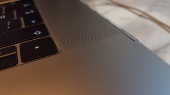

I am so happy to find this thread as this was bugging me since last December. Basically ordered a customised Pro 2016. 15" Space Gray 1TB, 2.9GHZ and 460. Received it after a 5 week waiting period.
When I received it - I immediatly noticed the scratches under both speakers. Long story short - returned it and received a replacement. The reason I'm happy to see this thread - everyone I showed the two scratched thought I was being anal, and trying to convince me it was not a defect. This thread proves it's a viable problem. No matter how small..this isn't what you should receive from a company like Apple..no matter if it's an ipod nano..or high-end, top of the line customised Macbook Pro. Period.
Anyways here is my current problem. I received my replacement back in early February - and I was away from home for the last 2 months for work. So my laptop is still in original factory box, shrink wrapped.
My current return period is over - but I don't want to take my chances. Especially after seeing this thread - as I initially thought I was the only one with a defected unit - looks like it's a global problem. What would you guys recommend? Should I give them a call in the morning and drive to nearest Apple store and open the package near a genious so I have a witness..if my second Macbook has the exact same problem?
As suspected my new replacement has the exact same problem! :( Thankfully this time I had a Genius unbox it at the local Apple Store for me, and they immediatly took note. This is getting ridiculous. It's more visible/disturbing when light hits from a certain angle / dark.

It is possible to get a perfect finish unit. Totally justifiable to keep demanding %100 satisfaction since Apple is overcharging for this hardware by a mile. Sheesh, my custom build 2016 15" MBP Space Gray retails for $3198 or so.

Thanks for explaining the anodize process. And I think it is possible to have the contact point at the back of C panel, so it won't be seen from front - as a product designer, I believe the designers and engineers at Apple must have thought about the contact point issue for sure. There also might be some other finishing process after the part being anodized as well. So my opinion is the scratch might be from something else...
It would be great if Apple would release some kind of video showing their manufacturing process (like the factory video from BMW), so we might be able to figure out where is the scratch from...

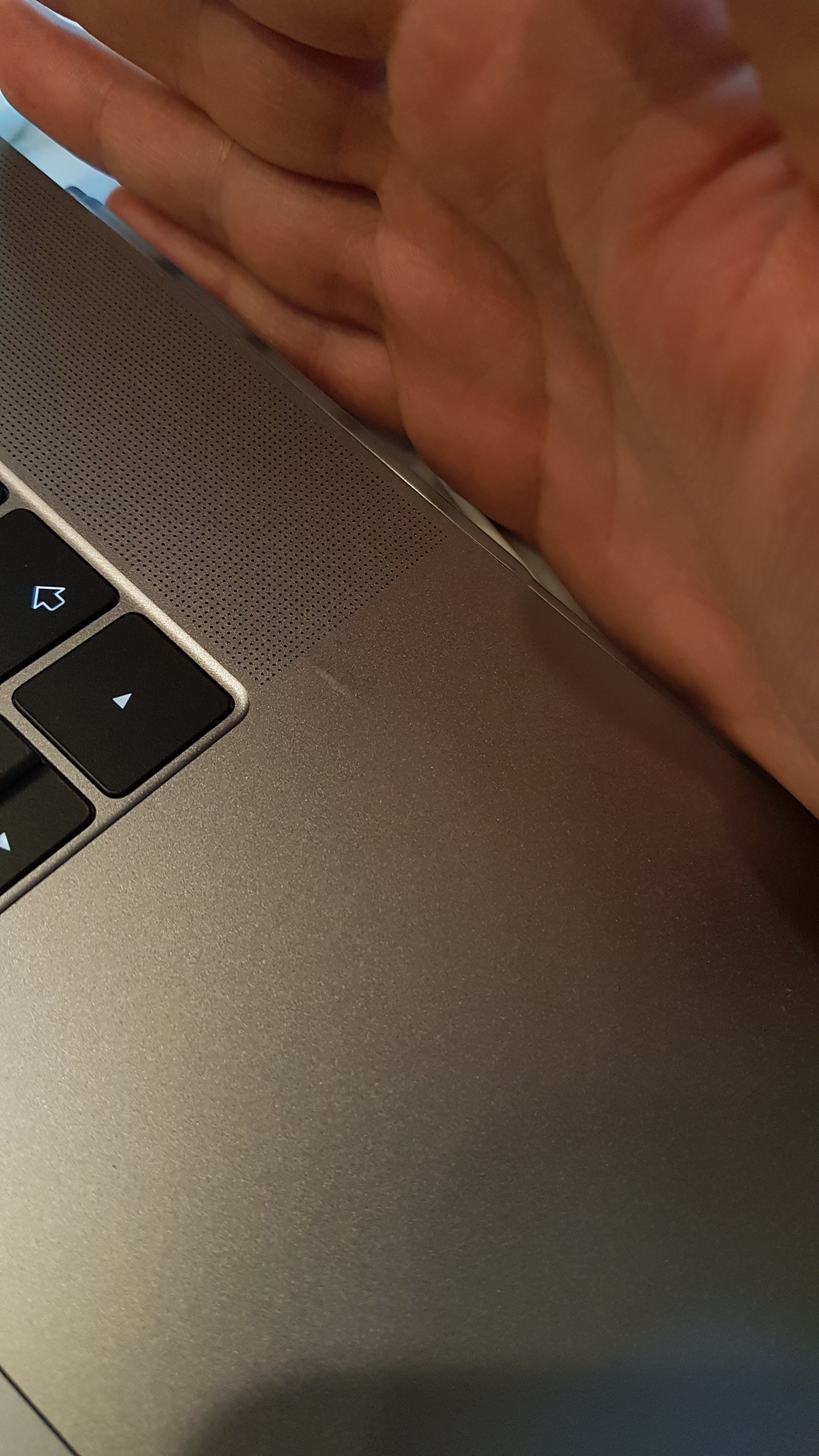

[doublepost=1493298779][/doublepost]View attachment 697652
Is that space grey? Thanks.
It’s likely that there is only one final step following anodize with respect to finish. That would be nothing more than a buffing or tumbling process to remove any residual water streaks or physical tackiness left upon the surface, following anodize. This would also provide for a minor wax coating that is inherently incorporated into that final buff/tumble process. At this scale of manufacturing, a final buff is somewhat likely but any additional finishing process--nope. All parts would then go straight to assembly.
It would be easy to incorporate into the manufacturing process controls, specificity of how the items would be hung/dipped in order to assure any color variations would be in inconspicuous areas.
I do not have the advantage of having a "scratched" MBP to inspect. If the scratch does not shine silver, as in bare metal, the scratch occurred prior to anodize. I suspect it is a handling issue.
Thanks for the analysis. I am not even sure if it is a "scratch", because if you touch it, you can barely feel it. And it's only visible from some angle. Maybe that's how scratch on anodized Aluminum looks... I am extremely curious where is it from...

Regarding the "feel" as mentioned above, in my case; when I run my finger over the left scratch - I don't feel anything, but it's there and you can see it. The scratch on the right feels more like a surface bump when you touch. Hard to explain. It's especially disturbing under daylight.
Update - A replacement came last Friday, and had a scratch at exactly the same spot (under right speaker). Will return it again... :(
Just got contacted by Apple, they offered to replace my metal casing instead of going through the whole return process for the third time. To be honest, I would prefer this, instead of going through this process again, only to find out that my third unit will have the exact same scratch on the exact same spot.
