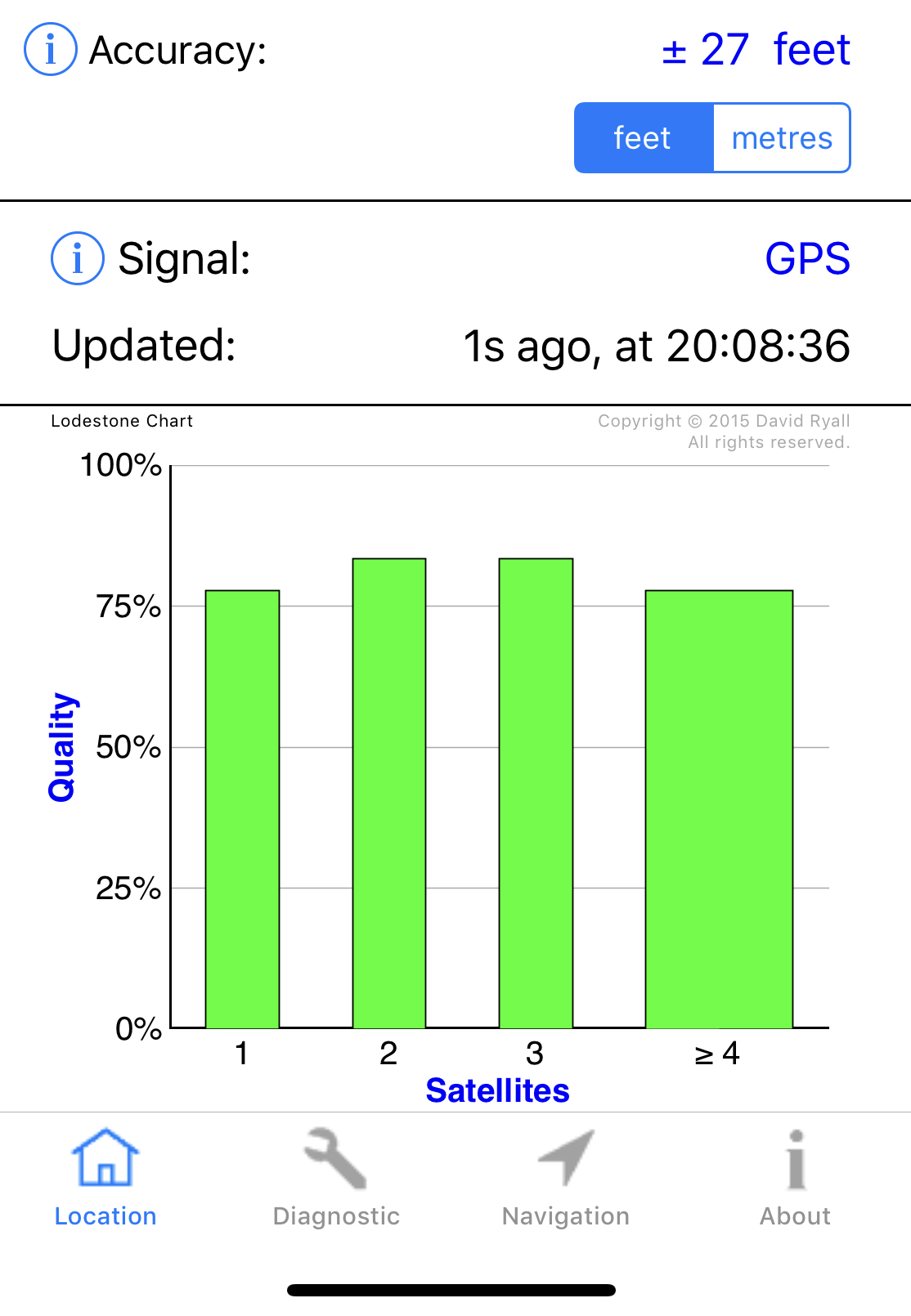

This is inside my house on a EU Intel iPhone X on beta 3
