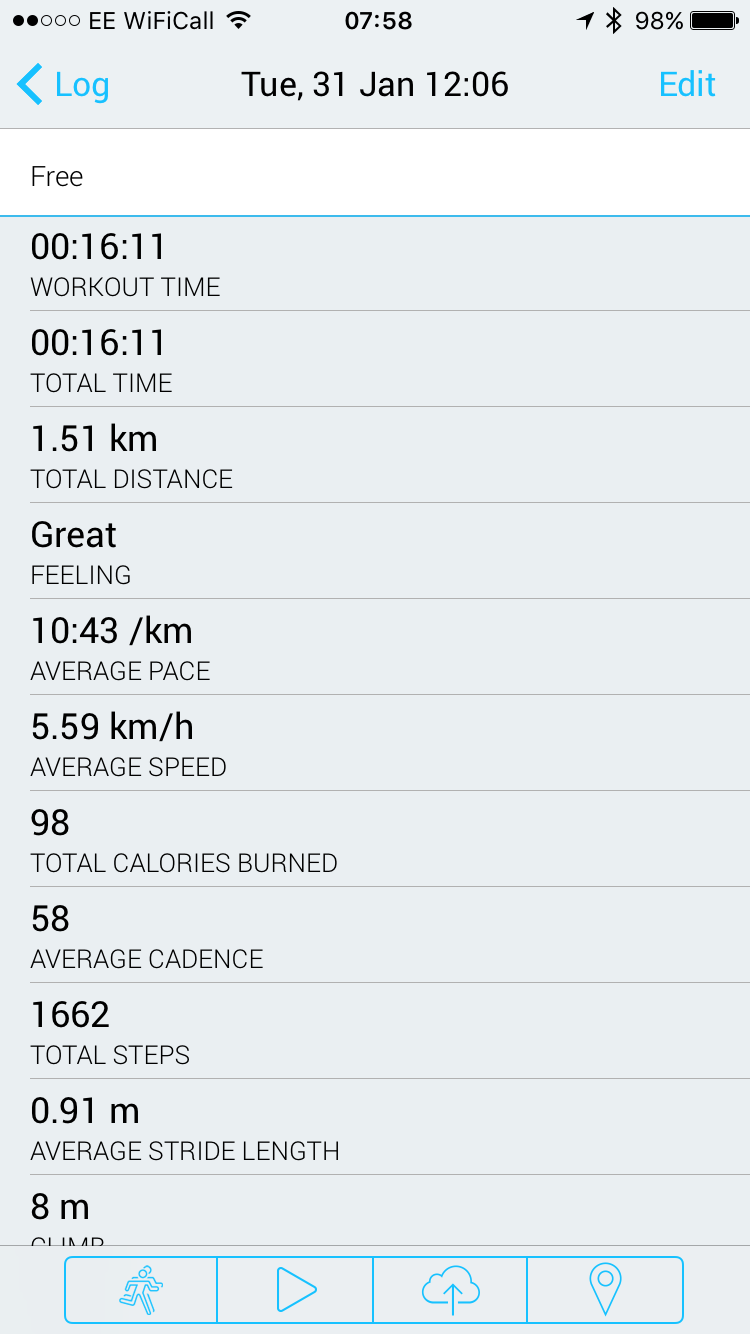

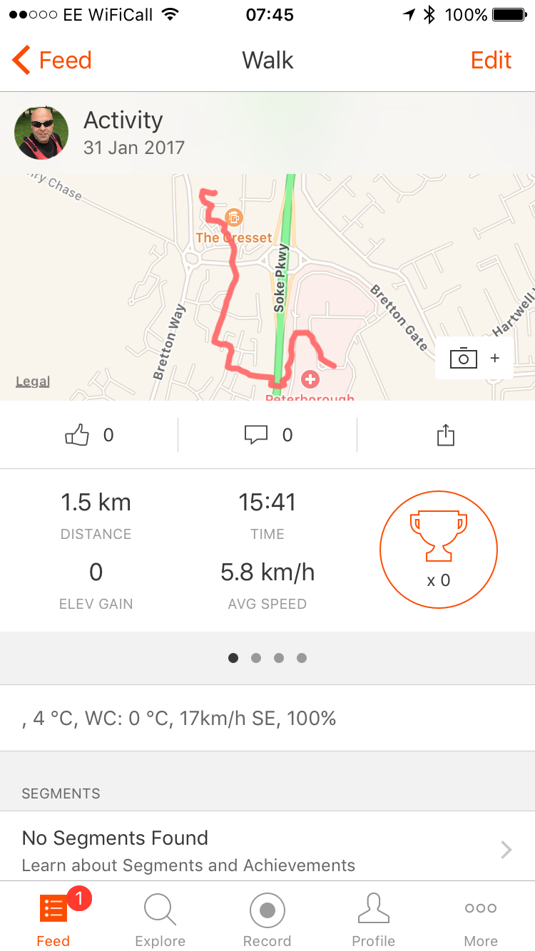

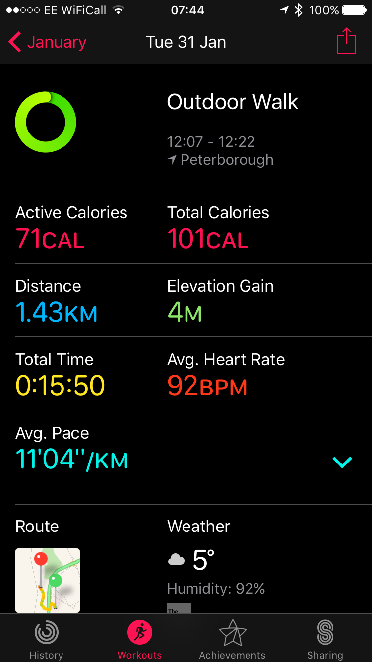

Ok so after some testing it seems that the gps distance accuracy issue is only a problem through 3rd party apps.
If I use the apple workout app (on Apple Watch but series 1 so still using the iPhone gps) then the distance measured seems to be accurate.
This seems to suggest it's software not hardware? Although obviously something has changed for 3rd party apps to have problems since iPhone 7

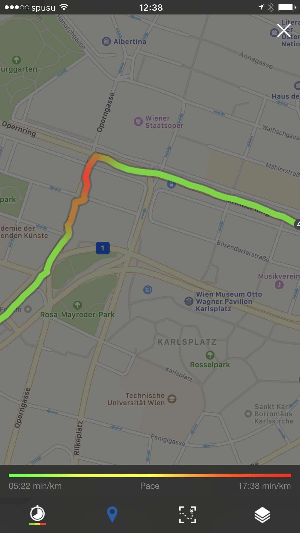

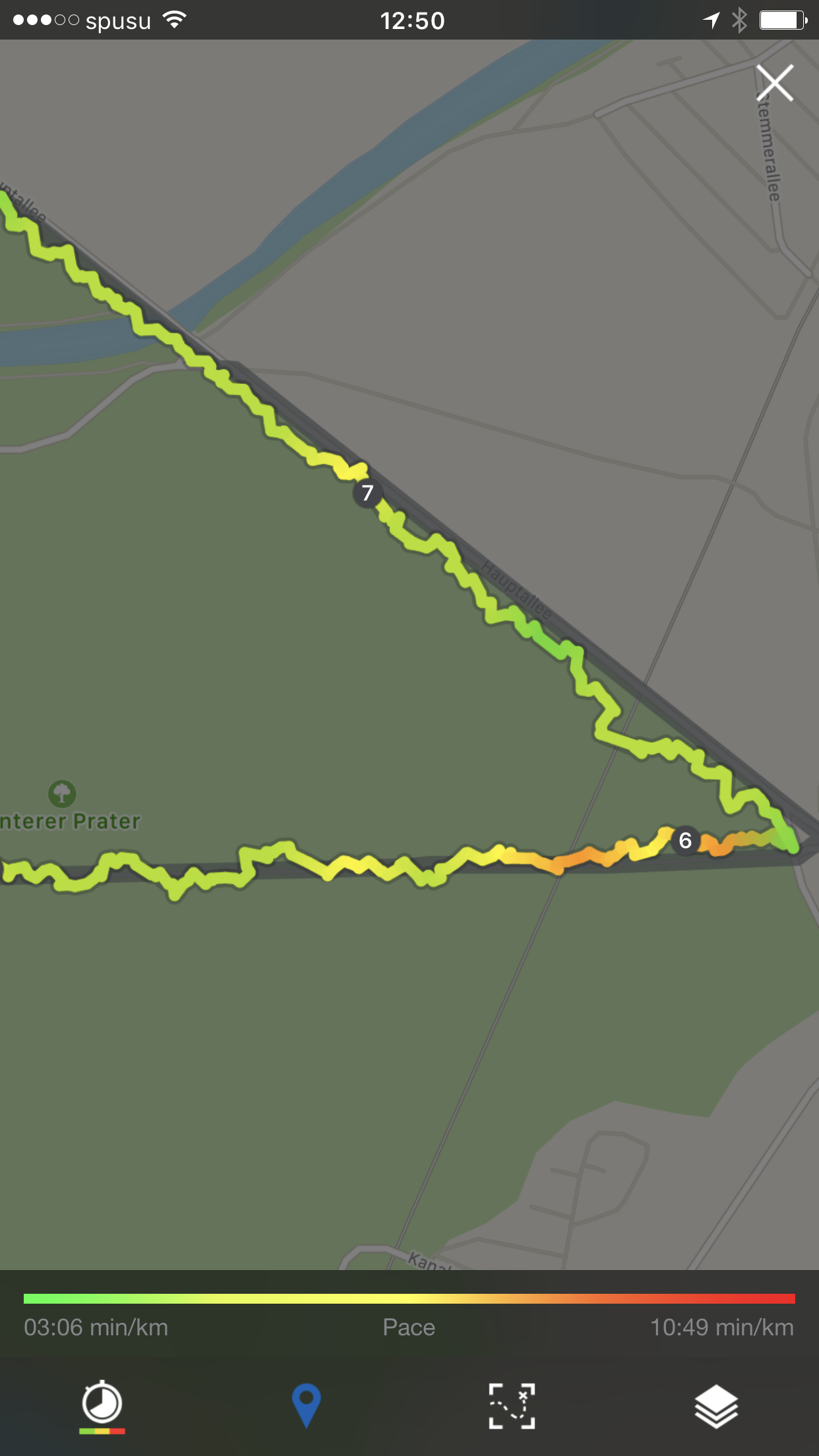

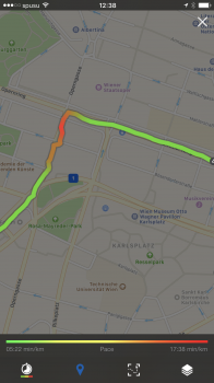

Hello everyone. It is my first post here. I've read different topics many times, but that GPS issue made me create account to share my experience too.
I use Runtastic for years and I run a lot. I've never had any problem with my previous iPhone 6+. I run over routes I know the exact length of. I ran several times last year with my new 7+ and it started to pause my activity from time to time while I am running with ~10km/h. I turned the Auto Pause off and continued using the app. I did not notice any significant distance errors. This year January was very cold and I skipped it training-wise. February I have several runs now and when I started I noticed I am faster without pushing myself more than usual. I attributed it to the almost two months long winter rest. But today I ran a short 5km route in the park where local weekly runs are organized. Runtastic measured it at almost 6km. The graphics of my run is jagged and zig-zagish.
I thought I'd go Monday to Apple Service center here in Sofia to ask for a replacement, but after reading almost the entire thread, I think I'll wait several months more. Obviously Apple do not know what is going on. But I think I know. They just saved some coins by putting subpar low quality GPS module in their iPhone 7, counting on assisted GPS to compensate the bad positioning data from the antenna. I suppose they will never fix it and will never admit it publicly. Maybe third party app developers will adjust their smoothing algorithms to remedy the problem as much as they can. That will take time. And until that time comes, I could brag with my amazing running results.

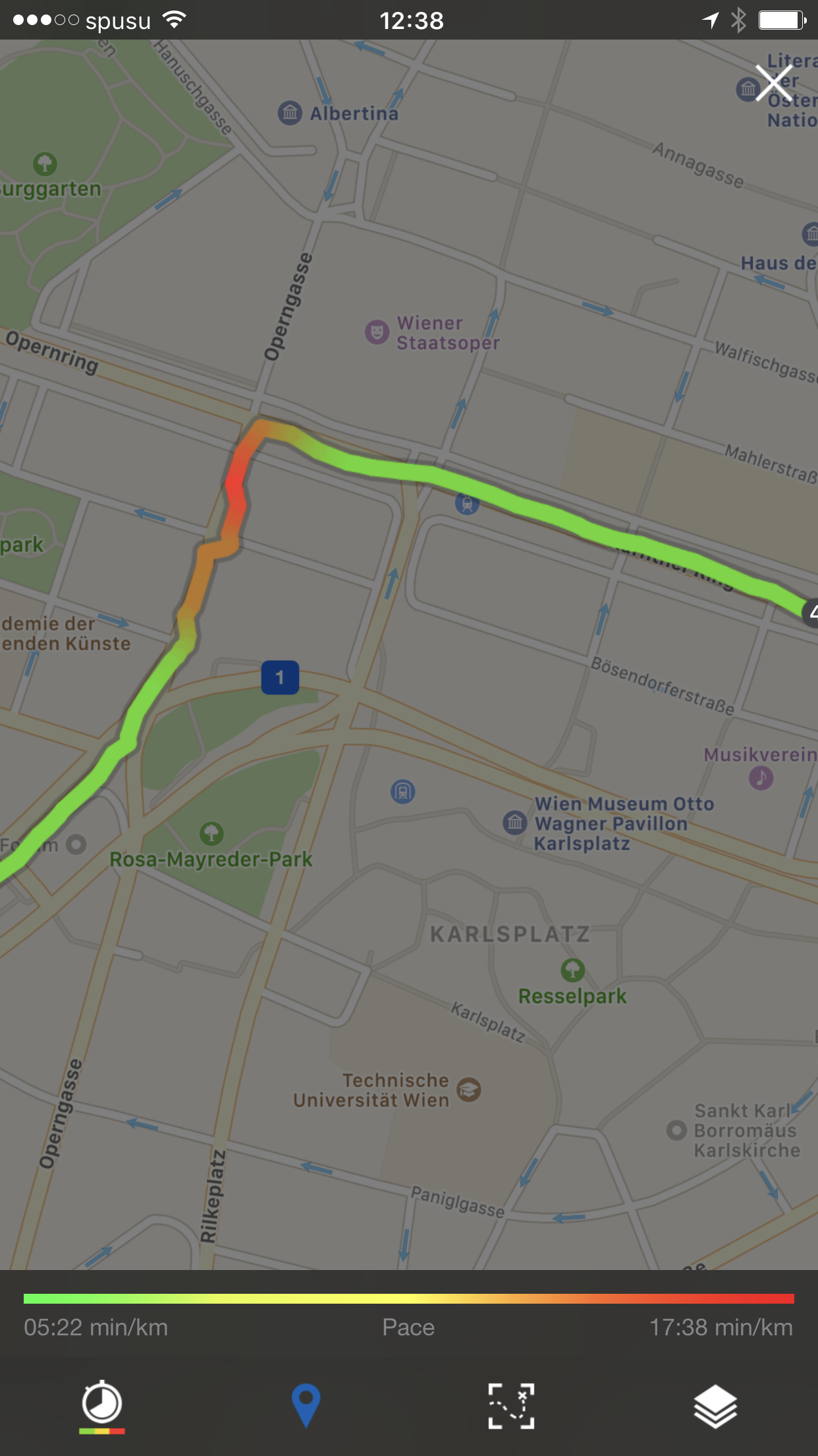

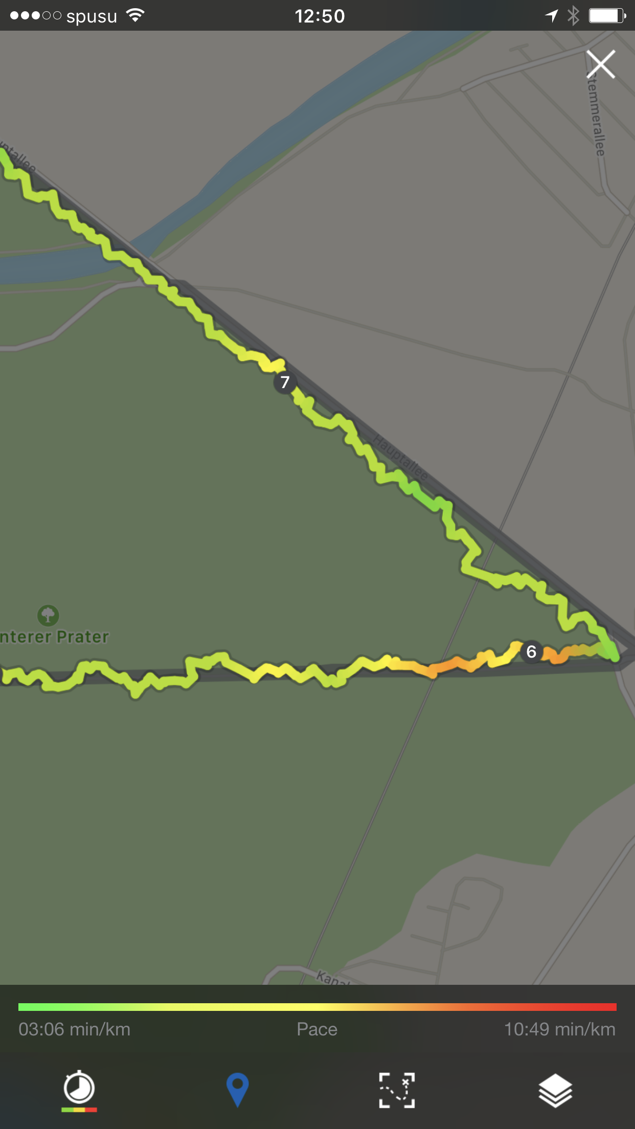

Anyway. Haven't been in this thread in a while. My problems with the GPS seemed to get a little better, or maybe I got used to them. Now that I'm ramping up more for training and running 60-70 miles per week, it's been chaos. There's really no rhyme or reason. I mostly run trails. And for example - I did a 27 mile trail run this past Saturday - it was off a little but not too bad. I did a short bridge run the next day and it seemed good. I did another bridge run the following day and it had me running 4 and 5 minute miles the entire time. Flattering.. but NO.
Went back to Apple, showed them my Strava data, promised that I wasn't running drunk with a jet pack. Also showed them screenshots of Apple Maps acting all whacky. They obvisouly replaced it (yesterday). My first run yesterday seemed only a little off. But I ran again last night and it was WAYYYY off. Ran again today... and off again. It seems worse than ever. Before it was sporadic, but now it's constant.

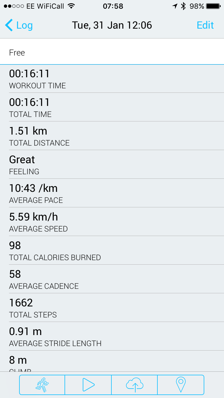

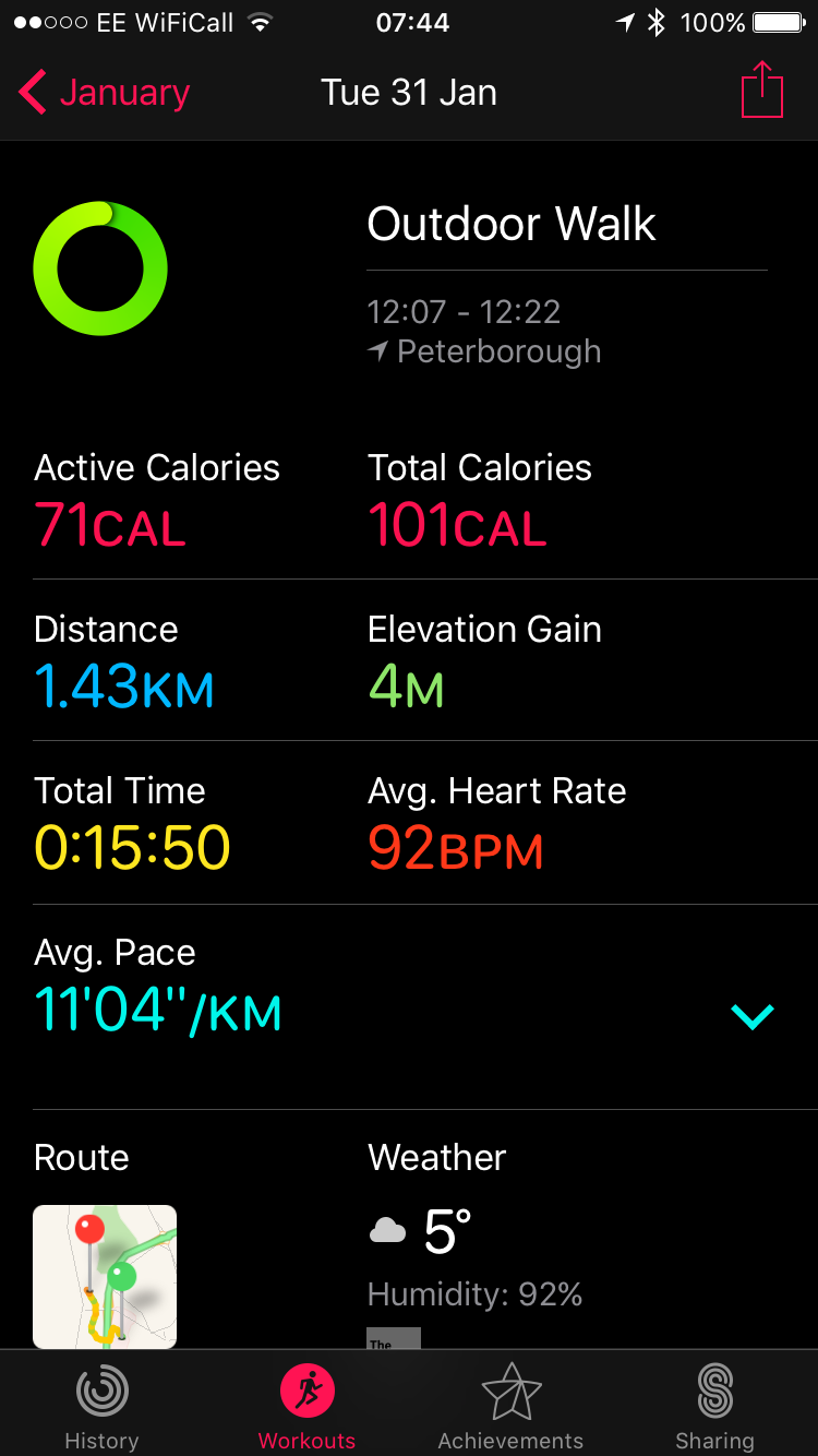

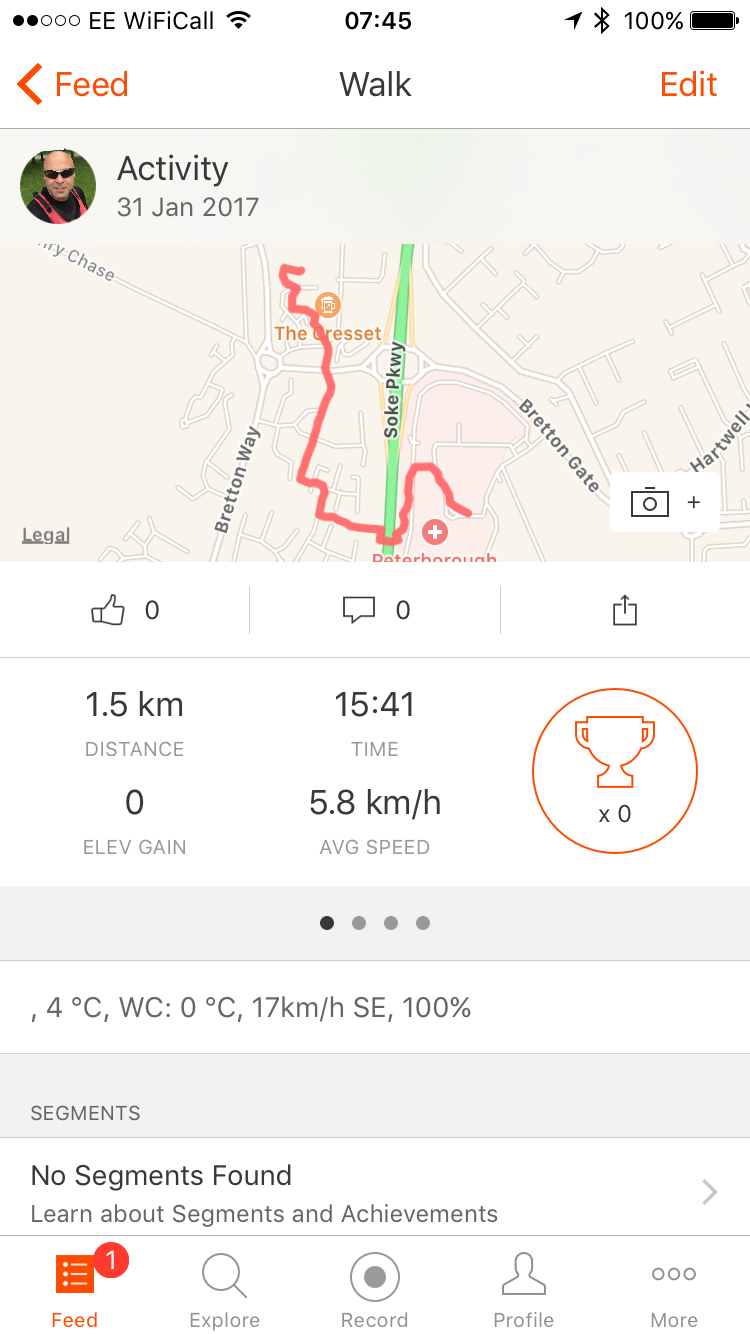

Hi,
Just to clarify it is the activity app linked to Apple Watch (series 1 so no onboard gps) that seemed to be recording more accurately. See comparison with iSmoothRun and strava below. Over 10k 3rd party apps were around 1k out.
In the end I gave up with iPhone 7 and have gone back to my iPhone 6, in testing against gps watches it's around 1% out compared to 10% on iPhone 7. Really don't miss my 7. Just shame on Apple for saving a few pennies on gps..
Agree about your point that most people wouldn't notice, I just thought my times were improving, it wasn't until I ran with my buddy who had a gps watch that I realised.
Paul

UPDATE 1: A friend also uses a iPhone 7 Plus, 10.3.1, EU and sent me some of his recorded runs (Runtastic) and they *looked* good, really good. He's an experienced runner and would have noticed a +45% distance.
Reason enough to give a Apple a call and ask for a replacement. To my surprise, not much talking/explaining was needed until I could pull my AMEX to block the fee for the exchange unit. I assume, that they know that somethings stinks but would not say so officially.
Looks good
Looks crap
No. iPhone 7 Plus, 10.3.1, EU.
Reference: Garmin Fenix 5, Polar V800 (1,3% difference)
RunKeeper, Strava, Runmeter: up to +20% distance
Runtastic: up to +45% distance
