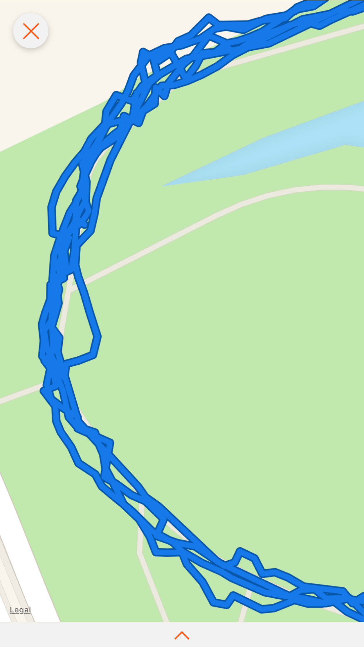

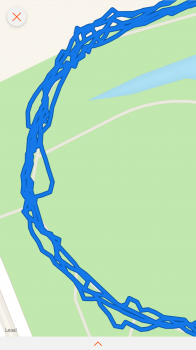

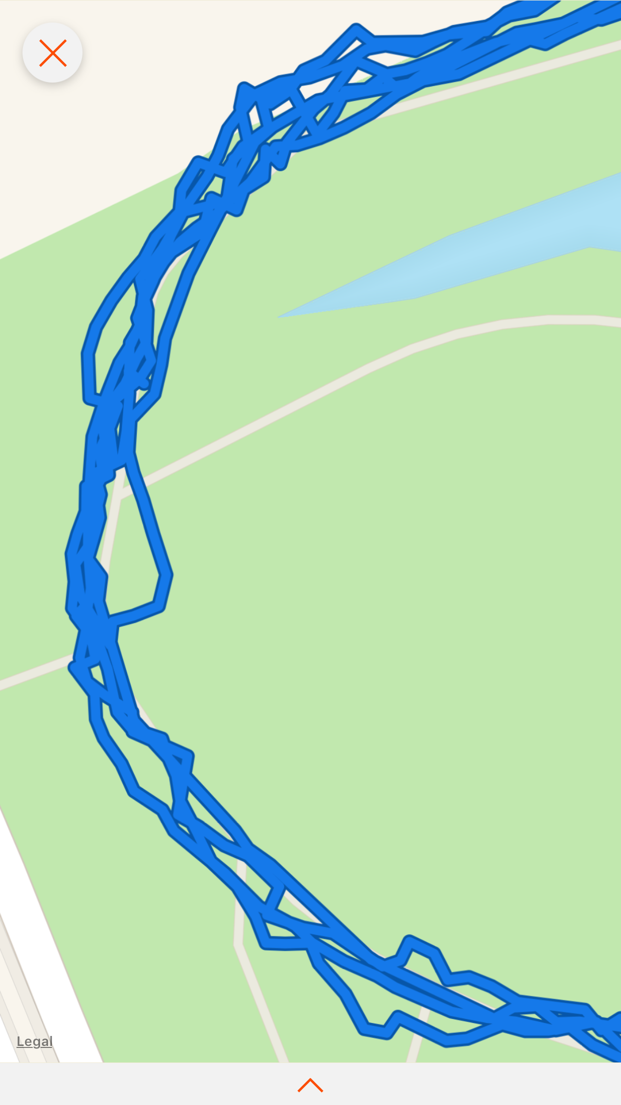

Just did my first Strava run on my new iPhone 7 Plus (A1784). GPS accuracy looks very messy.
My tracked line is jumping all over the place.
Before I always used my iPhone 6S Plus and GPS was a lot smoother.
