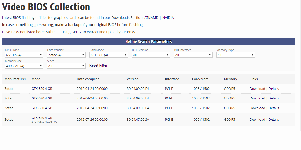

The only thing that comes to my mind is that BOIS is different, as i could see that TechPowerUp lists two of them, 09.00.E4 (mine) and 47.00.3A. When looking at the ROM in Hex editor, i could guess that Zotac rom that you made is out of the later one.
I'll try and go through them both and attempt to copy the EFI part in my original one, but i've never touched Nvidia rom before, just good old AMD...
