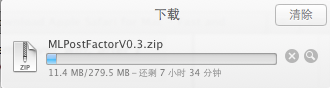

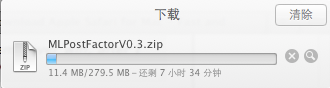

在大陆,此网盘的档案下载非常慢,而且下一下就会停,可以放在别的地方供大陆FANS下载吗?
PS:如百度网盘或115网盘
谢谢!

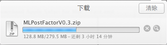

Dear Wayne:
PS:如百度网盘或115网盘
谢谢!
I don't think it's a regional thing. That download service throttles non-pro users. It took me over an hour here in the US. It's the cost of 'free'.
Wish I had a place with enough bandwidth to mirror it. Just know I'd blow my limits the moment I did.

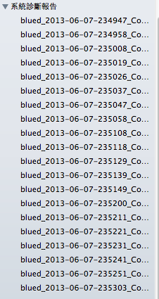

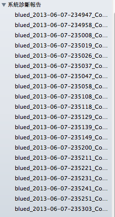

I have blue tooth problem here.
My MacBookPro 2,2 can't switch on/off bluetooth normally.
And ReportCrash keep producing crash logs as attachment.
View attachment blued.zip

Please take a look into it, thanks in advance.
I don't use blue tooth, anyway to temporally disable it?

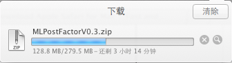

Dear Wayne:
PS:如百度网盘或115网盘
谢谢!
Probably dropbox... Will try.
